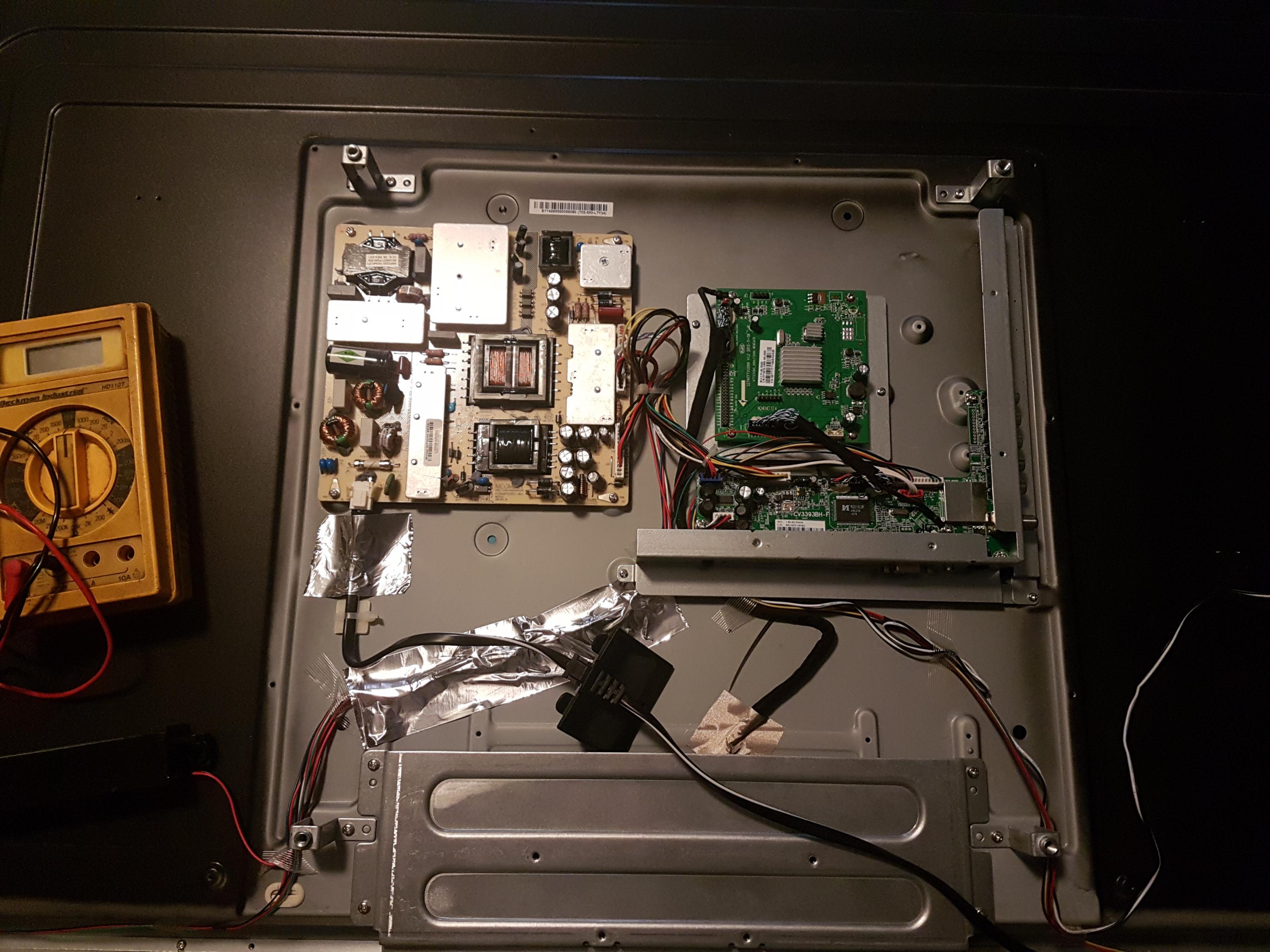

    Fluid 55 LED 8018758a no backlight
    This tv has same boards as Westinghouse dwm55f2y1 I have standby tv even turns on I can see video with flashlight. I have 24v 12v 5v 3.3v for back light on etc. I get 167v across main cap never changes I get no voltage on the led connectors. Removed led panel tested all leds as well.
    Looking for info on how test led driver circuit on psu

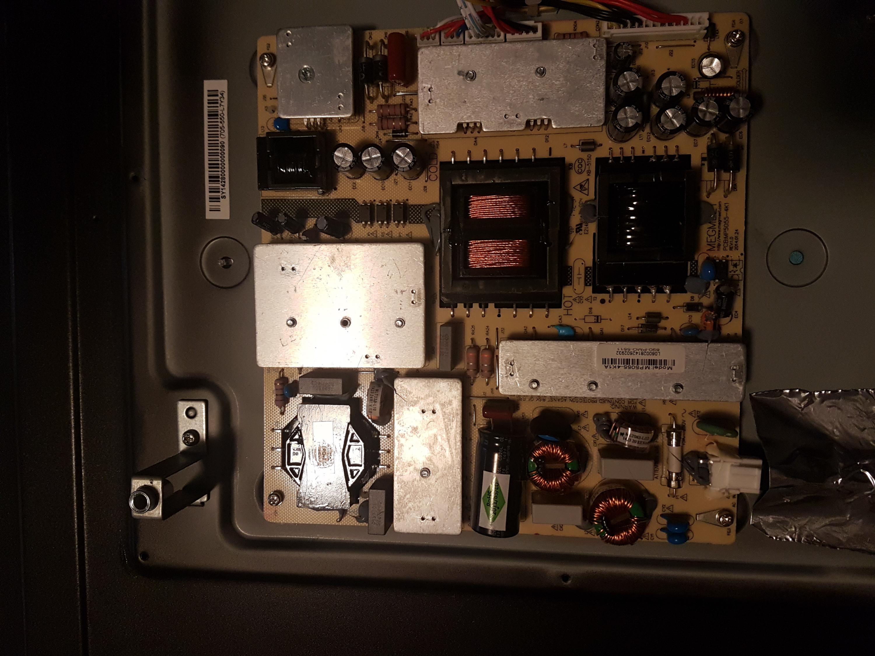

    Re: Fluid 55 LED 8018758a no backlight
    What is number on power board. PFC not working.
      Mp5055-4k1a

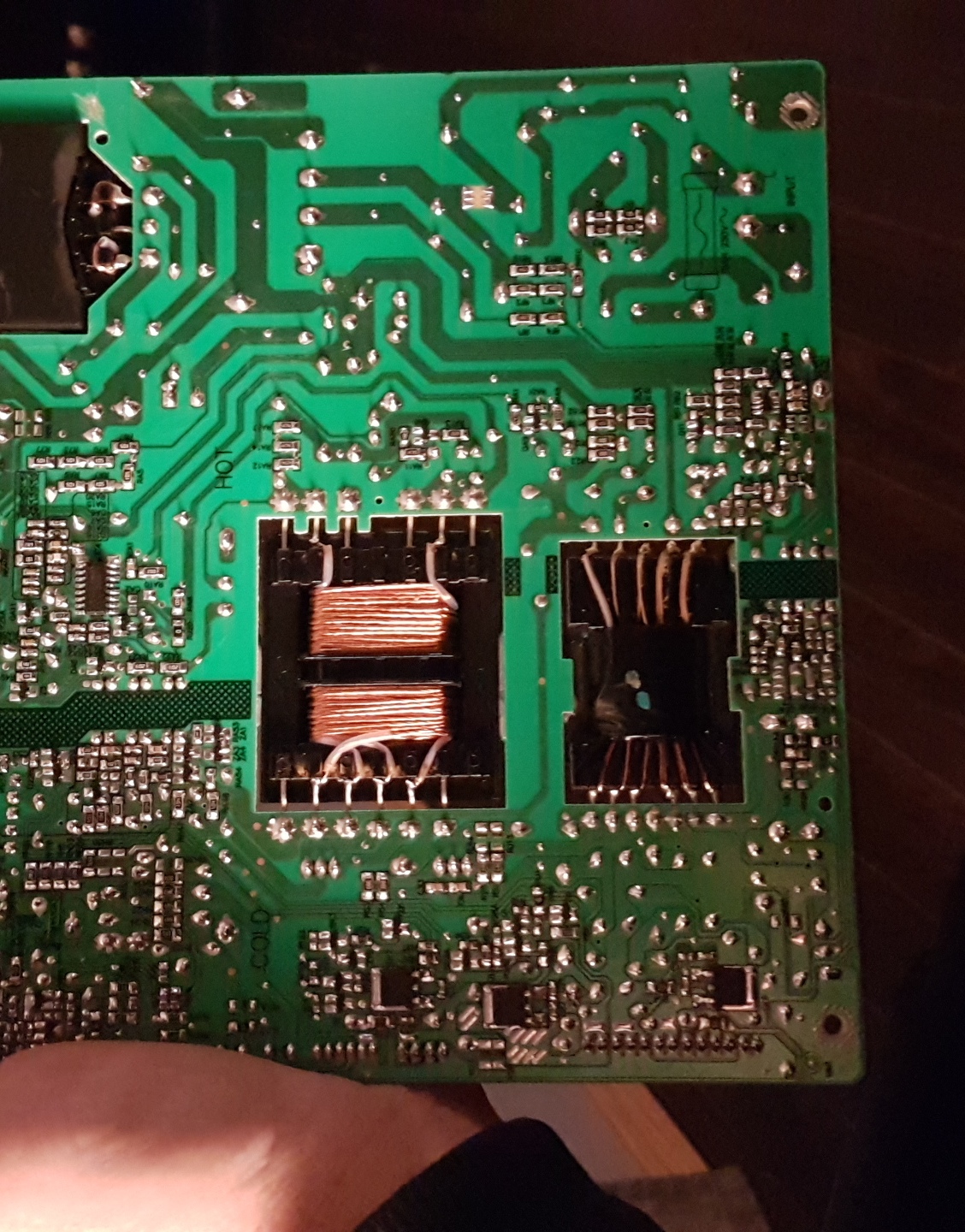

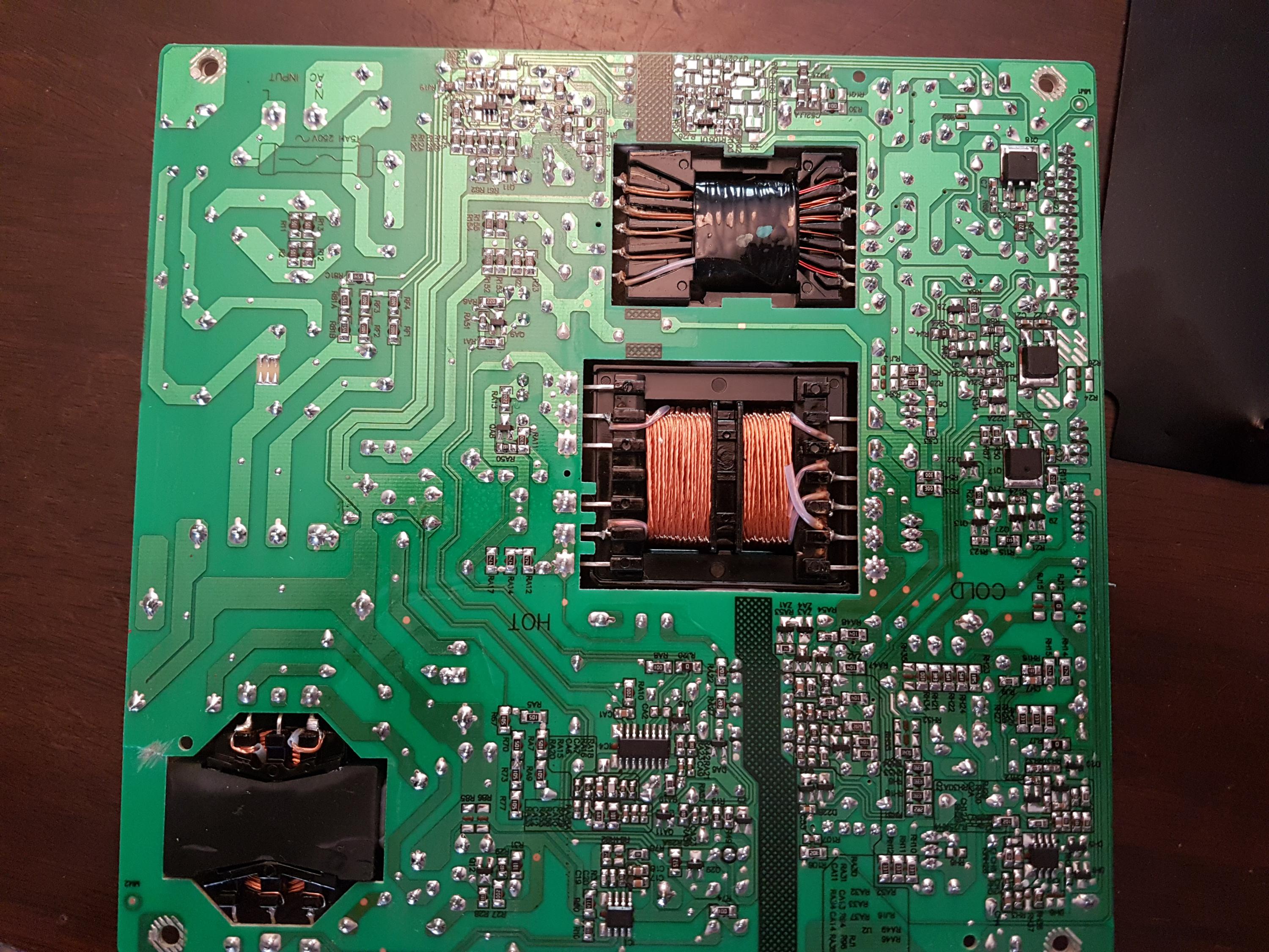

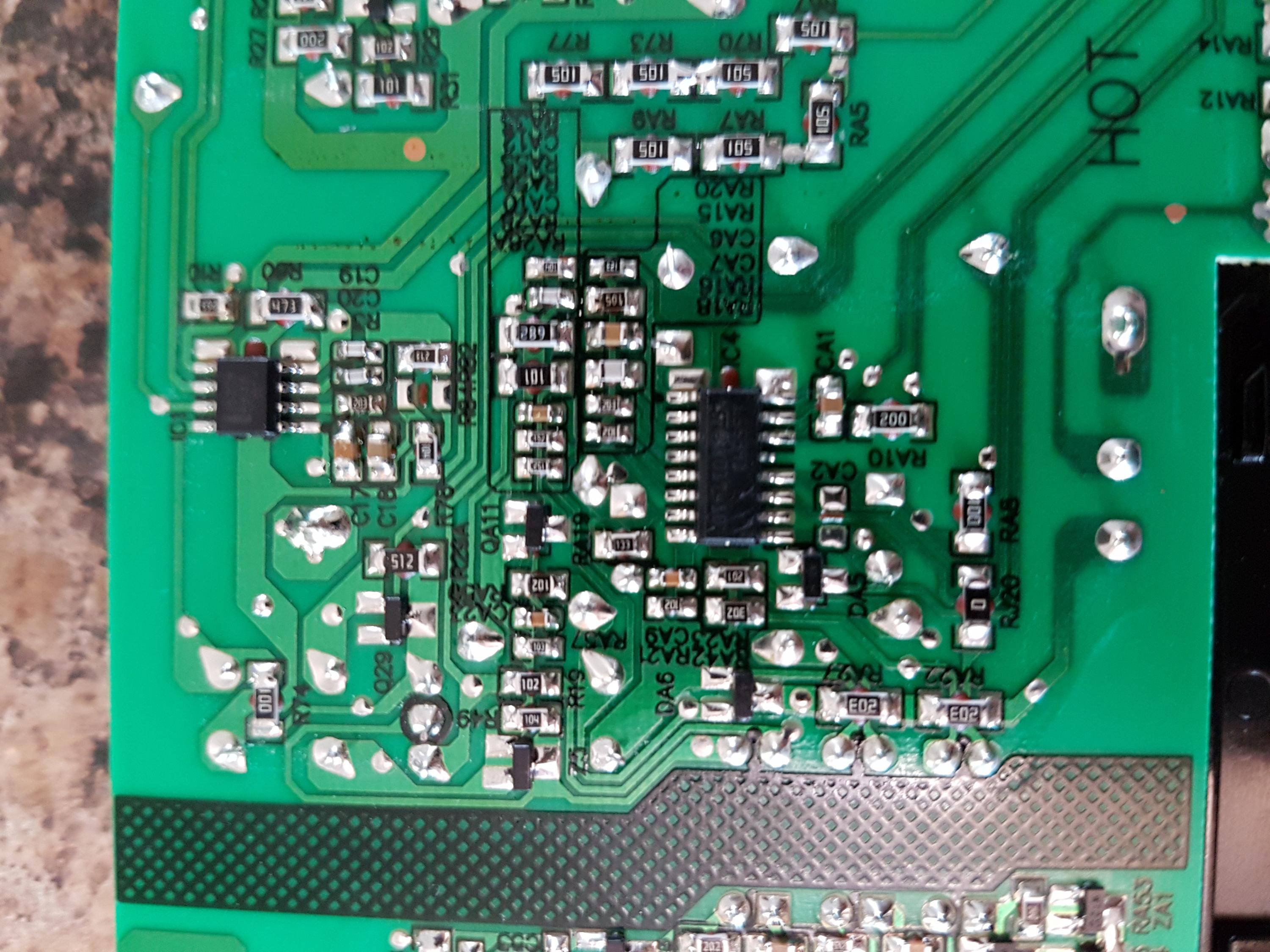

                  Need numbers off ic's bottom center and clear pictures of that area

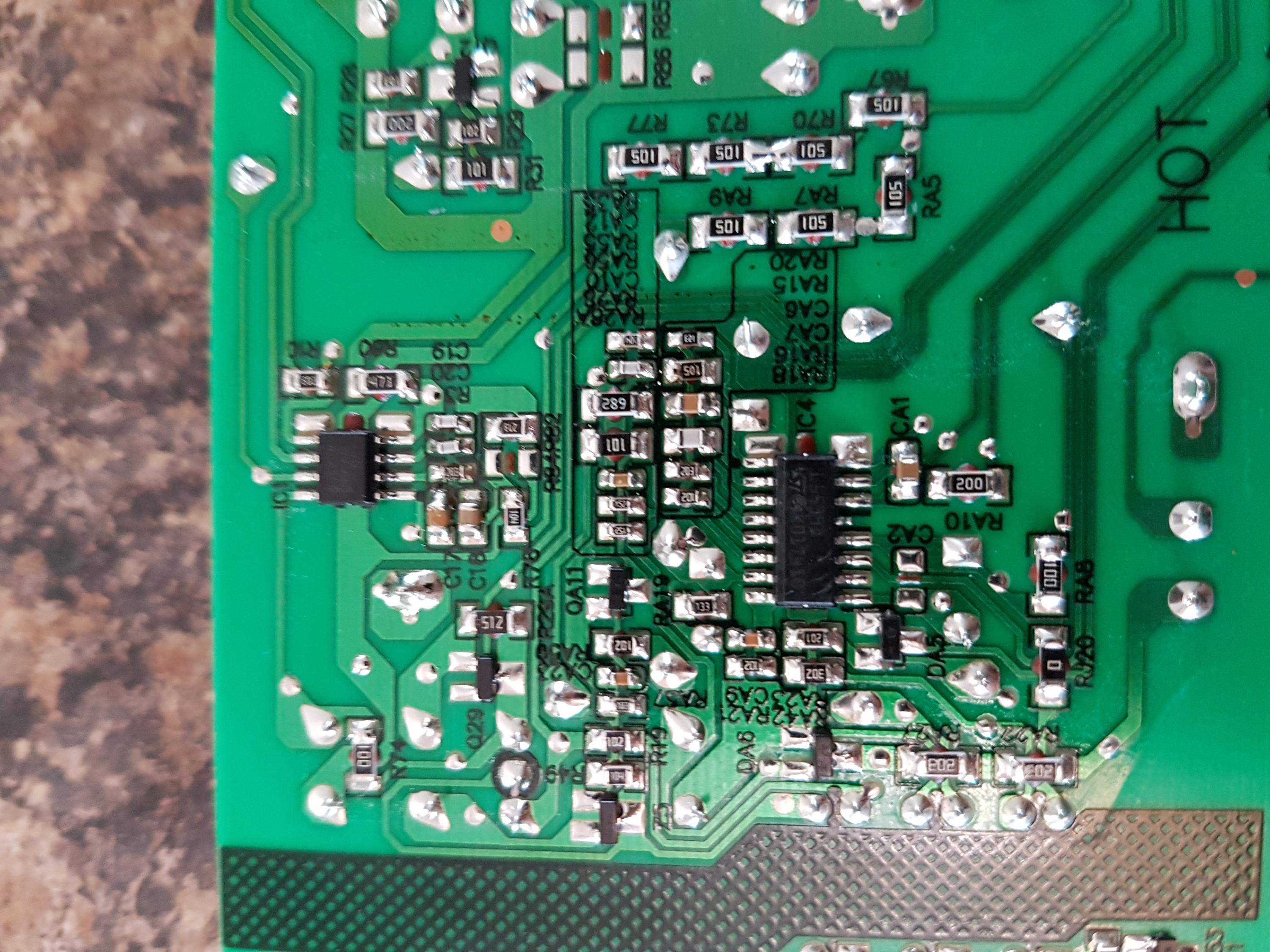

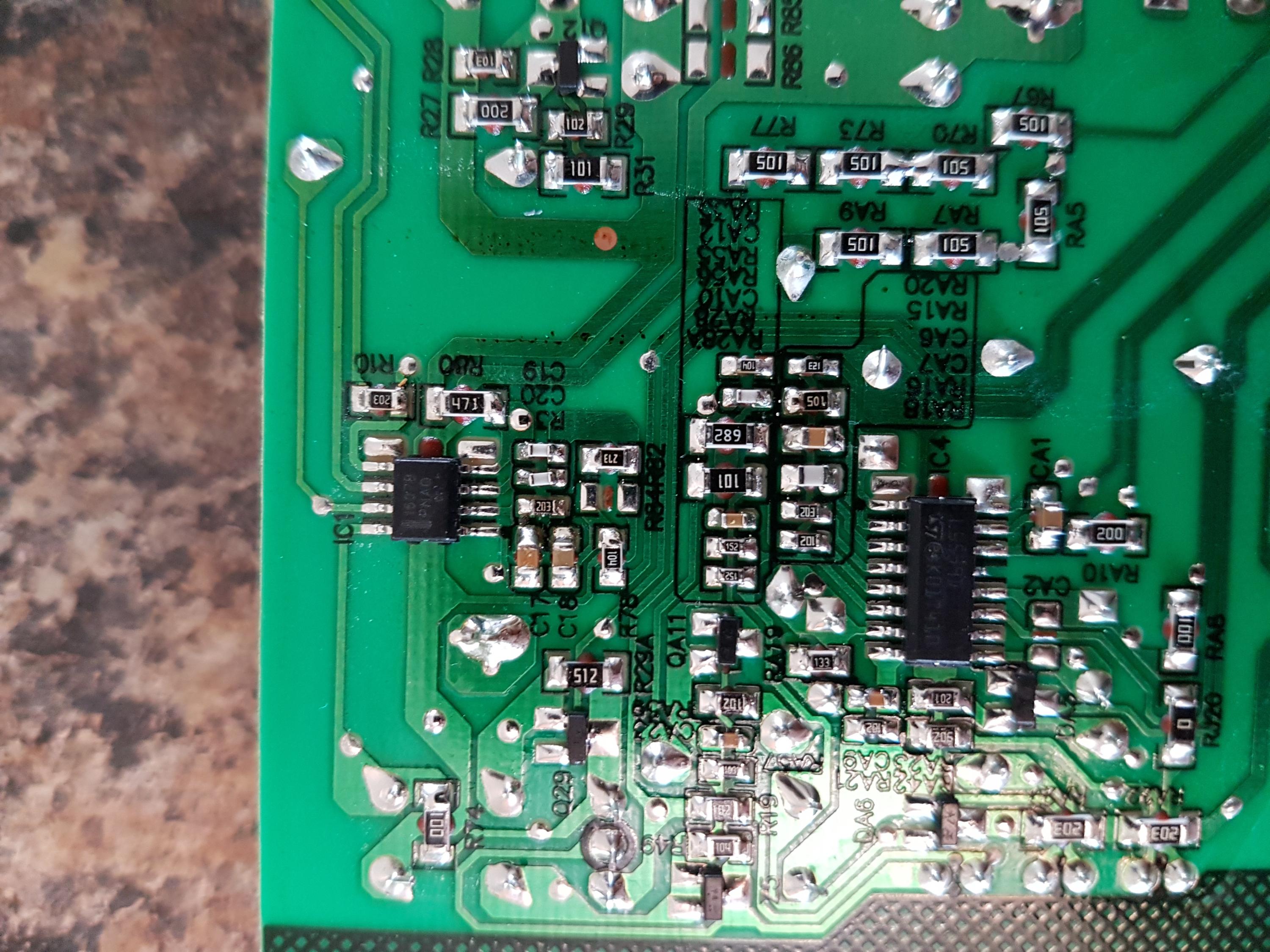

                    Can't make out numbers here the pics
                    • microvibe
                      • Mar 2013
                      • 275
                      • canada

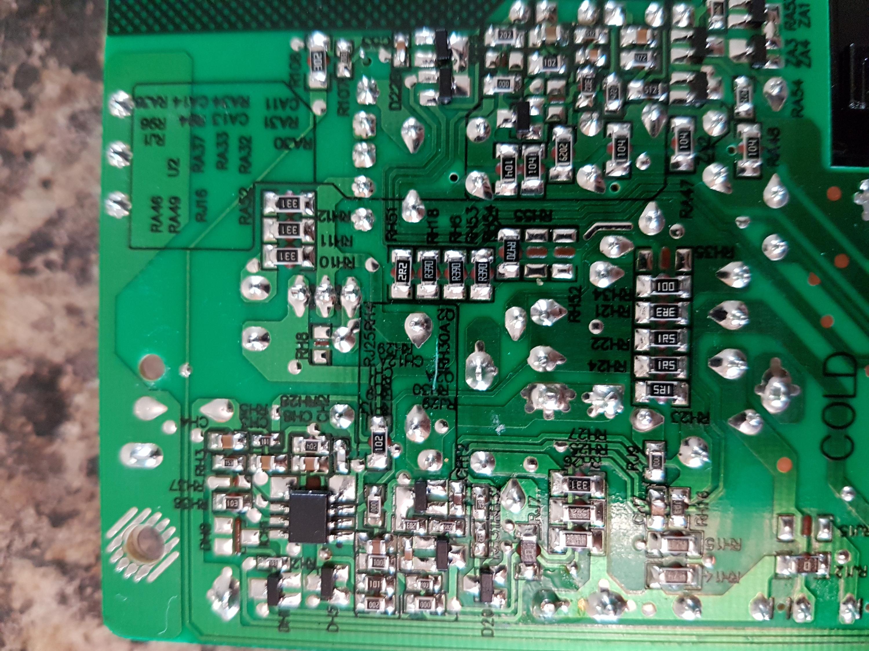

                      Tbis is one
                      1607b
                      Pnaq
                      The other is
                      L5599d I think
                        It's l6599d
                          1607 is your pfc ic. Pin 8 is input voltage and pin 6 is ground. See what dcv you have when power on

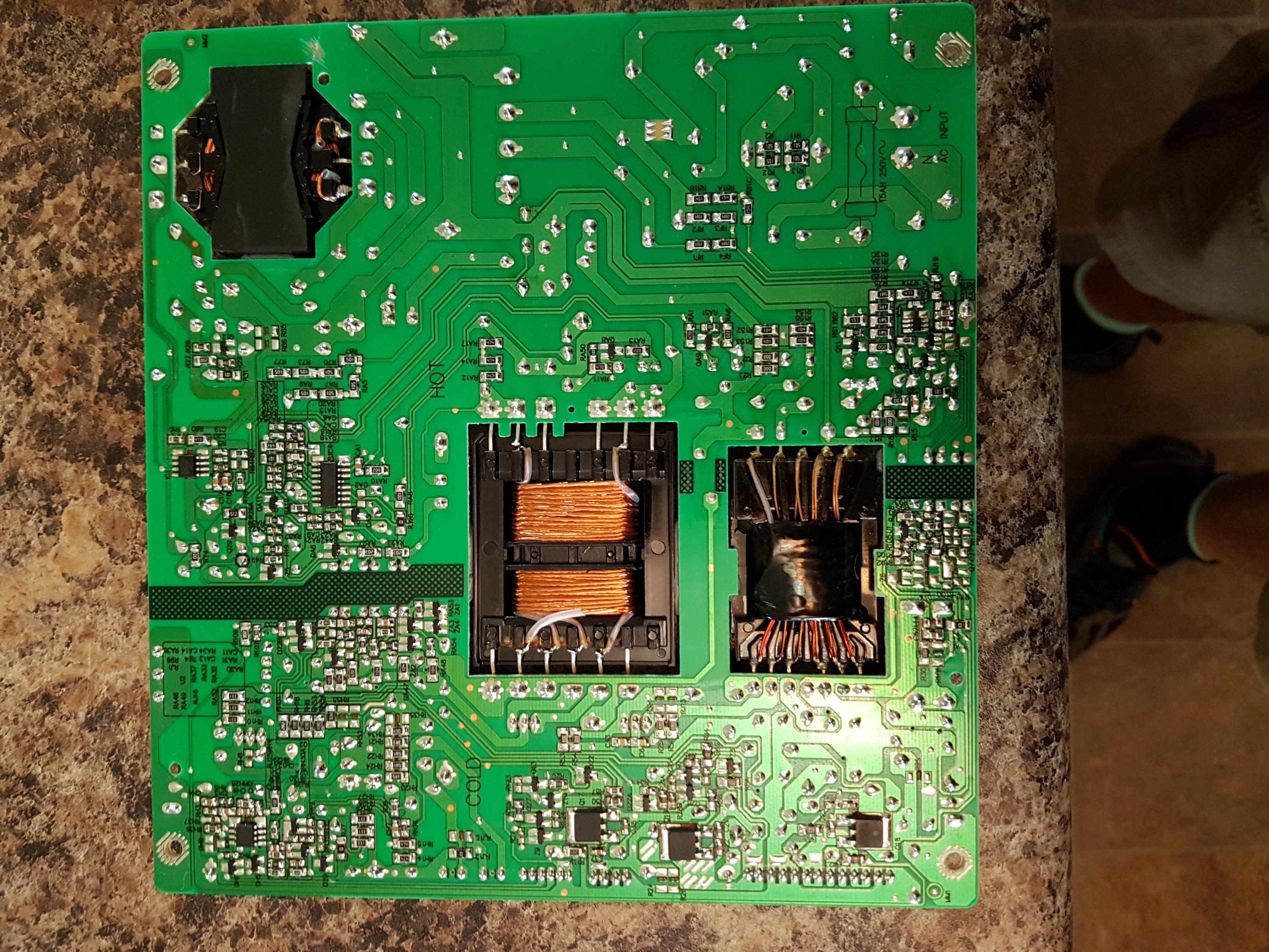

                              Zero volts on pin 8 of that pfc . I traced it back to a small cap no voltage there
                                        https://www.badcaps.net/forum/attach...5&d=1504545462
                                        Did you trace pin 8 of the PFC IC to see where it f goes?
                                        If you did you would have seen the + Voltage from the AUX winding of the STBY power supply feed the Emitter of the switched transistor Q29, the Collector of Q29 feed pin 8 of the IC through R74.
                                        You can solder wires to Emitter and Collector so you can test the Voltage with ref. to the hot side circuit GND.
