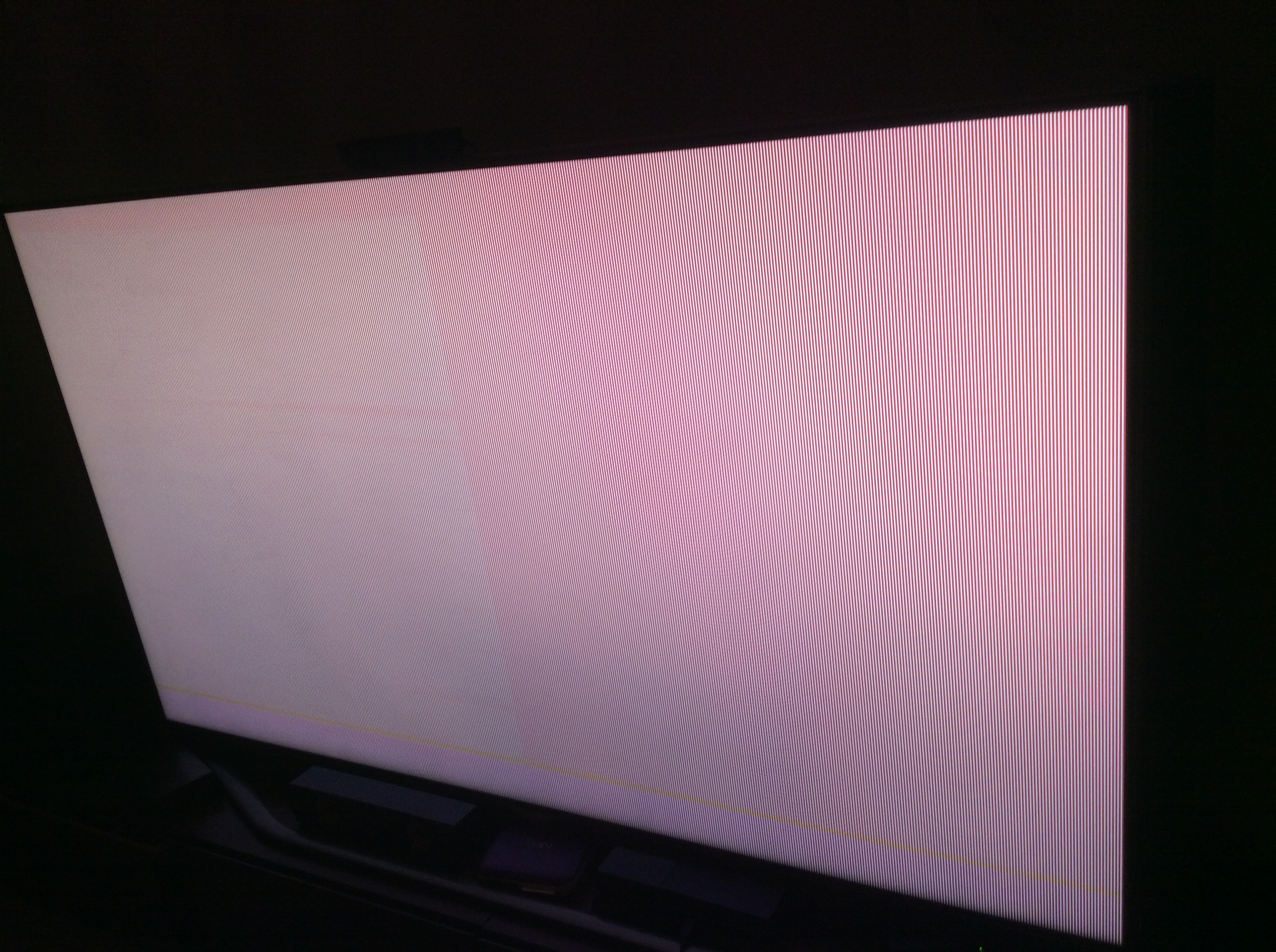

    hello,
    i've been having a problem with my LG 79UB980T, there's no picture visible in all the inputs (only vertical lines with a usually pink background flickering), tried satellite receiver, Xbox One, movie from a USB Harddrive & PS4. even the built-in youtube app and netflix show no videos.
    however i can see the menus with flawless full colors and listen to sound perfectly, it only appears when anything is played.
    *I use only high quality hdmi 2.0 cables. (if it matters)
    *I once used cheap HDMI splitter
    I thought it might be a T-Con issue at first but the TV worked perfectly for two days after changing it's location (weird i know), then the issue came back.
    So I opened the TV, jiggled the wires and connections a little bit, nothing happened, the boards look perfectly clean and no signs of burnt up capacitors or stuff like that.
    What could it be?
    Pic attached.
    thanks

    Well I am tempted to say put it back where it worked before....But I think this is aT_CON issue.

          Re: LG 79UB980T Video problem
          I'm guessing there are two processors on the mainboard, one does the menus and there is another to do image processing, this one had BGA issues.
          It sometimes only takes a light press on the processor to make/break connections (bring the picture back) so it's possible moving it caused it to temporarily work.

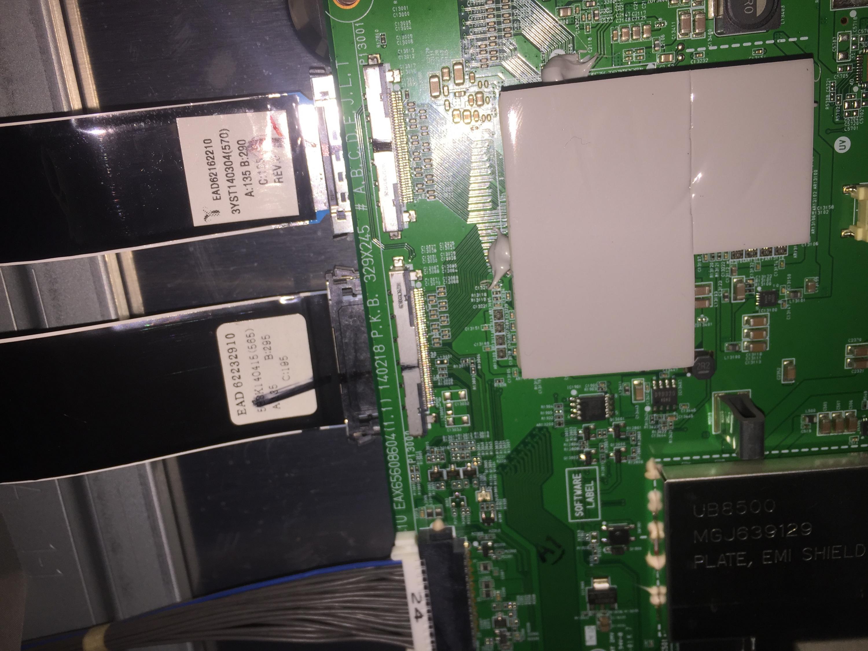

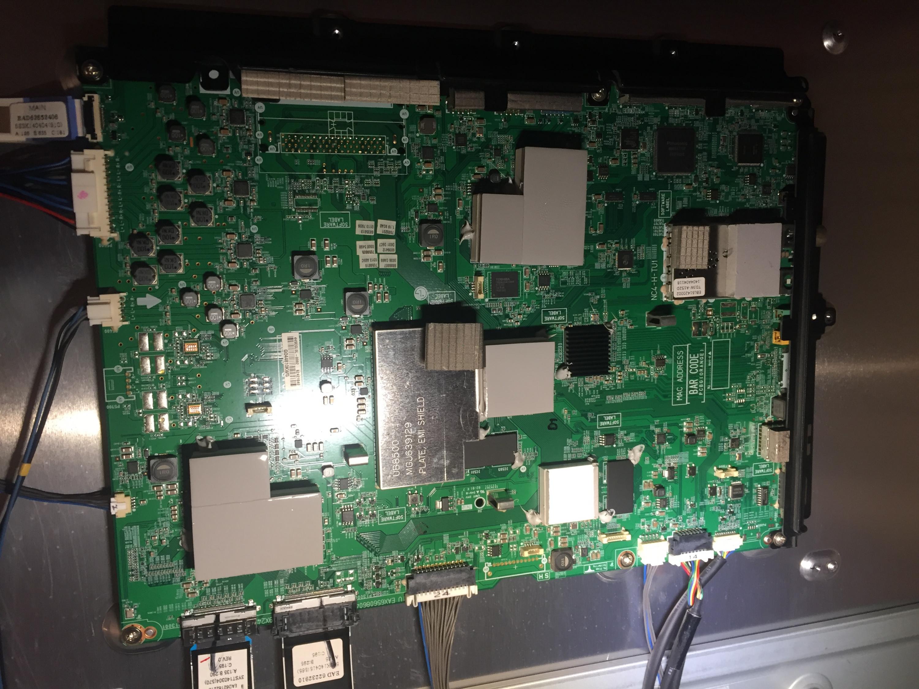

                  I found several main boards online that exactly match the one that needs replacement, same board model no. but not taken from the same TV size as mine. they're either taken from 65" or 84" models while mine is 79"
                  (does the TV size matter?)
                  I need someone to point me in the right direction for selecting a compatible board.
                  mine is EAX65608604(1.1)
                  took a couple of pics of the board
                    The size matters.. you can become to a video not comprensible due to different incompatible brand of lcd panel, i think is possible by a technician but it must do some steps more (copy of eeproms, firmware flash)...
