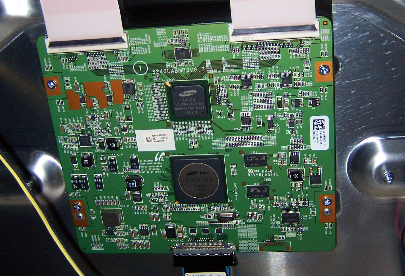

    Hi

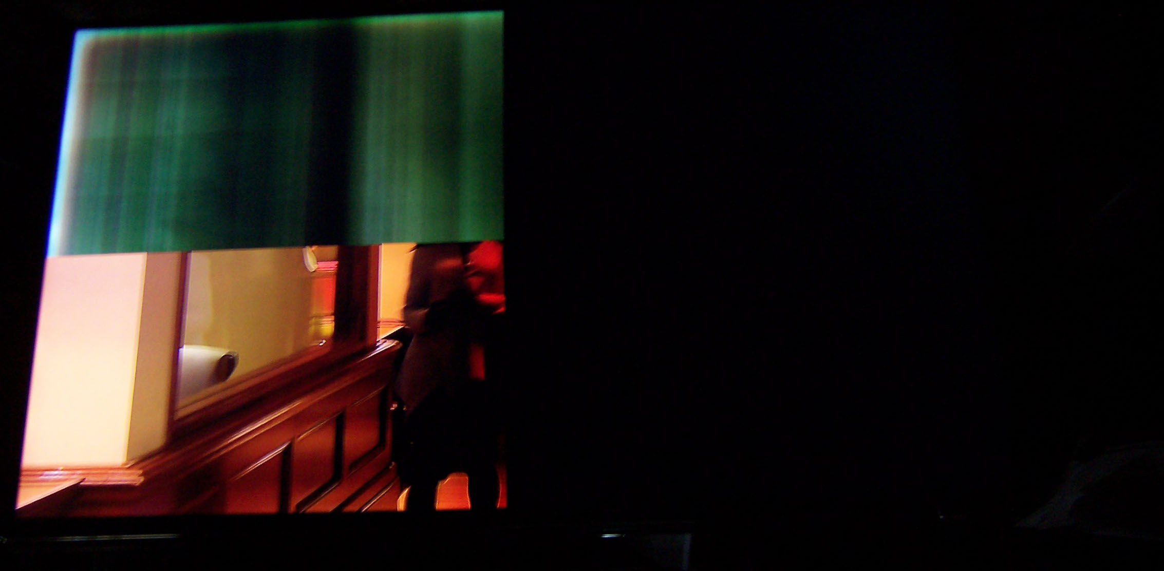

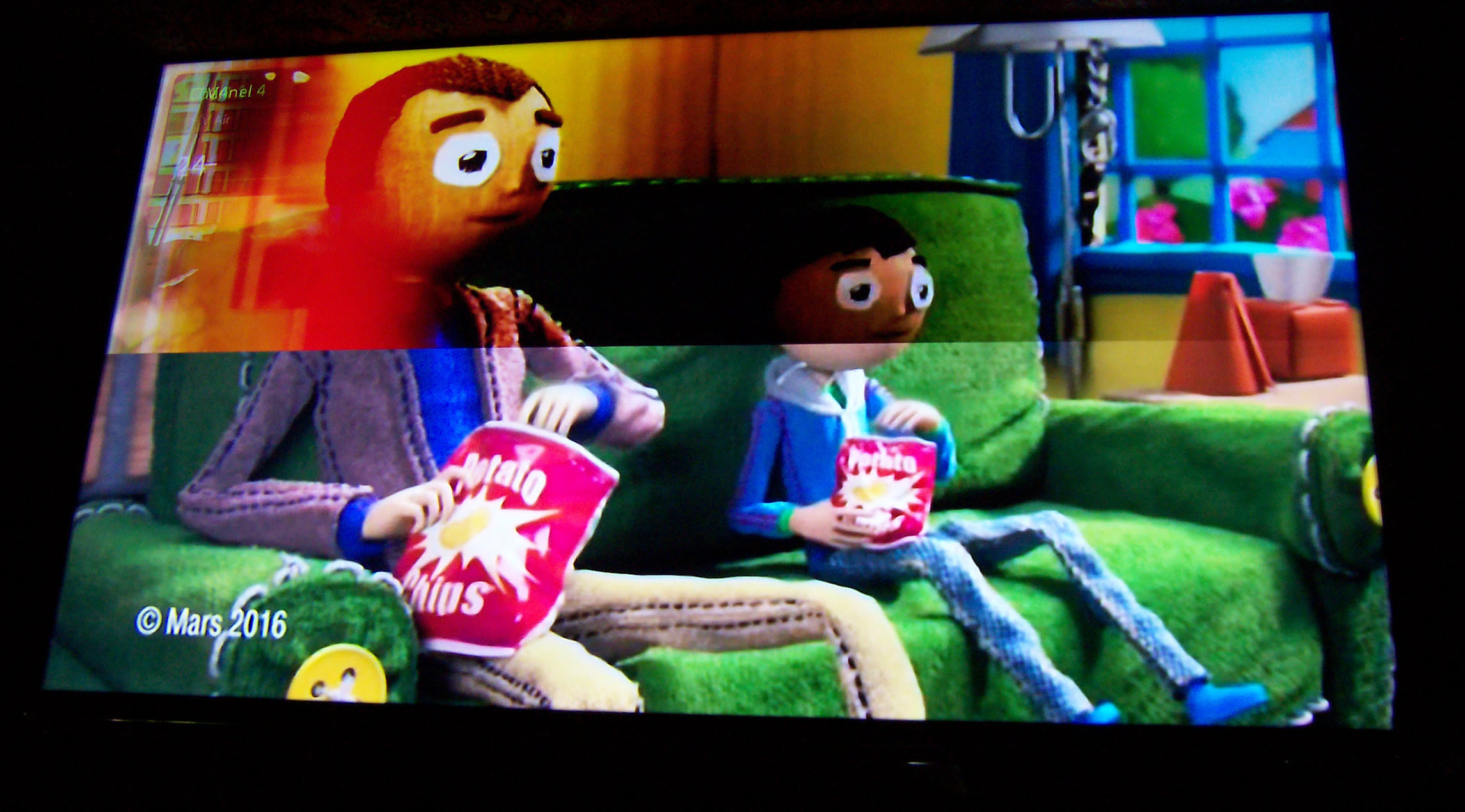

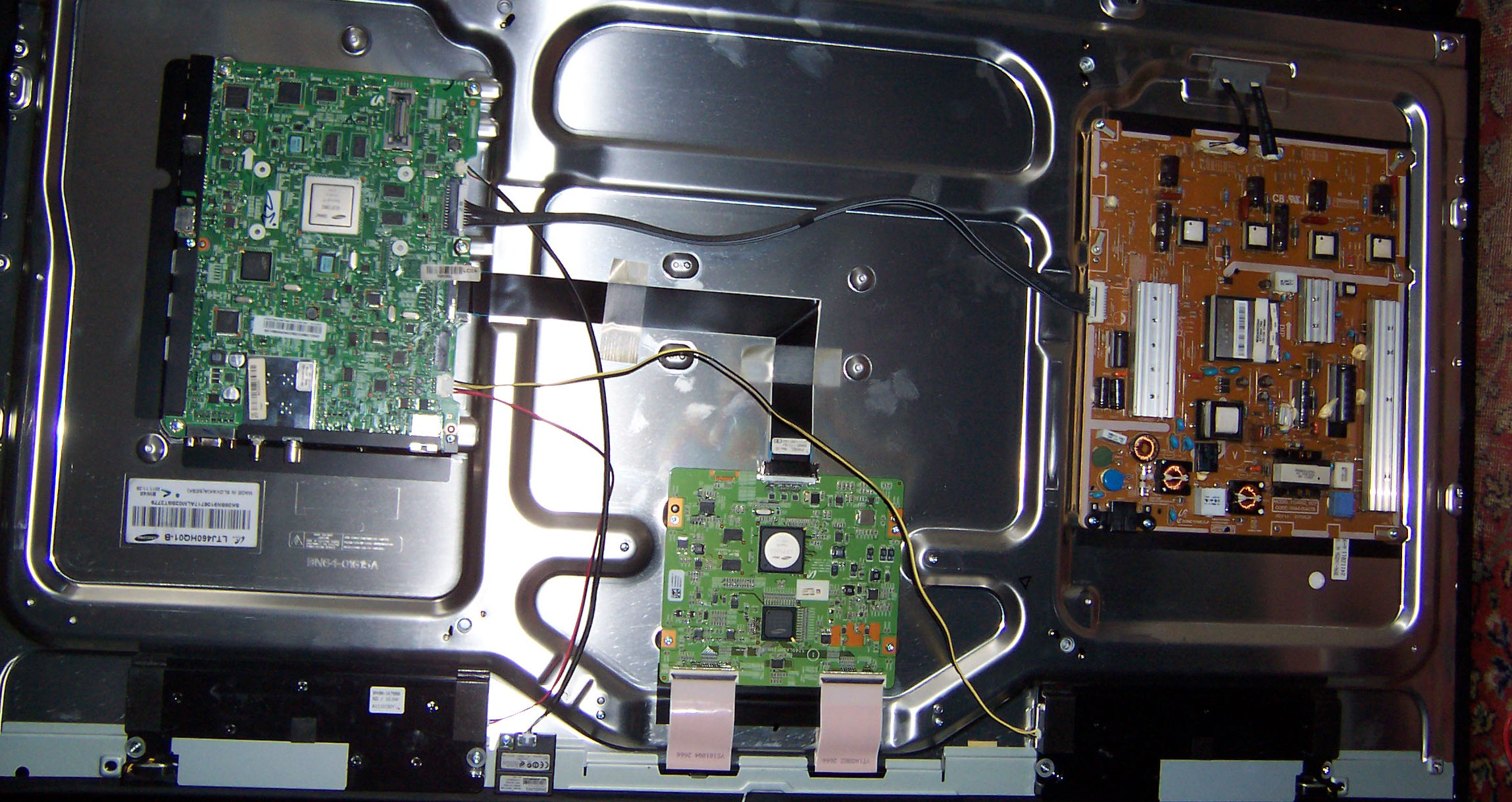

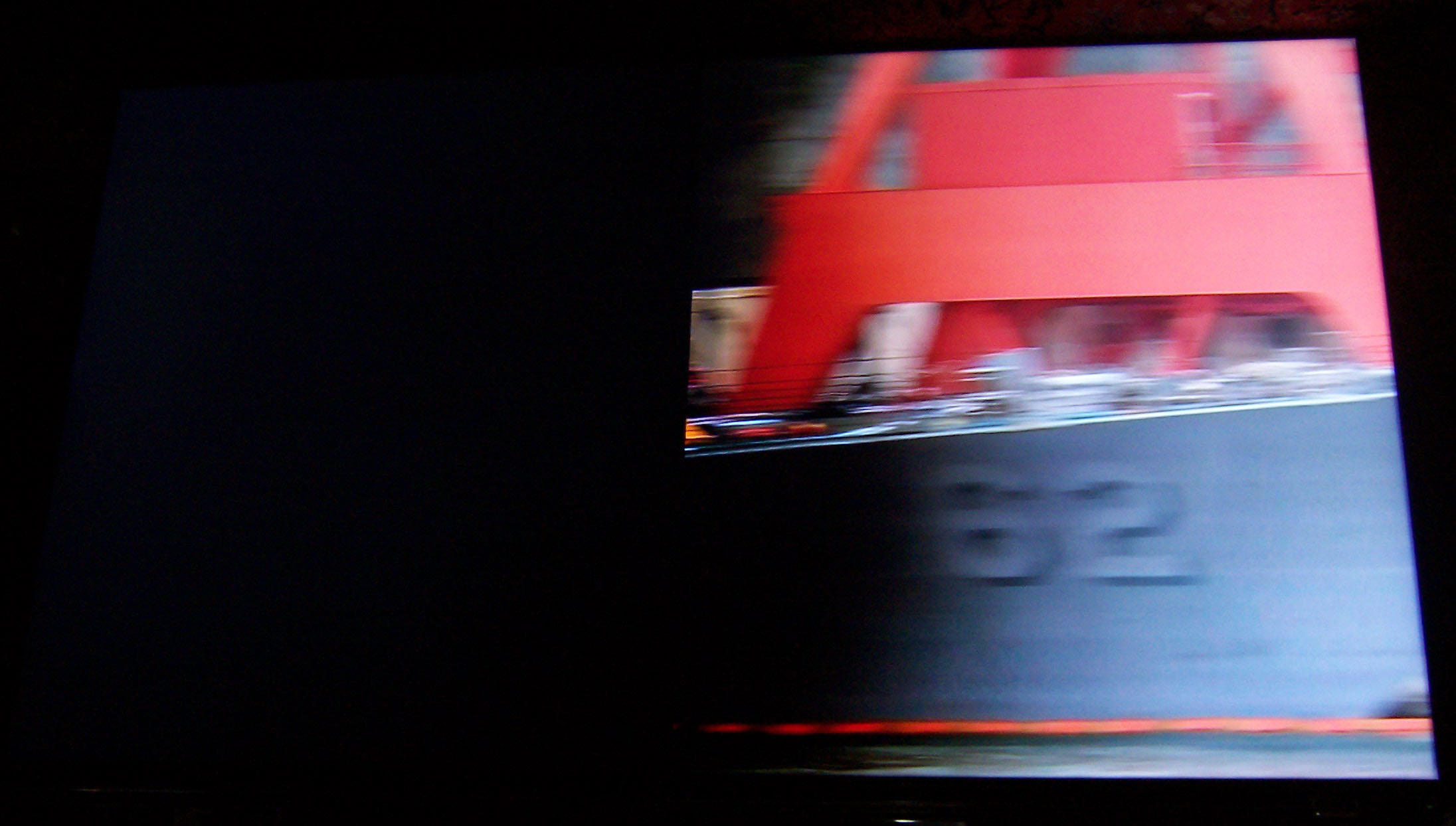

    I have a Samsung UE46D7000 (Panel: LTJ460HQ01-B, t-con: S240LABMB3V0.7) with the display problem exhibited in the attached photographs (both sides of t-con connected, and each side connected seperately - failure in left upper quadrant)
    It sounds like panel failures are common on this model, but I was hoping someone could confirm definitively whether this is panel or t-con?
    Thanks in advance.

    Looks like panel
    Tab bonds.. maybe workable fix
    If not bad panel.
      Re: Samsung UE46D7000 - panel or t-con?
      Bad panel.

            Bad panel...don't waste any more time on this set, sorry......
              Thanks, all.
              I haven't had any success with tab-bonds but a 46" is worth another try. It's the biggest panel I've had to deal with - it may not survive...
                be sure that over heat in Tcon (like AS15 )
                if there are 2 connexions to panel, eliminate 1 by 1 and see if problem persist
