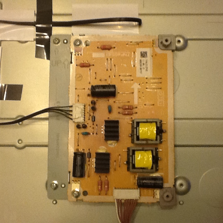

    Hello, does anyone have a service manuel for this tv, I have a solid green light, but the picture is flashing, first flash is a bright flash, then a slightly dimmer flash, then a slightly dimmer flash again, then back to a bright flash.

    Couple of pictures

      Re: Panasonic TXL50B6B flashing picture
      Check this.
      http://www.ebay.co.uk/itm/Panasonic-...-/263097823983
      The parts in the repair kit are referenced in this thread. https://www.badcaps.net/forum/showthread.php?t=51587
        I'm having trouble finding those transistors on mine, also my serial number is later than what there saying the cure is for. Il have to have another look tomorrow, my eyes are going blurry
          The inverter board looks slightly brown in places near the two heat sinks,,hmm
            Found them, might be worth a try
              Cheap and easy as long as none of the LEDs have failed but you won't know until you fit them.
              The thread mentions the serial numbers but the ebay ad doesn't. Perhaps it was discovered it covered more ?
              Worth a punt at a fiver I reckon especially if showing signs of warm there.
                I think your right there, il get a kit and see what occurs
                  Any updates ?
                  What are your voltages on Pin 2=BL_ON and Pin3=BL_SOS on LD1?
