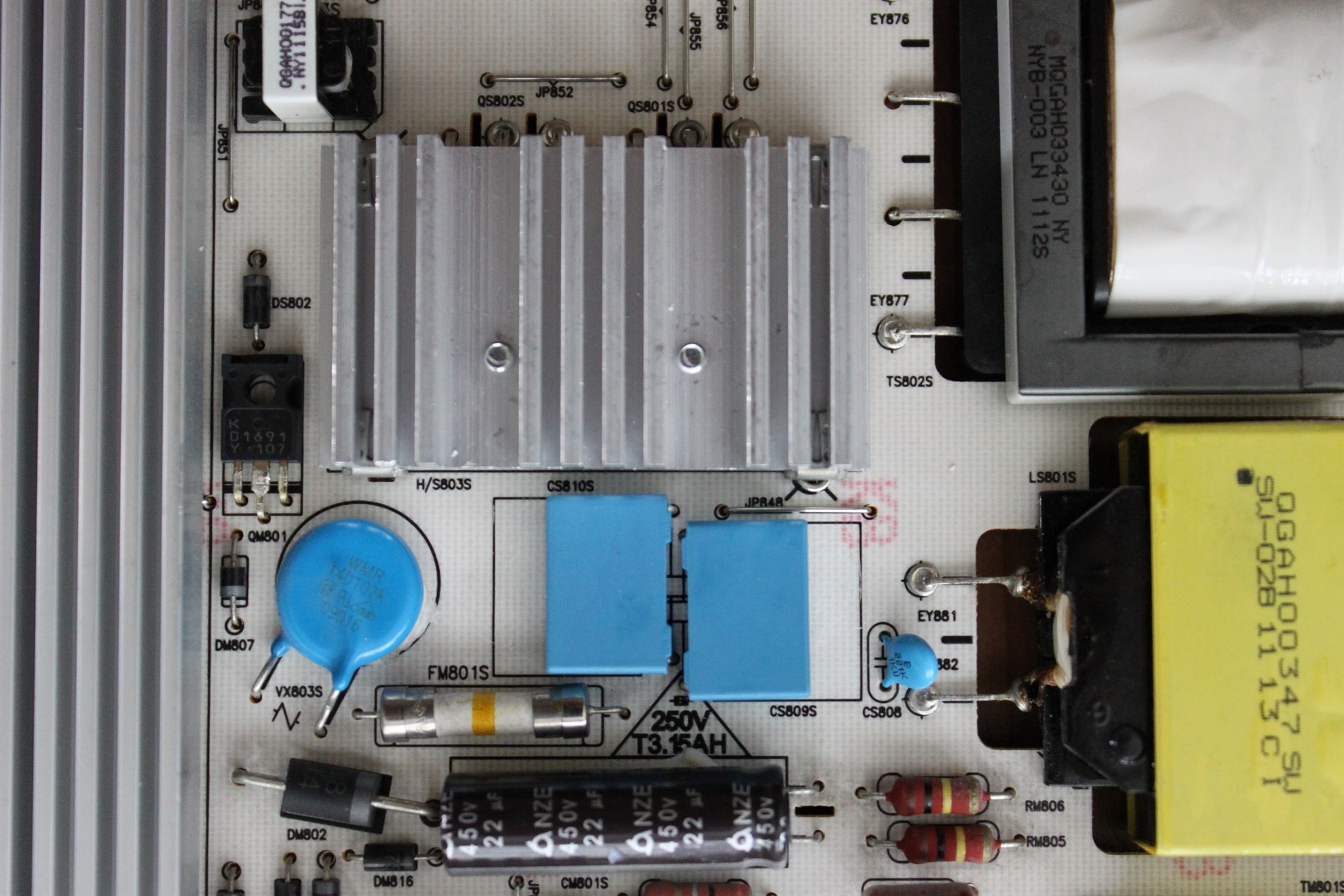

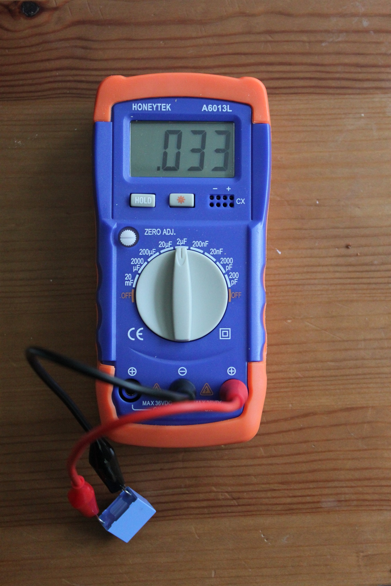

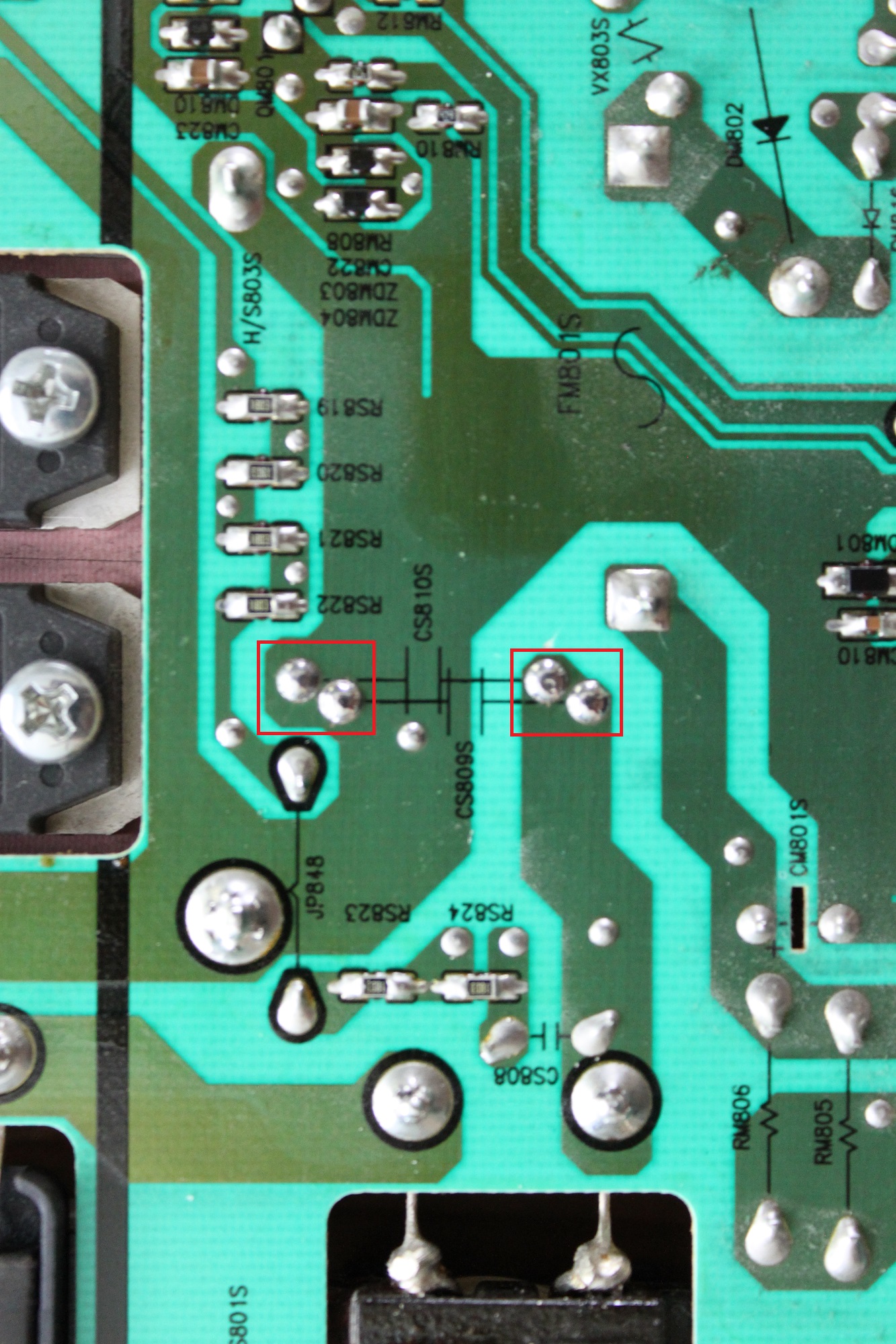

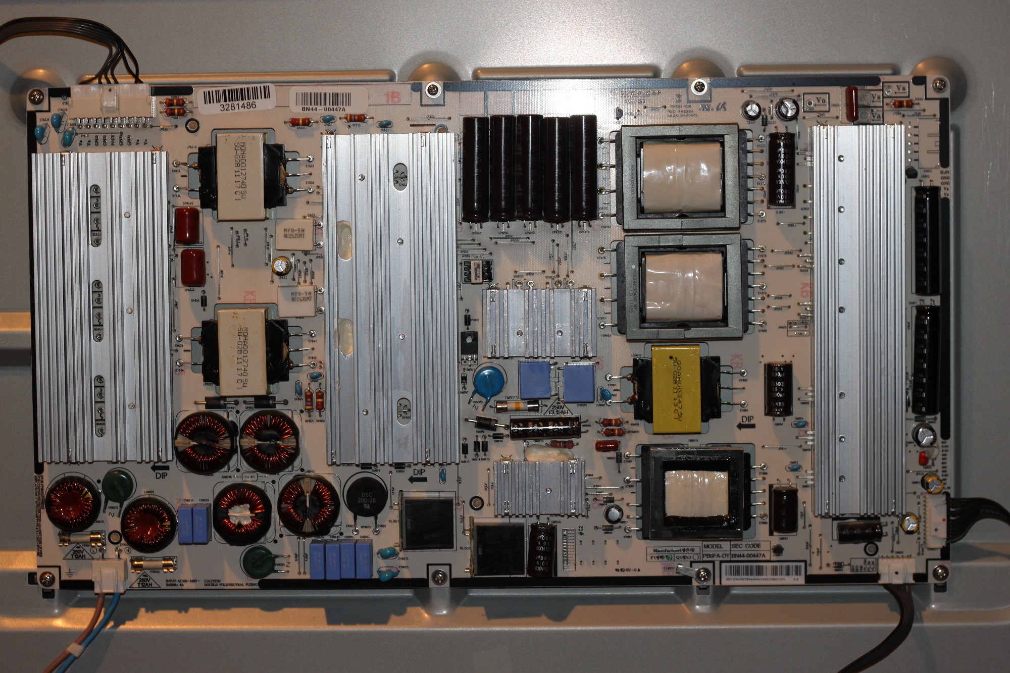

    So I soldered in the new capacitors. There is no change in behavior of the unit. Vs still does not come up when plugging in the television.
    I also tested the capacitors I removed from the TV. They both seemed to be within specifications of 0.033 μF.
    Is there anything else you recommend I try before I send the board out to PTS electronics?
    Thank You.

      #42
      Re: Samsung Plasma PN64D7000 Flashing Red LED No Power
      Unfortunately not without doing comprehensive diagnosis of the circuit.
      I hope PTS can fix it, try seeing what they have replaced.

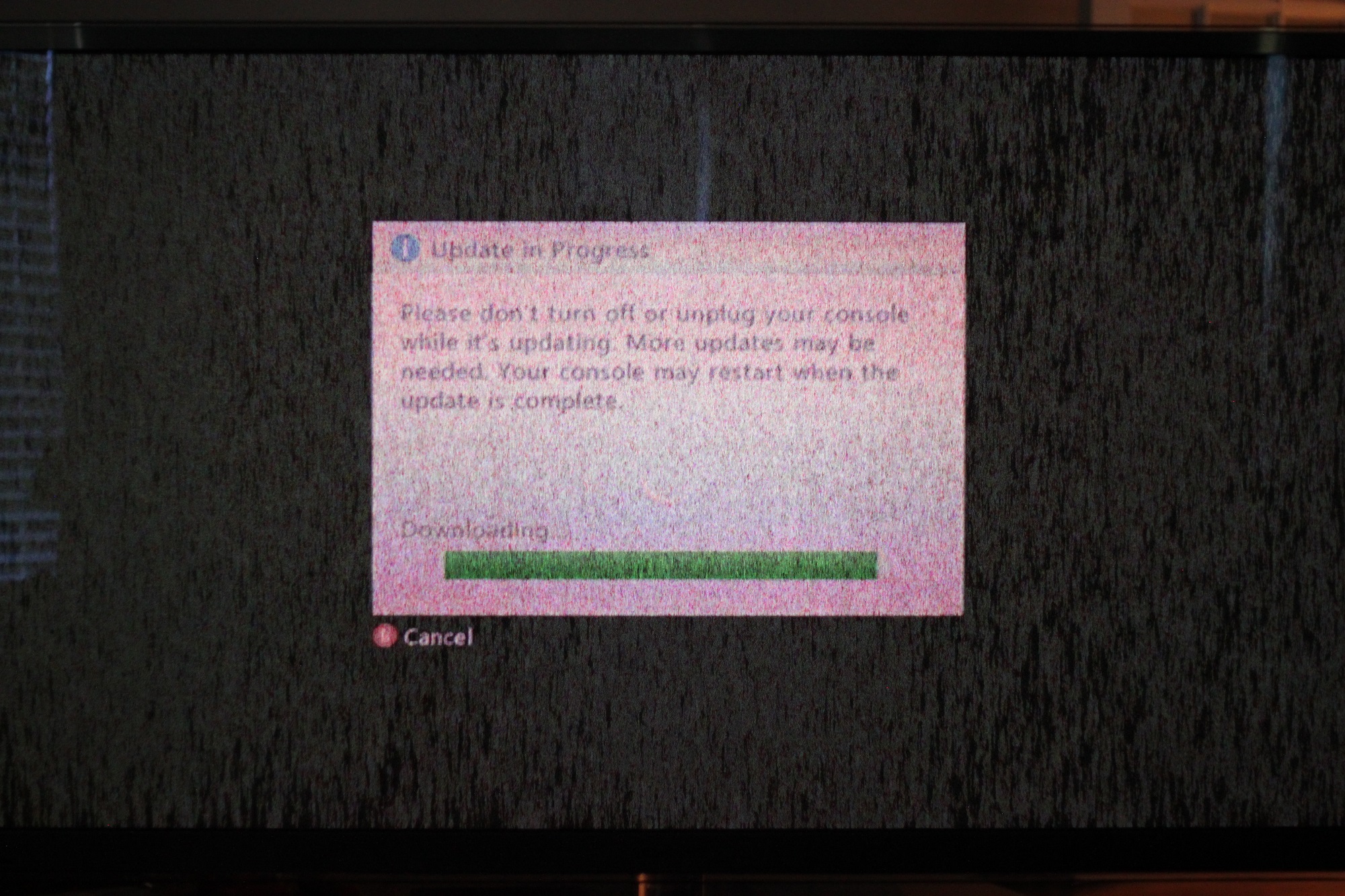

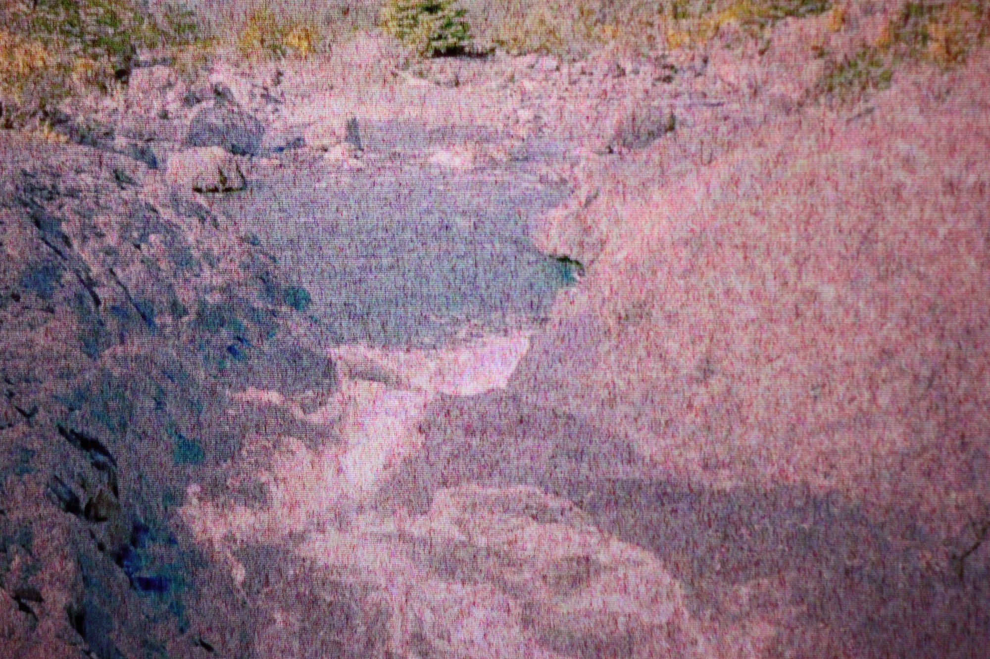

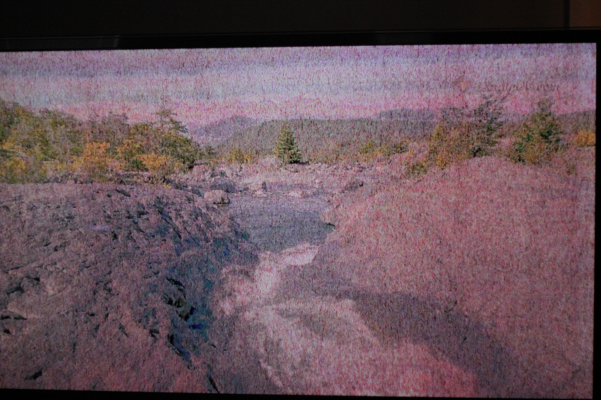

          So it has been awhile since I've posted an update. I finally received the PSU back from PTS. They didn't include any information as to what they fixed. I have gone ahead and sent them a message asking for specifics. As soon as I receive a response, I'll post it here. I've attached a photo of the board now. The only thing i can differentiate is the stickers they have attached at the top left. Other than that, I can't tell what they have done.
          Now, after installing the repaired PSU, I am seeing voltages coming back. However, the screen is now snowy, slightly purple, and very dim. I went ahead and disconnected and reconnected all the ribbon and power cables to make sure that everything is seated properly. I've also run the logic board test pattern, and it shows the same purple hue with snowy pattern.
          These are the current voltages I am reading:
          Vs: is 214V s/b 217V
          Va: is 52V s/b 55V
          Ve: is 91V s/b 91V
          Vsc: is -193V s/b -197V
          I adjusted the potentiometers as far as I could. The ones for Vs and Va cannot be adjusted up any higher than they are now. The same goes for Vsc. The only one within range is Ve. I'm not sure if a few volts would cause the picture to be bad as it is.
          I'll get on the phone with PTS this week and see if they have any feedback on not being able to meet the VS and Va voltages. If anyone has any suggestions in the meantime, please let me know. Thanks.
            #45
            Ah, now that is an X-main issue. Vs down a few volts unlikely to cause major issues, though worth investigating with PTS.
            Jesus, something did a number on your set...!
            Check power and data lines to X-main are fully connected; check all the FPCs are installed; check all screws are secure.

                  Flat printed connectors (so-called because they are basically flexible printed circuit boards, which are made similarly to a rigid circuit board but without the rigid bit in the middle ). EDIT: Vince beat me to it. Make sure all of them are seated in place (should be from 2 to 6 of them.) These are on the X-main side. Don't fiddle with the Y-buffer ones; they're a pain to reseat, so only touch them if you really need to .
                  As for the fault, it's very very unlikely for a cascading failure to occur in such a manner on a plasma or LCD TV. You occasionally hear of an X-main damaging a Y-main or a Y-main damaging the buffers, but it's pretty rare for that to go beyond those parts. I have no idea what went wrong, but it was catastrophic, however it happened.
                  The good news is, since you can see a dim picture, it confirms:
                  - Power supply
                  - Most of Y-main and Y-buffers
                  - Control board (probably*)
                  - Main board
                  are all working in good order. You are seeing "underdiffusion" right now where the panel is only getting half of its rated sustain voltage because the X-main is missing or not driving the panel properly.
                  *there is a small, very small chance that the control board could fail in such a manner that it could fail to generate correct X-main signals, but I have only ever seen this failure once and it was due to physical damage to the control board.

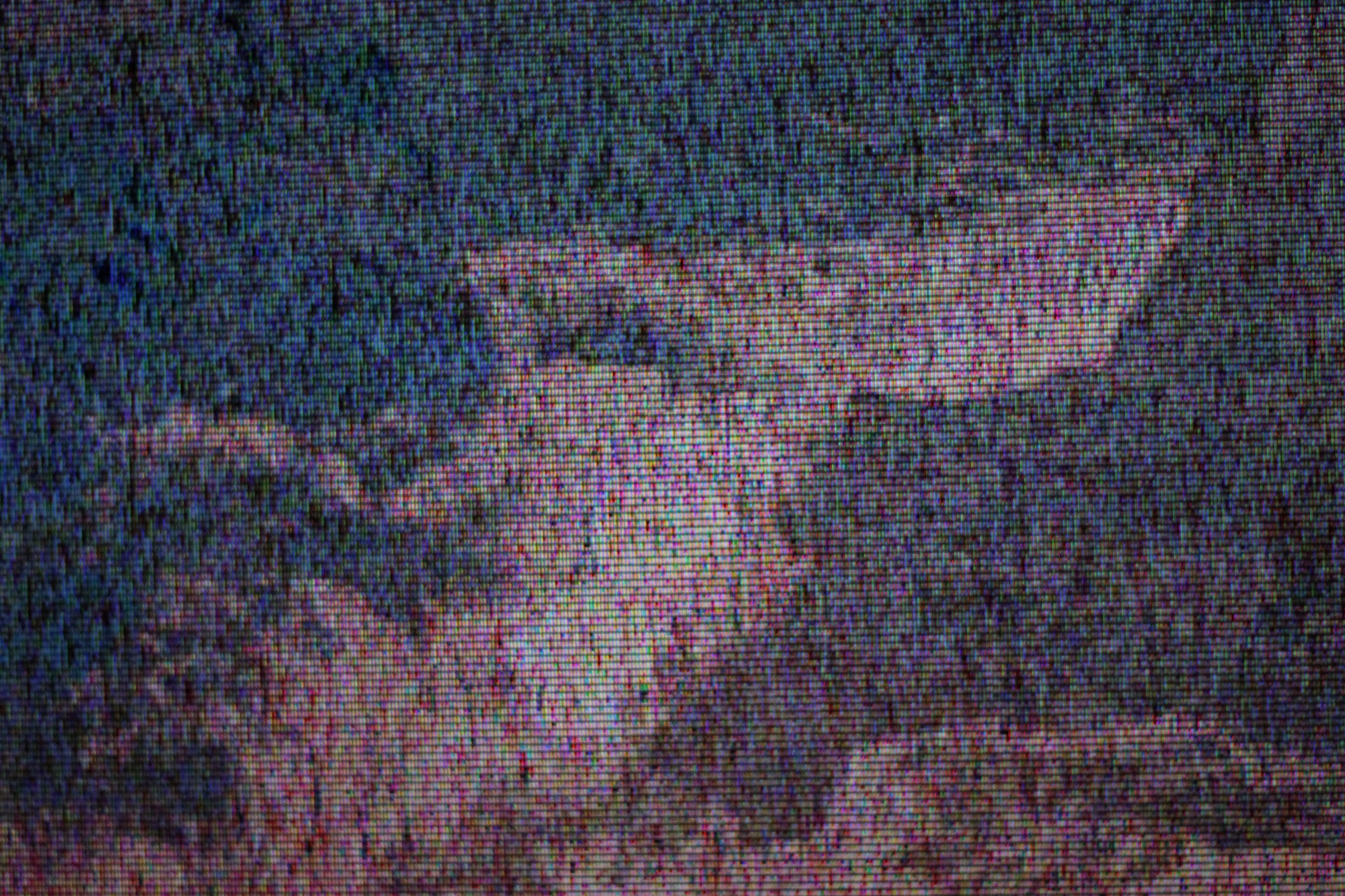

                    So I swapped out the X-main board. The picture still looks the same. I've checked all the connections, and they seem fine.
                    Is the green LED on the logic board supposed to blink when the set is on?
                    I received a response from PTS. It is a bit cryptic. This is what they said:
                    Your board was repaired it failed for power issues. Due to cold solder joints. Thank you and have a great day.
                    The grammar isn't exactly clear.
                    I'm just about ready to throw in the towel on this thing.
                    It's looking like a OLED purchase may be in my future.
                      #50
                      Ah I really hope you don't give up. We are really close! OLED is a nice image, but they burn in really quick. The local Costco has OLED screens with burn in from the channel logos. A shame at the price they cost.
                      I think they meant to say your set had cold solder joints on some of the transistors. Rare failure. Will have to look at your pictures and check it out for myself, because I didn't see any when I first looked, though it can be hard. If you post a picture of the X-main, I'll highlight some test points.
                      And yes, the LED on the control board should blink approx once a second. (It blinks every 32 frames, with 60Hz image then it's about once a second. 50Hz it's longer, and so on.)

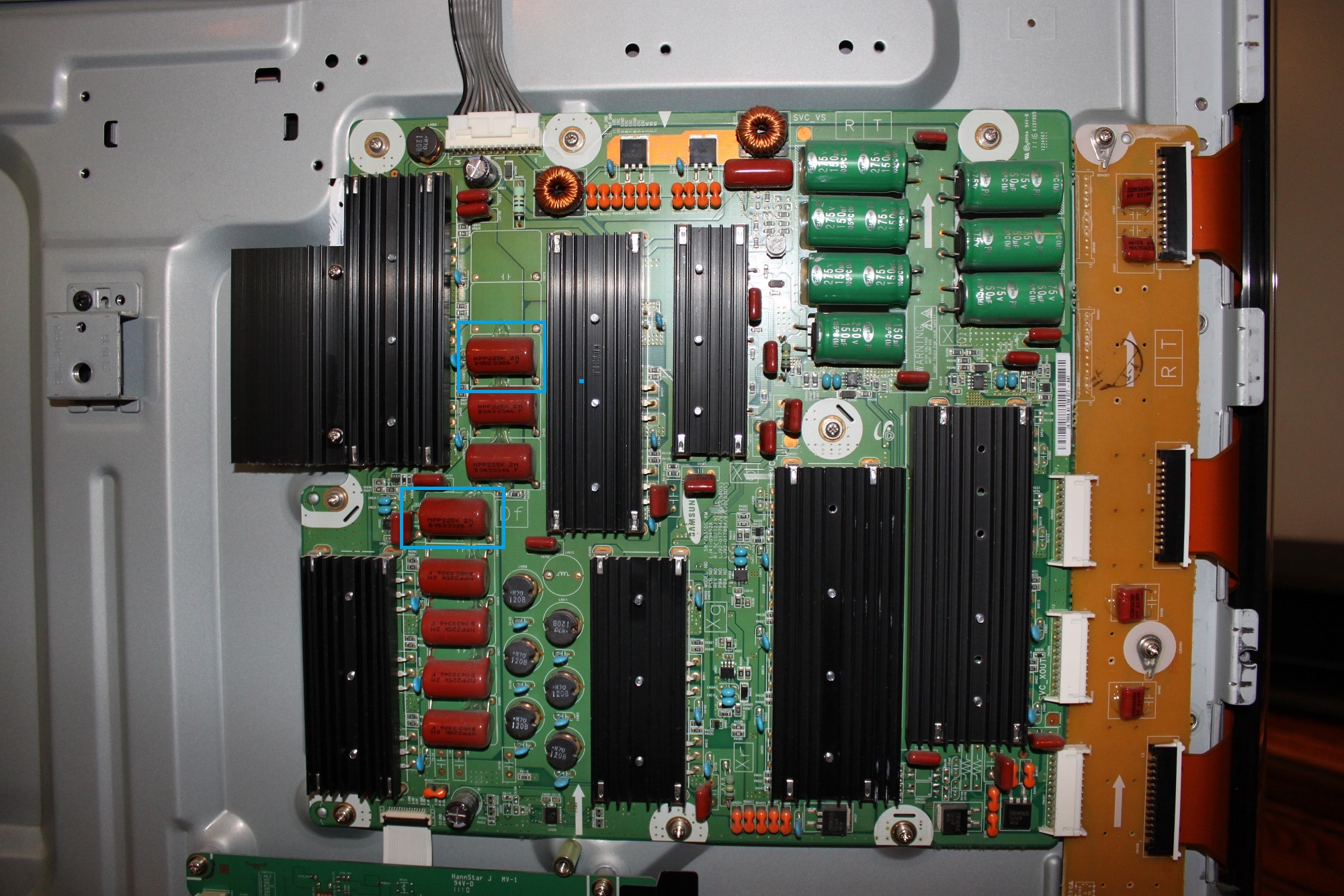

                        I'll keep trying if you have any ideas left! There is a picture of the X-sus on the first post when I started this thread. The camera flash is hiding the Ve test point, but the rest of the board looks pretty clear. Let me know if you need a better photo.
                        I was at Costco the other day and saw the OLED. I didn't have much time to look at it. But it was nice from the brief glance I took at it. Next time I pop in, I'll make a closer observation and check out the burn in issue.
                        I should have stuck with Panasonic plasmas. My two 50" units never had an issue. I had to install a chip in the G10 to reset the hours counter so it didn't keep raising the power level and killing the blacks. Other than that, never any problems. I also bought a S30 for the guest room, and it's going great.

                          Try checking the Ve and Vs test points on the X-main; also check the voltage across both blue highlighted caps on the X-main (see attachment).

                            So I tested the voltages you asked for.
                            Ve = 91V
                            If the Vs you're looking for is the one at the top labeled SVC_Vs, I am seeing 215V.
                            As for the capacitors, I cannot get a consistent reading. The voltages bounce from 0V-40V. I even saw a number as high as 86V on the lower one. But that was extremely brief. If you have any suggestions as to what I should look for here and how to test, I could use the help.
                            I disconnected all the ribbon cables from the X-buffer and reconnected them. There was no change. I even tried booting up the unit with the X-buffer ribbon cables disconnected, and I still got the same picture.
                              #54
                              Yeah, keep looking myself for a 55" VT50 or similar set for my living room; saw a GT30B but didn't want to go down in performance: the ST50B's blacks are fucking good, especially when you consider it was only the mid-range set. "Gravity" on this TV looks amazing. Then again, the U30B in my bedroom ain't no slacker either.
                              Ve looks about right...a little on the low side but Samsung have often been found using low Ve voltage (X-bias initialisation voltage.)
                              So, there should be a similar bank of caps on the Y-main, can you check those? The voltage is definitely not right. It should be steady at about half the Vs voltage for most pictures on the screen. I'd expect, since your Y-main seems to be working, to see the steady ERC voltage there.
                              Do you have access to an oscilloscope, or know someone who does? It might be worth seeing if you can borrow one. Plasma TV repair is difficult without one.

                                I checked the capacitors on the Y-main. The ones at the top are a steady 215V, I forgot what the lower ones are. My notes are back at home. However, they were at a steady voltage, not varying. It seems the Y-main is functioning as it should be.
                                I'll ask around and see if I can find someone with an oscilloscope. It's not a tool most people typically have around. Out of curiosity, what would I be checking with the oscilloscope?
