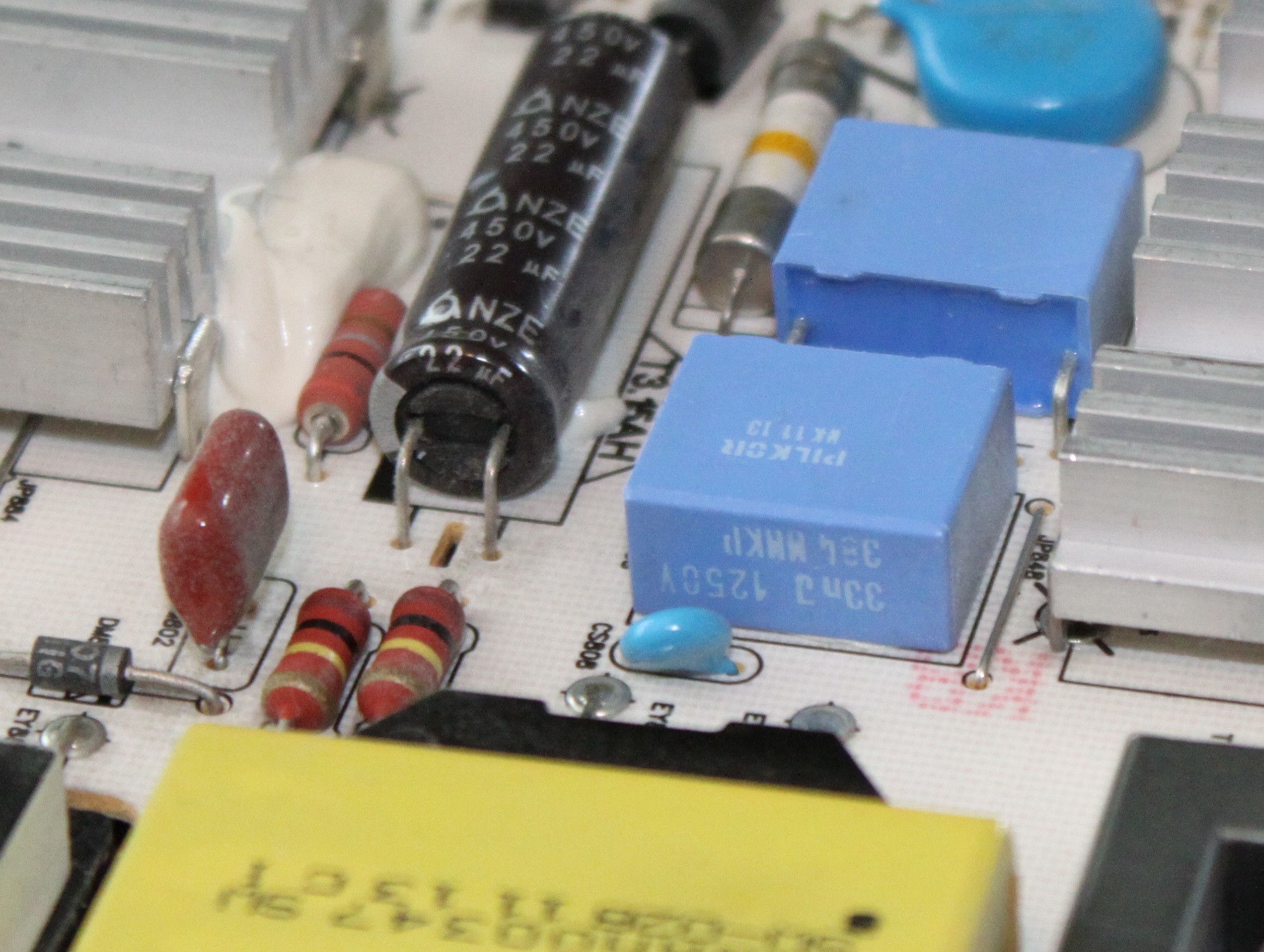

                            It *may* be worth exchanging the two blue caps in the centre of the power board - the ones that are rectangular. These can fail and cause this type of symptom. It's vital you use the right type of capacitor so if you want to go this route, get me a pic of the capacitors and the dimensions (width, height, spacing between pins) and I'll look for a suitable replacement.
                              Unfortunately, I do not have an oscilloscope. I'll ask around and see if any of my friends may have one, but I have my doubts about it.
                              The capacitors are 14.3mm wide x 17.5mm long x 8.5mm deep. The spacing between the pins is 15.0mm. I've attached photos of the capacitors.
                              I do have a capacitance tester. Is it worth removing them to test? My only concern is getting them in and out without damage. I imagine I can snip their leads off and solder them back on there. This way I'm not fighting to keep solder hot at two locations on the board to try and get them out. Also, it appears they are marked as 33nJ. Why would it be in Joules instead of Farads?
                              I am wondering since my PSU board is suspect, is it worth just sending off to PTS electronics? It looks like they have a repair and return option for $68. That seems like a pretty reasonable price. This is the link to their site: http://www.ptselectronicsinc.com/bn44-00447a/ .
                              And since I have a Y-sus on the way, should I swap it out and try anyway? Or just leave it be and return it.

                                Up to you if you want to try and repair it or send it off. For that type of capacitor I'd suggest removing it completely rather than snipping leads. They can be desoldered by alternating the soldering iron between both pins while gently prising it off the other side. If there's any glue surrounding it (white blobs tacking it down), remove that first.
                                The "J" simply refers to the tolerance of the capacitor, J meaning 10%. They are 33nF capacitors. A joule rating would be meaningless as it would depend on the voltage across the capacitor. You can test the capacitors for capacitance, though ESR is not a useful measurement. They will be small in value.
                                As it is, your new Y-main will do nothing as your Vs is too low. There might be several faults on this TV if it was subject to power surge damage or something of that nature. So might be worth hanging onto that board for a bit before you return it, just in case.
                                  I guess I can give swapping the capacitors a shot and see what happens. If that doesn't fix it, I'll put the original ones back in and send it to PTS. I spent some time looking around for direct equivalents. I imagine I need to stick with the film capacitor. It seems Digi-Key has quite a few options, but only one is actually stocked. Everything else I saw has a lead time of weeks. Is this one an acceptable replacement?
                                  https://www.digikey.com/product-deta...132-ND/4157191
                                  The only issue I see is that the seated height of 18mm may be too high. From my measurements, I need to be around 14.3mm. When I bend the leads and install it laying flat, it might bump into the little blue ceramic capacitor behind. Even so, I can install and test the capacitor to see if indeed that was the problem.

                                    I would suggest this one. I think it should fit:
                                    https://www.digikey.com/product-deta...142-ND/5414292
                                    The Rubycon one might work, but it's a different type of capacitor and I'm not sure how it will perform. The capacitor is utilised as a coupling capacitor in a high-frequency, high-energy LLC resonant circuit. A lot of long words, but essentially means the capacitor needs to be rated for this type of operation (high pulse operation). LLC is used to reduce electromagnetic emissions, audible noise, and improve energy efficiency.
                                    Make sure the capacitor is clear from other components.

                                      Would it be an issue that the capacitor on the board is rated 1250V, and the one you suggested is rated for 1000V? This is the problem I run into. Anything larger than 1000V doesn't seem to be kept in stock.
                                        #39
                                        Re: Samsung Plasma PN64D7000 Flashing Red LED No Power
                                        Unlikely to be an issue. The board operates on 390V (the PFC voltage) plus there will be some transients due to the LLC switching edges not being perfect, but still well under the 1000V rating.
                                        At a guess, they used 1250V because it was the most economical price or was the only product available from a preferred vendor at the time.

                                          Transients, LLC switching edges. This is getting into a realm of Engineering I do not know very well. I'm a structural Engineer by training. This sparky stuff gets way over my head. I'd have to do some reading to really understand what it all does. Sometimes I think I'd like to go back and get a graduate degree in Electrical Engineering.
                                          Digikey seems to be pretty quick on shipping. Hopefully I receive the parts and install them by this weekend. If not, off to PTS electronics it goes.
