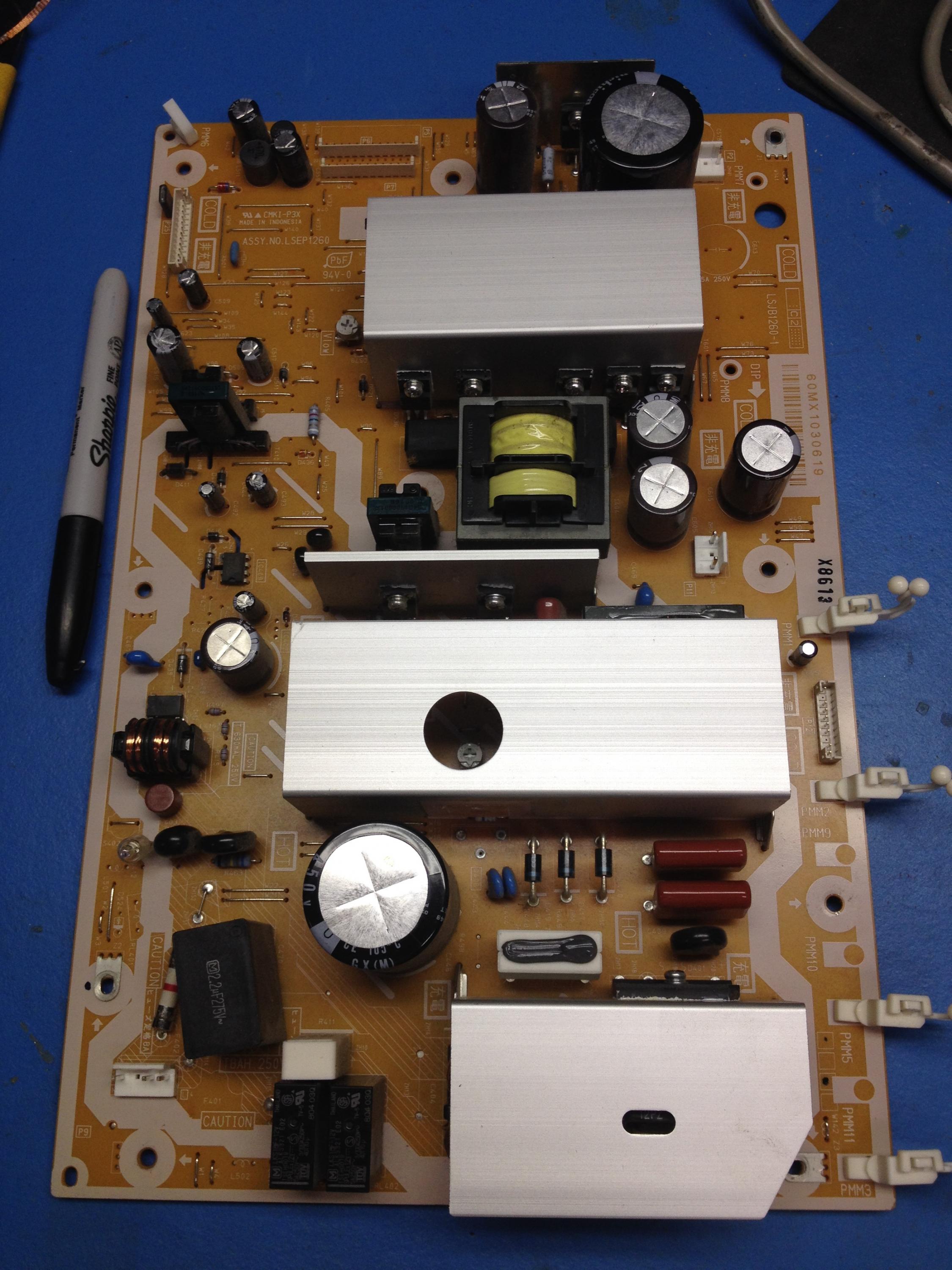

    Hello all - I'm looking for a set of schematics for for a LSJB1260-1 power supply board found in a Panasonic TH-50PX80U. .
    I searched for this particular board part number, and for the TV itself, but none of the results matched the power board that i have in hand. (See pic please). Looks like there are a couple of others that are also having problems finding the schematic.
    The board has no power, and the input fuses are blown. The FET (Q406) is shorted between the source and drain. I have parts on order, but I'd like to be able to check the rest of the board out before i power it up. I did find a Panasonic Tech note (TT-08-27) that shows the exact problem I see (slightly different power board, but the board is similar enough)
    Any leads on the schematic?

    Check link in my signature - I believe it's in the service manual for this model.
    Common fault with these is also the PFC diode is bad which causes that FET you mention to fail. Check that as well.
