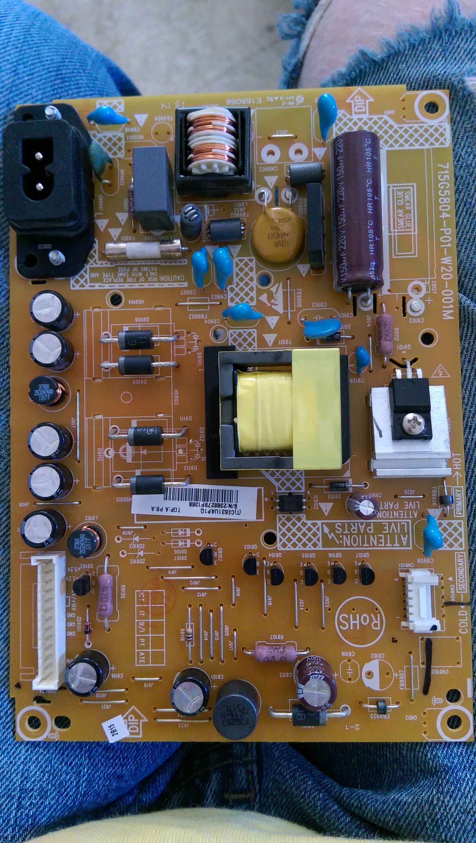

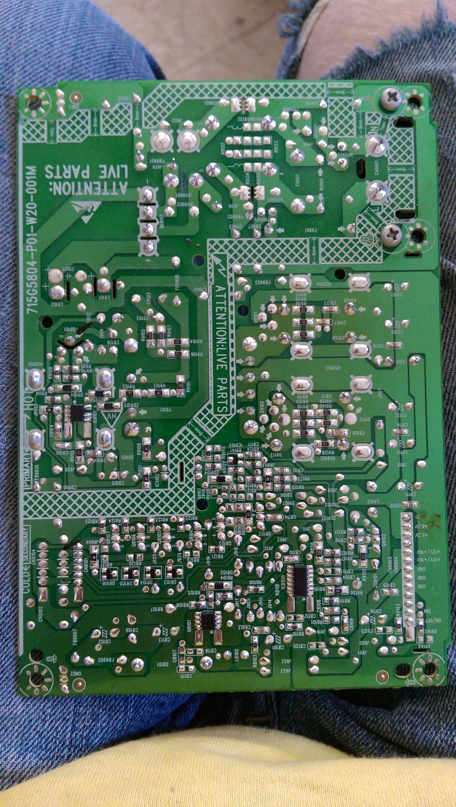

    My sister-in-law has had this TV for years. She says that after about 6-months the TV began shutting itself off at random. Until a week or two, ago when it would no longer power on. Pressing the power button causes the power light to come up for a few moments, but then the TV shuts back off. As it became gradually worse and worse, I'm hoping that it's as simple as replacing the caps. I've already ordered the capacitors, but I wanted to give you guys a look at the board in case there is anything you suggest I change. I will re-wet the solder joints, and I would like to re-position the large diodes so that they are as far apart from each other as possible.

    When you push power button what dcv do you get across terminals of your main cap? Upper right first pic.

      That reminds me, do any of you feel I should populate the empty spaces for electrolytics? I noticed it has space for a second primary cap, and one other 'lytic.

        Those empty spaces could be populated when the power supply is used for a different set. Leave unpopulated.

          My caps from Digi-Key have arrived.
          Will it put some sort of unnecessary strain on portions of the circuits to add extra filtering capacitors?
          For instance, C8113 near the bottom of the image is tied to the exact same traces as C8102. Both positives share the same trace as well as the ground trace. And obviously, the location for the second primary cap is tied to the same points as the first.
          Would it be bad to add these? On motherboards, people have always suggested populating empty areas.

            I agree with post 4

              Well, it still behaves the same after a recap. Time to bust out my meter, and test stuff out. I'll start with the previous suggestion, checking the voltage at the primary cap during turn-on.
              Any other suggestions are quite welcome.

                So did you also replace the cap in the primary side C9103?
                Since the power supply is an always on power supply, so you need to find out if ALL the output DC Voltages drop out or not when TV acts up.

                  I replaced C9101, the large primary cap, but not those little blue caps.

                    C9103 is small brown lytics cap right next to D9105.
