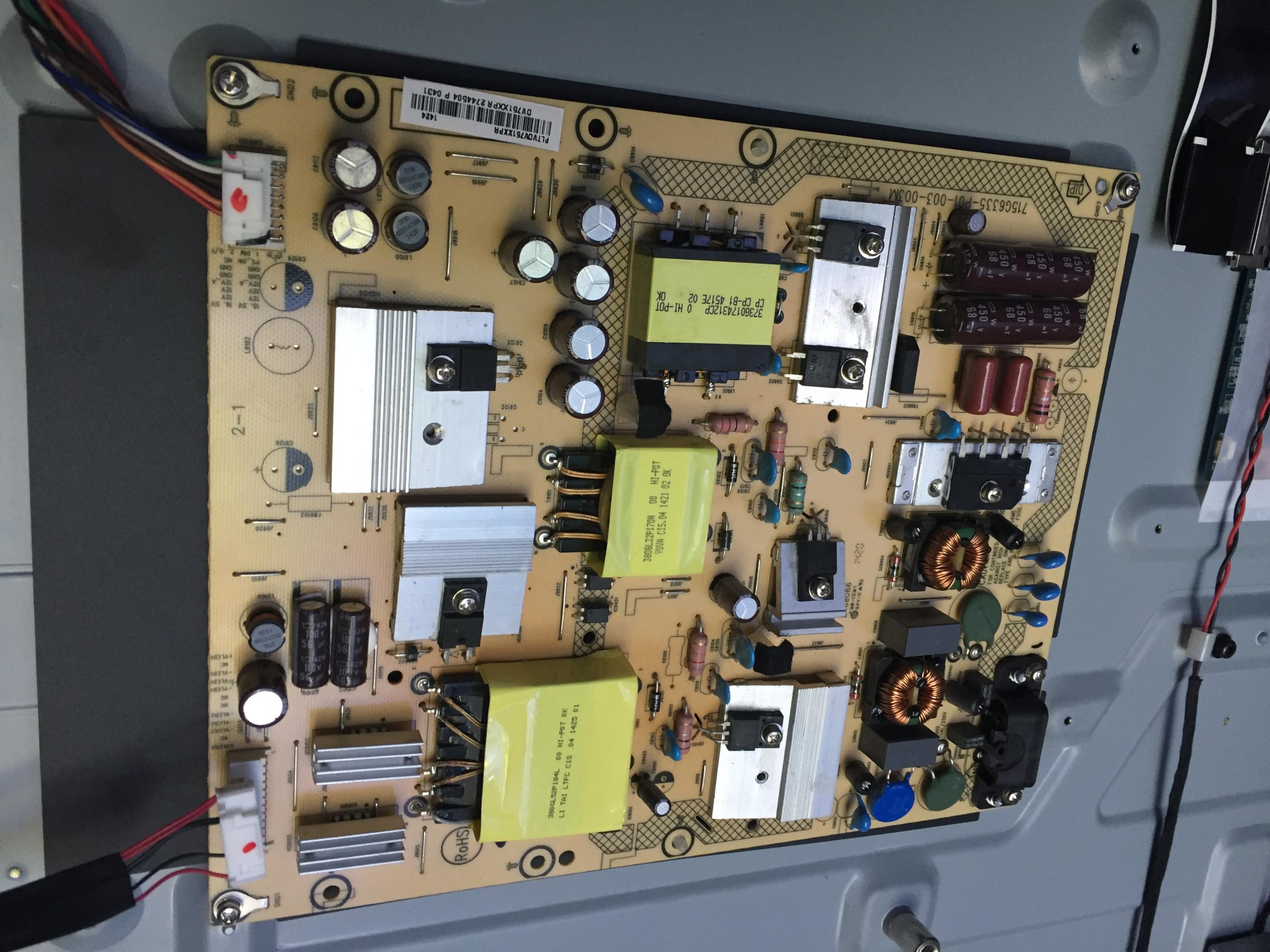

    Working upon my neighbors TV that has audio but no picture. I have performed the reset functions of holding down Input and Vol - while plugging in etc. No success
    I pulled the back off and checked upon the plug from the power supply to the main board - 715G6840-M0D-000-0041
    Power board - 715G6335-P01-003-003M
    I am getting over 12 volts - about 19 - 19.5 volts with the main board plugged in and 15.5 volts with the main board unplugged.
    The LED back light does not come on but a faint picture is present. Replaced the T-Con board already since it is a generic $8 part.
    The backlight came on after replacing the T-Con board and then went off about 15 seconds later.

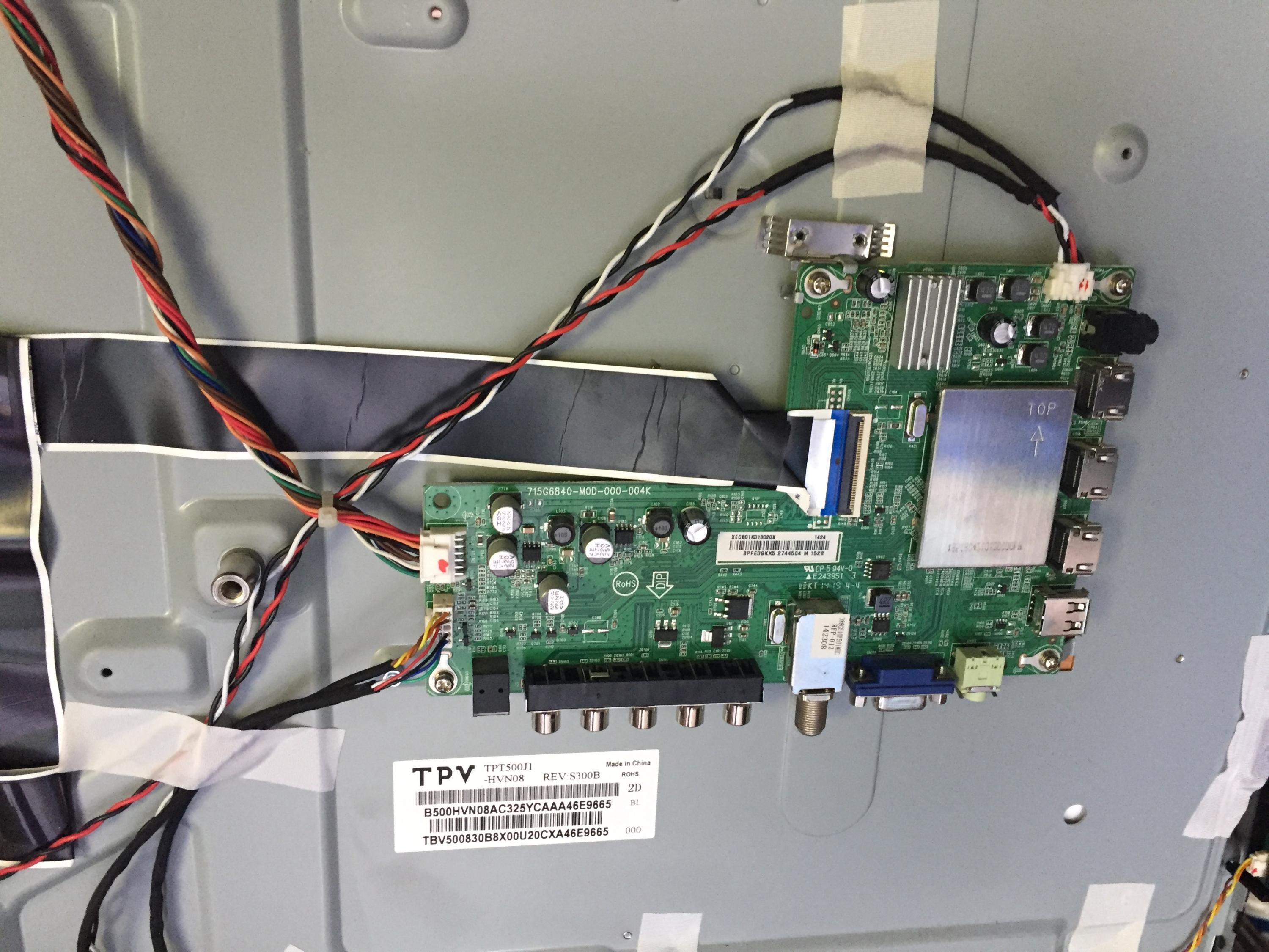

    Re: Sharp LC-50LB261U - has audio, no picture
    That power supply looked so familiar.. I have one (scrap/donor) looks just like it from one i repaired in the past.
    BUT it sounds to me like your having a backlight issue, is this a LED or CCFL type?
    It would help everyone here help you if you took pictures of the full back and then each board (like you did the power supply)
    Also on this power supply the voltages are clearly marked so it also would help
    if you read each on pin for pin and recorded it for us. One set with TV off but plugged in. Another with it turned on and audio on...

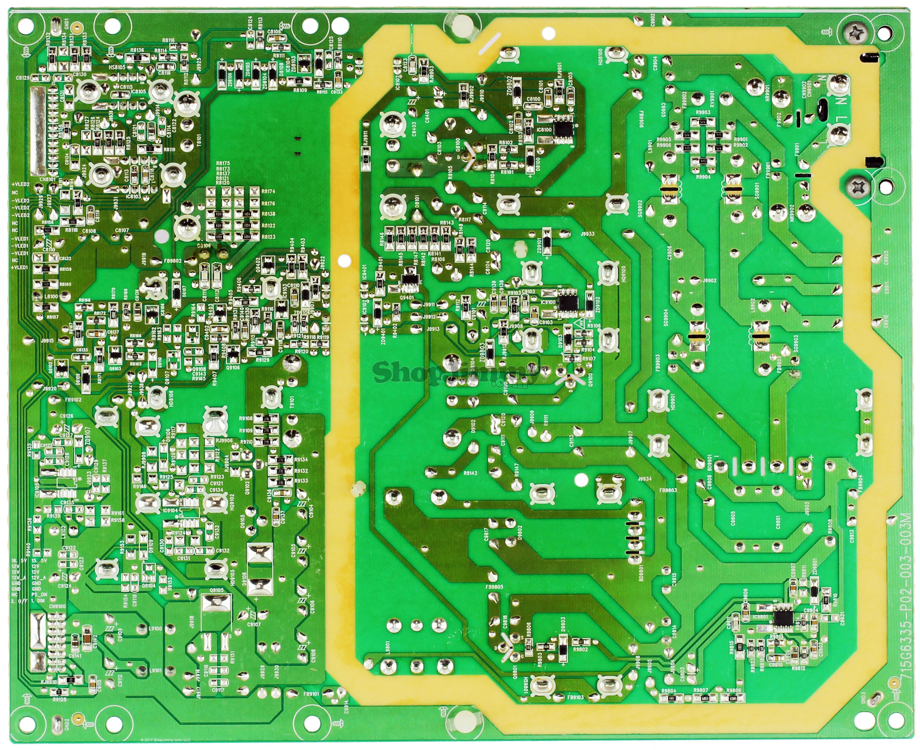

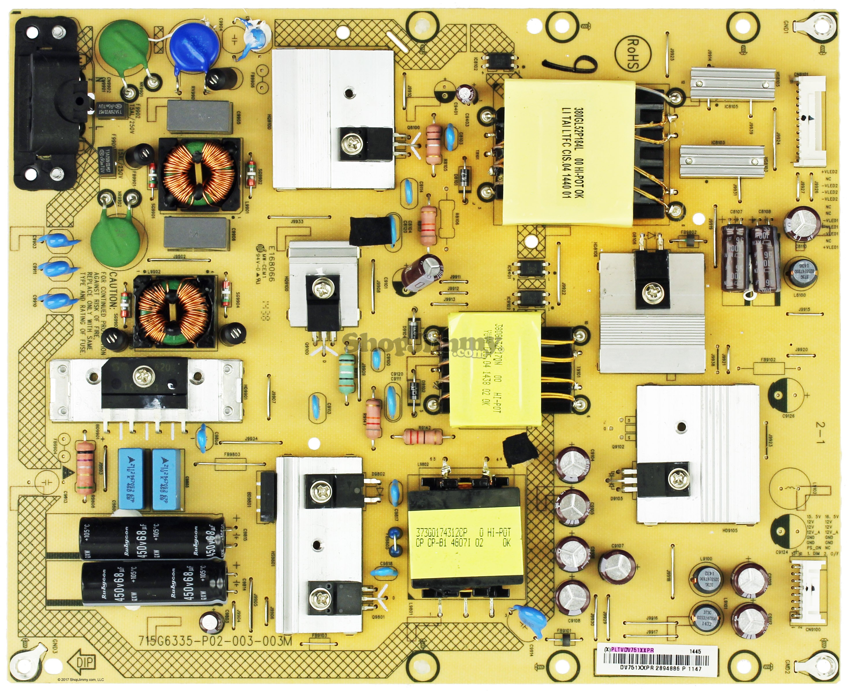

      Is the the exact match of your board?
      Sharp PLTVDV751XXPR Power Supply / LED Board for LC-50LB261U.
      Pictures provided by shopjimmy.
      http://www.shopjimmy.com/sharp-pltvd...-50lb261u.htm#
      You need to test the Voltages at those two connectors on the cold side of the circuit.
      Make sure to put pin names and follow by pin Voltage readings.

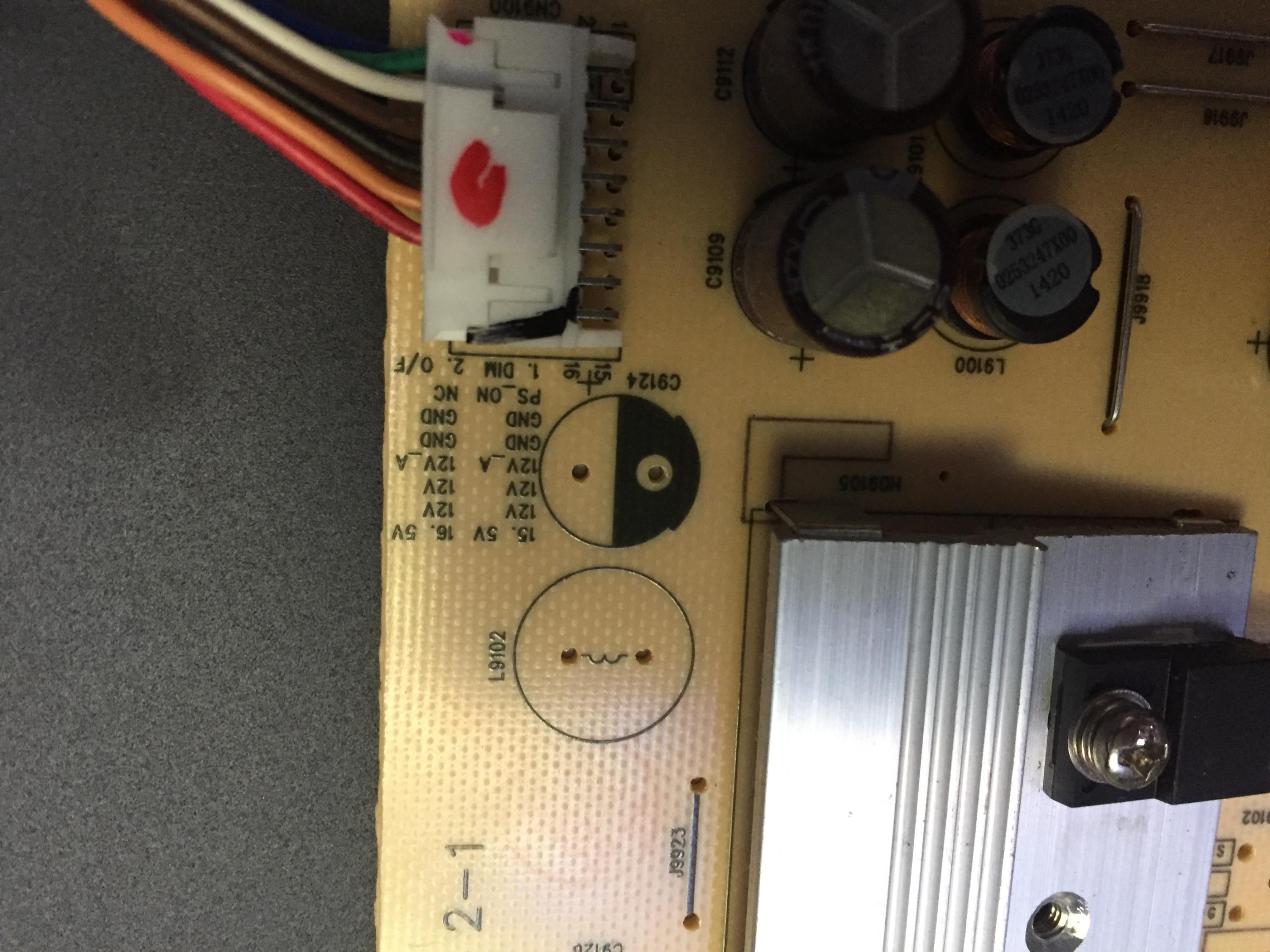

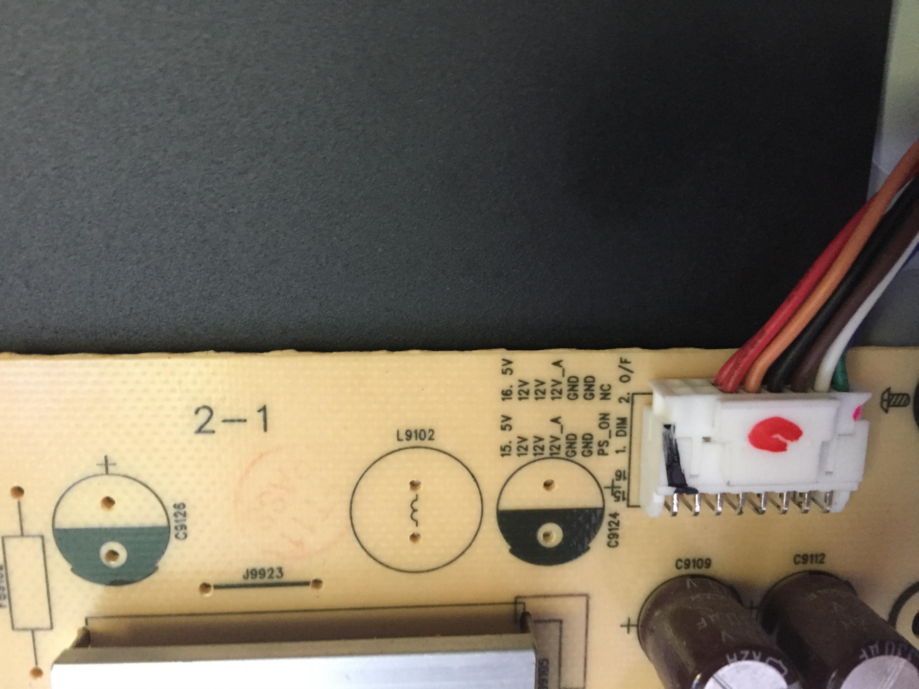

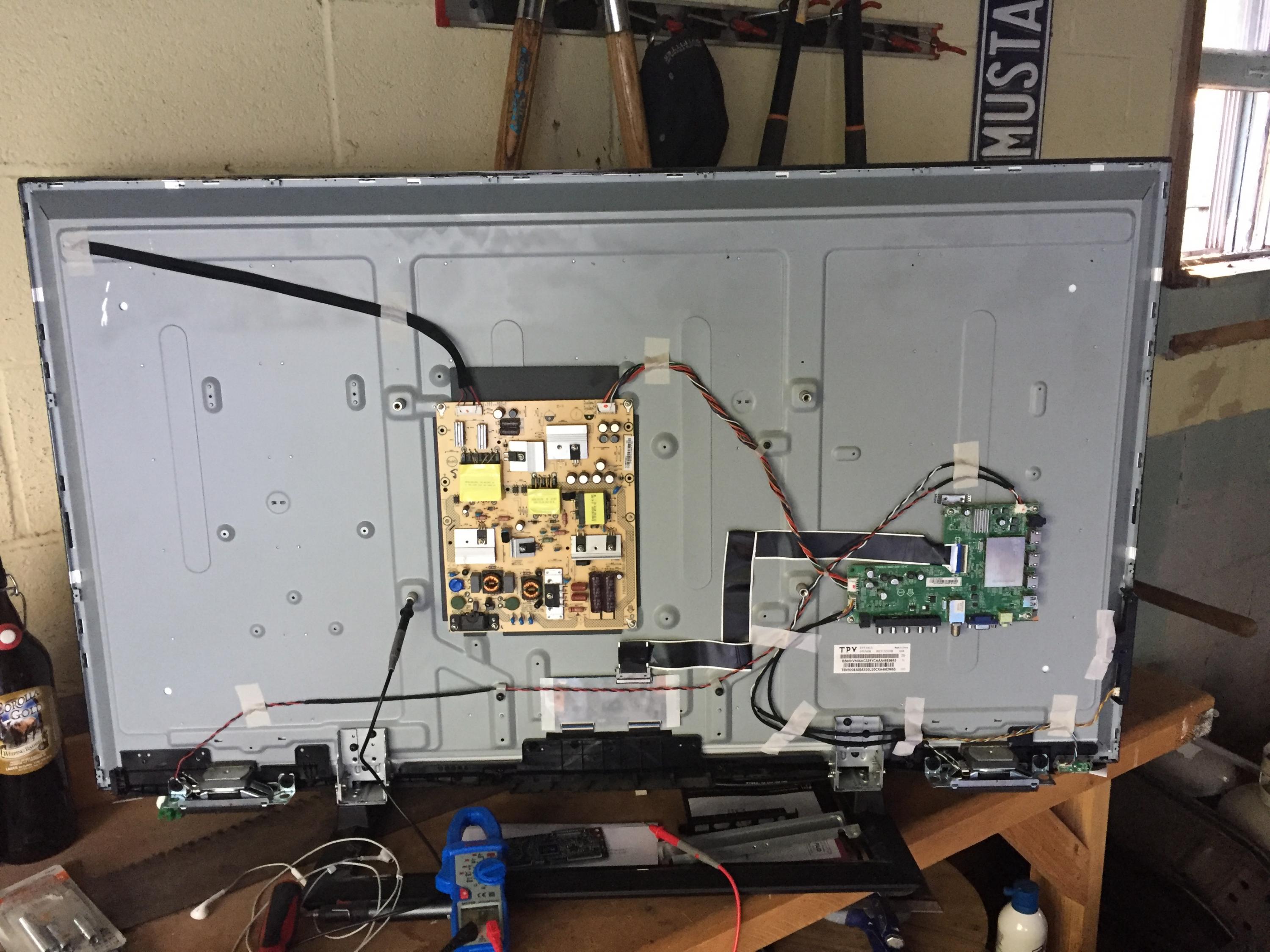

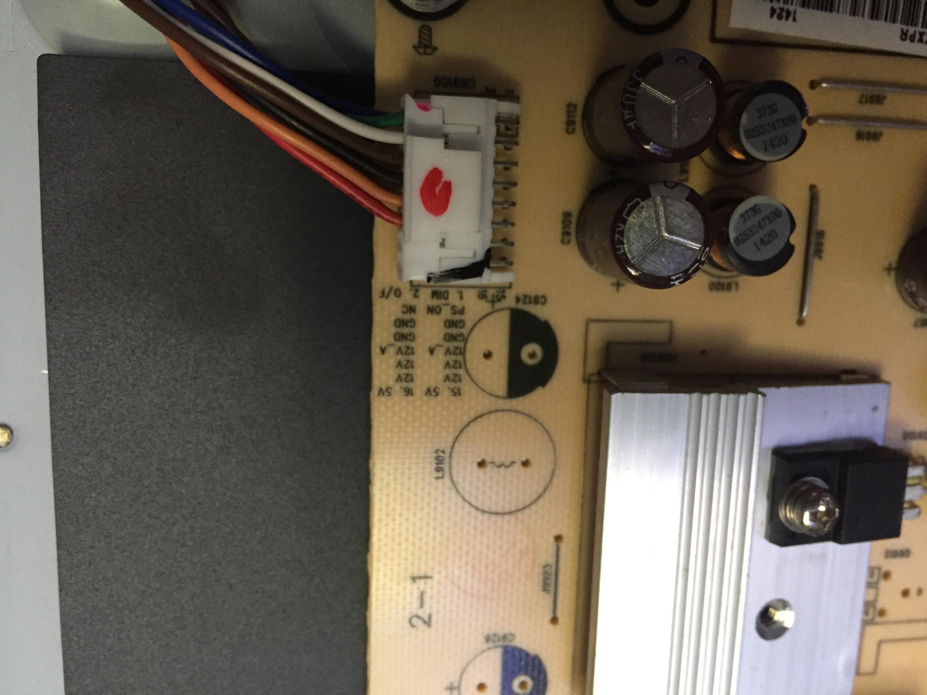

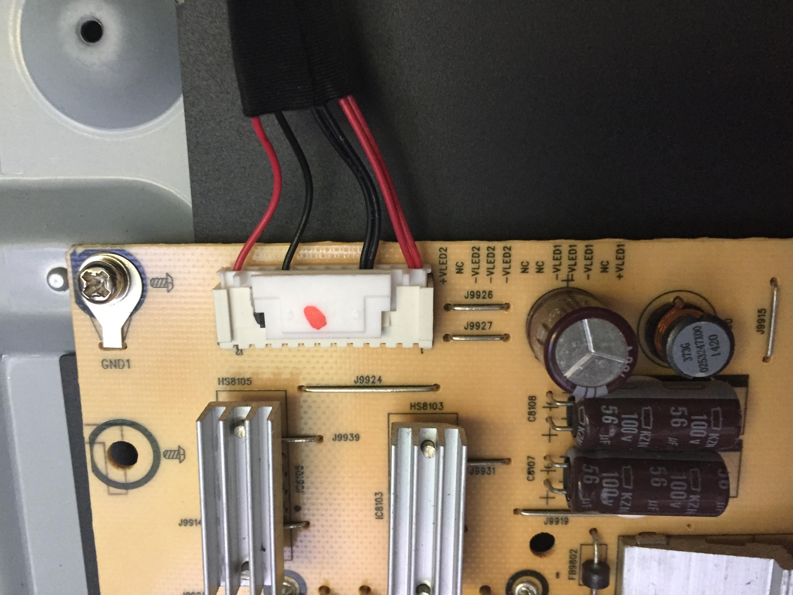

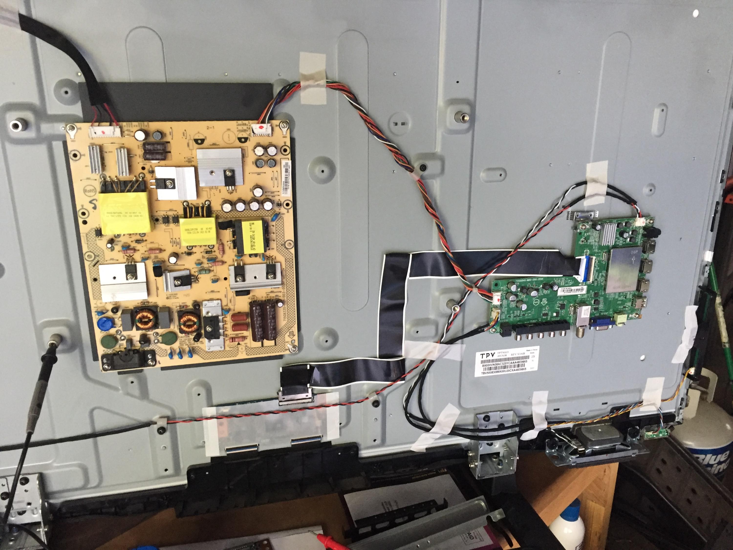

            Afternoon guys! Finally have had some time to tinker back with the television set. I put the boards back on the back side and obtained photos for you Doc.
            Bud- I need to obtain a resistor to jump those pins you mentioned. Do I need to test that capacitor on the bench with the power supply plugged in?
            The readings I obtained from the power board
            VLED1 and 2 + 65 Volts - Power On - Standby light blue
            To Main Board Plug - Power Off - Standby light Red
            All 12V - 15.5V
            No voltage on DIM, O/F, PS_ON, or NC
            Power On - Standby Light Blue
            All 12V - 19.6V
            3.3V on DIM, O/F, PS_ON, and NC

              Good pictures and great info. You need to do just like budm said to see if the backlights fire up. you could have a failing led... OR it could be one of the other boards that control the leds. Testing is essential....
              added the service manual should help a bit
                Doc - Thank you for the service manual!
                Bad news, my toddler cracked the LCD panel... my fault for leaving my work room unlocked!
                Still, I have the front panel off. I am rigging up a power source to test the LED's just to confirm it is a bad back light.
                If you would like the boards off the TV, PM me an address and I can ship them off to you pro bono.

                        Leave black probe of the meter on the chassis, red probe on +vled1 then turn the TV on and see how high the Voltage jumps up to before settling down to 65VDC then turn off the TV, do the same for +vled2; report the result.
                        Repeat the same test without the LED connector in place; report the result.
                        • fredearl
                          • Sep 2017
                          • 9
                          With the connector in place, the voltage jumped up to 97 volts before settling down to 65 for both +vled1 and +vled2. Without the connector in place, I got the same results.
                            OK, so the boost converters are working, now you need to repeat the test on the -VLED1, -VLED2.

                              with the connector in place and the power off the voltage is anywhere from .01 volts to .9 volts for both -vled1 and -vled2 (they are usually the same). When powered on they go to 0 volts for about 2 seconds then back to where they were before it was powered on. The behavior is the same without the connector in place. The voltage on -vled1 and -vled2 seems to be all over the place. Sometimes I see it as high as 3.5 volts with the power off. What should the voltage be on those pins?

                                  Well, it looks like you have open circuit in the LED strings.
