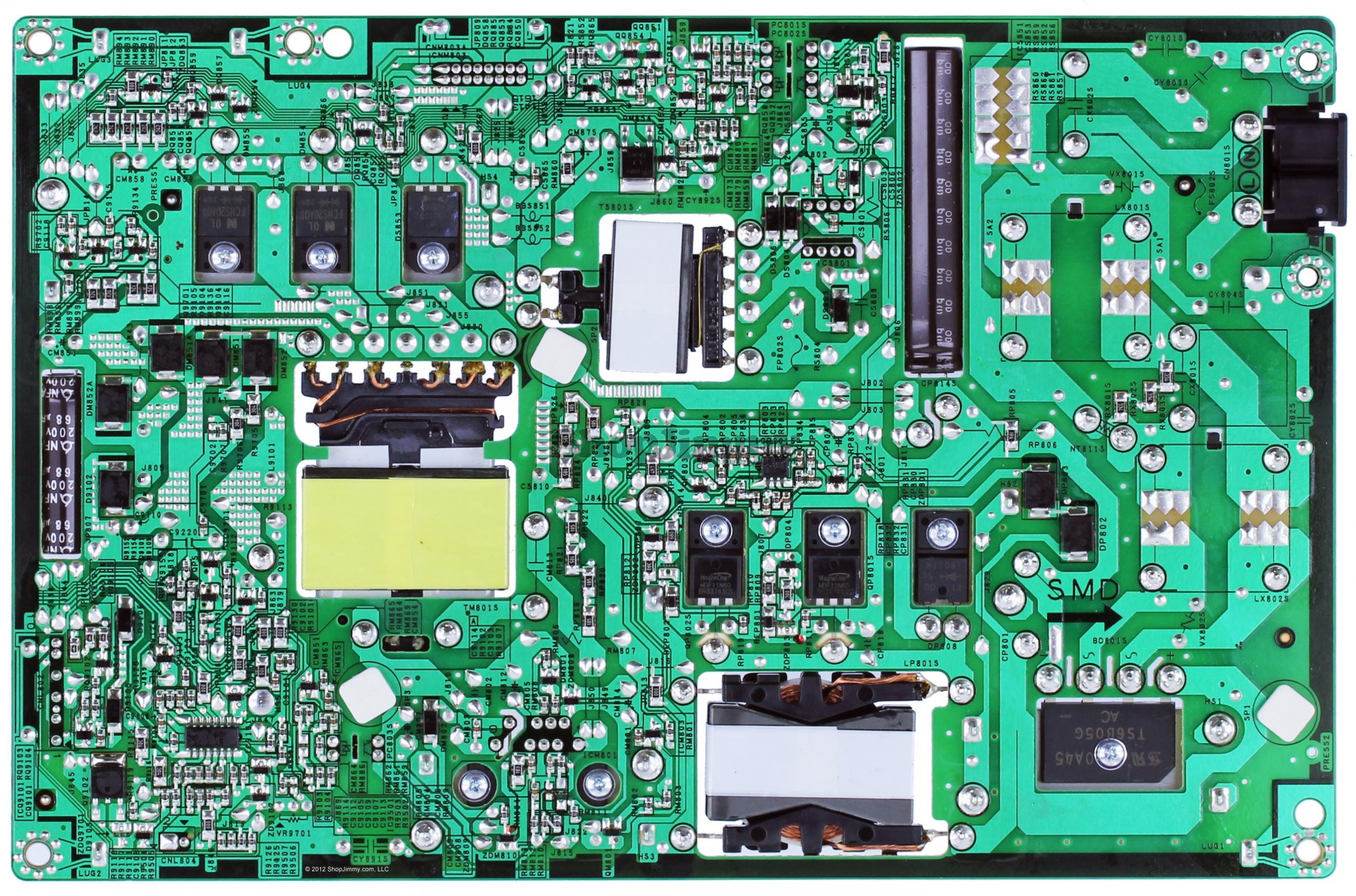

    Hello, i have another tread active and you guys are great.
    I got this Samsung UN46d6003SF that has picture and everything works but image is kinda dark. I actually opened screen up and looked at led strips and they all light up. Edge lit screen from top, two strings of leds along top of screen only. No dead leds. I can stare at them and they are not bright bright. On power supply it says that power to led string TOP1+ should be 255VDC but i am measuring only 230V. I have measurements at led strip connectors as shown bellow:
    BACKLIGHT ARE AT 20, multi-meter negative probe on tv chassis
    TOP1+ 230VDC
    TOP1- 111VDC
    TOP2+ 111VDC
    TOP2- 9VDC
    Tv does respond to backlight level change and it gets darker to where at Backlight 1 TOP2- is about 134VDC.
    Compared to working 46 samsung this one at full backlight level looks like good working one at level 4 i would say.
    Picture of power supply is attached, provided by shopjimmy.

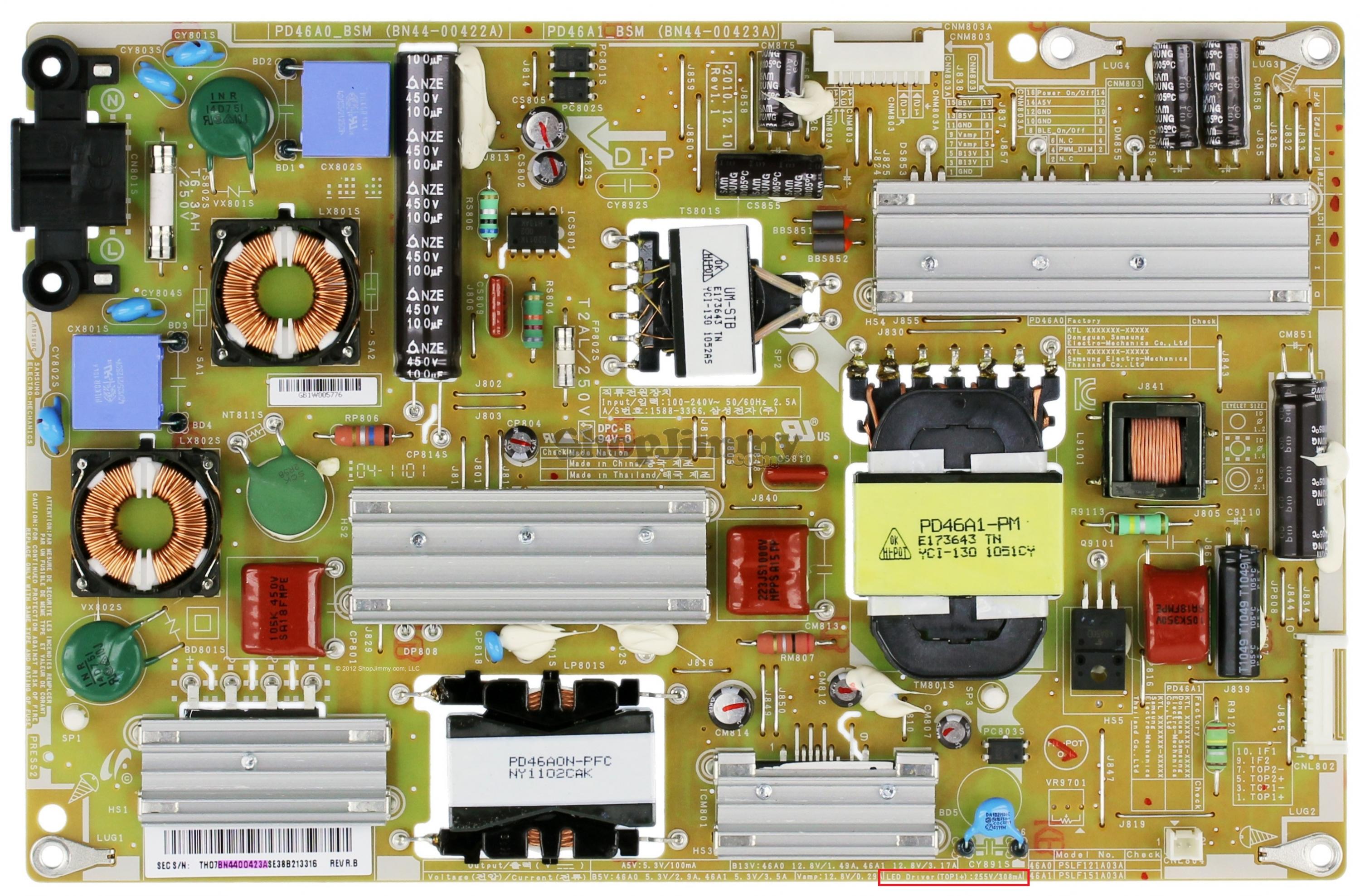

        Self-test mode (disconnecting the cable form the main) will put the LED driver circuit at full on mode (see explanation below). So you may have problem in the Voltage Booster circuit (IC9101, Q9101, D9102, L9101, C9110) that suppose to boost the Voltage up to 255VDC.
        "TOP2- 1VDC lost 8VDC from before" Right now the PWM Controlled MOSFET Q9102 on the Cathode return side is basically fully on that is why you are only seeing about Vds drops of only 1VDC (same topology as other LED driver that I already explain how it functions and how it regulate the current flow through the LED in the your LG thread).

          BTW, all other Voltages are OK? I.E. 5.3V, B13V, VAMP 12V?
          Also what is thew PFC Boosted Voltage measured between the two legs of the main filter cap CP814S?

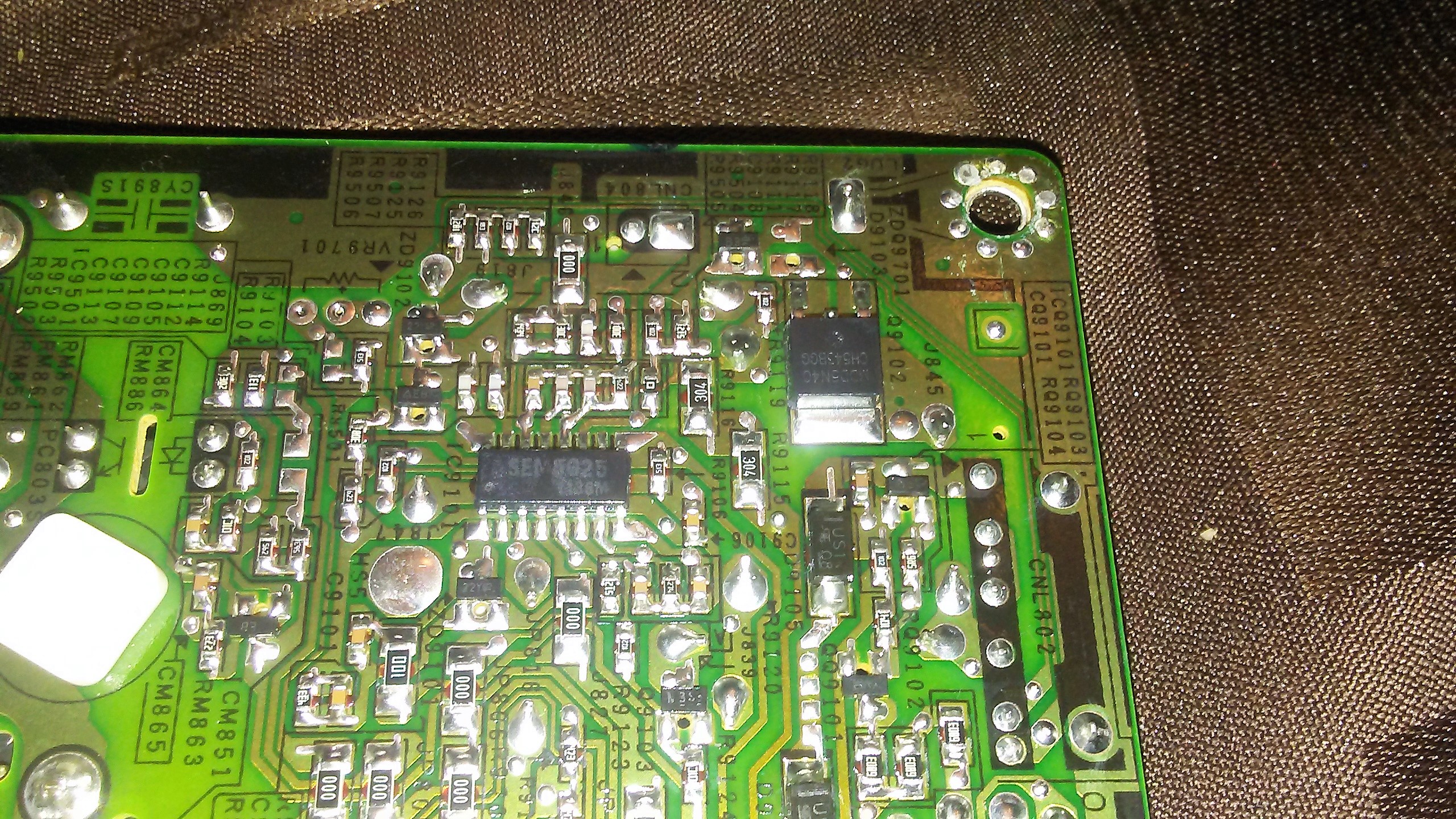

              I read elsewhere that others have replaced IC9101 to fix no backlight problem where they had no voltage at all but in my case i am missing only about 25V.
                Re: Samsung UN46d6003SF screen dark some
                What is the P/N of the IC9101?
                • gavric
                  • Jun 2011
                  • 65
                  IC9101 is SEM5025
