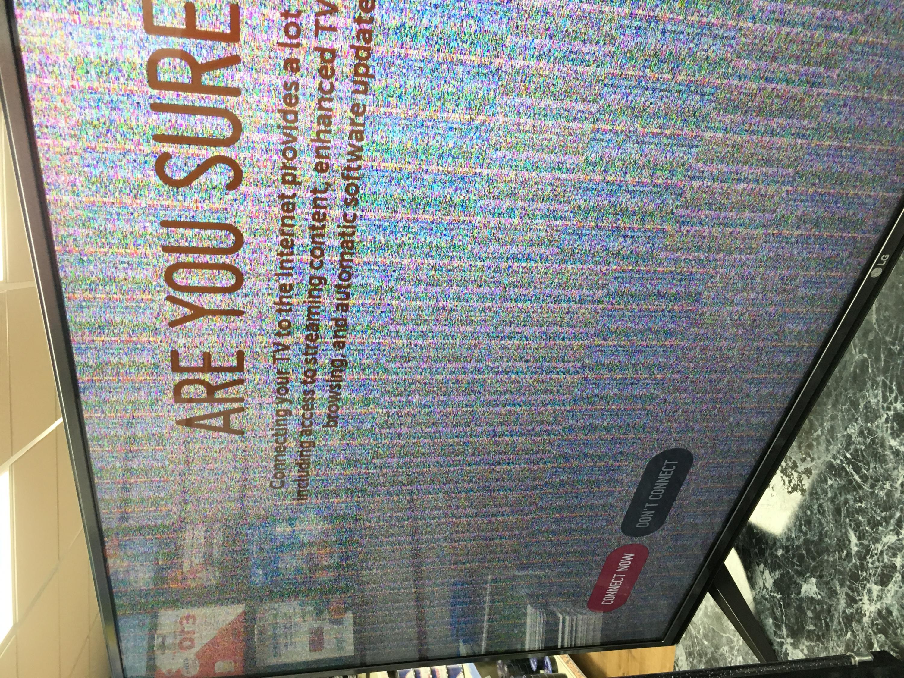

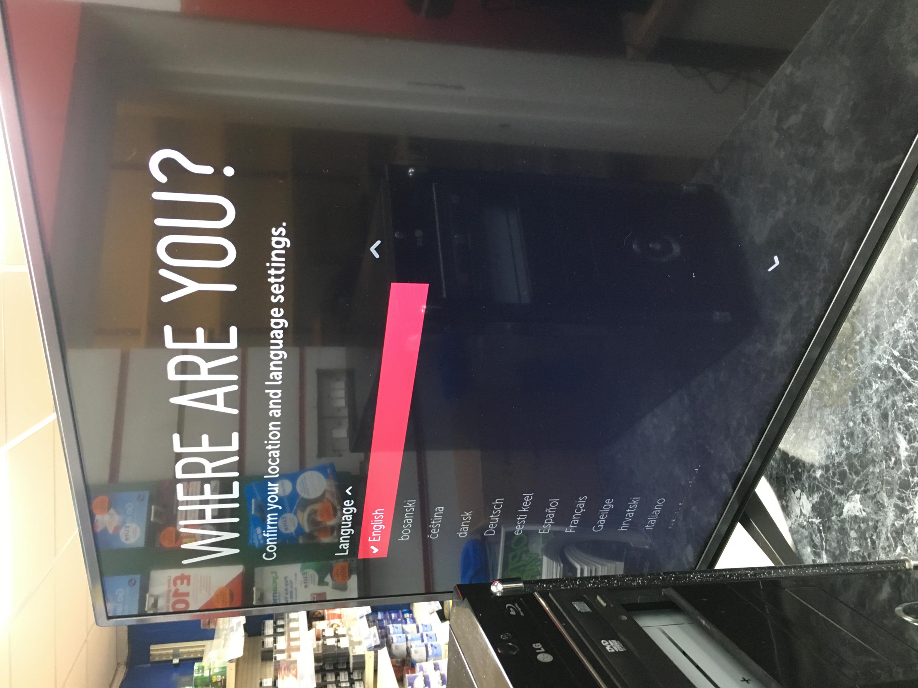

    HI all. I have never seen anything like this in my entire life. When powered on, you get the menu for setup. Perfect. After all that and not in menu, tv becomes fuzzy. Any pointers? Tcon or mainboard?

    Main board. I'd say corrupted flash memory. Maybe try a software update, failing that, new main board needed.
    • Hamie
      • Apr 2014
      • 1383
      Re: LG 49UF680V: Fuzzy only NOT on settings
      +1 MAINBOARD
      This is the most common fault on all the UF series.
      LG should have recalled them all.
      • Hamie
        • Apr 2014
        • 1383
        Also I'd ad I got a working board for a 55uf860v exact same fault.
        Tried to keep the faulty board in circulation by swapping/copying the flash.
        Didn't work. Gave up.
        • speedypro
          • Feb 2013
          • 561
          • United Kingdom
          Sorry for late reply. Ive done a software update from the main menu but same. Guess I'll let the customer know. My spirit never took this one to even repair it lol.
