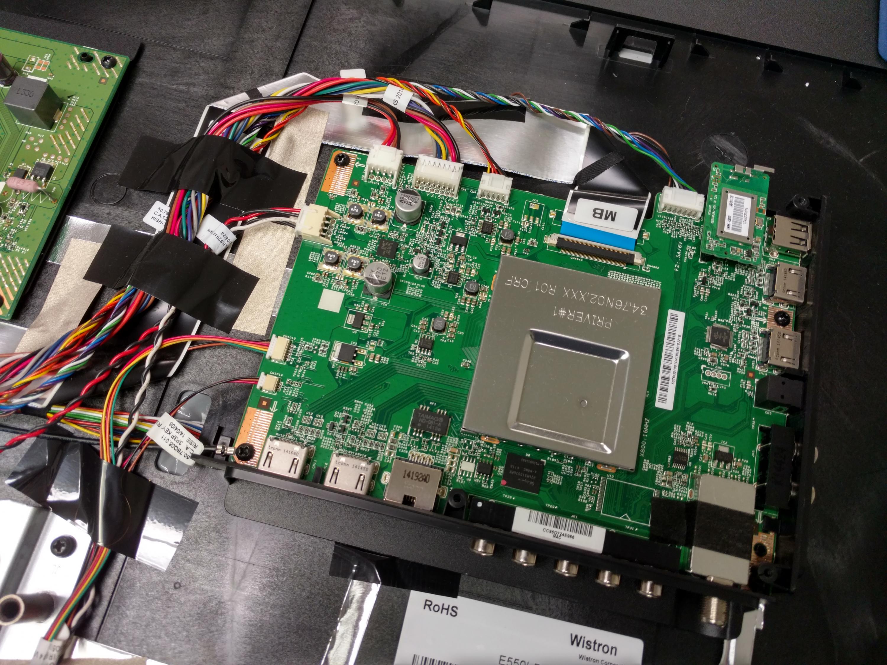

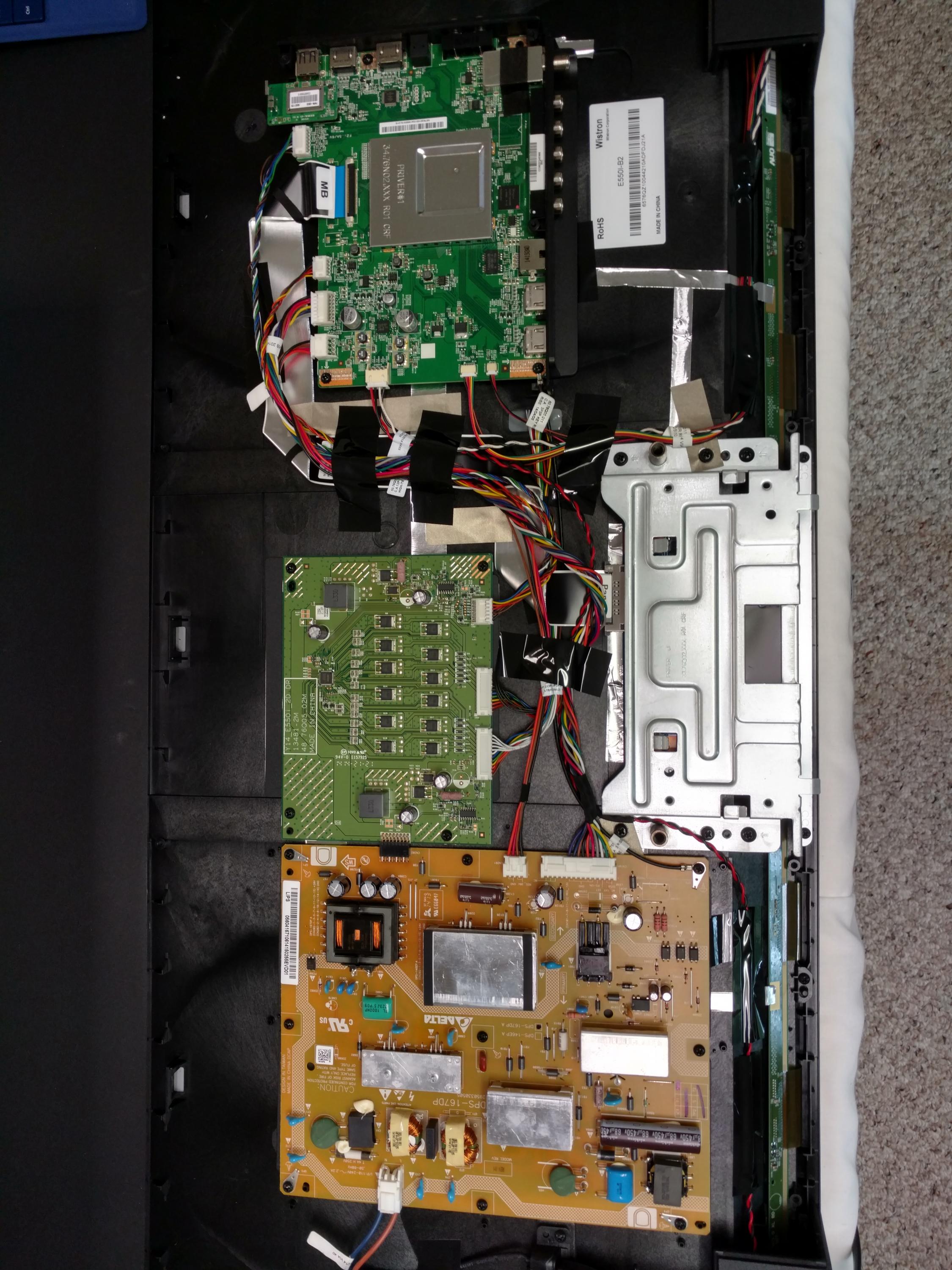

    I'm working on this Vizio flatpanel, but am having a bit of trouble with it. What happens is that after the power button is toggled, the white light comes on and just pulses. It never powers up. No backlight, nothing on the screen (after analysis by flashlight).

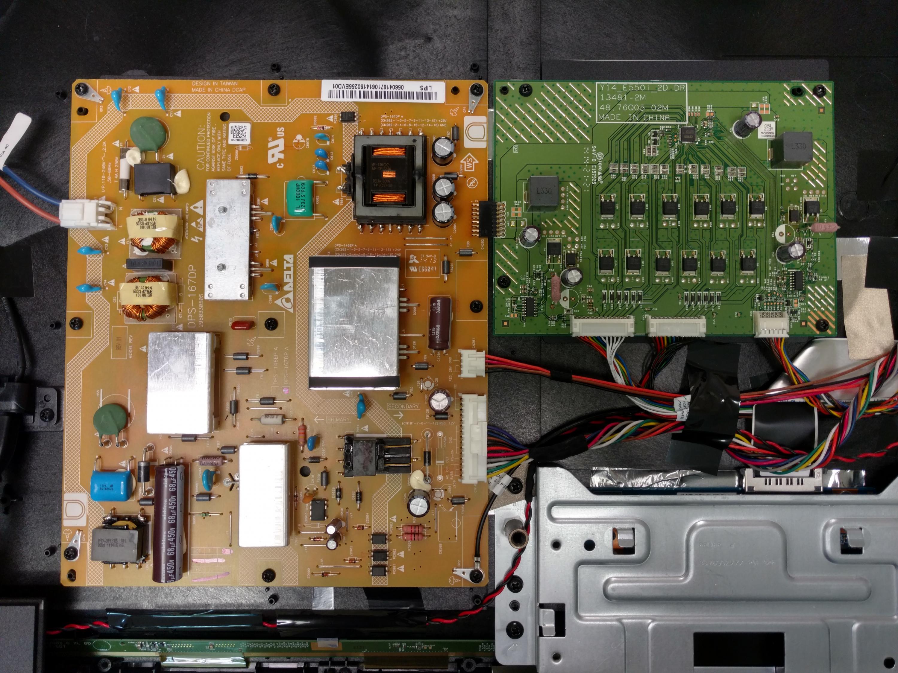

    I opened it up and visually inspected everything. Nothing looks off. The voltages seem okay too. 5Volt Standby is good, Reg 20V & Reg 12V are relatively stable, AC_OFF_DET cycles between 3volts and nothing.
    Even in this state, it still responds to the power-off command from the remote.
    Any ideas?

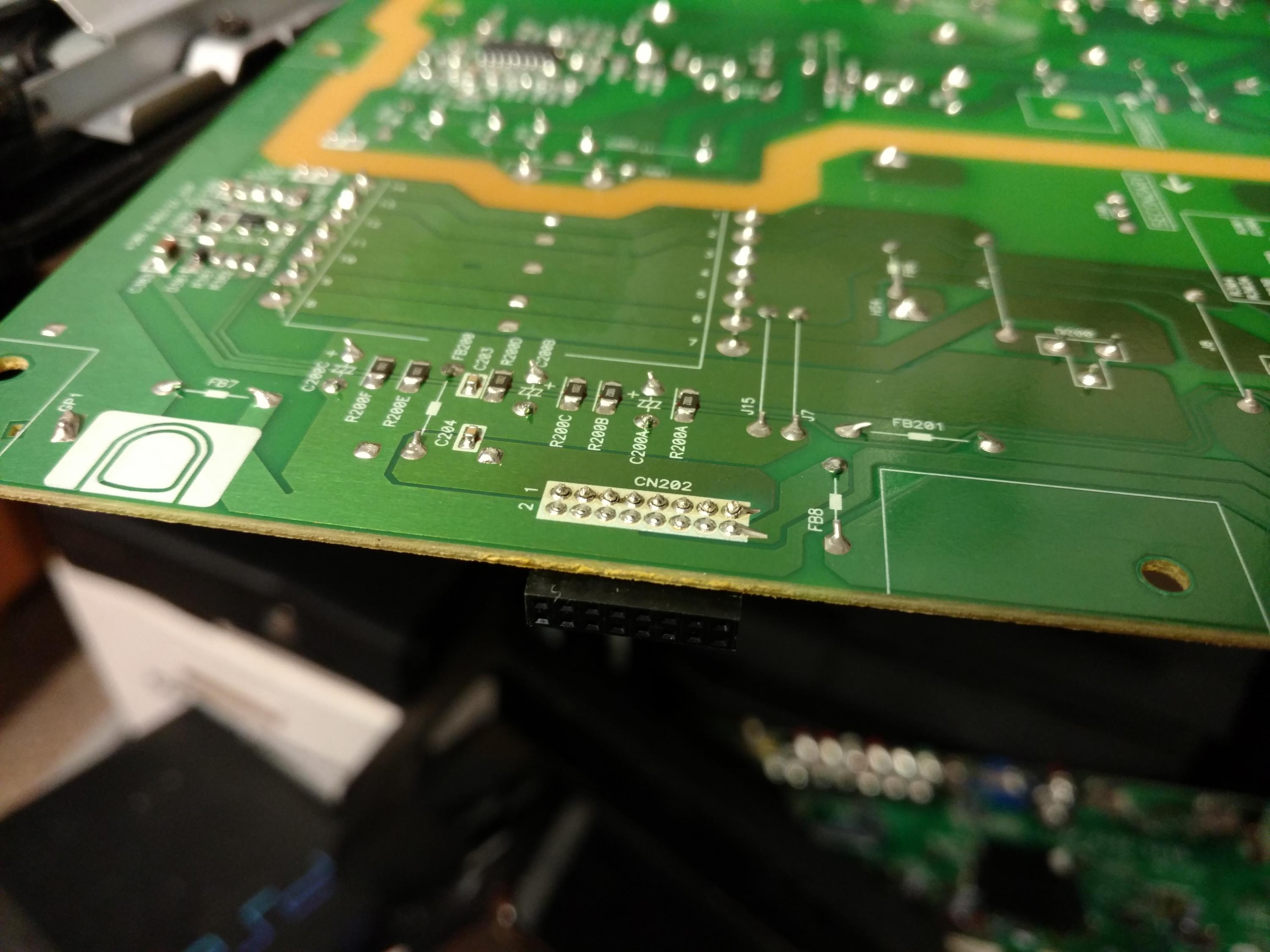

    If you search the threads you will probably find that there are bad solder joints on both boards where the Black linking connector is that connects the two boards together.

      I would be tracing back the AC_Det line to see why it is jumping around. Maybe one of the resistors in the chain needs to be replaced or an opto-isolator malfunctioning.
      Hard to know without the schematic.

          Solved!
          https://www.badcaps.net/forum/showthread.php?t=53880
          https://www.badcaps.net/forum/search...archid=9128515
          Good find! That was exactly what was ailing this one, as it turns out. Every single point of contact for that connector between the backlight board and the power supply (on the power supply board only) was broken. Put down fresh solder and hot-glued the connector for better rigidity and it fires right up now.
