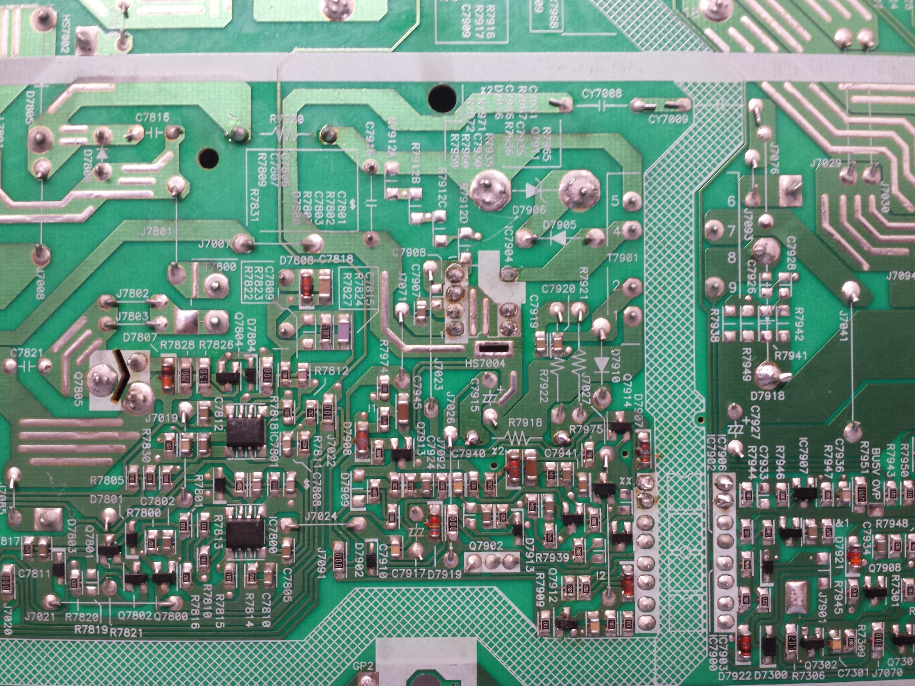

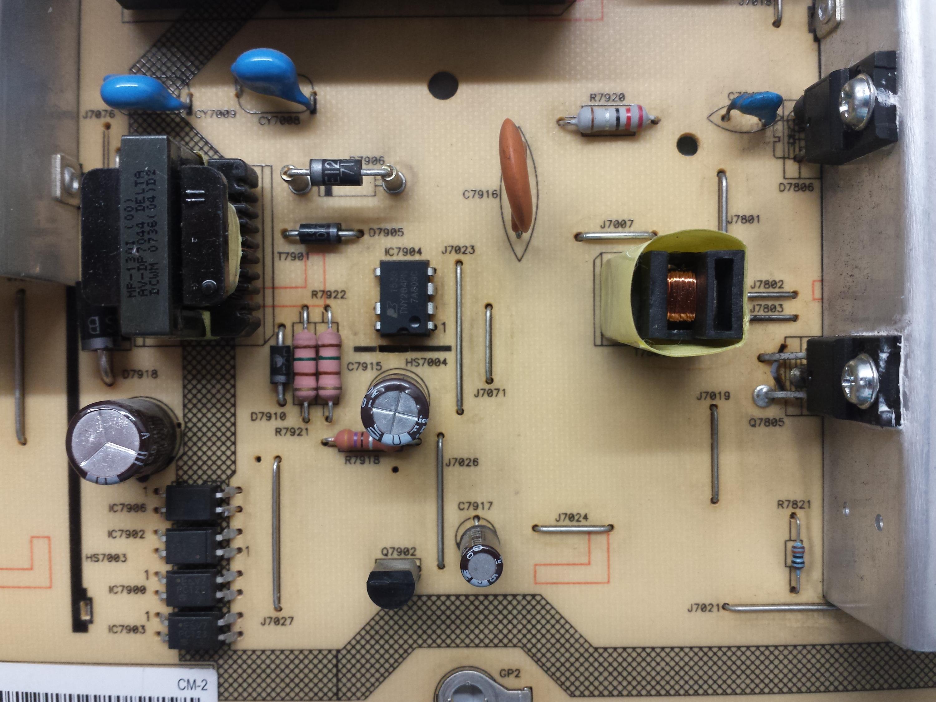

    Can we see good closed up pictures of the top and the bottom side of the board around the area where you replaced the IC7601?
      Re: Sharp LC-37x20e power on but only for few seconds
      IC7601 was copy and paste error.. I had to replace IC7904.. summarizing:
      IC7904 (9NK2510293234) TNY264PN --> It was very HOT. Replaced because it burnt after freezing. But during freezing it, the TV power came to life for some seconds, before this component burnt definitively.
      R7920 replaced because damaged after IC7904 burnt
      R7918 replaced but it was good
      IC7906 PC123Y82FZ0F --> Replaced, but after desoldering repeating tests on the old it had no problem.
      In attach some photo centered on IC7904, but also other replacements are visible.
