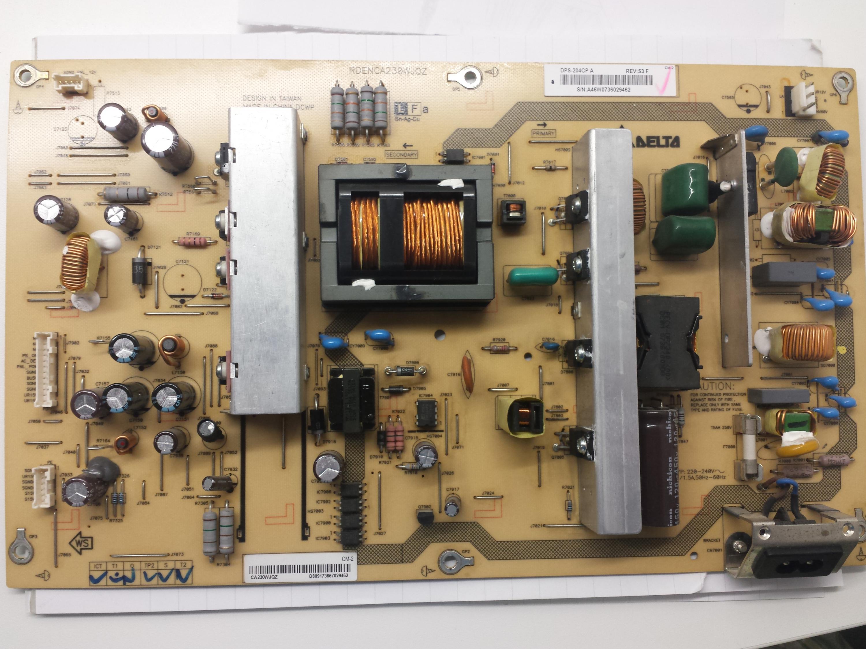

    Hello, I'm a newby. I read a lot of post on the forum to search a case similar to mine, but nothing found to solve my problem.
    I have a Sharp LC-37x20e. I think I have a problem with power supply unit rdenca230wjqz (DPS-240CP) by delta electronics.
    If I leave tv unplugged from power for 1 day, then I plug it into the AC, the tv starts regularly (green led) and images, but after 1 minutes it shutdowns. No lamps, no messages, no standy-led after shutdown.
    If I unplug power cord for a while, then reconnect, the tv starts (I see green led), but now it shutdowns after few seconds.
    I downloaded service manual for this model and I tried to understand something.
    So I tried so umount power board from TV and make some tests. I cannot see any bad capacitor, so I tried to perform something other.
    In my tests, first I plug the power cord. I use my digital multimeter to read voltages on connectors.

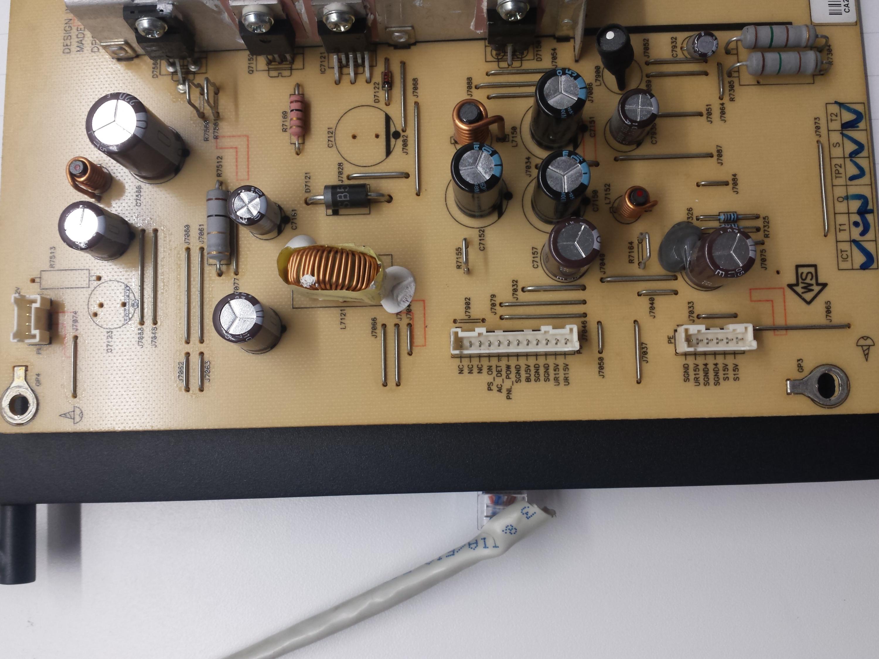

    On PD connector (see image in detail) I can read (using as ground the holes for screws at corners)
    pin1 - NC -> 0V
    pin2 - NC -> 0V
    pin3 - NC -> 0V
    pin4 - PS_ON -> 0V
    pin5 - AC_DET -> 3.3V
    pin6 - PNL_POW -> 0V
    pin7 - SGND -> 0V
    pin8 - BU5V -> 5V
    pin9 - SGND -> 0V
    pin10 - SGND -> 0V
    pin11 - UR15V -> 0V
    pin12 - UR15V -> 0V
    I also read 0V on other pin connector at example INV60, UR12V etc. I understood it is normal because the power board is in standby mode. So I tried to connect 3.3V to PS_ON (it should be power on the board).
    After that, I can see voltages UR15V, INV60, UR12V etc, but only for few seconds. Then they go to zero V. I think I have a power board problem, because I got same problem when it is attached to tv, and when power board is standalone.
    I also tried to replace some components: D7121, D7918, C7150, C7151, C7152..
    I think the my problem is due to a component malfunction (it goes only for few seconds) but I'm unable to understand where could be this component.. May someone give me some help please?

      When you force power supply on what do you read across the terminals of the big capacitor in dcv

          When the power supply is only connected to AC I read 305V at big capacitor.
          When I give 3.3v to PS_ON, in the meanwhile I read all correct voltages on connectors, I read 397V across terminals of big capacitor.
          When voltages on connectors disappear I read 305V at big capacitor.

            As a first step I would try freezing the four optocouplers while 3.3v to ps-on
            And also ic7601

                Your suggestion give me the hint about thermal trouble. So I connect power board to TV, and to the AC. As usual the tv came up, but only for few time. After shutdown I disconnect AC power, then I tested with my finger searching for HOT components.
                The octocouplers and ic7601 seems to be fine.
                But I found IC7904 very very hot. So I tried to freeze it, then reconnect AC power.. the TV came up, but always for few time. So I tried to freeze IC7904 without disconnect AC power (only a bit freeze) and TV starts again. After that IC7904 as burned.
                Tomorrow I'll replace that component, it is TNY264PN, I hope to found it.
                I also hope that component burnt do not damaged other components. I can see anything strange in the board. I'll let you know..
