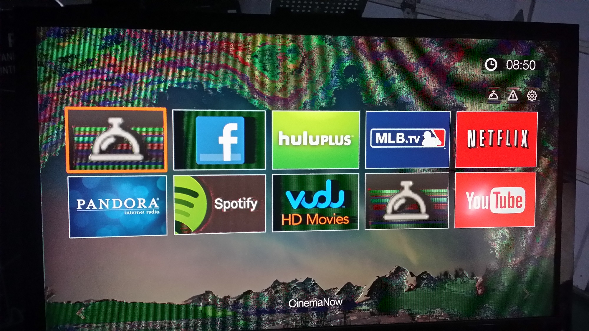

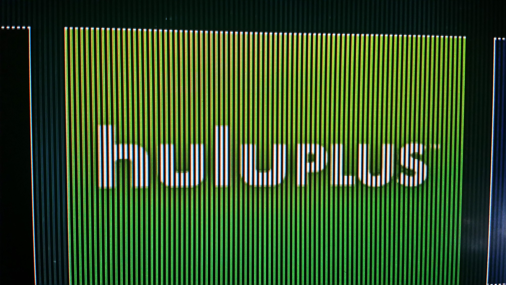

    Vizio SV420M green vertical lines
    It's been a while, since I have posted here.

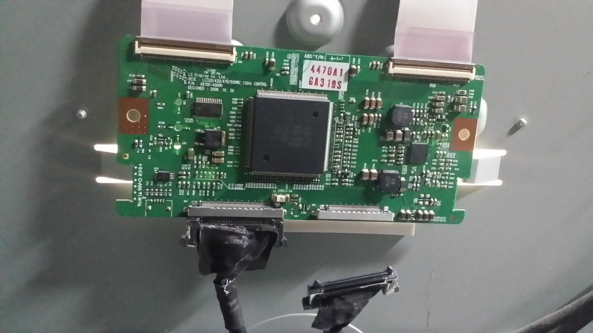

    I have got this TV, from a coworker for free and I'm trying to repair it.
    I have replaced the T-Con board, since it was a couple of bucks, but nothing changed.
    I'm measuring the voltages and they are all there.
    Removed ribbon cables, re-inserted them again, with no change.
    Any ideas, what else can I try?

    Re: Vizio SV420M green vertical lines
    I'd change the main board.
      I suspect the mainboard as well, but it is not available, or it is over $100 which is not worth it.
      Do you think, that it would be a bad/old capacitor?
          i doubt it, but you could easily find out by heating up the caps. just for heck... flex or squeeze the frame a little
            Didn't try different sources. You are thinking analog source?
            • petehall347
              • Jan 2015
              • 4427
              • United Kingdom
              any source .
              • tibimakai
                • Jan 2012
                • 3680
                I have tried only HDMI 4. The menu has the same issue as well.
