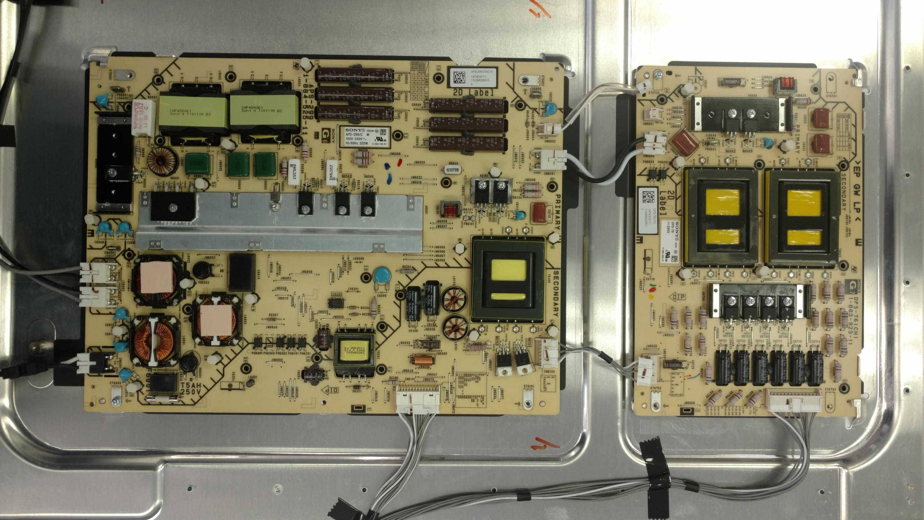

    From another post where this same Sony model was blinking 4 times I found this:
    CoppellTVRepair wrote:
    Haven't figured it out yet, partially because of Sony's idiotic design where if anything is disconnected (or failed) the whole TV shuts down ...
    Looking up the 5 blink code says I have a bad panel. But what is frustrating is if I disconnect everything related to the panel and I still get the same 5 blinks.
    Voltage readings:
    1 - 3.25v - Power_ON ----------2 - 0v - NC
    3 - 3.30v - PFC_ON ------------ 4 - 0v - NC
    5 - 0v - NC ---------------------- 6 - 1.67v - BL_ERR
    7 - 2.75v - AC_OFF_DET ------- 8 - 0v - T-CON_ON
    9 - 0v - GND ------------------- 10 - 3.3v - STBY3.3V
    11 - 0v - AU_GND ------------- 12 - 10.7v - AU_12V
    13 - 0v - AU_GND ------------- 14 - 10.7v - AU_12V
    15 - 0v - GND ----------------- 16 - 10.7v - REG_12V
    17 - 0v - GND ----------------- 18 - 10.7v - REG_12V
    19 - 0v - GND ----------------- 20 - 10.7v - BOR_ASU_12V
    21 - 0v - GND ----------------- 22 - 10.7v - BOR_ASU_12V
    23 - 0v - GND ----------------- 24 - 10.7v - TCON_VCC_12V
    25 - 0v - GND ----------------- 26 - 10.7v - TCON_VCC_12V
    27 - 0v - GND ----------------- 28 - 10.7v - TCON_VCC_12V

    Re: KDL-55NX720 Pwr Led Blinks 5 times
    If you unplug the 12v stuff do you still get 10.7v?
    • fcisolutions
      • Jan 2017
      • 205
      The main board has been isolated, forced power supply on, by jumpering standby to power_on and the 12V rail came to 12.75V.
      • dskall
        • Oct 2016
        • 2905
        • usa
        Possible bad cap on 12v supply. Probable short dragging down voltage
            You can try using 1A load on that 12V output to see if it can even handle 1A load to start with. The PFC Boosted Voltage also staying at around 380~400V range?
            • fcisolutions
              • Jan 2017
              • 205
              To use a 1A load would I put a 12ohm resister from 12v to ground?
                  12V, 12W car bulb would do the job
                    The cold resistance of the lamp may trip the over current circuit, the cold resistance of the lamp can be about 15 times lower than the hot resistance.
                      The power supply (w/o main connected) is forced on via 1k resistor to standby voltage and then I wired a 12v, 1.3amp fan from the 12v rail to gound. The voltage dropped from 12.75 to 12.44 with the fan running at full speed. PFC is stable at 392v during this test.

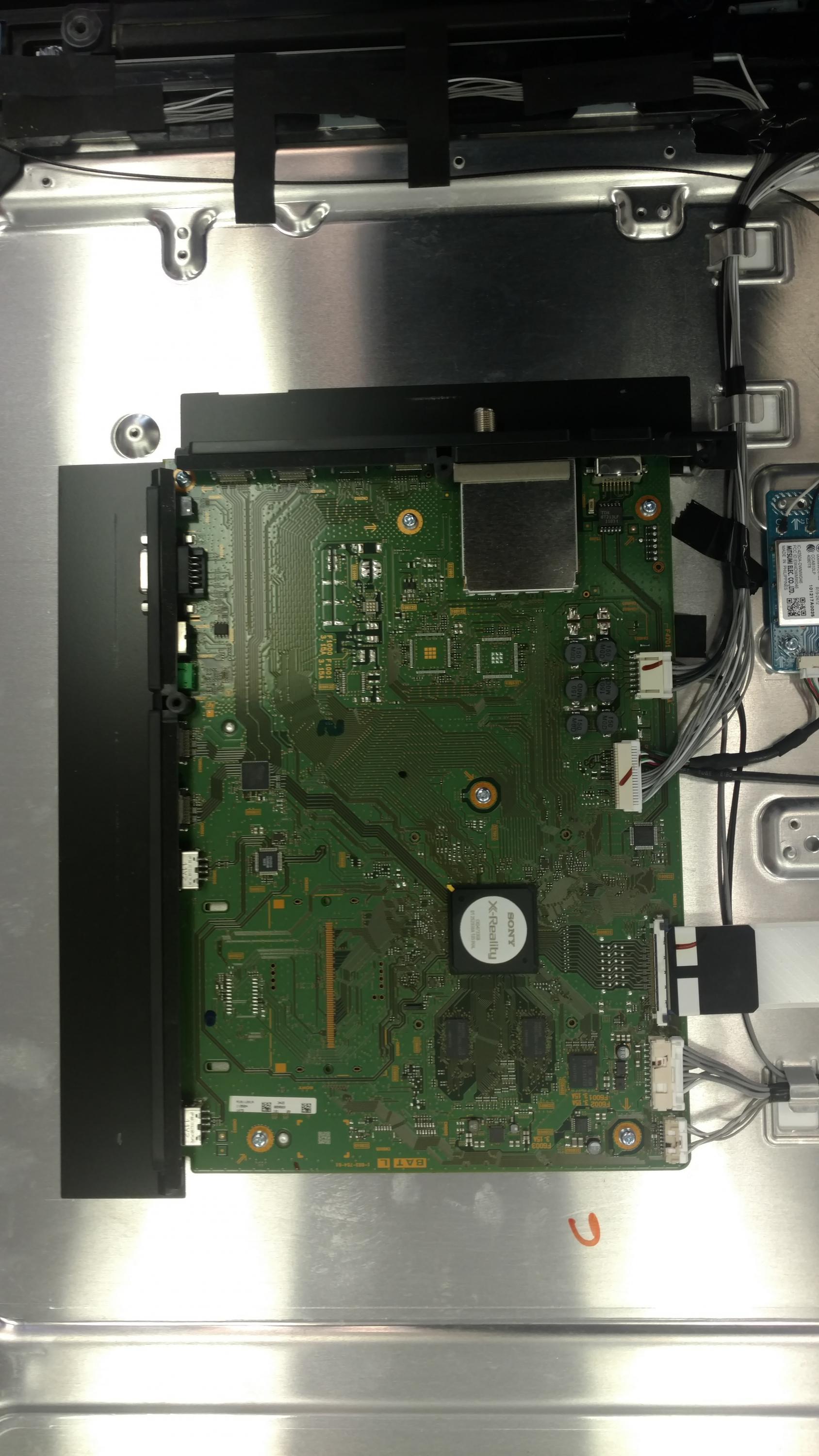

                        I would start disconnecting 12v loads one at a time till voltage comes up
                        • fcisolutions
                          • Jan 2017
                          • 205
                          With the main disconnected and everything else plugged up 12v is good. Going to try ordering a main board. Thanks for your help.

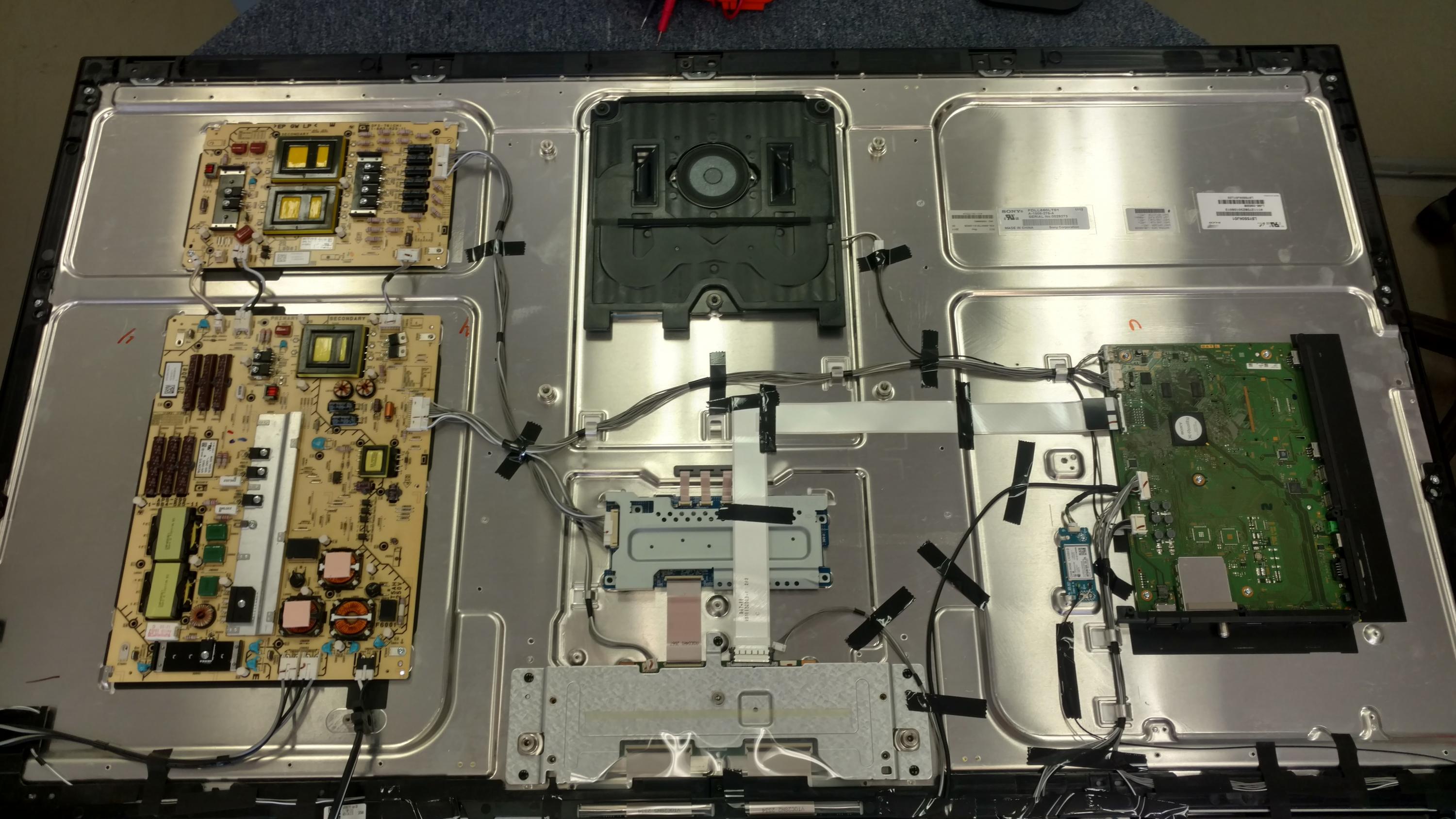

                            Main board arrived and the voltages stabilized. But still no picture. The problem is, isolating seems to trigger the led to blink 5 times. For example, I connected just the main and I get the 5 blinks. So how is a tech suppose to troubleshoot?
                            Also I don't get the LEDs to light. There is a LED driver brd responsible to send the BL-ON turn on voltage to the secondary power board. Thanks Sony.
                            • fcisolutions
                              • Jan 2017
                              • 205
                              I was able to test the leds and each string (there was 4) was pulling 30volts. So looks like leds are good.
                                Service manual for 5 blinks is t-con error/panel ID NVM error. T-com control MT board.
                                • fcisolutions
                                  • Jan 2017
                                  • 205
                                  Yes that's right. But remember, I get 5 blinks whether I have just the main board connected or main, led driver or main, led driver, tcon or main, led driver, tcon, and panel.
