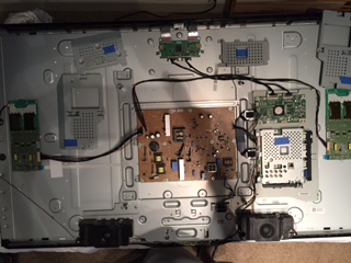

    Hello, I have Philips 55PFL3907/F7 LCD TV with sound and backlight (I can see the light from behind), but no video. I replaced the TCon board and still nothing. Not sure what to try next. I thought it could be the Inverter boards but the tech at ShopJimmy didn't think so. Any guidance would be greatly appreciated.

    Try unplugging ribbon cables from t-con to panel one at a time and see if you get picture

      Thanks for replying. I unplugged the one ribbon cable and got a 1/2 white 1/2 black screen. The white side was where I disconnected the cable. Repeated the process with the other cable and go the same thing, with the white side of the screen being on the side of the disconnected cable.

        So happens I have same model with same problem. I have a frc board between the t-con and main board and was getting no data out so I replaced and still have same problem. Unplugging ribbon cables I get same results as you. I know this is not much help. Thinking a main board at this point.

          Looking at he main board I don't see any bad capacitors, and I tested the fuse. Not sure where to look. I tried finding the SM online but no luck.

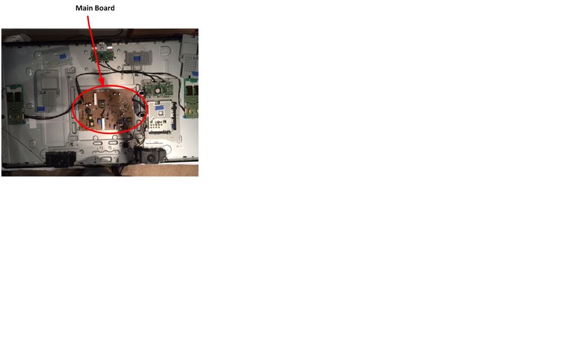

                      Does your setup look like this? See attachment.

                        That's it. Parts seem a little hard to find. You've changed t-con. I've changed the board above the main board. Power board is good. Leaves main board

                          Re: Philips 55PFL3907/F7 Sound and Backlight, No Video
                          Main board, correct?

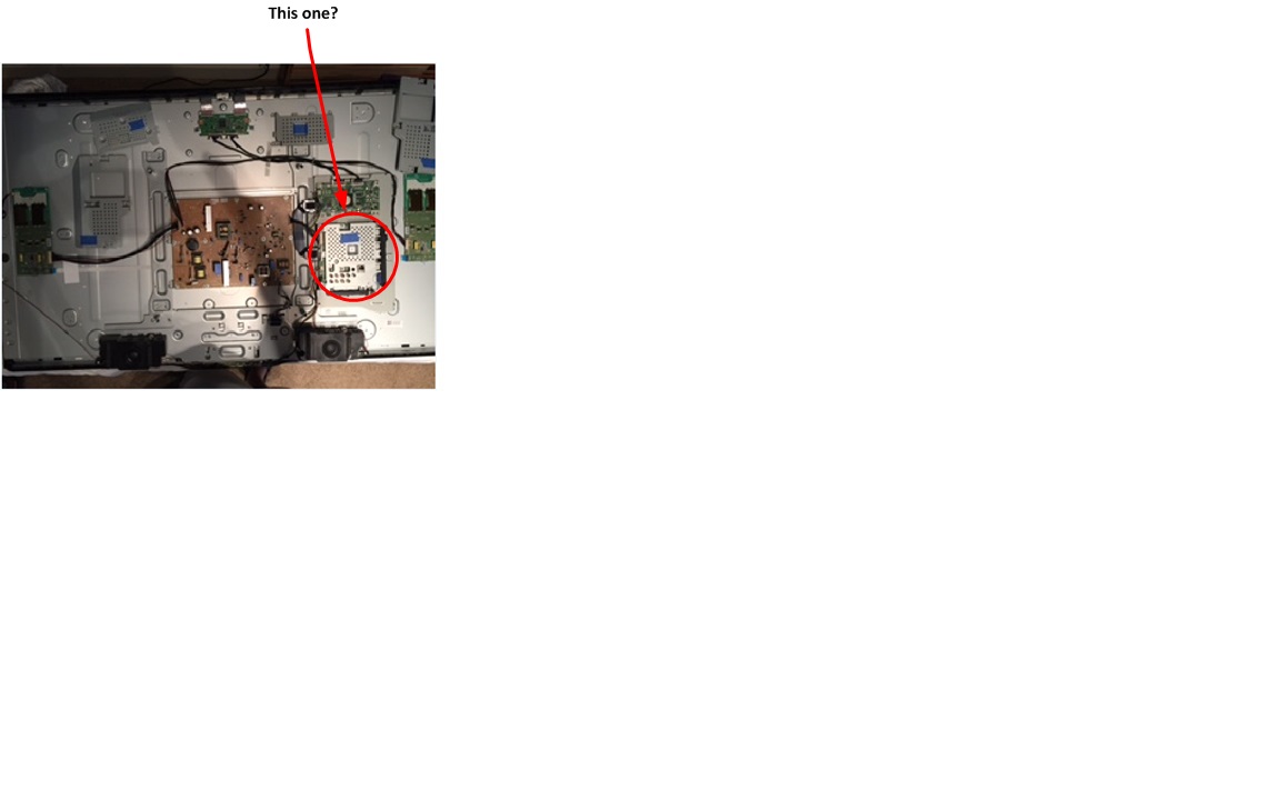

                            Board to right with metal shield over it

                              This one, correct? I'll start going through the SM and see what I can find on it.
