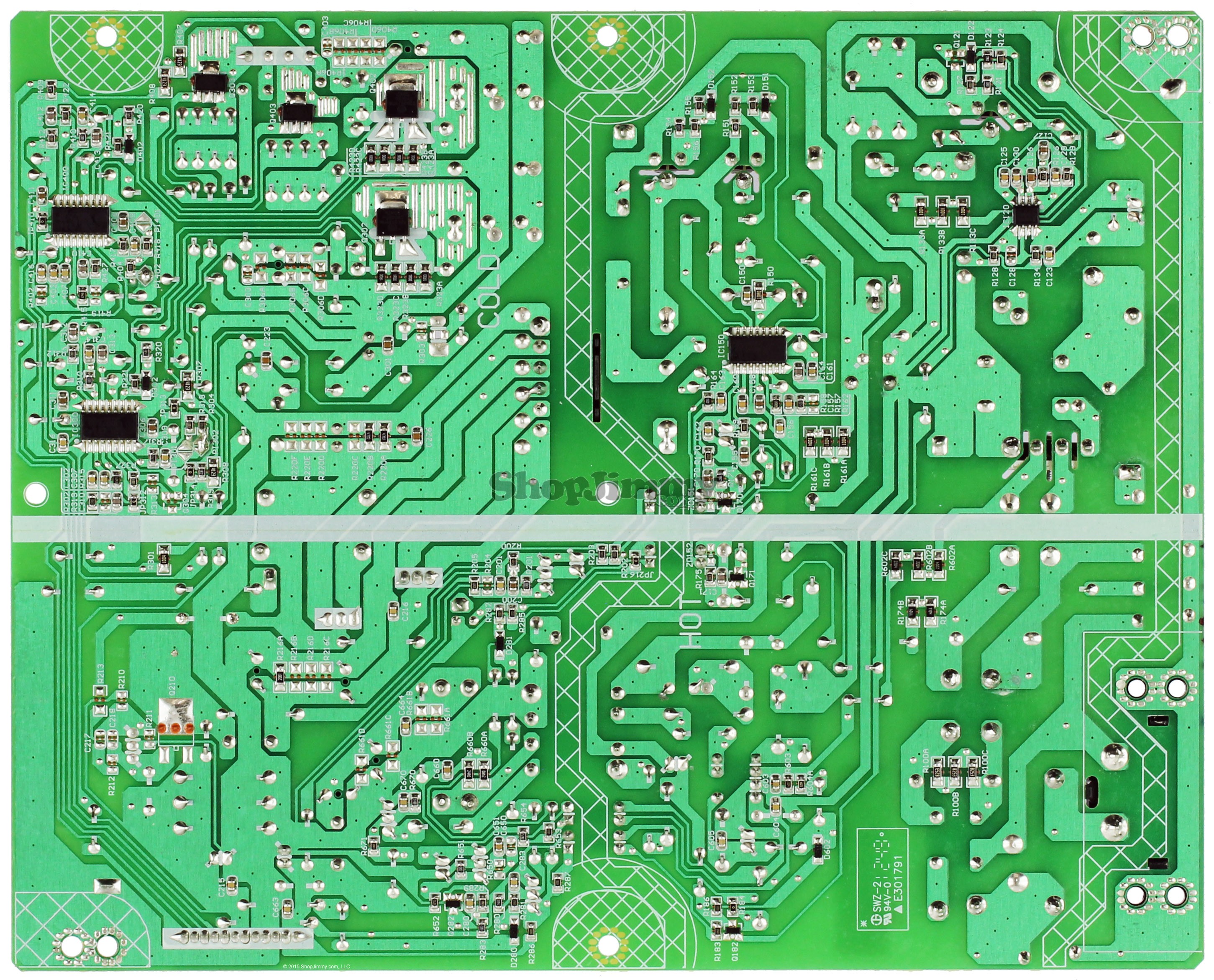

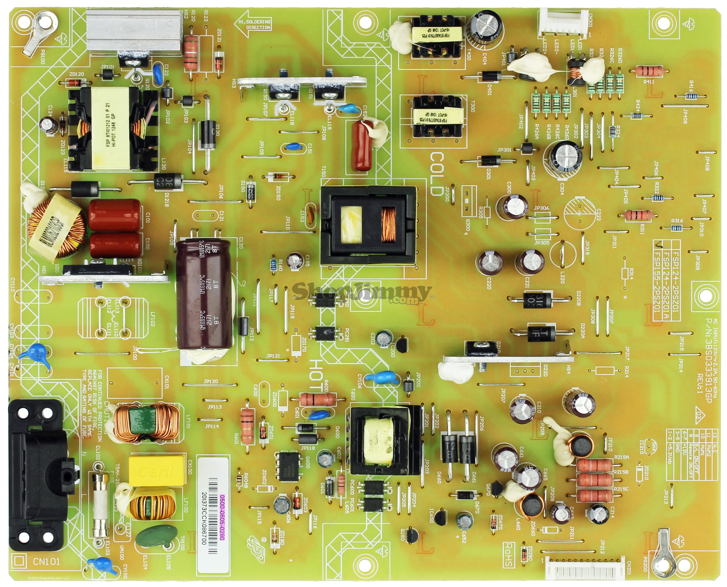

    I'm confused by my troubleshooting test results. See photo attachments courtesy of ShopJimmy for reference. Power board is 0500-0605-0280. With the TV on, the connector to main board measured:

    68V is the input Voltage feeding the LED boost converter circuit which boosts the voltage to over 100V. So you have to monitor both LED + pins to see what you have when it is working and when it is not, you have two LED driver for two set of LED strings.

                    Re: Vizio E500i-A0 backlight goes out intermittently
                    https://www.badcaps.net/forum/attach...5&d=1497448943
                    Top right section where the two yellow inductors are.
                        Since LED2 has the boosted Voltage then the BL-ON signal is fine.
                        There are two LED driver ICs (IC390/490 16-pin SMD): on the top left side.
                        https://www.badcaps.net/forum/attach...6&d=1497448943
                        So look up the spec sheet of the IC and then you can also do the Voltage comparison test. Check the MOSFET (Q302/402)/DIODES (D301/401), solder joints, etc. in the booster section.
