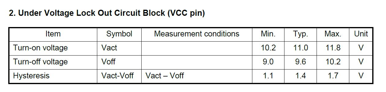

    What voltage do you have with the meter probes set to DC placed across Pins 1 & 2
    Only one of the administrators can change a Post Title or contents of a post.
    8.7V volts,

      Re: Sony KDL-40EX710 - Lightning strike and power surge
      What voltage do you have on Pin1 of IC6802 and chassis and then on Pin4 IC6800 and chassis?
            So the opto's should not be the problem.
            Can you check that IC6800 Pin 5 is at 12V and IC6800 Pin 4 is at 9V
            • sat3182000
              • Jun 2017
              • 18
              • India
              They are 0 Volts.
              How can I check if CXA3809M is switching? IC6501
              CXA3809M => IC6501 => Pin 20 => 10.2V
              Looks like the IC is not switching on with 10.2V
              I do not see any voltage at T6101 Pin5.
                  Its 10.5V, you must be right, Why is the 12V not turning on
