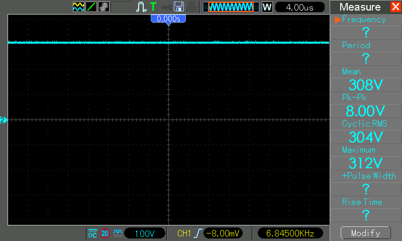

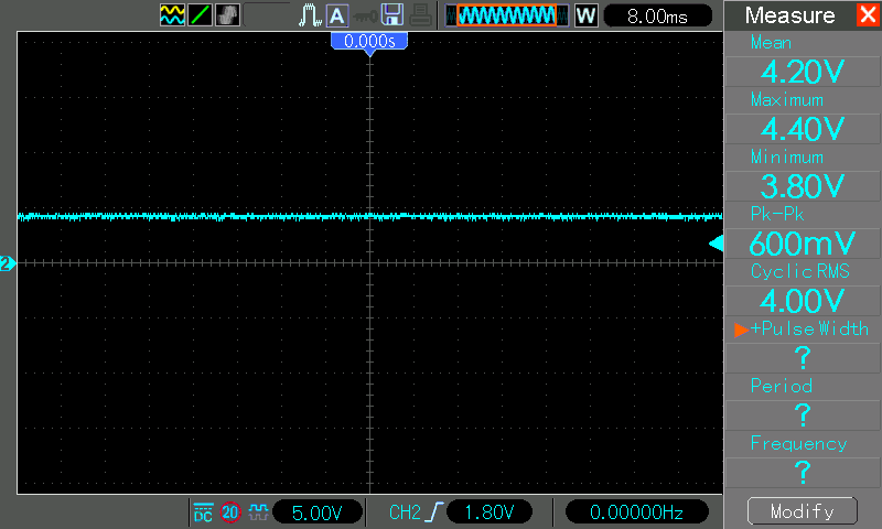

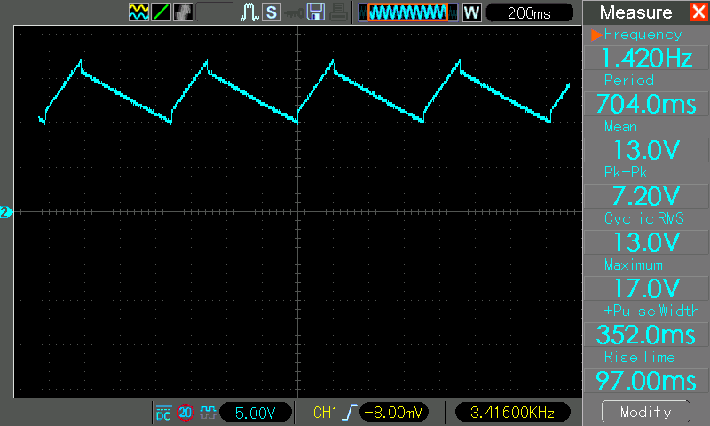

                Here you are the measures at the diferent points commented before.
                B+, FB pin, IC Vcc (in this order).

                  Re: Power suply doesn't work (DPS-214CP)
                  VCC is initially supplied via the DDA010 internal current cell until it reaches a specific value after which it switches off. The IC should then start to drive the internal mosfet to switch T901 which will then maintain VCC through the winding (pins 9-10) of T901 which is rectified and connected to VCC and it's charging capacitor C904.
                  If the IC fails to drive T901 for whatever reason, then there is no secondary voltage to maintain VCC. The IC restarts and charges the VCC startup capacitor via it's internal startup circuit once again until it reaches VCCstartup threshold at which point the internal charge circuit switches off.
                  This I believe would explain the ramp that you see on VCC
                  VCC = 18V and internal charge circuit switches off
                  VCC = 10.5V and internal charge circuit switches on
                  Can you scope the Drain (pin 5) and check that the internal mosfet is switching transformer T901

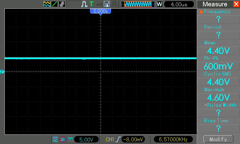

                        I would check R903, D902, C903, C904, D903, Q901, R904, ZD901
                        Out of curiosity are you using an isolation transformer to power up the set or using a scope isolation probe?
                        I have attached a screenshot of the drain pin.

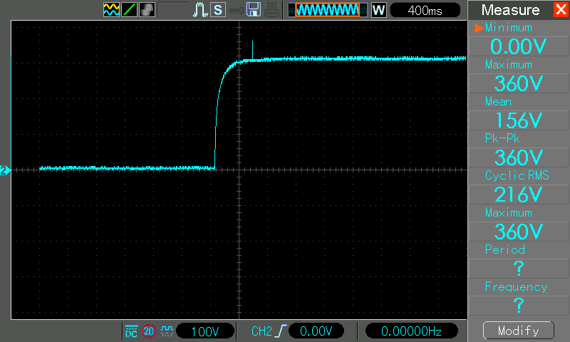

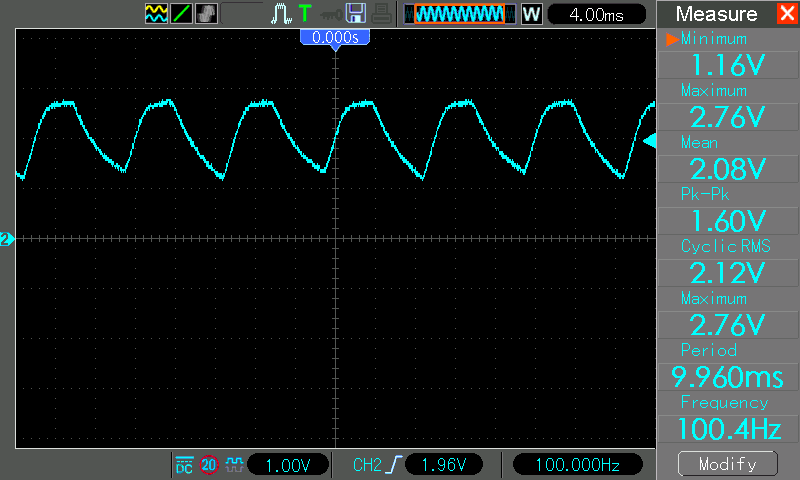

                        I have atached a screenshot of the input pin of the IC902 as well as a screenshot of the behaviour of the drain pin when I apply AC to board.
                              So transformer T901 is not being switched.
                              IC902 (IN1) needs 1.8V peak or more and the output (FPO) I think would be around 7V
