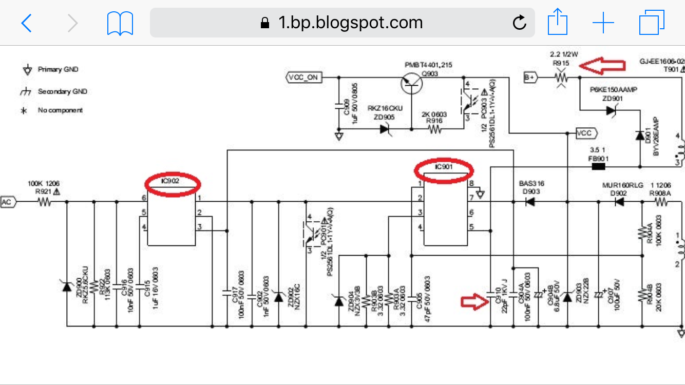

    Can you verify that the OPTO PC901 is OK?
    The Brown out protection IC 902 can be left out for now, the output of that IC will go low if the AC brown out is detected.
    I believe the SMPS IC is in the open loop protection mode.

      Yes, at least it's not shorted. But when I arrive home I could desolder it and make a circuit to check it's behaviour
      In case of a faulty OPTO souldn't the drain pin starts swiching and stops suddenly after a little bit time?

        Like budm, for me IC901 is in latched off / over voltage / shorted winding protection mode or the replacement PWM is bad again. Then it will do the ramping up down triangle thingy then too.

          Ok, I have checked the OPTO, it works OK.

            Can you make a list on which components you have tested so far?

              At first I supoussed that there was an issue in primary so I cheked every compoment surrounding DDA010 (resistors capacitors diodes an even the transistor) then I checked there wasn't no shorts at secondary that can stop DDA010 from switching. After that I replaced DDA010, but nothing changed and then I came here and I followed al your recomendations.

                So, to sumarize, I have cheked: D901, D903, D902, Q901(not shorted), ZD901, ZD902 and ZD906 (not shorted), ZD903 (behaviour checked), PC901, D950, R905, R915, R914, R902, R901.

                  what about the transformer itself, R903 and C905?

                    R903 is ok, C905 replaced and nothing changed.
                    The transformer values are:
                    Pins 7-5: 0.8 Ohm
                    Pins 9-10: 0.5 ohm
                    Pins 1,2 - 3,4: 0.1 Ohm

                      what disturbs me is that the PWM isn't even trying to switch on the Drain pin. Maybe verify this again. Because if it isn't at all, I think that the PWM is bad, even tough you put a new one in.

                        I am not good with spec sheets but it looks to me that 5v on feedback will shut down DDA010

                          Hello again, good news, or maybe not. Y have checked again, and as I said when I plug in the power supply I can't see nothing in the scope related to the Drain pin... but I really have 5 volts in +5V in the secondary side for arround half a second.
                          I'm still confused, I hope this new info helps.
                          Thank you one more time for all the help and the advice given up until now.
