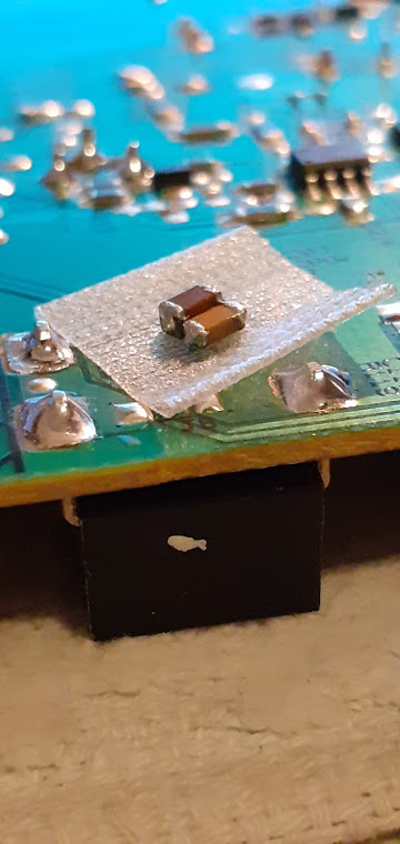

                            Thank you for your reply and for this post Dannyx. I replaced U202, C295 and C296. Used 1uF 50V as suggested. TV is now fixed . Yay me, Dannyx and all others that left their comments and thoughts here.

                              Re: Dead Vestel 17IPS20 power supply repair (OK fuse, no shorts)
                              Hi there Old post but looks I have the same issue with mine!!! Thanks.
                              Caused by a short when backside of the board touched accidentally the TV metal frame and blown the onboard fuse as well as tripped the home el. panel fuse.
                              I already verified that D112/114 are definitely shorted (by desoldering them) According to schematic they are RL207
                              C295 and C296 look ok but found some more shorted SMD diodes (Measuring their resistance on the board with Ohmmeter)
                              D298 Zener looks shorted (C18V)
                              D213 D111 D307 look shorted as well (1N4148)
                              Looks also the 3 caps near the input are dead? as measuring with Ohmmeter on board I dont see 'pulling' any voltage
                              C152 (100nF 275V)
                              C142 (56n 275V)
                              C151 (56n 275V)
                              Would also like to ask if there s anything else to check before ordering/mounting the new components.?
                              Being an amateur in electronics i accept with pleasure any advice or even critical comment
