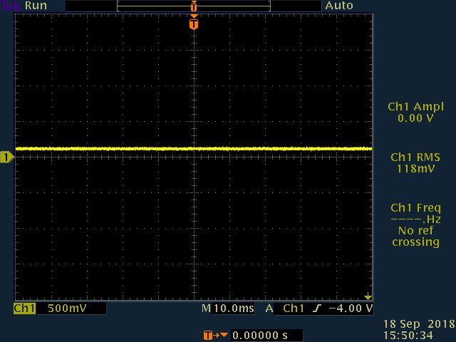

    Okay. I used 2 pole cable no earth to the Oscope. I measured the cathode of d214 and gives me noting at all. then i measure the cathode of D215 and gives me a nice 13.7V. like in the picture.
    That is strange... If the secondary winding feeds the first diode and then in turn the diode feeds the second diode then why i get no voltage from the winding while i get 13.7 from the second diode ?
    Please note that the PSU is not connected with the mainboard.

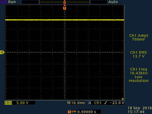

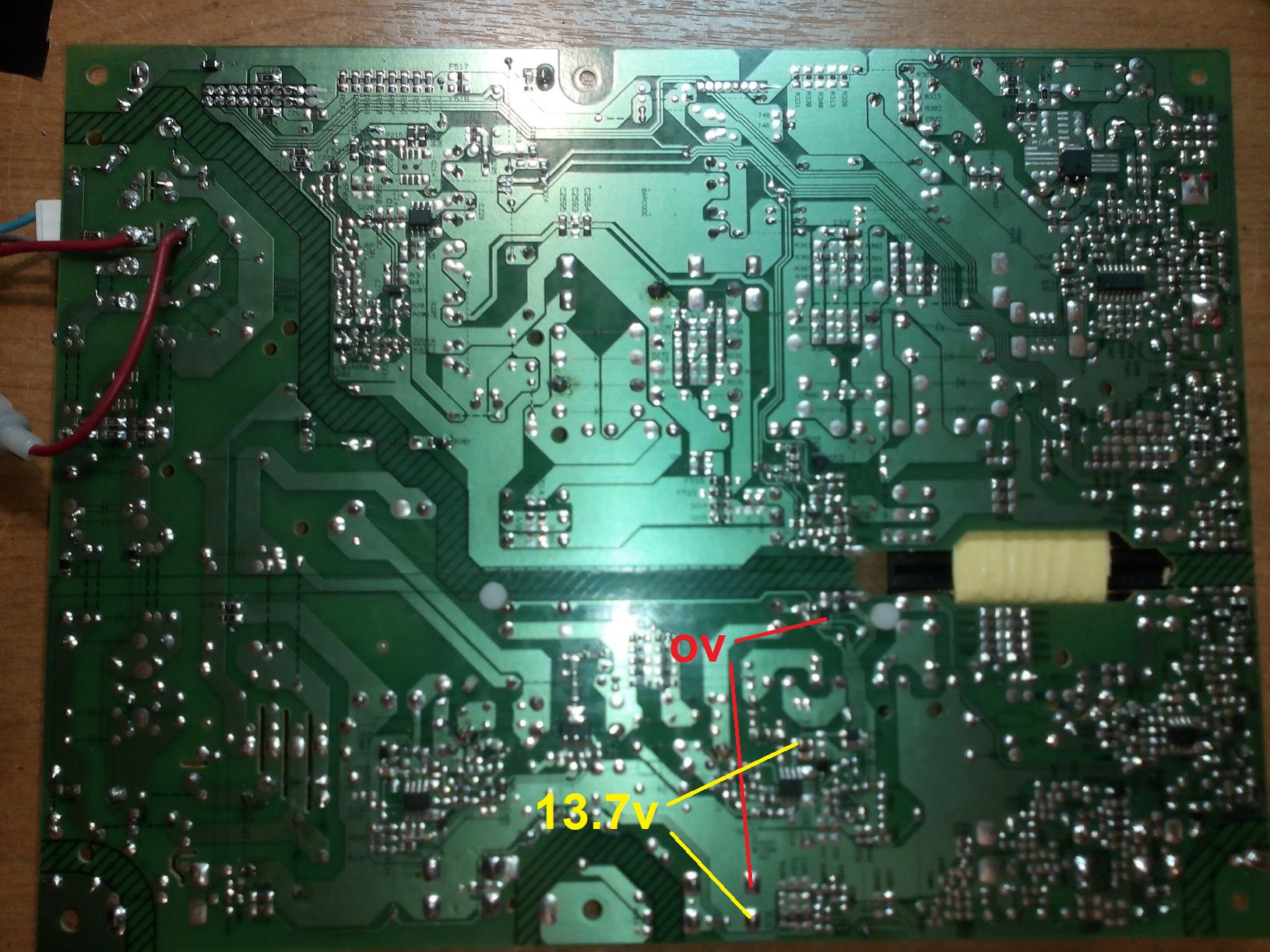

      Re: Dead Vestel 17IPS20 power supply repair (OK fuse, no shorts)
      Originally posted by R_J
      If you do have 13.5v on VCC_MAIN (VCC_M) You should have the other voltages from the transformer (24v_AC) which feed diodes to give 24volts on C213/217 and (12V_AC) which feeds D210 to give 12V_DC which goes through L200 to give +12VCC which gives +5V_STBY through Q212 (transistor acting as +5v regulator)
      Yes i do have 13.7V VCC_MAIN BUT I have nothing on C217 or before the diodes feeding it (actually i do have 118mV).
        U101 as well as U300 have no VCC... I have to scope TR200 to see what comes in and goes out, right ?
        Could you help me understand the pinout of the actual transformer ?
        Also i am reading almost short on D111 but again it might be due to that resistor r130 connected in parallel. I think its a 10 Ohm
          U202 FAN6300 has an internal startup cell: when power is first applied to the board, there would be no VCC_MAIN present because U202 has no VCC to switch TR200 to generate anything, so the IC takes some current from its HV pin (which is at HOT+) and feeds it THROUGH the IC into the VCC pin to provide its own startup until VCC_MAIN takes over. The VCC pin is connected to D215 and it also explains why you get something after D215 but not before: it comes from the VCC pin itself. It also explains the role of D214 - blocks VCC from U202 from going back into the transformer. It looks like U202 is not switching. Probe its 5th pin (GATE_M in the schematic) and see if you get any switching action from U202, provided it has VCC on its pin coming through itself.
            Good catch dannyx, that must be the reason, On a normal schematic drawing it may have been more obvious, at least they put the transformer and the ic and fet on the same page.
            If there is no gate pulse check that D298 or Q215 is'nt shorted, 13.5 volts vdd is above the 10 volt turn off so it should be turning on if its ok.
