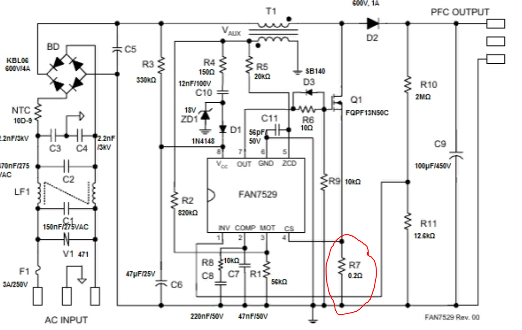

      Hello, sorry for dig up this old thread but i need help with mine Vestel 17IPS20P.
      I only have 320v on the capacitors so i think the PFC circuit isnt running cause it should be around 400V, i don't have VCC_MAIN, VCC_M, VCC, nothing...
      i've tested a lot of components found Q211, R228 and U202 blown so i've changed them and still no voltages....
      The only short that i don't even know if it's a short is on pin 6 of U202 (SENSE (CS_M)), its normal beeping to ground on this?
      Thank you
      • lotas
        • Jan 2016
        • 4459
        • Russia
        #103
        Yes, normally on CS there is a low resistance resistor (current sensor) on the ground.

            So... I fixed it, was the new chip 6742HR that possibly came damaged from factory... now i have all my voltages
