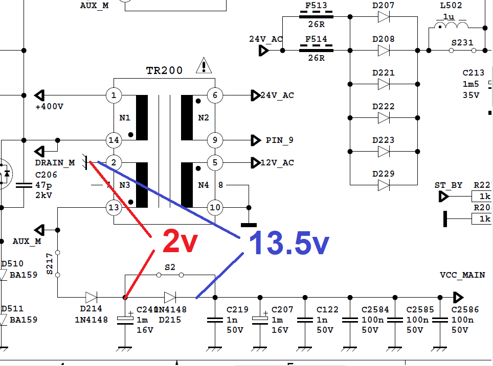

        Strange... Before i remove the jumper i meazured voltages again. take a look. very strange. All measurements arewith the DMM set to DC volts. U300 pin 6 reads 0v.
        Also on my board S1 is open and a few capacitors are not installed. Ive noticed many differences between my board and the diagram. I wonder how can i identify the version of my board and find a correct diagram ? It says 17IPS20 but what version exactly ? how can i find out ?

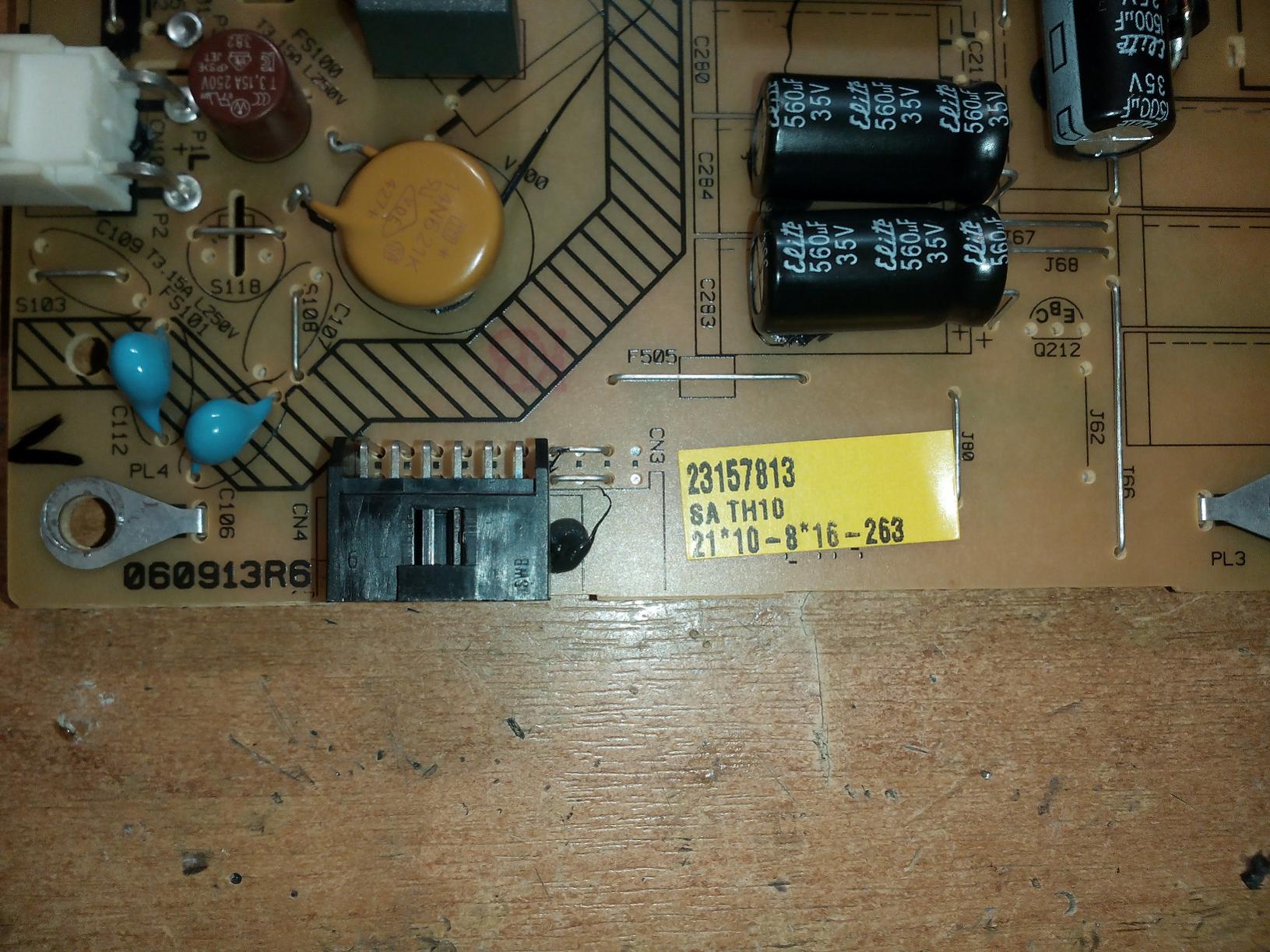

                If there was only a way we could see the board you are working on....
                Is there a number printed in the corner near CN4 the black plug?

                          Re: Dead Vestel 17IPS20 power supply repair (OK fuse, no shorts)
                          Your board is a 17IPS20 060913R6, so that should be the schematic. These are a real POS to follow.
                          The circuit that needs to be working is the one for U202/TR200, it supplies 12V_AC to get 12v_DC which supplies +12VCC_S which supplies Q212 and gives +5V_STBY
                          TR200 also supplies VCC_MAIN, Q216 is a switch that controls VCC that supplies U300 etc. Q216 is basically controled by ST_BY from the main baord.
                          So you need st_by ON signal from the main board to have VCC on U300

                            Good spot...I couldn't tell the difference between U202 and U300...I think U300 is for the LED driver and it's "switched" (just like U101 for PFC) whereas U202 runs all the time to generate standby...damn
                            So yeah, with that being said you STILL need to check if the AUX winding outputs anything to power U202, then if it does see if you get standby, then if you don't trace everything back from there....such a pain in the butt...I much prefer a supply that's completely blown apart, at least you know what to replace at a glance
                              Can you confirm that VCC_Main as shown in post #23 is steady at 13.5V
                                I missed that in the picture, should have looked closer. thanks dick_barton
                                If you do have 13.5v on VCC_MAIN (VCC_M) You should have the other voltages from the transformer (24v_AC) which feed diodes to give 24volts on C213/217 and (12V_AC) which feeds D210 to give 12V_DC which goes through L200 to give +12VCC which gives +5V_STBY through Q212 (transistor acting as +5v regulator)
                                    No, If the ic is NOT working you will NOT get VCC_MAIN. although it is drawn on the primary side it is a scondary winding, so no primary switching, no secondary voltage.
