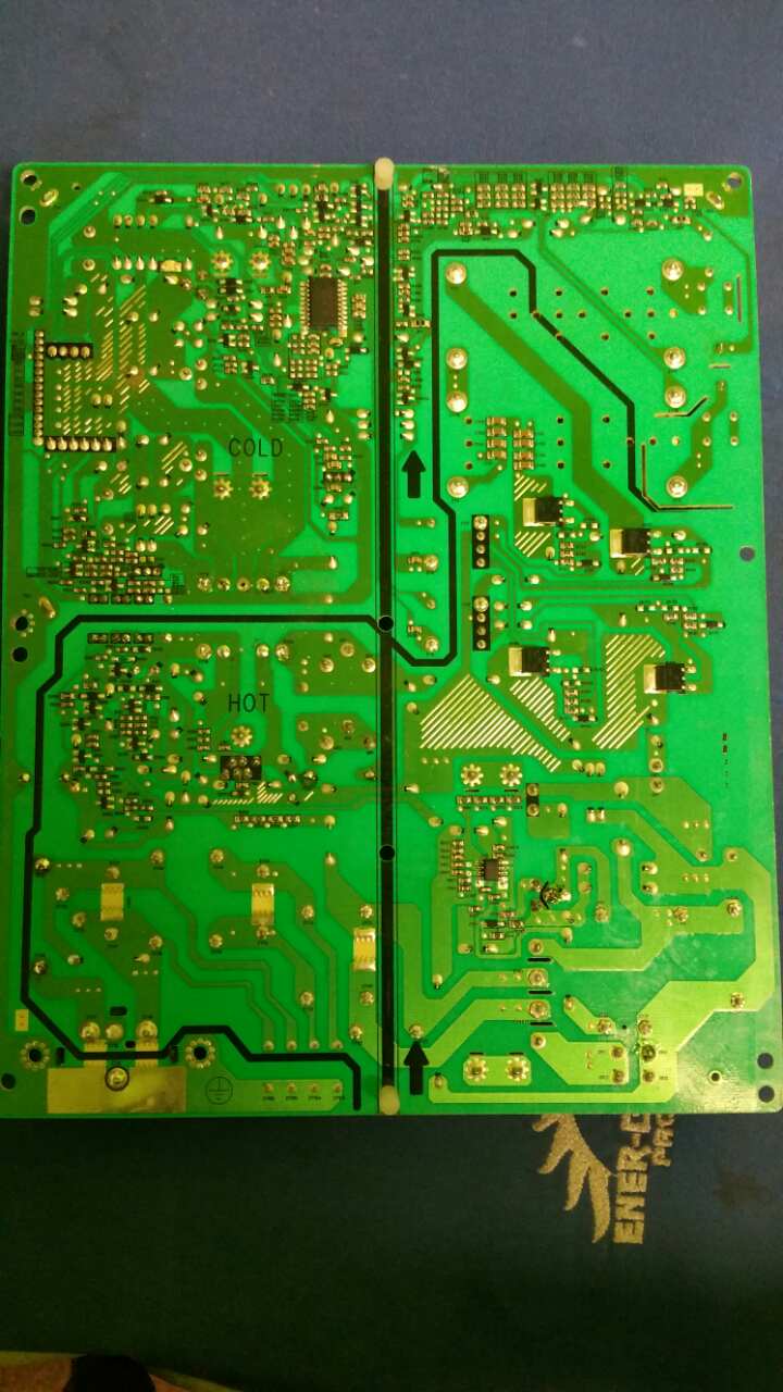

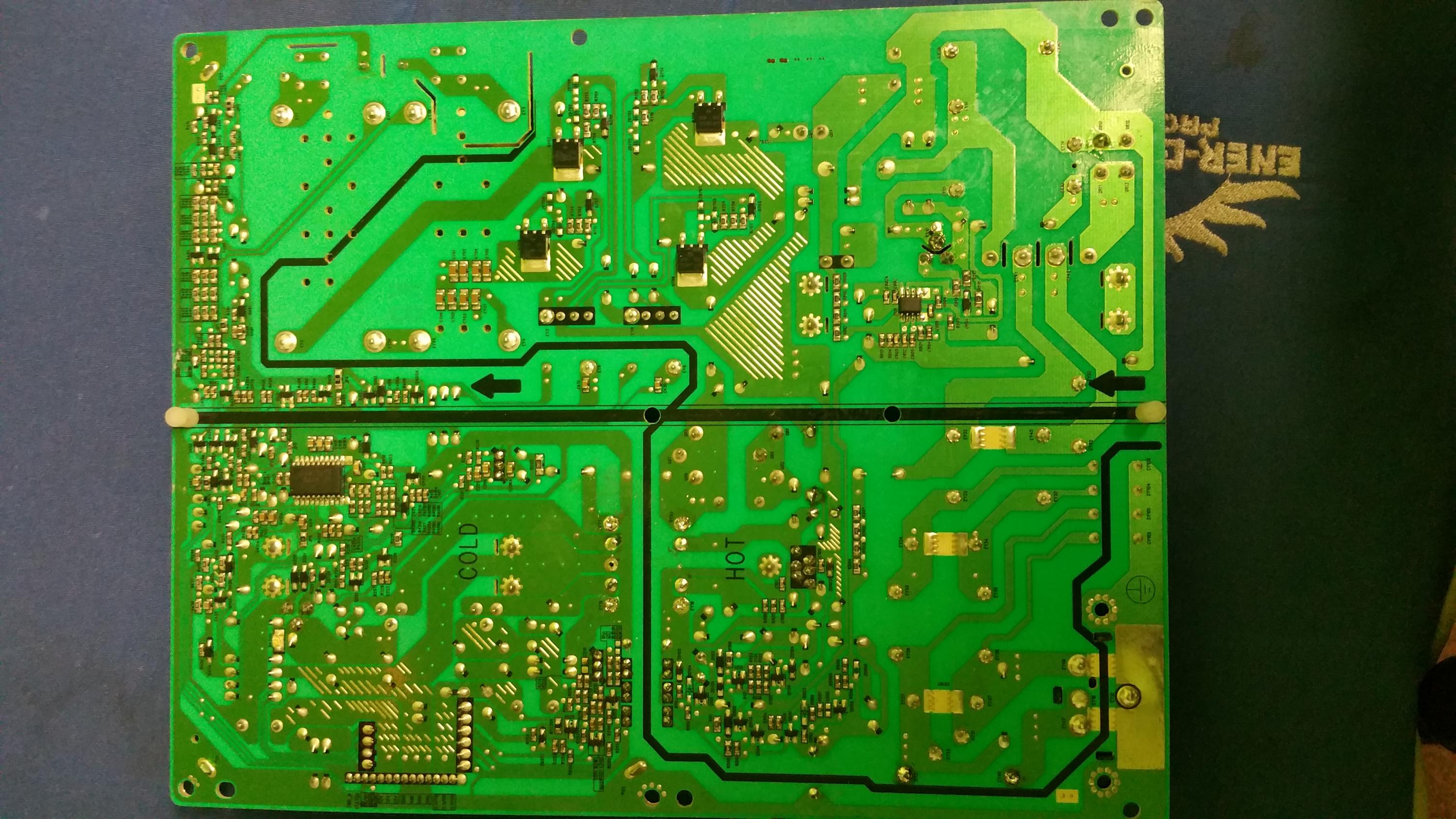

    Hi everyone i have and VIZIO E321VL with no out put volts on the secondary side of the board i bought the power board kit from eBay and still no power on the out put on the secondary side of the power boar i mean no 5v,12v,or 24v i only have ac volts on the primary side please help much will be appreciated.
    Re: VIZIO E321VL no dc out put volts on the secondary side of the board
    http://www.shopjimmy.com/catalogsear...q=VIZIO+E321VL
    Which one is the exact matched of your power supply board?
    Do you have about 160VDC between the + and - of the main filter cap in the primary side?
    BTW, your picture is too blur for my eyes.
      hi thanks for the reply yes am getting 168 volts across the main cap on the primary side

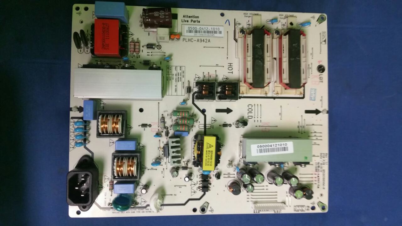

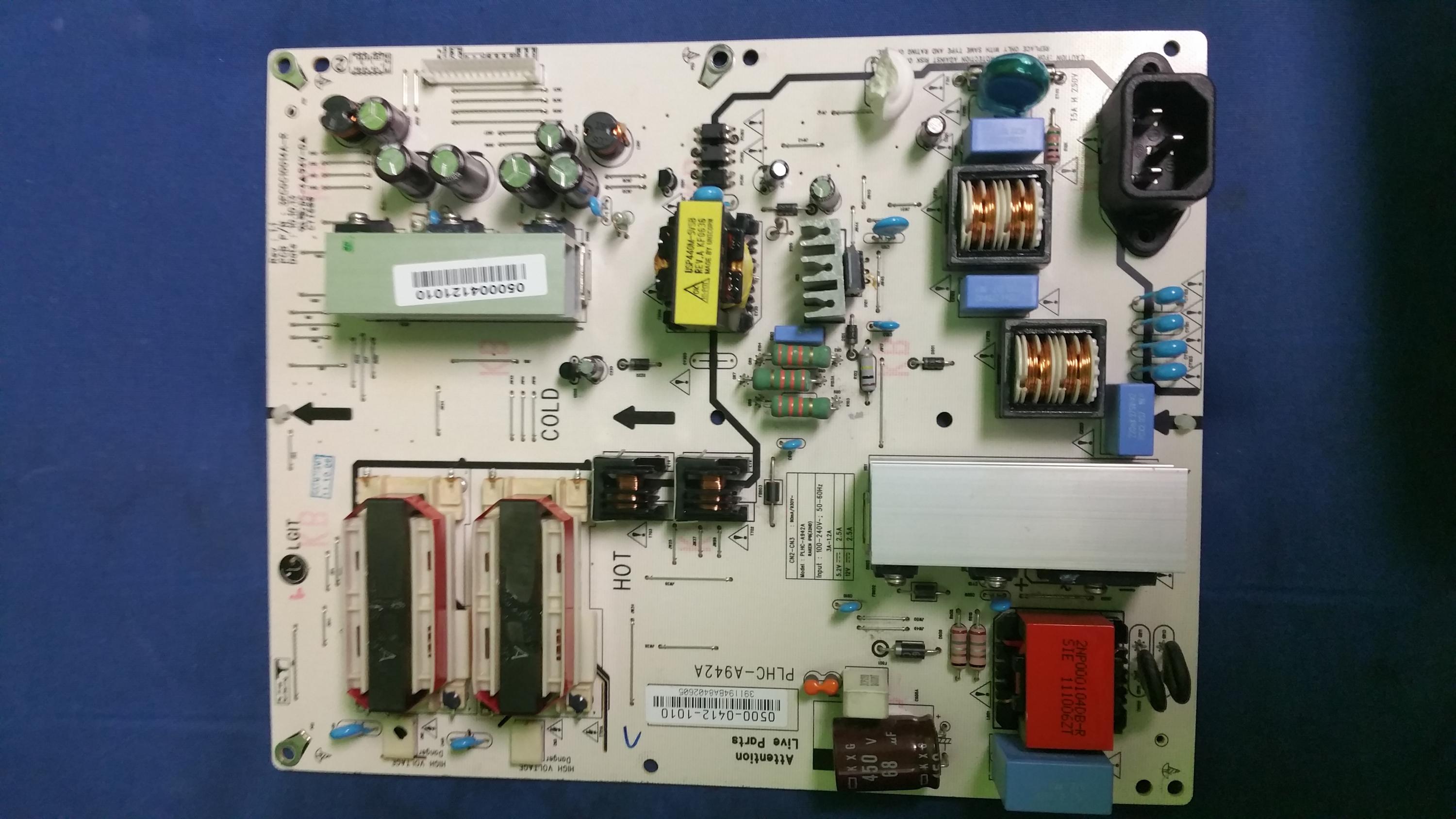

          every thing on the primary side is working can you tell me this what creats 5v ,and 12v,24v on the secondary side
            How did you figure that?
            It is not working that is why you do not have the standby 5V.
            That small yellow transformer is the one that generates the Standby Voltage.
            It looks like some one did not install the SMPS IC (next to the yellow transformer) back on the heatsink properly, I can see the gap between the heatsink and the body of the IC., the mounting screw is missing? What is the story on this board, someone messing with it and not putting the part back in properly.
            Your pictures are so bad I cannot even read any labels on the board. So which one is your board?

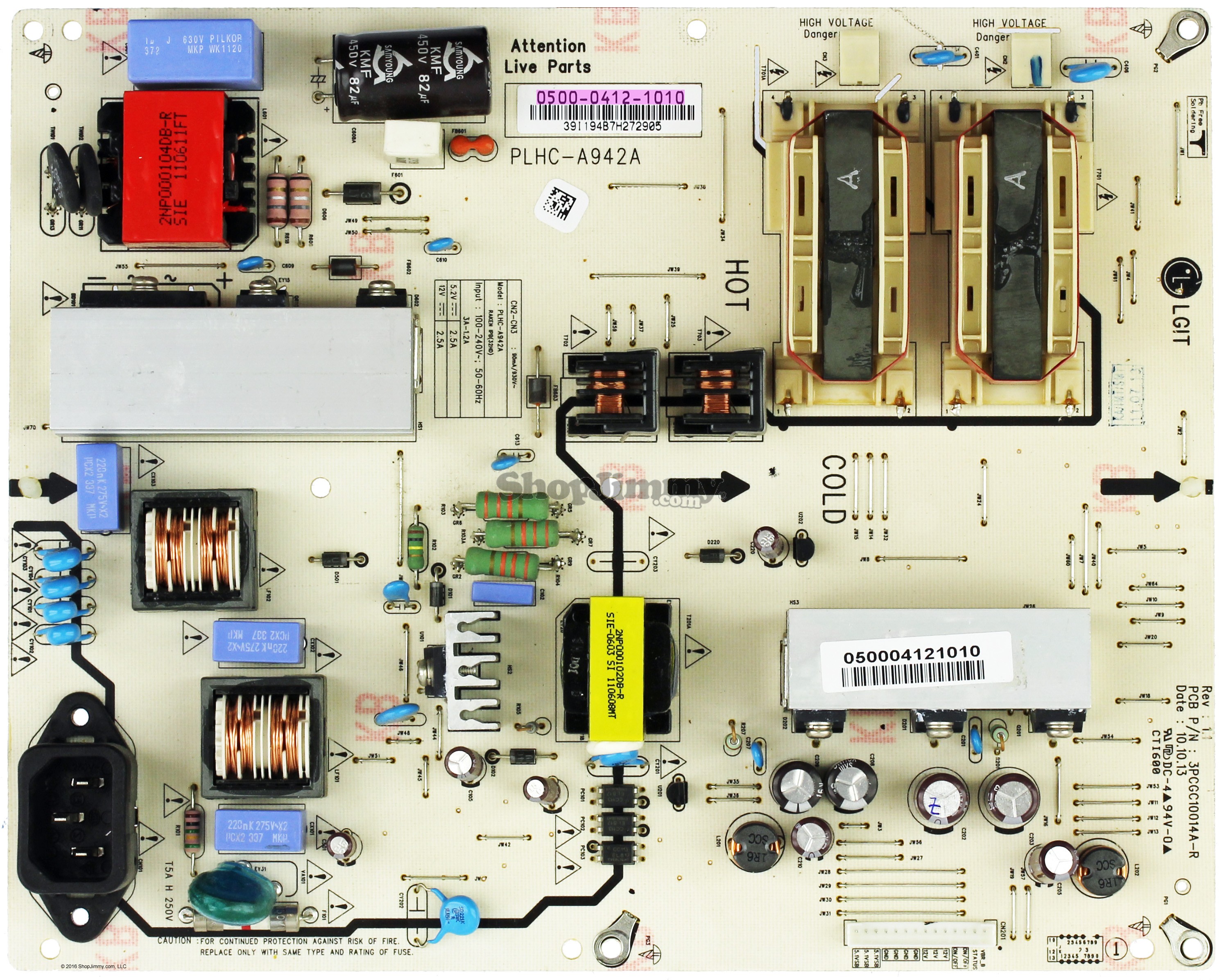

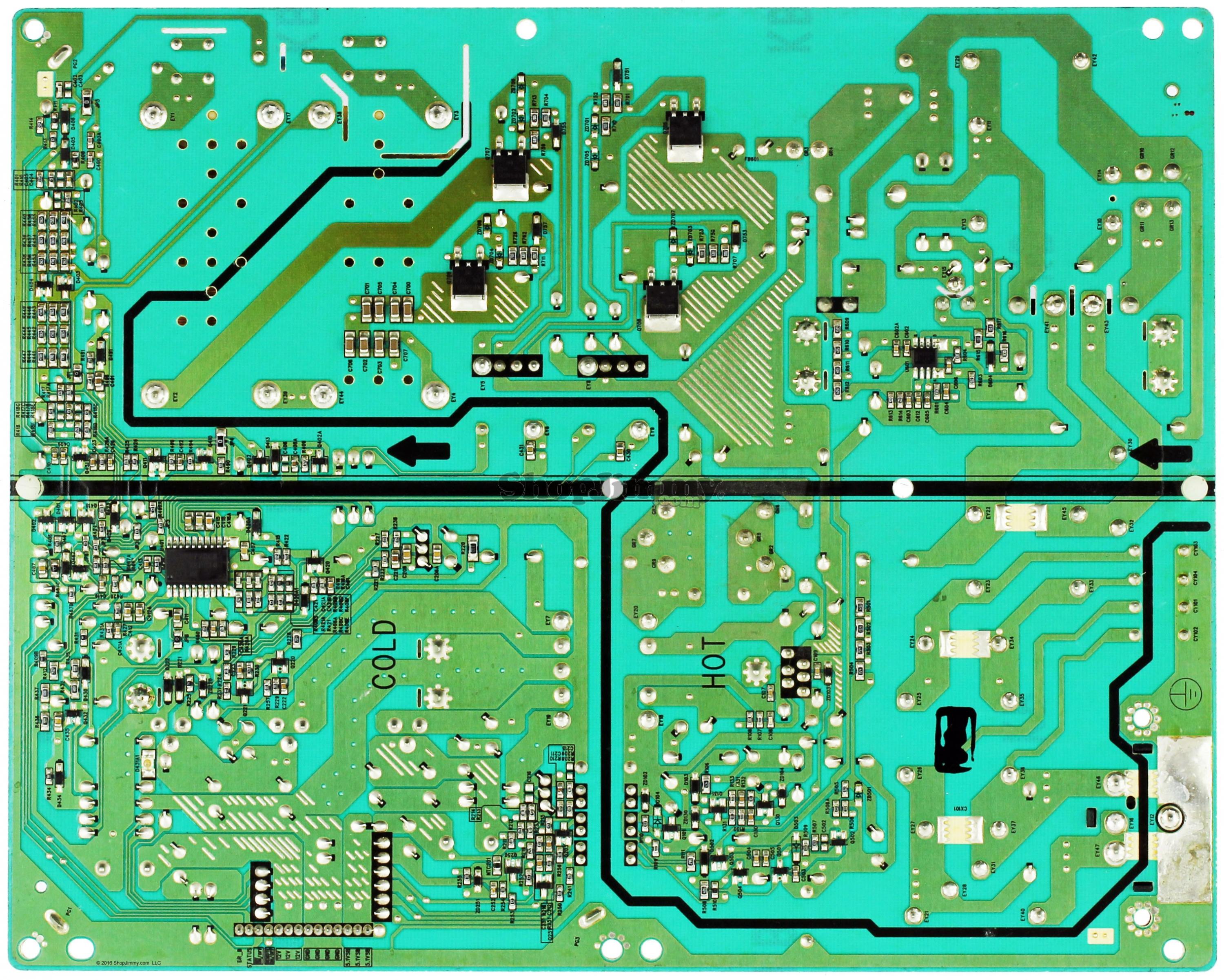

              Your board:
              http://www.shopjimmy.com/vizio-0500-...upply-unit.htm
              Vizio 0500-0412-1010 Power Supply / Backlight Inverter
              Some one messed with the board before you?
              Pictures provided by shopjimmy.
                hi thanks i replace that part with a new one i have to put back in the screw when the board start working properly am not sure if some one mess with before me yes this is the right board Vizio 0500-0412-1010 Power Supply / Backlight Inverter.
