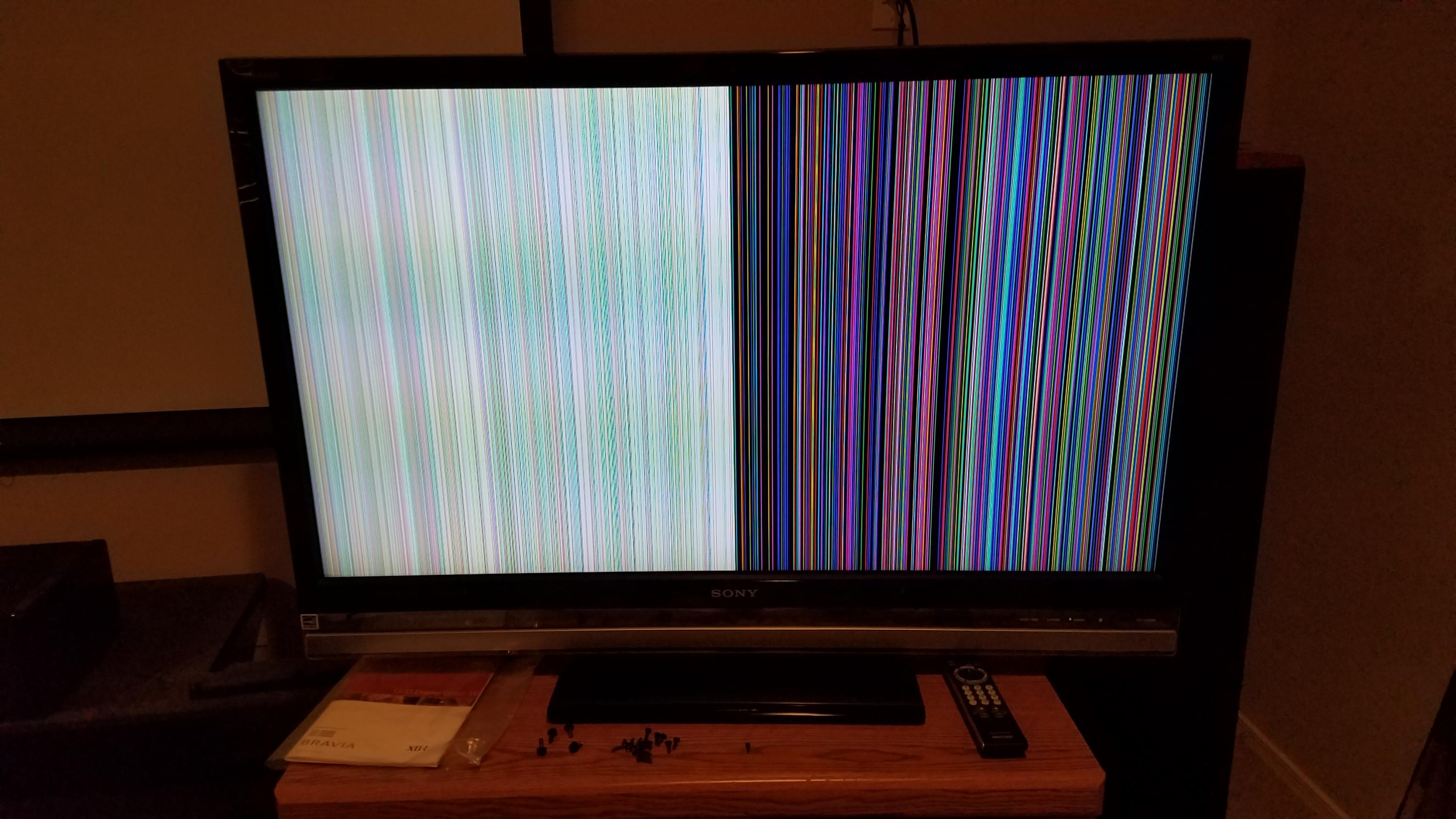

    A friend of mine gave me this Sony KDL-46XBR6. Initially, it would work for a while (picture looked perfect and had sound) and after 30 minutes to a couple hours the screen would turn pink & green plaid (no other picture) but sound would continue. I read up on it and figured it was the T-Con board. After testing it for a few days eventually the picture went totally black and the TV shut off with 14 blinks. Again, I read up on it and people pointed to T-Con board.
    So, I replaced the T-Con board. eBay seller sent me the replacement and I installed it and got the attached photo. I get that picture and I still get audio, but TV shuts off after a 30 seconds or so with 14 blink code. Note that with the old T-Con board, before it broke, I did not have the white overlay on the left side of the screen.
    Bad replacement T-Con board? Or do you think something else may have gone bad as well based on the picture.

    disconnect one side of the tcon board, check the pic and then do the other half and see what you get.

      I'm working on the same model problem child. I've ordered 3 tcons off ebay and got 3 bad ones with open surface mount fuse on the board back side and 14 blink code. Returned them all fortunately. About to check the fourth board. They are expensive and you might want to consider paid repair of the board. OTOH, double check the seating of the two ribbon cables. Inaccurate placement will cause just the issue in your photo.

        Just to follow up on this issue, I returned the T-Con that I had bought off of eBay and received a full refund. I was able to pick up another used T-Con from a different seller on eBay for $49. 2nd times a charm. Installed it today and the TV is working beautifully!
          I re-seated the ribbon cables a bunch of times and it did not fix the problem. That T-Con board was definitely defective. The new board, I popped it in and it worked on the first shot.

            Was the tag number on the board that fixed your set 55.46T02.C05 or 55.46T03.C03? I have the same problem child Sony model for a year now. Every ebay T-con I bought except the last one has had an open fuse. None worked. This new t-con is a 55.46T03.C03. The seller said it had a good picture on his parts TV. All I got with it on my TV was a backlit black screen followed by shutdown to 14 blinks. The seller thought it would be incompatible with a panel that came with a 55.46T02.C05.
            Shopjimmy (and every seller who copies them) says the two parts are compatible. What do you think?
            I've been unable to find 55.46T02.C05 anywhere selling under $120, and one even was posted last month for $200! So I hope you got a 55.46T03.C03 that worked.

              Are you checking fuses after you install or before?

                The replacement board was indeed a 55.46T03.C03 (http://www.ebay.com/itm/282479632091), as was my original board.
                I think there are a lot of bad boards out there and sellers who don't really test their parts.

                  I had one with a blown fuse and I took an alligator clip and put it across the fuse and the tv worked. I scavenged a fuse from my mountain of donor boards and put it right over the bad one. Soldered it in and its still good to go(1 month)
