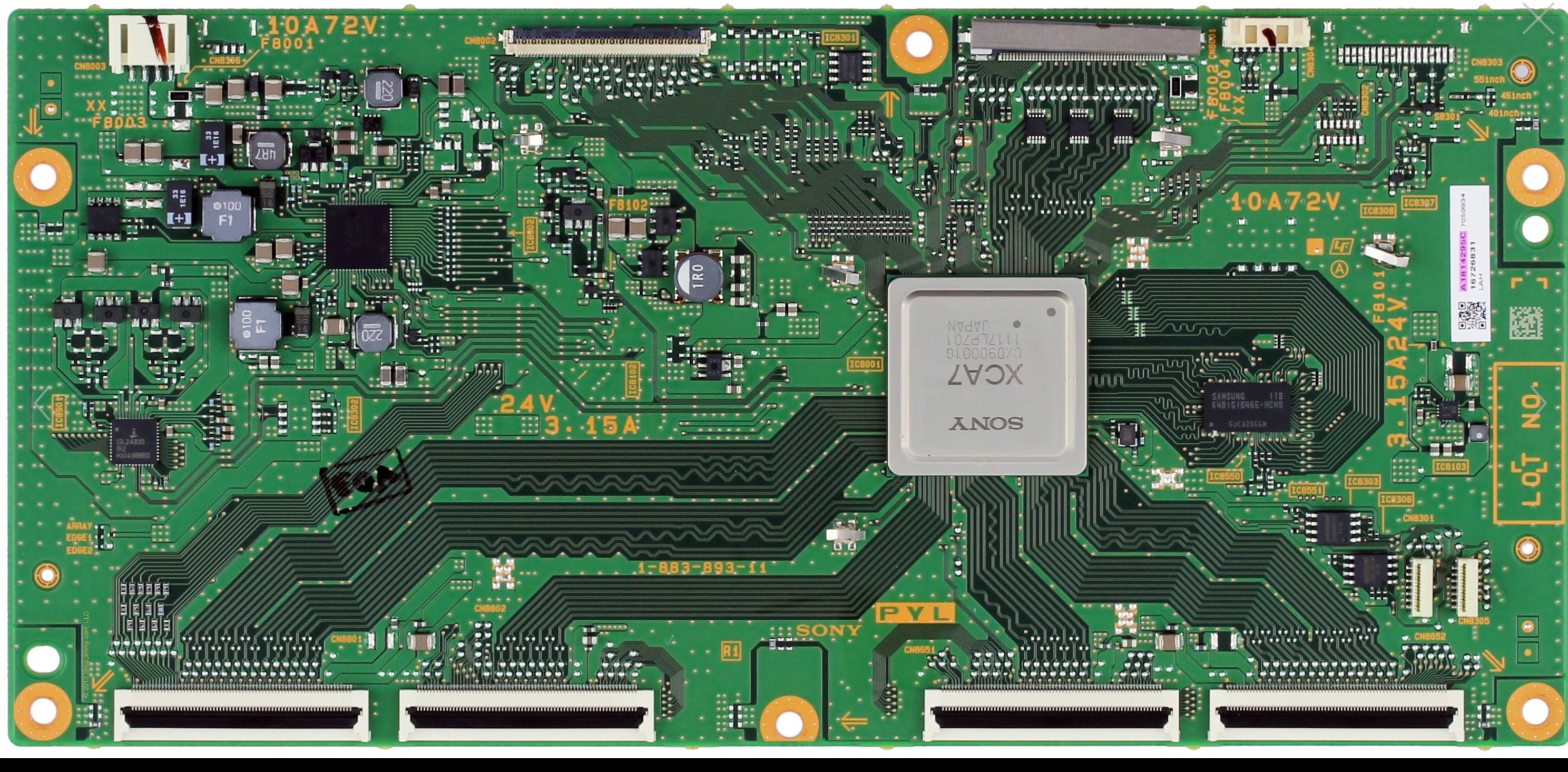

    HI
    Made a mistake and ordered the wrong TCON board to replace in my KDL-46HX823, the board I ordered was Sony PLY 1-883-893-11 which is sort of correct.
    But later realized this board is used in 4 or 5 models, any way the one i got sent was for KDL-55HX820.
    Physically these boards are identical, everything on the board is the same. I havent put this board into the TV yet, but am I right in saying all i would have to do is copy the Epprom from my faulty board and transfere it on to the new board, or is there still something else that may stop this working.
    Thanks in advance for any help.

    are you sure it had eeprom on it... can you show us photo of the both

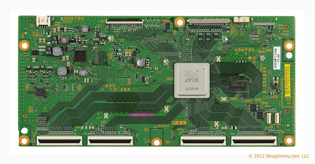

      Hi Thanks for your reply.
      The first pic is the board I should have purchased, the second is the actual board purchased.
      Identical apart for one is for 46 the other 55

        Re: Ordered Wrong TCON Board For Sony TV, Can I flash Epprom
        Look the same BUT not the same, see how the sticker numbers do not match?
          however it may work but my advice Don't do it, there are big risk to yours panel COFs. it look yours set 3D and there other chips aligned to.
            Might be worth comparing other components on both boards , as you will most probably find other differences to discrete components values & positions .
            I carried this out on a Sony set about a year ago , although it wasn't a 3D TV .
            Couldn't find the correct T-CON & bought closest i could find , as with yours , different display size .
            Took me the whole day swapping out components to ensure a match, plus the NVM.
            It did work though .
            Long as the main BGA doesn't have an internal flash , you should be fine .

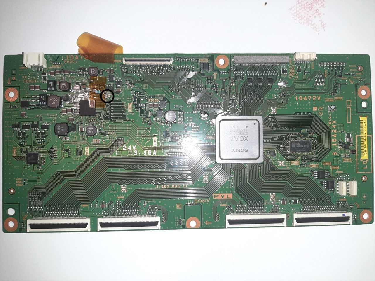

                          Originally posted by Diah
                          Yours Sony build in Option " Self diagnose Mode" you can access to this when the set at stand by.. there you will see if any error registered and at which parts... did you log on this mode ? if no then you need and show us the screen shoot of the result.
                          Oh Man, I have another problem now. I really hope someone can get me back to where I was before.
                          This board was repaired before I have attached an image of the repair, wasnt done by me.
                          Any way see the resistor bridge, i stupidly touched the end of it to see if it was making proper connection and if that what was causing the problem. With power on....
                          Any way see the 2 components I have circled I accidentally touched these together with tip of screwdriver and got a spark. Now TV not turning on, only 5 flashing red blinks.
                          Can anyone help me sort this.
                            yours t-con fuse of 12v get open.
                            buy exact t-con and save time & set together
                              Ok Thanks anyway for your help.
                              Both fuses testing good.
                              Unfortunately not so easy to source new exact board. Would rather try get this back to how it was.
