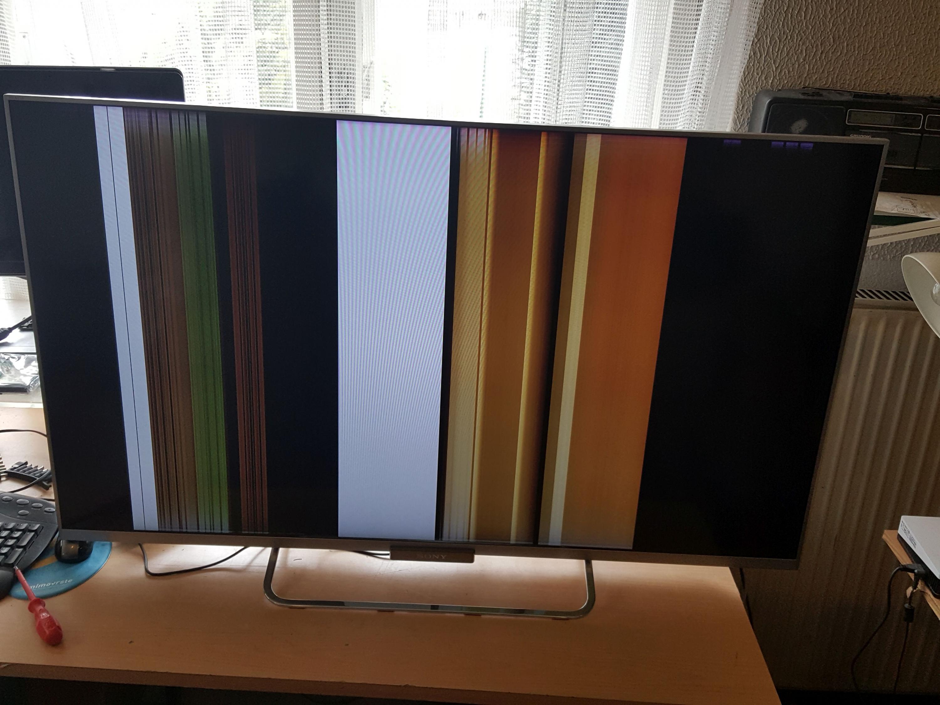

Sony KDL-50W656 vertical colored lines

    Sony KDL-50W656 has colored vertical lines, they change color when getting into menus with remote, etc ...
    What could be wrong, panel gone bad?
    Regards

    Re: Sony KDL-50W656 vertical colored lines
    Yes this could be a bad panel....However, first I would, before concluding that this is actually the case.....clean and re-seat the LVDS cable from the Main Bd to the T-CON Bd and the Flat cables from the T-CON Bd to the panel. Of course, doing these re-seats with the power OFF.
      Ok, I re-seated cables, but problem remains. Contacted some service here, they said it's possible t-con problem, t-con is not simple to replace, it's integrated on display board ... they said to deliver tv to them, and they'll see if it's repairable...
      Thanks for help
