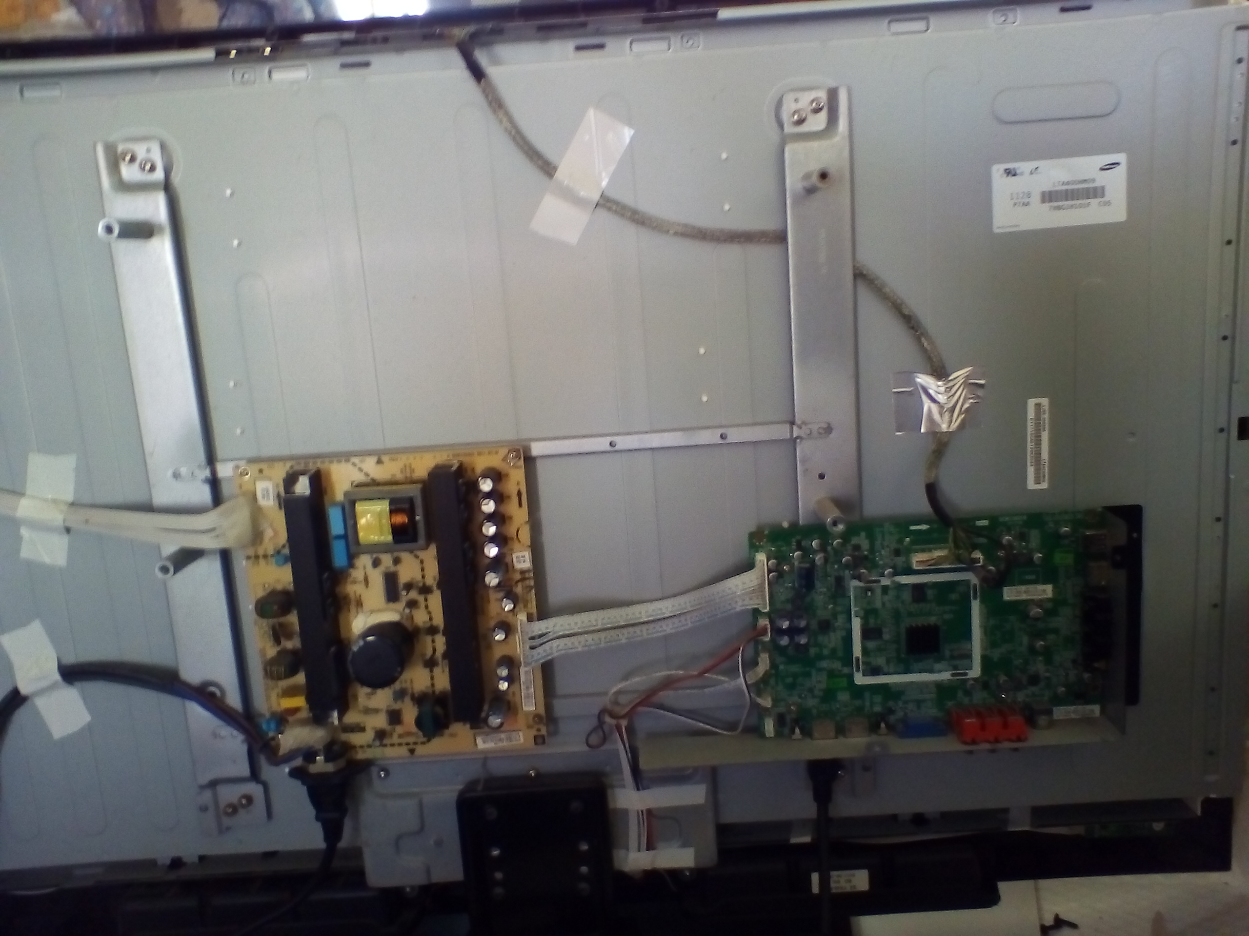

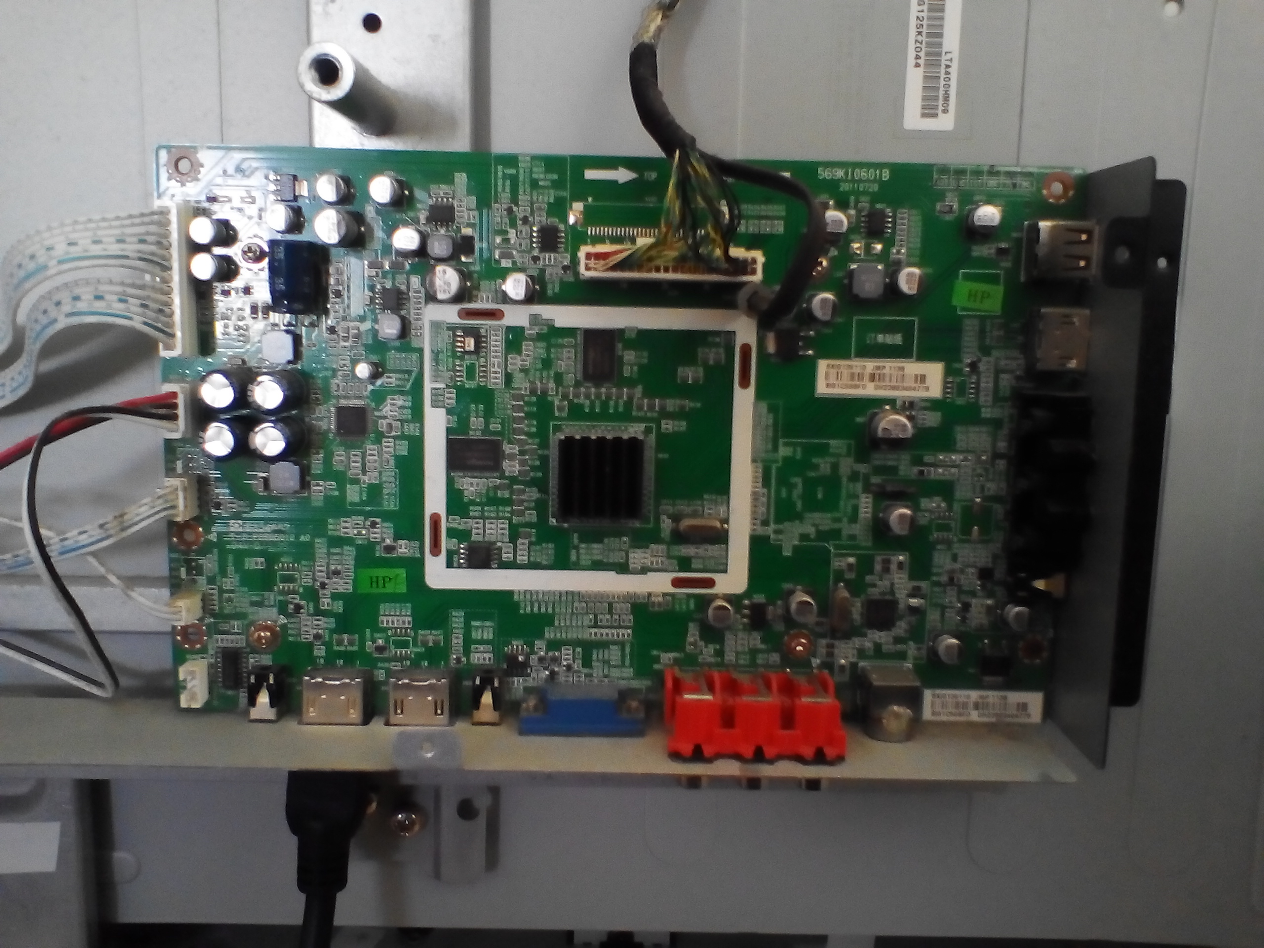

Hi all. Given this 2011 model the Sanyo logo comes up at start and that is all but does have sound. Power board output voltages all check OK. Nothing obvious seen. To me the screen output other than picture does seem ok but menus etc do not display. Main is 569KI0601B no maker name and LCD is Samsung. Anyone with experience these models? Pics to follow.

I think you may be right that they don't as I can't see any light from rear view (none of the usual holes) and its sus that no menu comes up. There is 24v output from power board. Will take cover off and see what I can on screen output boards.Comment
Re: Sanyo LCD40XR11F sound no picture -mainboard?
Quick look over nothing standing out and fuse checks OK. No real idea of voltages nothing marked except fuse nothing blown appears as if test points top and bottom but no markings. Will post a pic later.Attached Filesif you find these attachements useful please consider making a small donation to the site

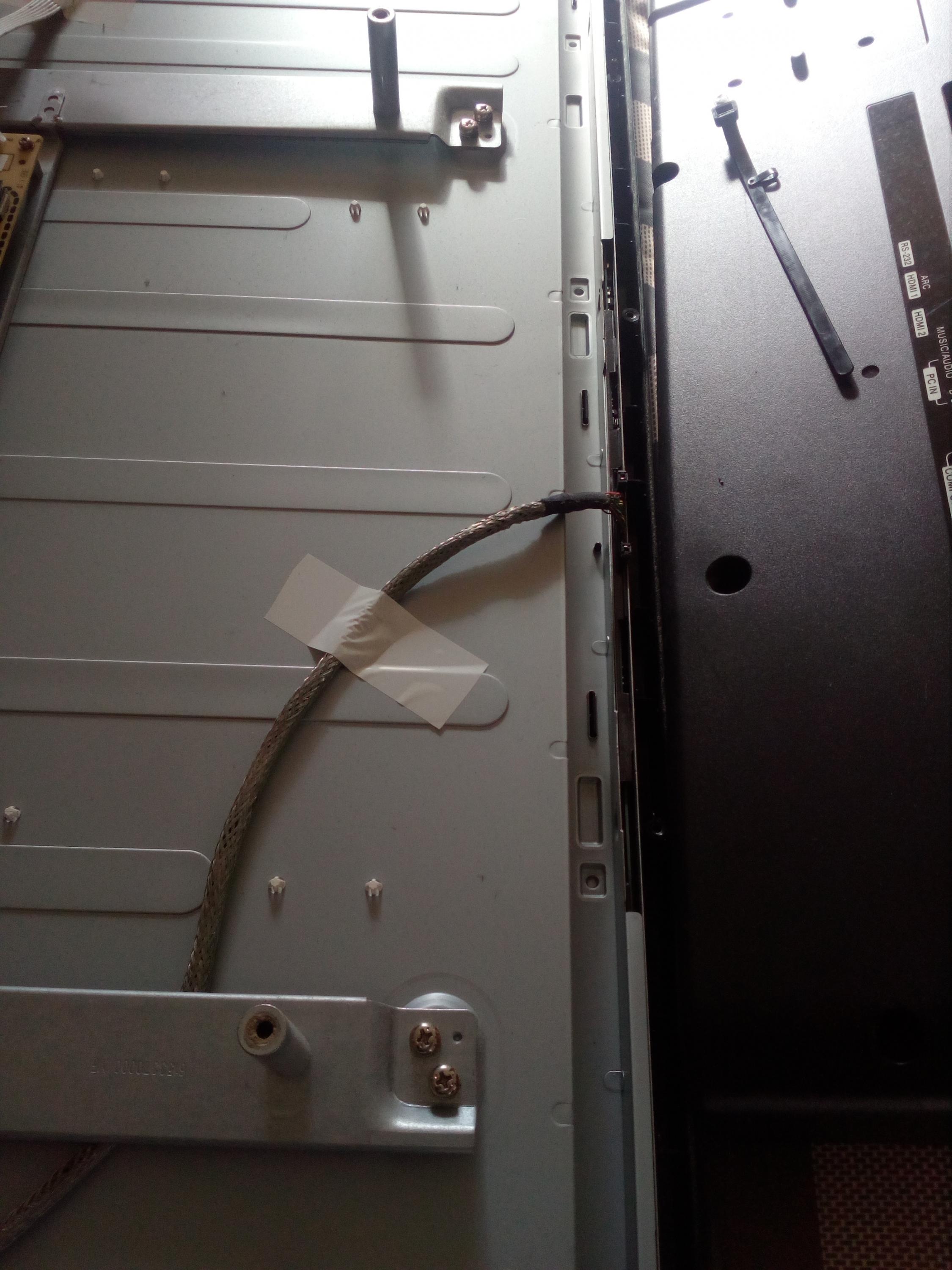

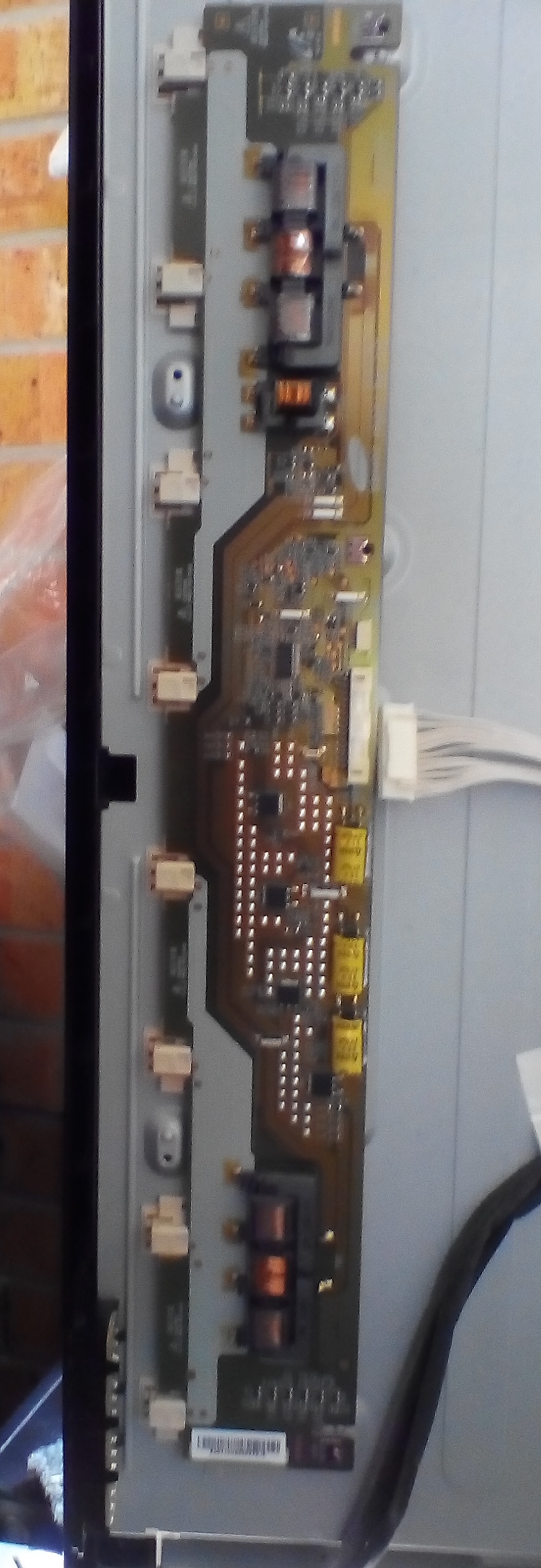

Took cover off inverter and this revealed two holes thru which I can see that backlight comes on for a second then off. I understand board can have an overload protection circuit switch which can be bypassed for testing for a few minutes but will give that a miss. Inverter is SS1400_08A01 rev 0.2 and a lot of these available around $20/30 from overseas.Comment
Yes I am punting on the inverter as ccfl beyond my scope - no indication of arcing seen or heard. This set is one of nine acquired in the past week. My work tools consist of mm , soldering iron, set of screwdrivers and very limited space - hobbyist only.Comment

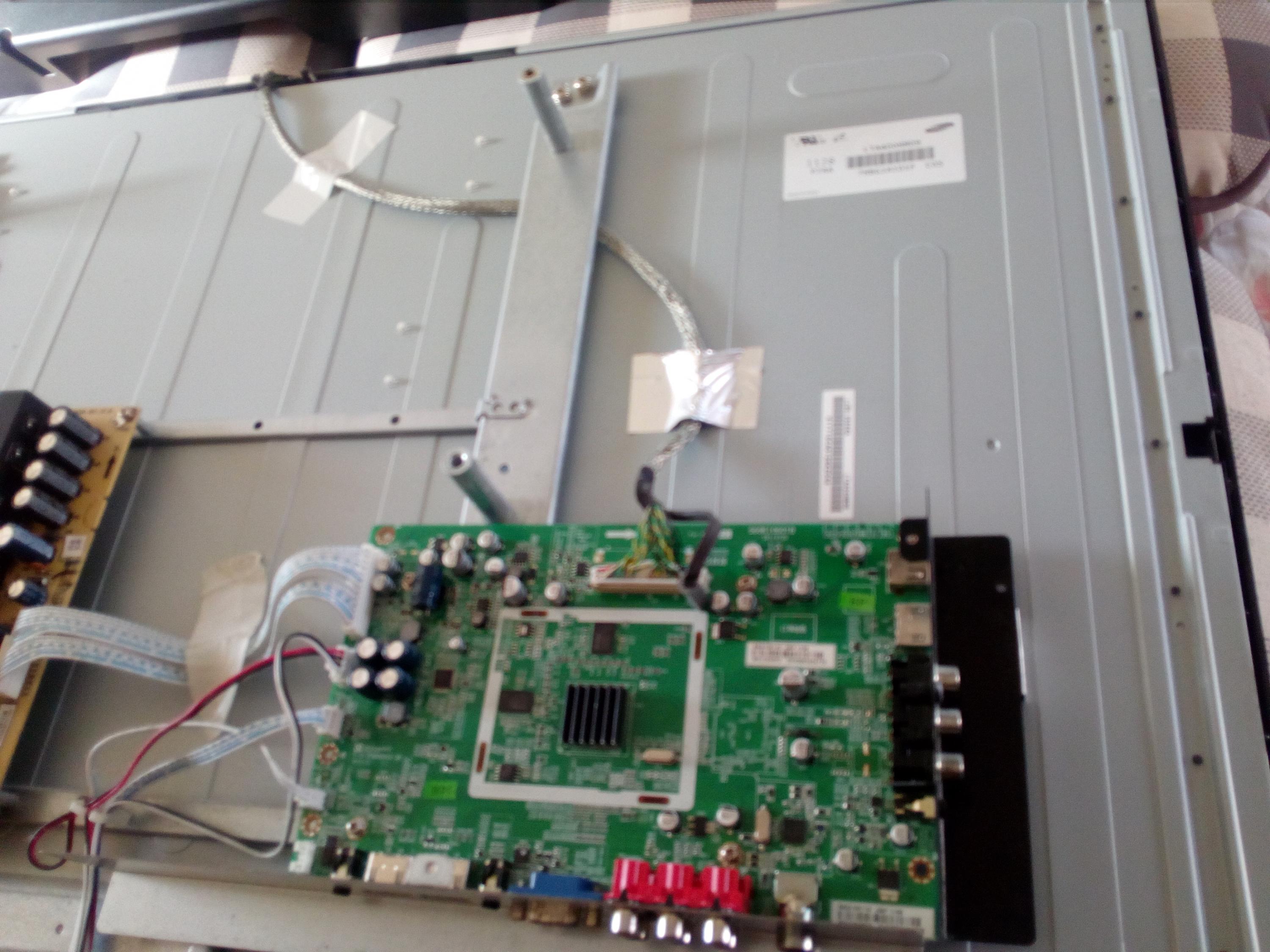

After some weeks received new inverter board (and it does indeed look new) which went well but after about 15 mins picture jumped around sound went out of synch then all settled down but with about half inch strip of red colour across bottom of screen. Looks a bit like a foldover. Now after many weeks pulled set apart again to check t-con but where is it?? On main board or locked in screen frame?? See picsAttached Filesif you find these attachements useful please consider making a small donation to the site
The Tcon appears to be the long narrow pcb the cable connects to in 2nd photoWilling to help but I'm no expert.Comment
Yes it does and to get it out looks like a pull a lot of frame apart. But I do wonder why the white square is marked out on the main board.Comment
The blank main board PCB can be stuffed with difference parts to create a bunch of PCBAs for the required TV models.
That LCD panel had integrated T-CON/Tab bonding boardsNever stop learning
http://www.badcaps.net/forum/showthread.php?t=24809Comment
Thanks guys. So right !! Found an old post herein showing panel failure pics and confirming integrated t-con with screen. Win some lose some.Comment
Check the smd capacitors on the integrated Tcon board for short circuit. Some forum users have been very lucky and found the fault to be just capacitor failure.Willing to help but I'm no expert.Comment
