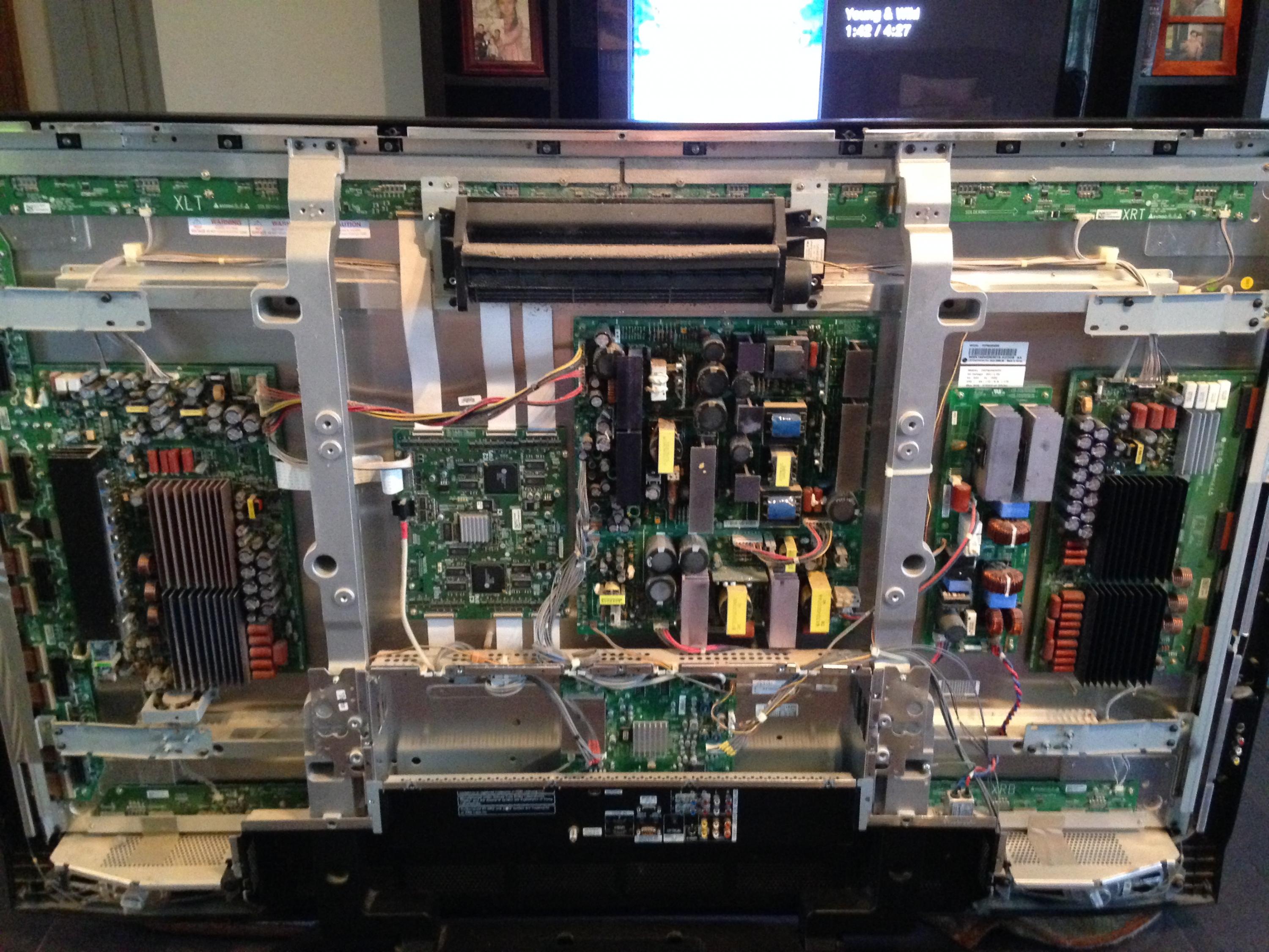

    PLASMA LG 60pc1d Flash on cold start
    this is a 2006 LG 60pc1d Plasma TV....first time ever I open an plasma tv and....OMG!!! so much thing in it!!!! So I found one bad caps that I changed. But the problem is still there
    the tv, on cold start, flash vertical red line for about 2 min then the picture is ok
    Any idea by where to start? seriously, this is soooooo much complexe than the LDC Monitor I normally repair
    thanks
    heres a video : https://www.youtube.com/watch?v=upipmbyyx1k

        Its most likely more caps that are failed but have not blew up, replace all Samwha WB and WL brand capacitors on the power supply first.

            Re: PLASMA LG 60pc1d Flash on cold start
            Since there is a LOT of board, can you help me to clarify which board is what
            I mean, the one where the power cord go is the power board but there is only one HUGE capacitor, then, the wires goes to the central board, is that another power board?
            thanks
              I repaired a bad caps on the power board but the problem is still there, I have tested the buffer board (http://blog.coppelltvrepair.com/2010...-lines-in.html) but they seem ok too...
                What voltages are you getting? Are you getting vs va voltages? No then try disconnecting y and x mains and see if it turns on. Still no va and vs? then focus there,,, getting standby on powerboard?. Is mains sending on signal? Your va and vs voltage reference is on a sticker back of panel.
                Looking at the back of set your y main is on left connected to buffers. On right is your x main , center is power board and mainboard is obvious and below the powerboard. The smaller board next to powerboard with all the flat ribbons going to it is like your tcon in lcds. Btw this plasma has a split power supply design hence 2 boards might be 3 hard to tell with fuzzy picture. I worked on a 60 inch vizio that has a tripple power supply design before.
