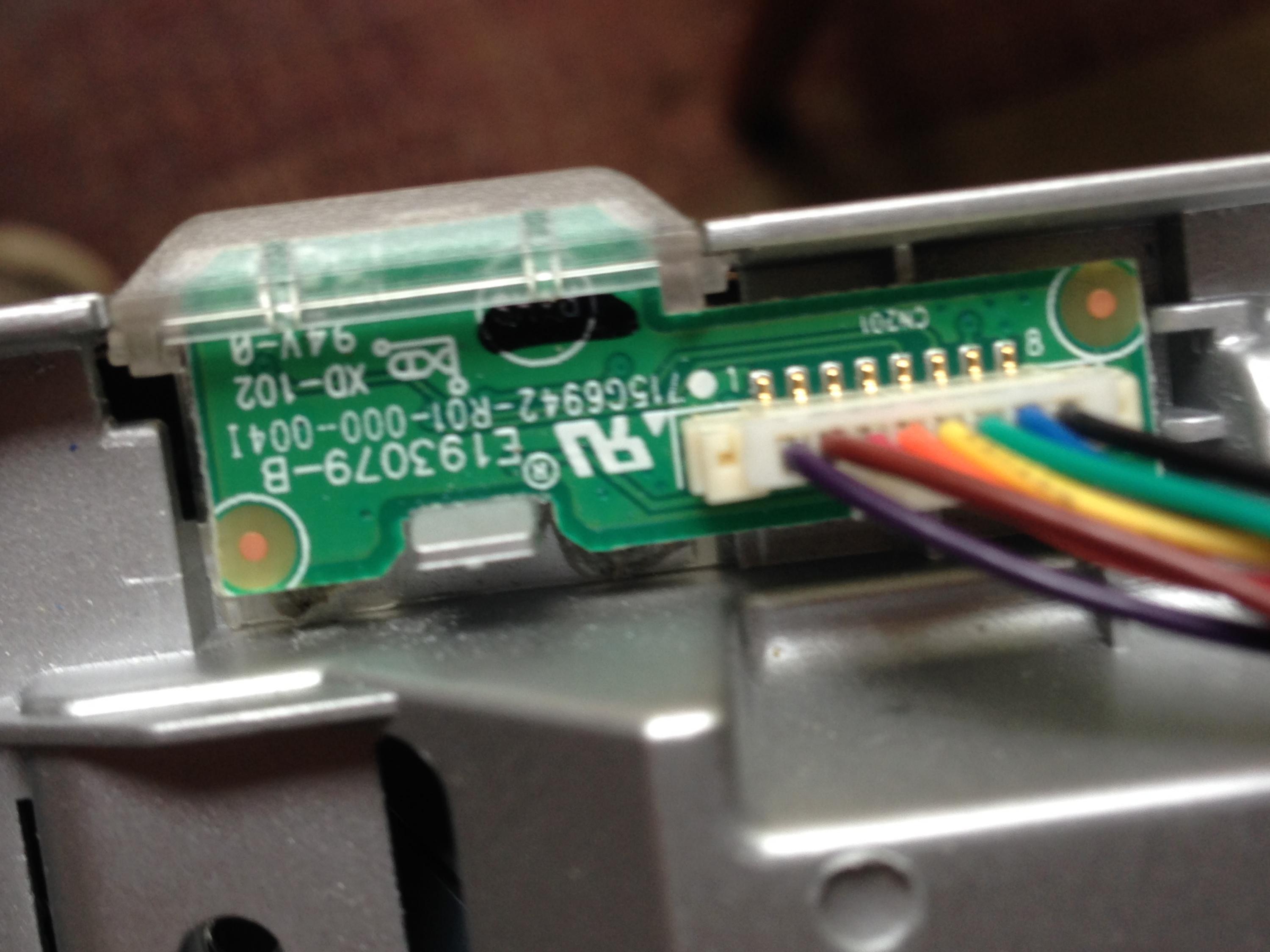

      Need picture of connector

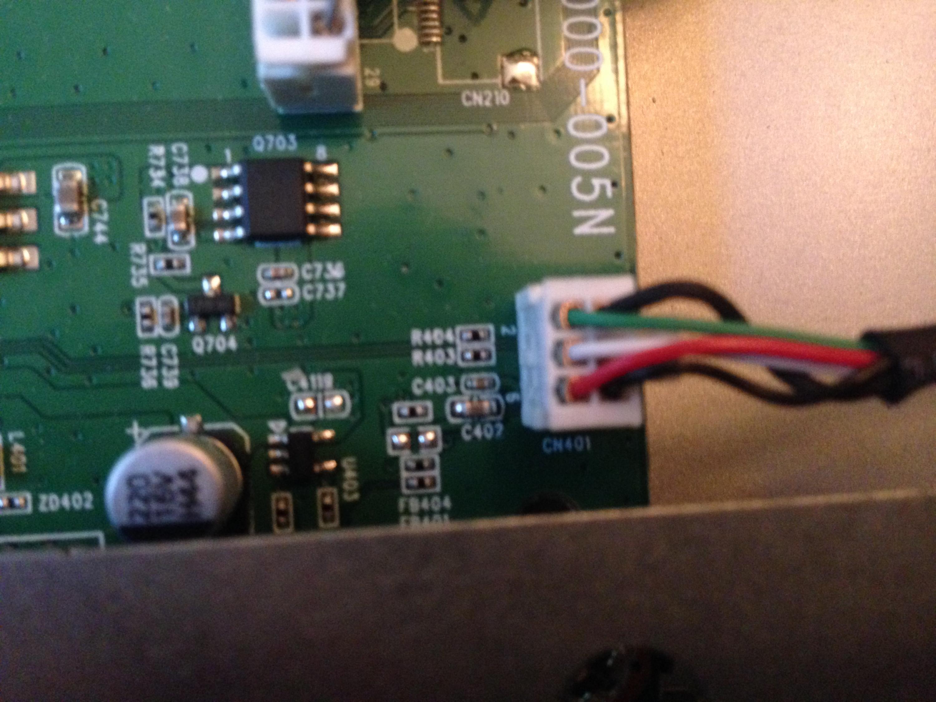

        Re: Vizio M502i-B1 won't turn on
        Here are pictures of both ends of connectir

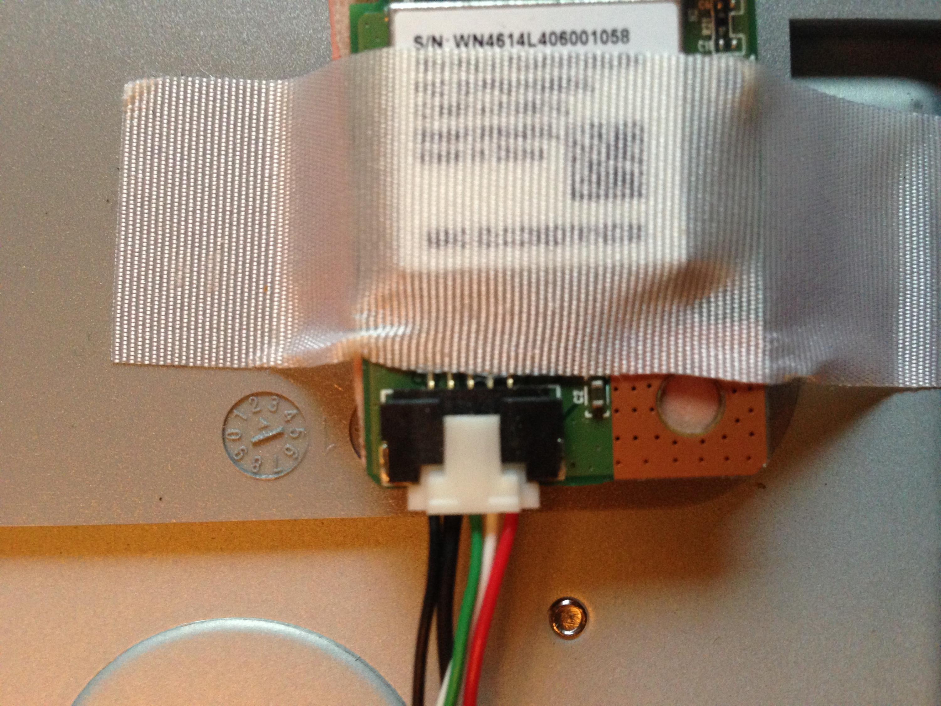

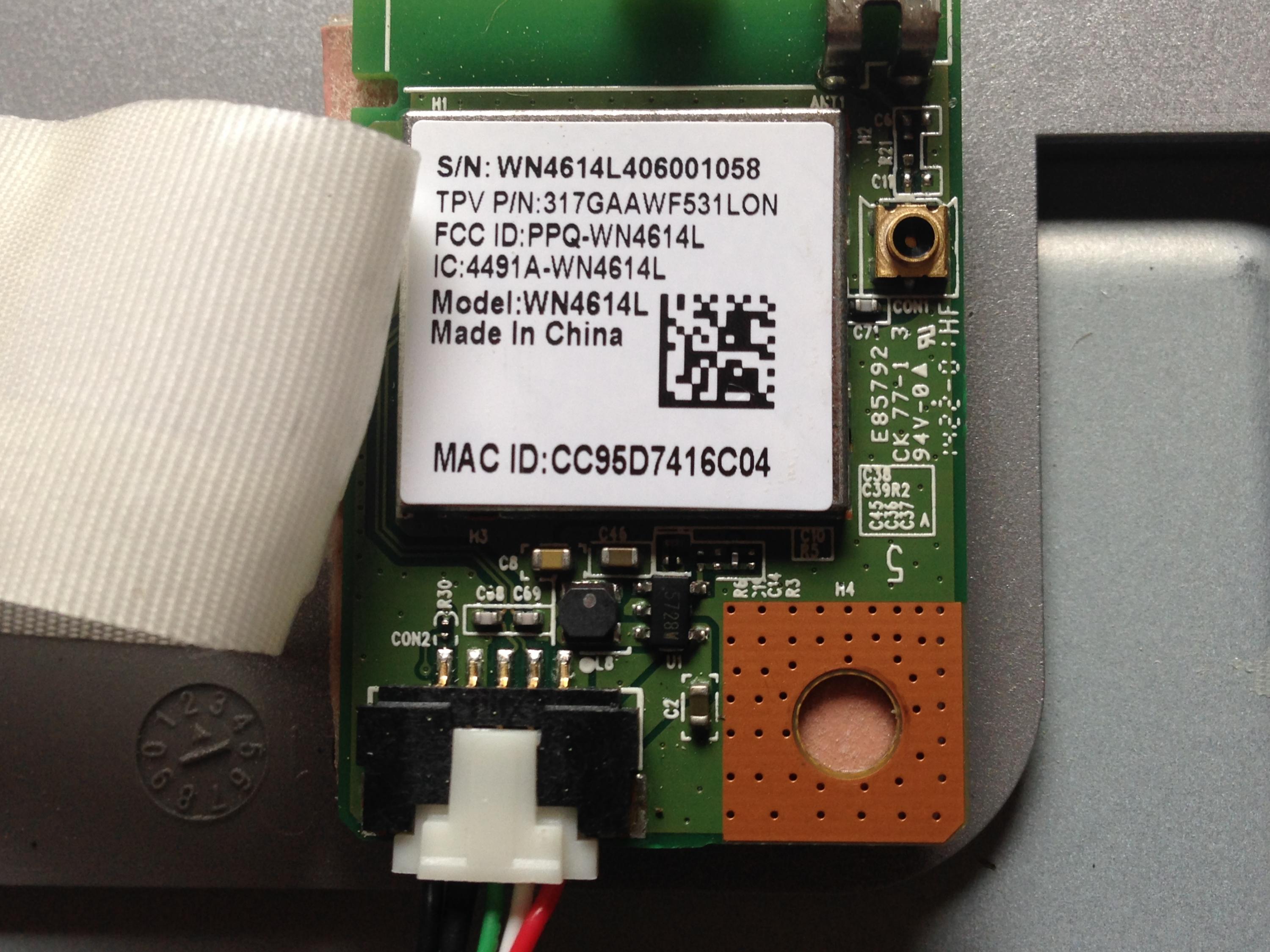

          That looks like WI-FI
                Here is a close up picture of the board I thought was the ir sensor board. I now believe it to be a wi Fi sensor. I did verify that the second black wire does indeed go to ground.(by continuity check on ohm meter). With the hold down tape off, I was able to obtain correct voltages as follows:
                Pin 1: Black 1 wire - 3.29 volts
                Pin 2: black wire - ground (0 volts)
                Pin 3: green wire - 3.25 volts
                Pin 4: white wire - 0 volts
                Pin 5: red wire - 5.07 volts
                However, voltages do not change as a result of pressing power button on remote

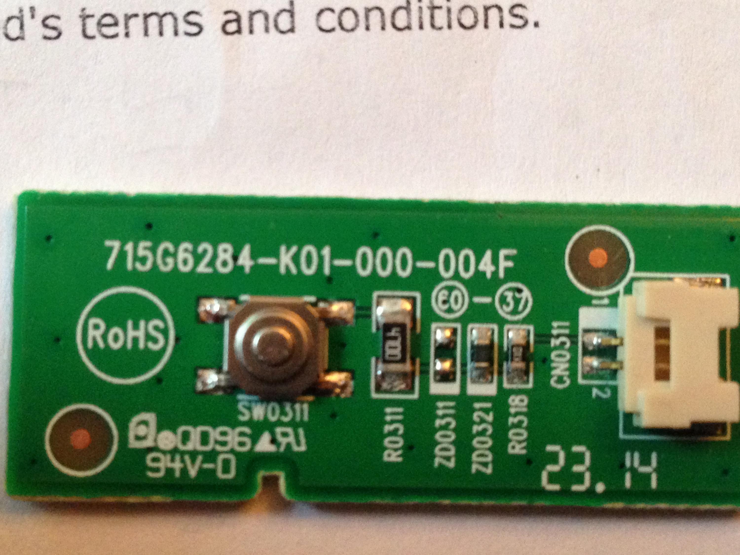

                                #35
                                Budwich:here is a picture of the on/off circuit board. For starters,the voltage on the two wires from the main circuit to the on/off board is 2.85volts. When the on/off button was depressed, the vintage drops to .3 volts. When the board is disconnected, the resistance on the two pins goes from infinte resistance to 479 ohms when the button is depressed. I suspect the zenor diode is open. I also drew a schematic of the board which I will send next

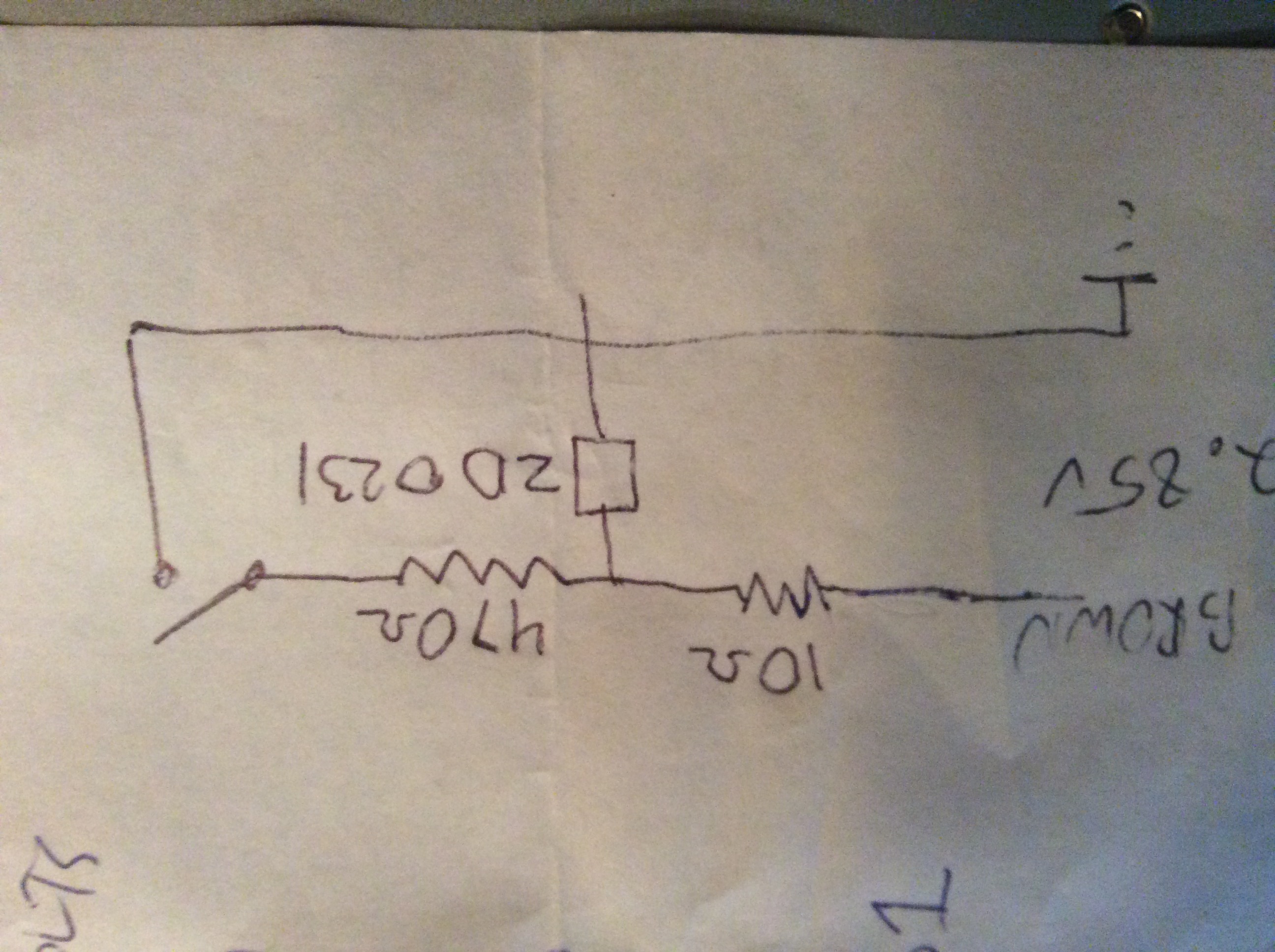

                                    #37
                                    Here is a drawing of the on/off circuit board that I drew from taking point to point resistance readings off. The Zenor diode appears to be open. I was wondering if any one had a suggestion as to what the zenor diode voltage rating should be. The incoming voltage is 2.85 volts. What do you suggest zenor diode zdo321 should be? The other question is what had happened just before the set quit. We had experinced power outages in the area where the power went on and off seven times. After the the power was restored, we were watching the tv and it went completely off.

                                      #38
                                      You can check it in diode test just like regular diode. You should get reading one way and . No short or open.

                                          #40
                                          Dskall: I did check it several times. I can absolutely tell you the diode shown as zdo0231 is open (infinite resistance in both directions using the diode setting in my digital vom). I suspect that with out the zenor diode operating, the supply voltage from the main circuit board, gets dragged down when the push button is depressed. However, I suspect with the zenor diode operating correctly, the voltage is allowed to stay above a certain value which feeds back to the main board. When the push button is depressed, it changes this voltage and the main board then senses this change and turns on the bl-on to the led driver board. I am only speculating on this because i don't have a schematic or a sense of how the on/off board actually works to turn on or off of the set. What zenor diode voltage would you suggest?
