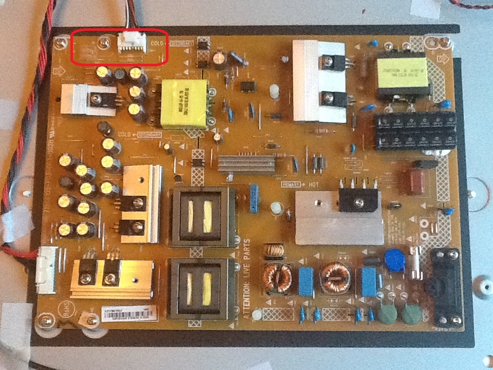

    I have a Vizio model M502I-B1 which doesn't turn on. No led back kites, no sound, nothing. I have tried power cycling and checked all Vizio related you tube videos but nothing seems to have tacked this issue. Overall, this set has 4 circuit boards as follows: power supply, led driver, main board and t-conn board. I have noticed a small(tiny) led that lights up on the main circuit board. At this point, I am trying to identify which board is bad.
    I have taken voltages on the power supply board (715G6100-P03-003-002h) at the two connectors.
    CN9101
    Suppose to be. Measured
    5 volts. 5.11 volts
    12 volts. 11.58 volts
    12 volts. 11.58 v
    24 volts. 19.58 volts
    CN9102
    24 volts. 19.58. Volts
    In this particular set, I do not see any markings on the power supply board near the cables that say standby power. I am assuming that the power supply board is energized all the time. I am of the opinion that something is dragging the 12 volt and 24 volt voltages down and perhaps the power supply board is ok. I would appreciate any assistance that can assist me in my trouble shooting.

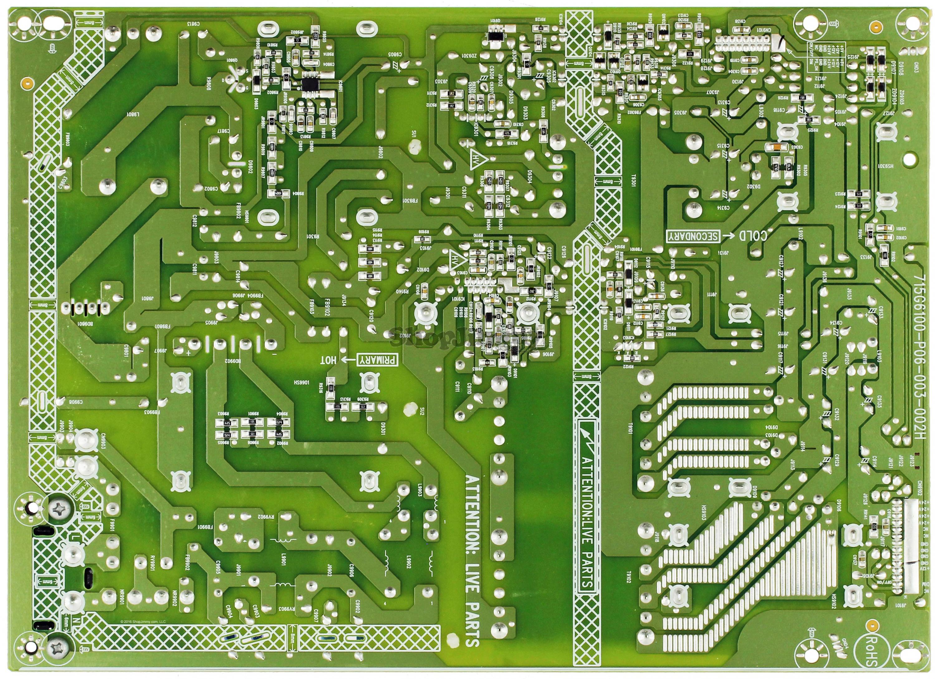

    Re: Vizio M502i-B1 won't turn on

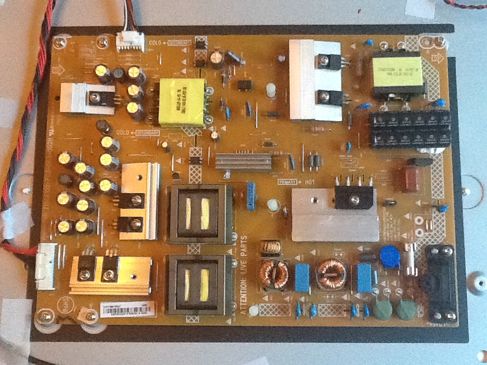

    Here is a picture of the power supply board

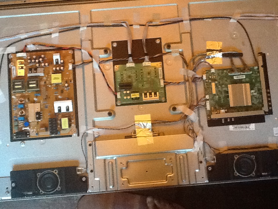

      Here is a picture of the back of the set showing all of the circuit boards.

        12v seems okay. Don't know how this tv works. If you unplug connector to led board does 24v come up? What is voltage across main caps?

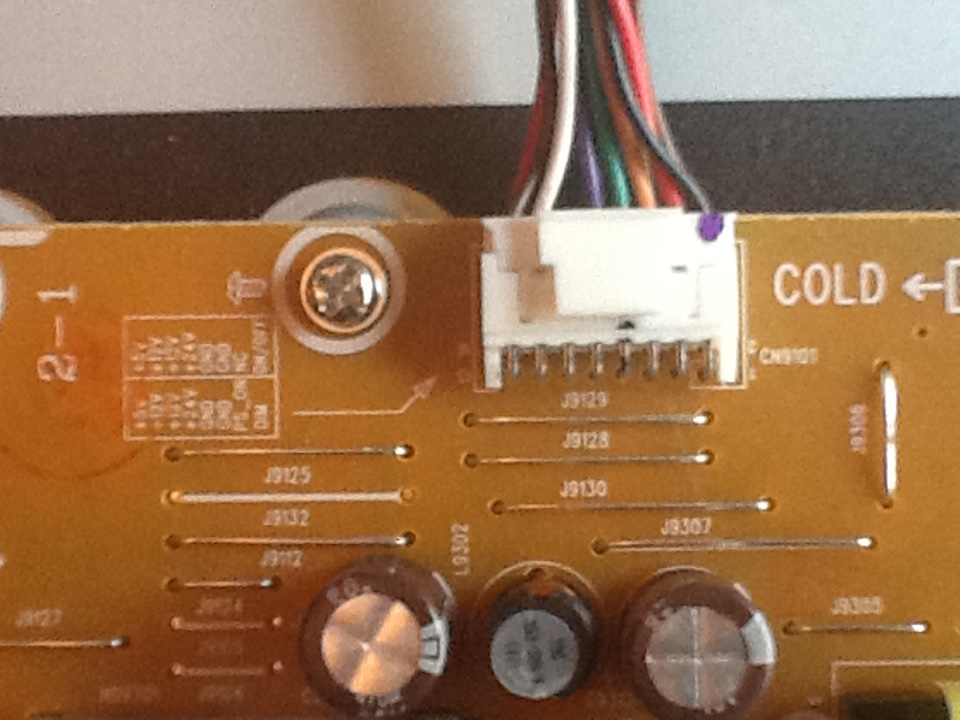

          Can you post a photo showing the legends and connector clearly.

            Thanks for replying. When I disconnect the top power supply connector (Cn9102) to the led driver board, the voltages at the power supply do not change at all. I have attached a closeup picture of the two connectors. One of the connectors (Cn9101) goes from the power supply board to the main circuit board. The other connector (CN9102)goes from the top of the power supply board to the led driver board. This is the connector in which I temporary removed to check voltages(which had no effect).
            Incidentally, there is a cable that runs between the Led driver board to the main circuit board that I didn't do anything with.

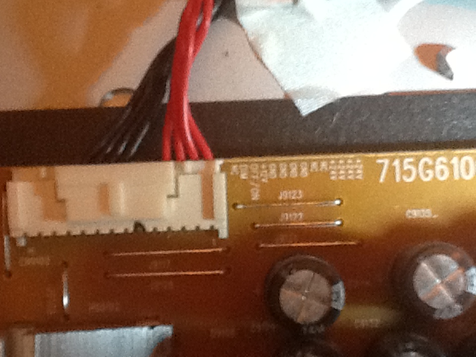

              Here is a picture of the other connector located towards the top of the tv (CN9102) which goes to the led driver board. I will next try and measure some voltages on the power supply caps

                Also, there are two main capacitors on the power supply board. I measured 393 volts on each of them separately. These caps have a 450 volt dc rating on both of them. No bulges on any of the capacitors in the power supply board that I can observe. Let me know what else I can do
                  The focus is poor and hard to read. The 393V across the capacitor I think would be correct or at least close to the value expected.
                  With the mainboard connected, what voltage do you have on PS_ON and ON/OFF with the set in standby and then when you try to switch it out of standby
                    Pput meter probe on the two legs of C820 then turn on the TV and watch and see how high the Voltage goes up to and how low it drops down to after 5 seconds, turn off the TV and then move the probes to the two legs of C821 and repeat the same test. You must keep the probes on the cap BEFORE TURNING ON THE TV.

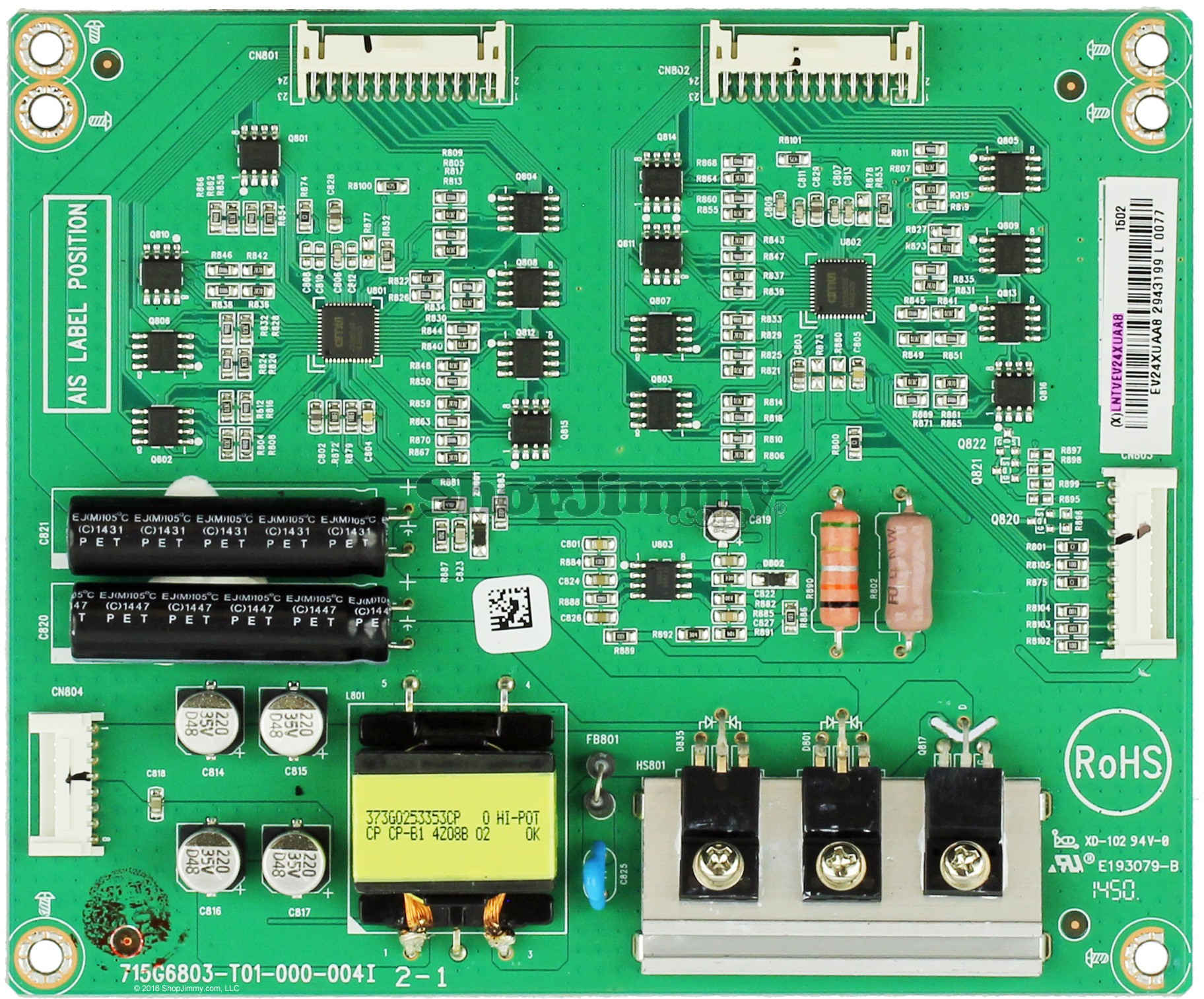

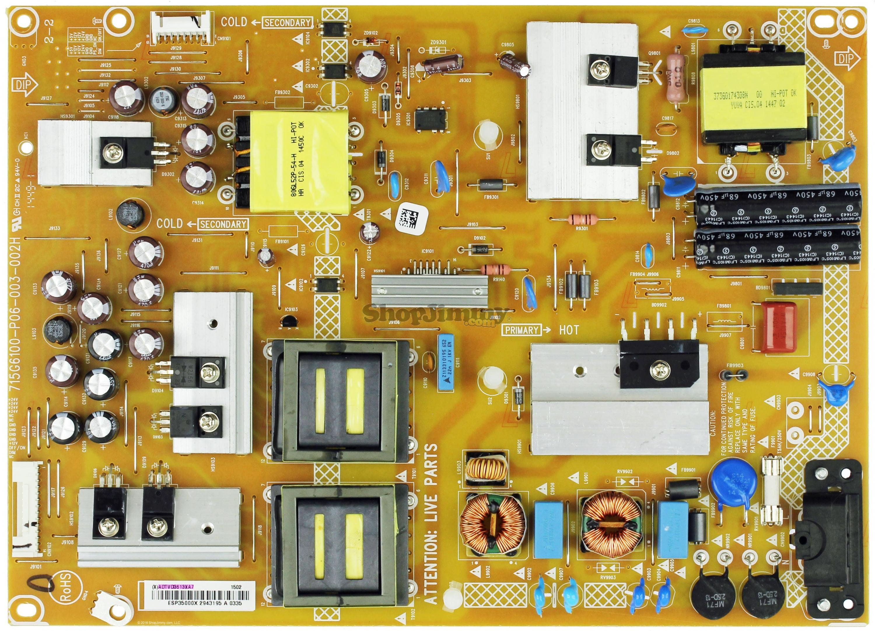

                    Vizio LNTVEV24XUAA8 LED Driver
                    http://www.shopjimmy.com/vizio-lntve...led-driver.htm
                    Vizio ADTVD3613XA7 Power Supply
                    Pictures provided by shopjimmy
                          There are two parallel sets of pins (9 x 2) so 18 pins in total. The NC and the PS_On are two separate pins. The Dim ON/OFF again are two separate pins. One pin is Dim and the second pin is ON/OFF
                          The legend alongside shows the pin layout of the connector.

                              FYI: as you can see the connector of the power supply that goes to the LED driver board only has red wires for the +24V, and Black wire for the GND return to feed the LED driver board with 24V, the ON/OFF PIN, DIM PIN are not used and now wires attached, see picture: https://www.badcaps.net/forum/attach...0&d=1493318280
                              The connector on the right side of the driver board that goes to the main board contain the BL-ON and dim control signals, but the connector on the LED driver board does not show the pin function. Right now you are not getting the Boost Voltage so it may mean that the LED driver board is bad or it is not getting the BL-ON from the main board.

                                Thanks budm: I have a couple of questions as follows: 1. Is the boast voltage derived on the led driver board? 2. I measured the voltage capacitors c820 and c821. The capacitor values and voltage rating cannot be seen unless I pull the caps off of the board to view the underside. What is voltage suppose to be on the capacitors c820 and c821? I measured only 19 volts. Is it suppose to be higher? Is this the boast voltage that you referred to?
                                I assume that the led driver board contains a switch mode power supply that derives the boast voltage. What do you propose should be my next steps? Still something is dragging down my 24 volt supply voltage.thanks for all your help.
                                  "1. Is the boast voltage derived on the led driver board?" Yes, the yellow inductor is part of the boost converter circuit.
                                  "2. I measured the voltage capacitors c820 and c821. The capacitor values and voltage rating cannot be seen unless I pull the caps off of the board to view the underside. What is voltage suppose to be on the capacitors c820 and c821? I measured only 19 volts. Is it suppose to be higher?" When the booster circuit is not turned on you will only see the feeding Voltage, in this case it is the 19V, those two should be rated at over 100VDC when it is running, the Voltage depends on how many LEDs there are in the LED string + Vdrops on the PWM controlled MOSFET and the current sensing resistor. Right now we do no know if the driver board is getting the BL-ON signal to turn on the boost converter circuit and the LED driver circuit or not, that is problem we need to find out.
                                  You can spend $15 dollars on the driver board to find out if it is the board or something else.
