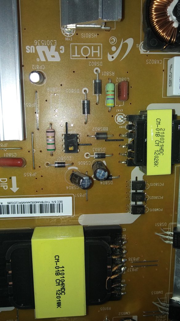

    Samsung un60eh6003f ICS801S blown away!

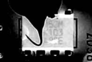

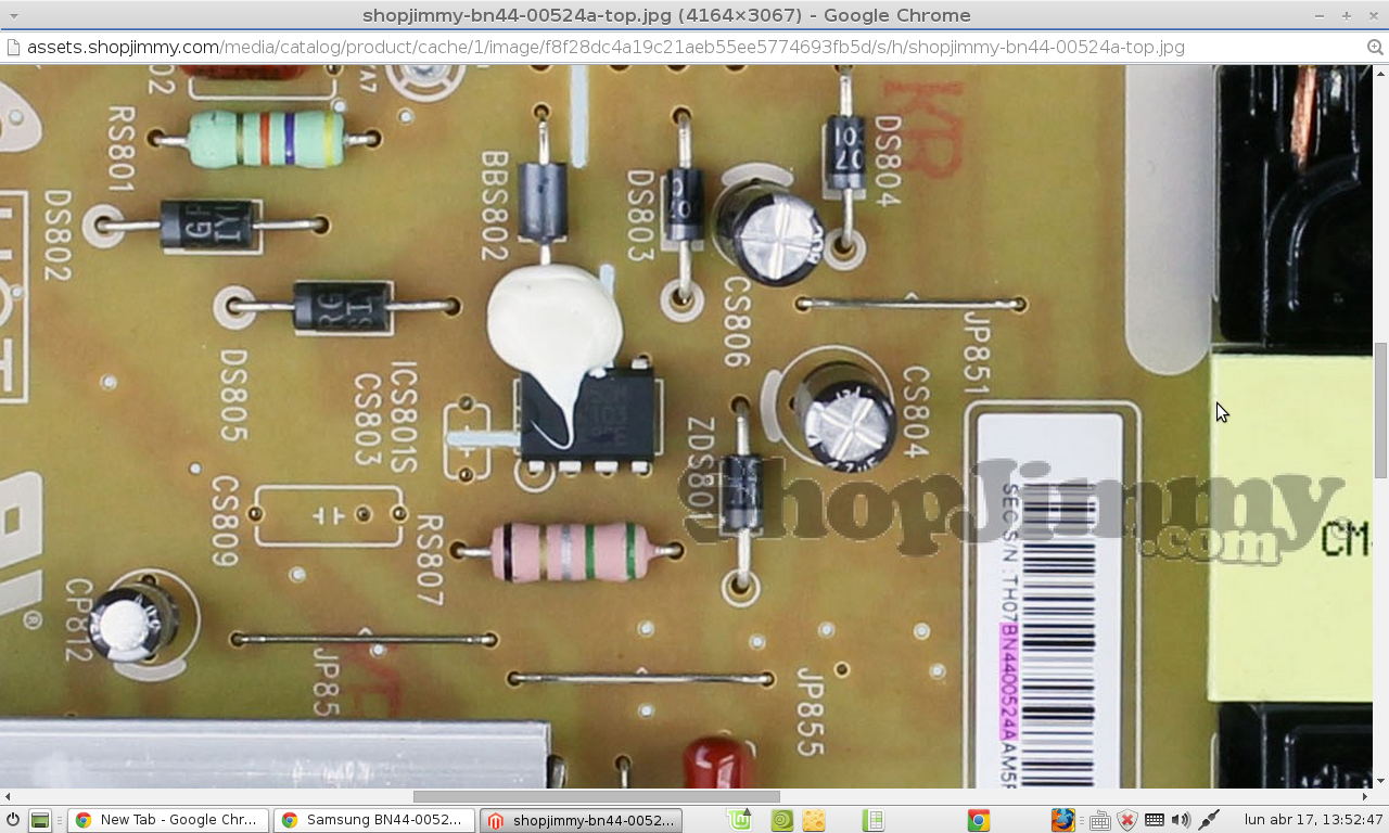

    SAMSUNG UN60ES6003FXZA Power Supply board Samsung BN44-00524A (PD60B1D_CHS)
    ICS801S was blown away. Maybe is ICE3BR1765J or ICE3BR1765Jz Please help me !

    Couldn't the other piece of the chip anywhere? There are eight boards on ebay maybe you could message seller and ask if they will give you number

      The white silicon glue is gone, so someone before me was already opened it . Thank you.

          It's a long shot but on the BN44-00423 ICS801 is a D2011K. The board is for a smaller TV but looks somewhat similar to yours and the IC denominator is the same, chances are it may be the same or a very similar chip...

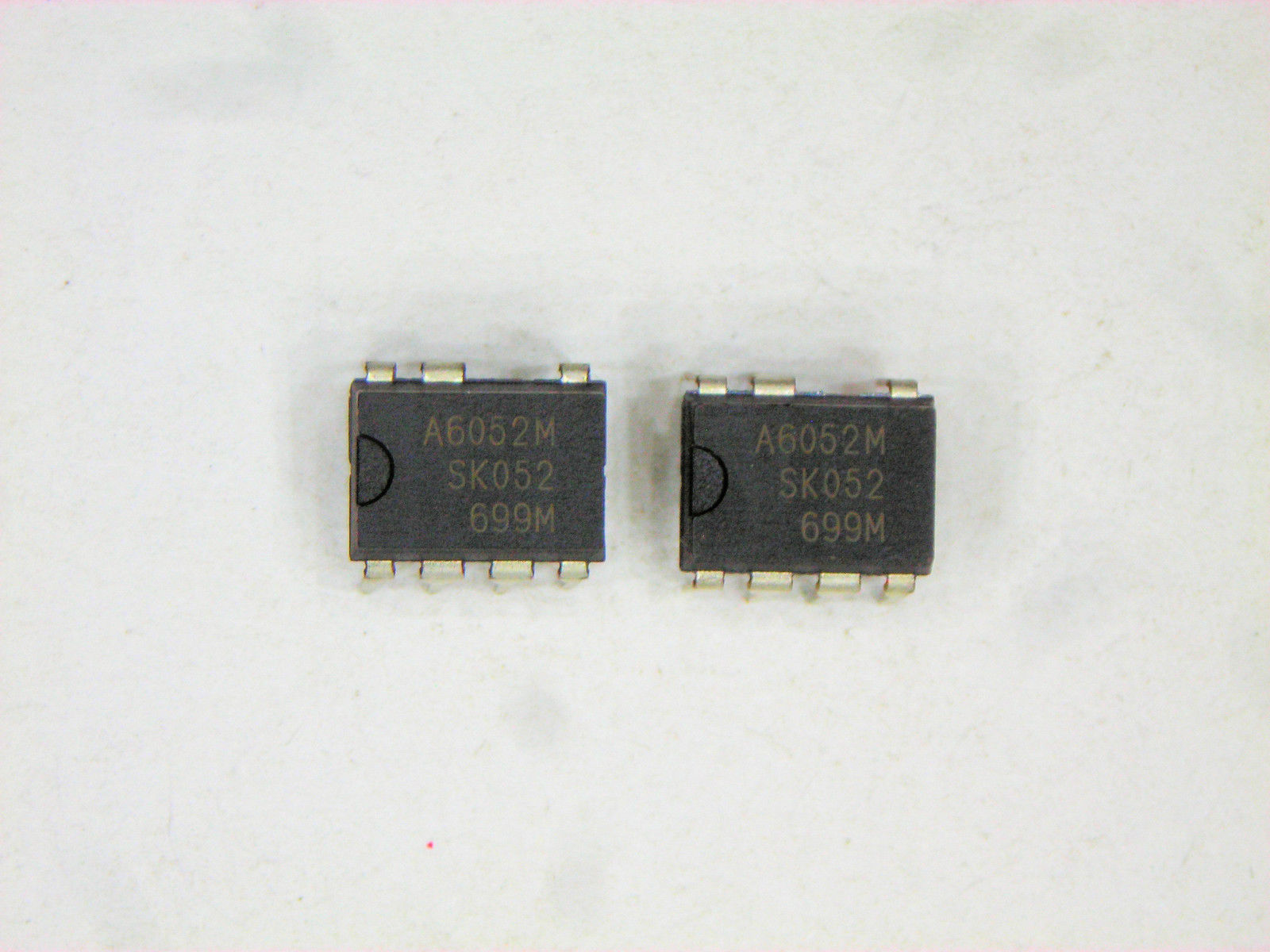

            Could be a STR-A6052M (used in a BN44-00482B) from your picture it looks like "52M"
              Re: Samsung un60eh6003f ICS801S blown away!
              It sure does look like *****52M
              • capwizard
                • Jun 2016
                • 1991

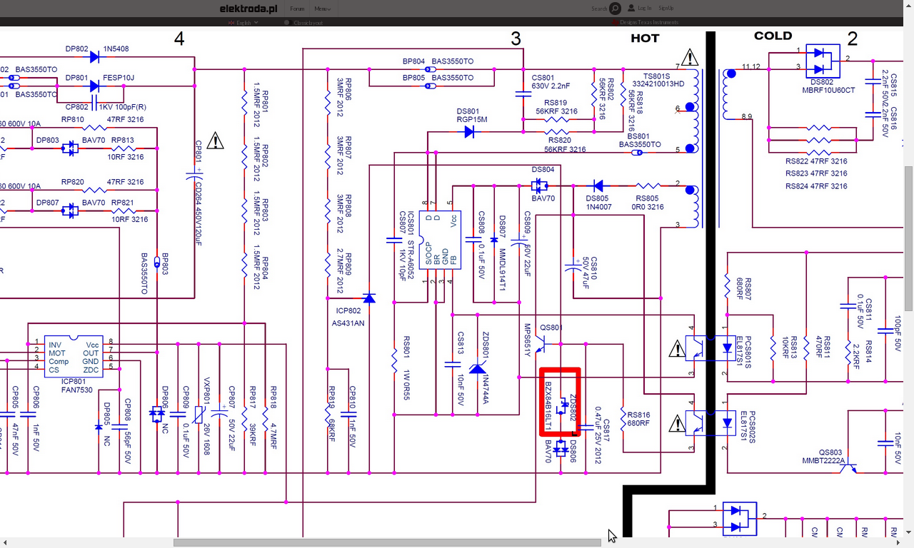

                Thank you very much R__J
                [Could be a STR-A6052M (used in a BN44-00482B) from your picture it looks like "52M"]

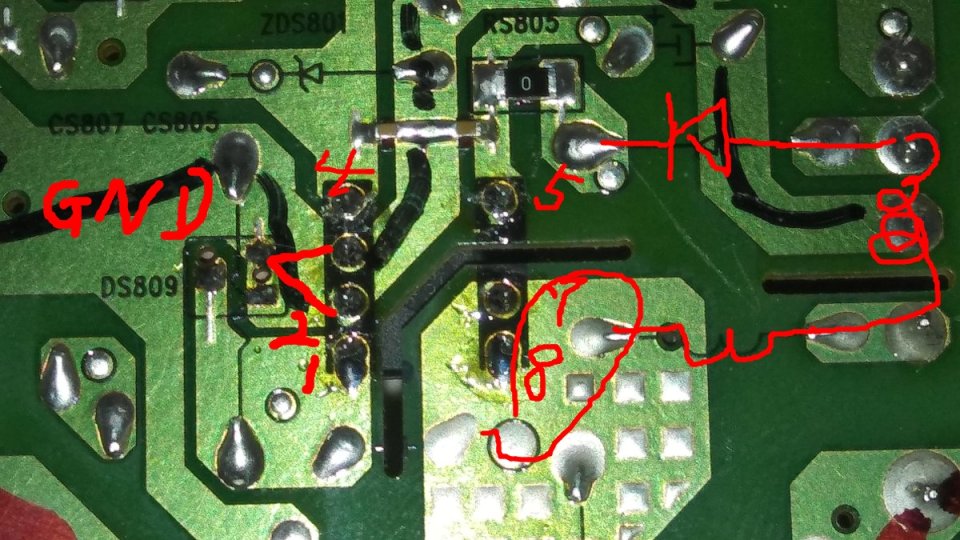

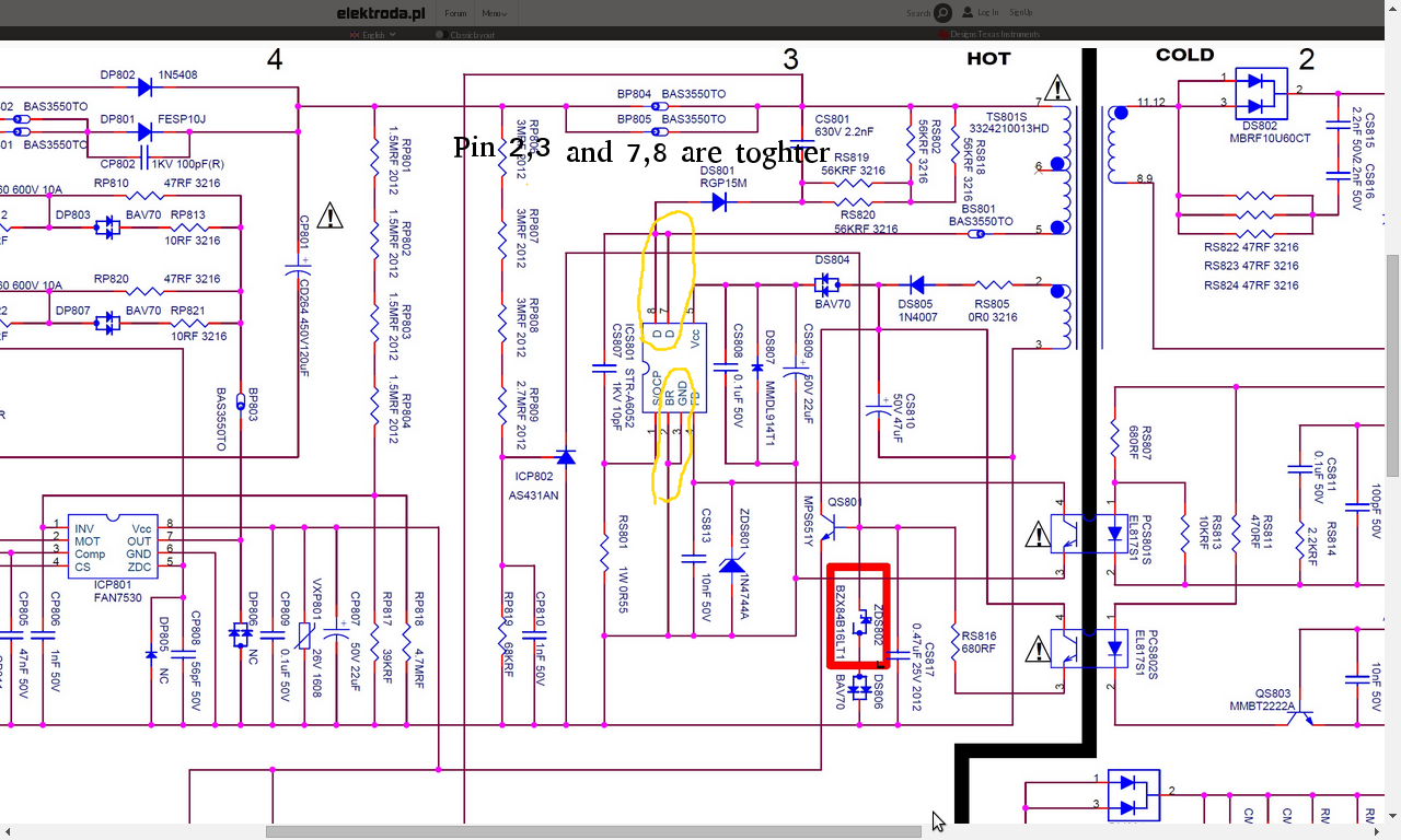

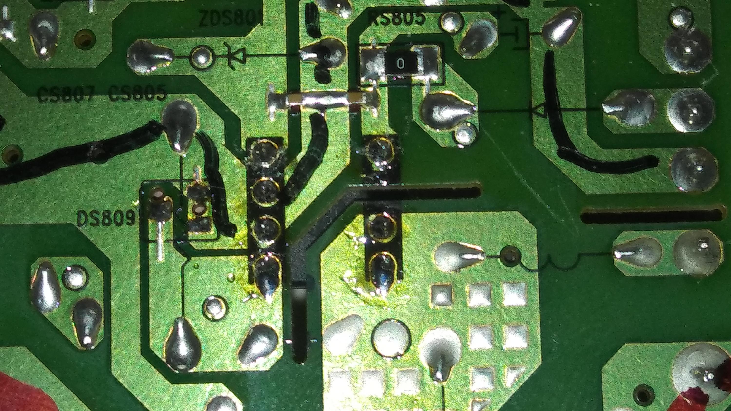

                I think your right! Because IC pin 2,3 ~ 7,8 are connected together. If pin 7,8 are (Drain) it is the STR-A6000 Series
                Before change this IC DS809 is dead shot : SMD 43L 2 schottky diodes.
                http://www.elektroda.pl/rtvforum/top....html#14918304
                https://cdn.badcaps-static.com/pdfs/...ae6914545d.pdf

                  i hope this will help... in the future: Pin 2,3 are connected to GND and pin 7,8 are connected to transformer.
