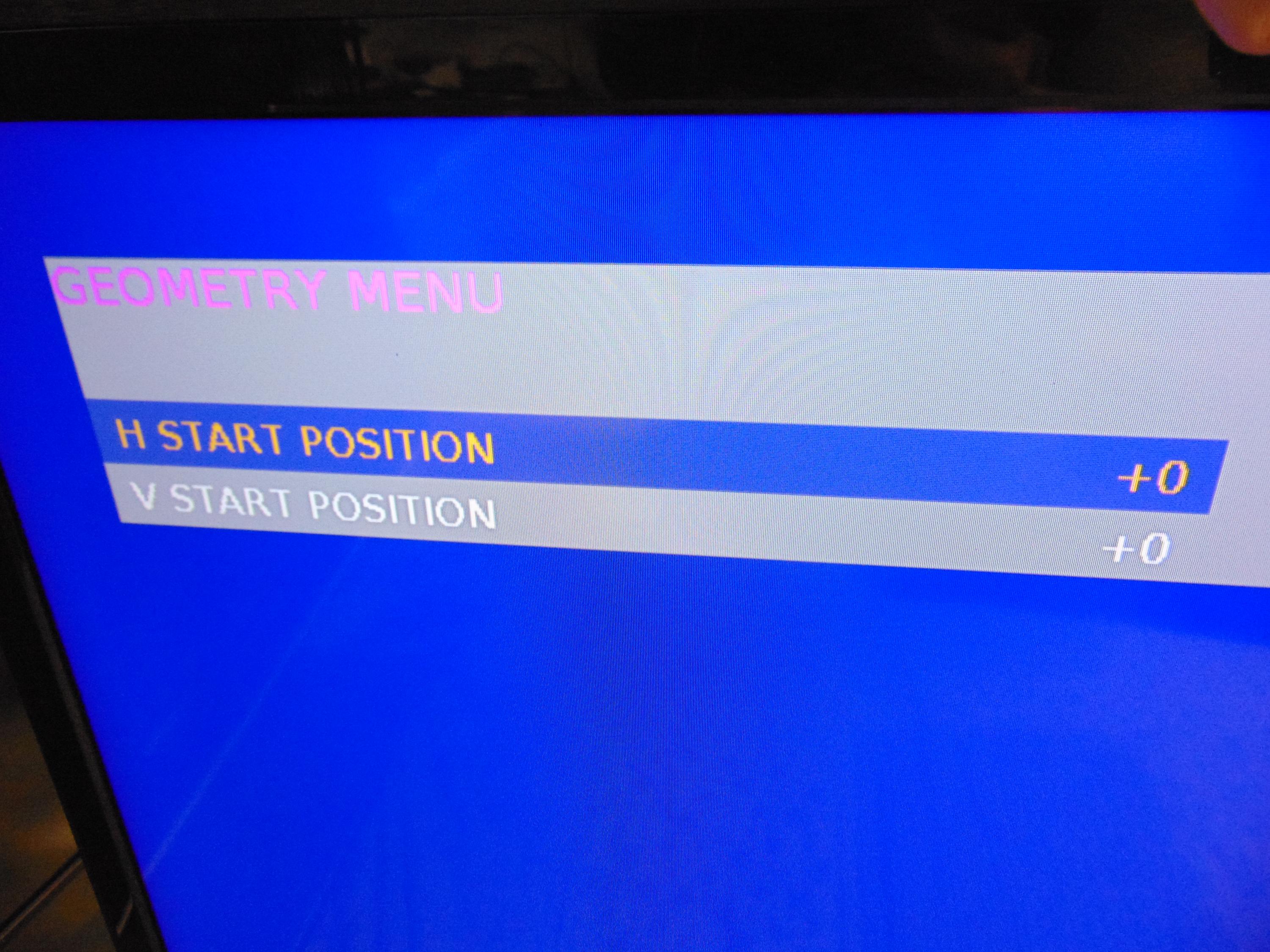

    Picked up this tv that had no backlights, which after testing, determined to be a bad eeprom. I ordered a replacement from SJ and installed it. I now have a perfect picture.....except that it is upside down. I accessed the service menu but can't find an option to flip the image. Anyone know what setting it is? I've attached a pic of the service menu options.

          have you tried menus such as geometry ?
          maybe look in all menus and see if anything shows up .
          • SHADOW3277
            • Jun 2014
            • 123
            Re: RCA 46LB45RQ Inverted picture after eeprom replacement.
            I did but I see nothing for flipping the image. I know if I choose the wrong thing I can brick the board.

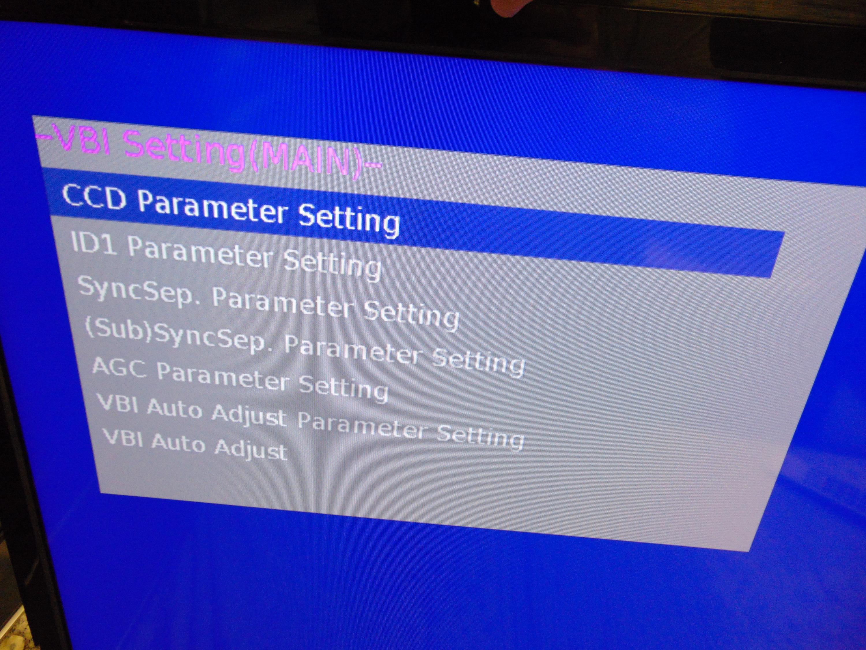

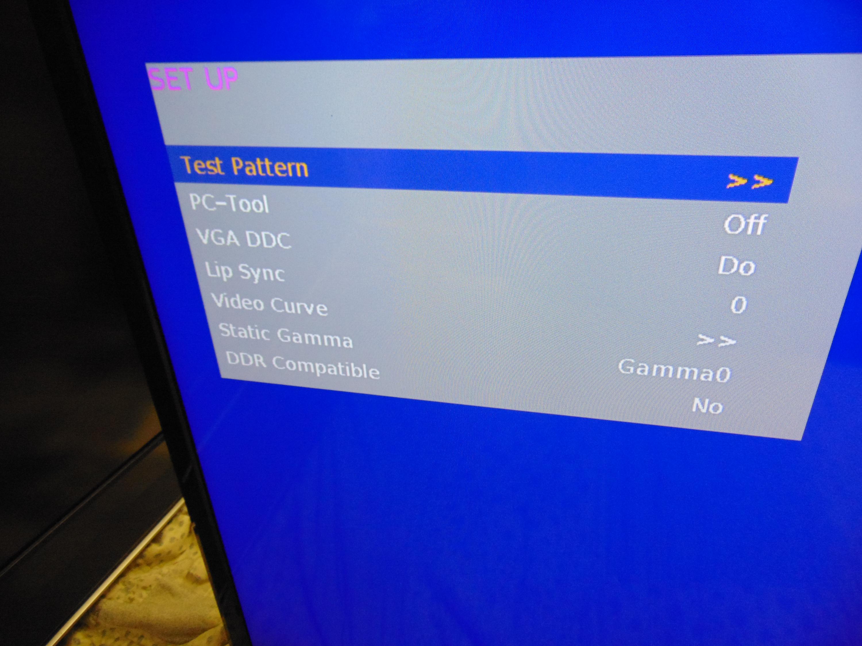

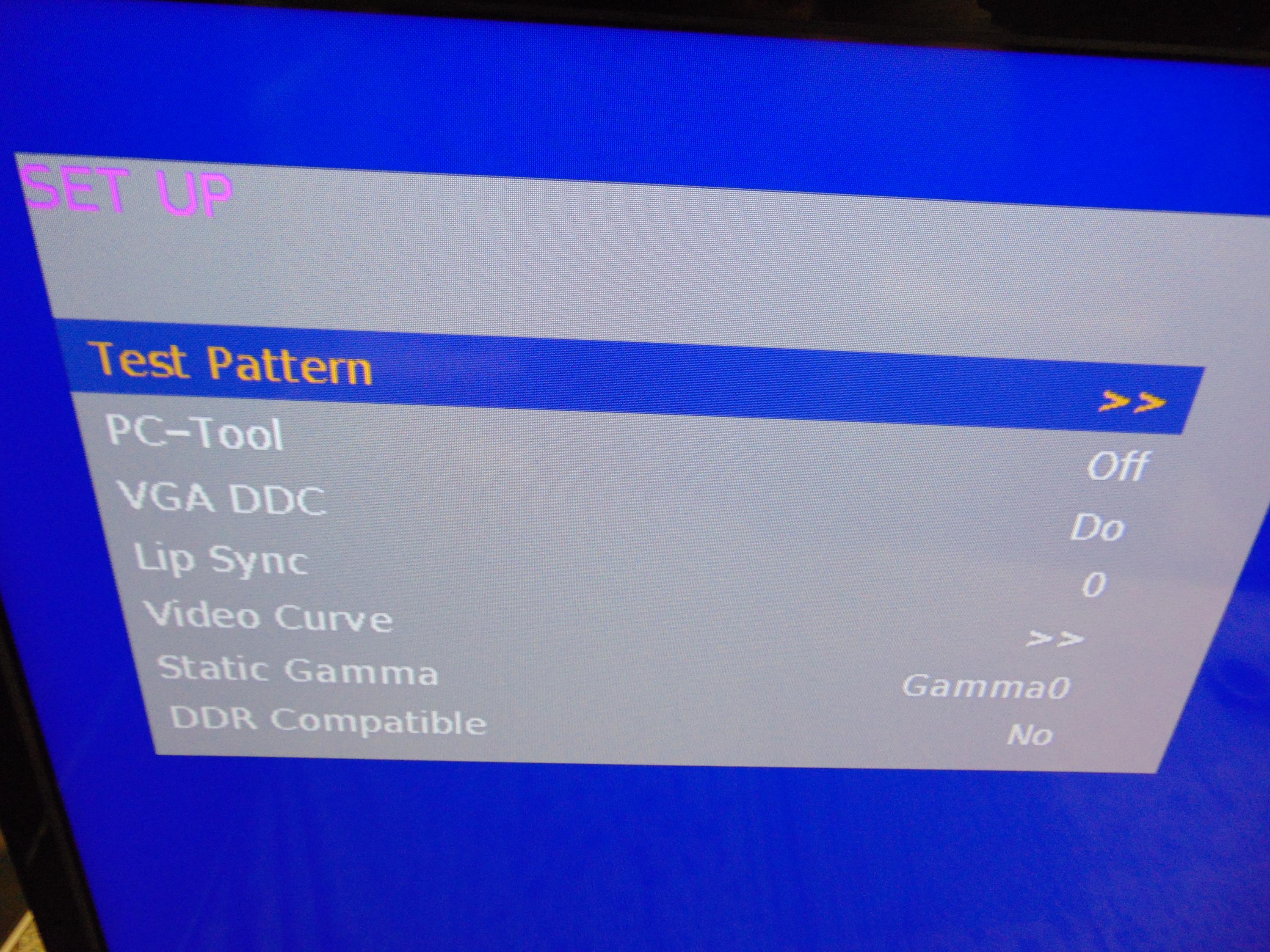

              Maybe under setup. Possibly post pictures of submenus

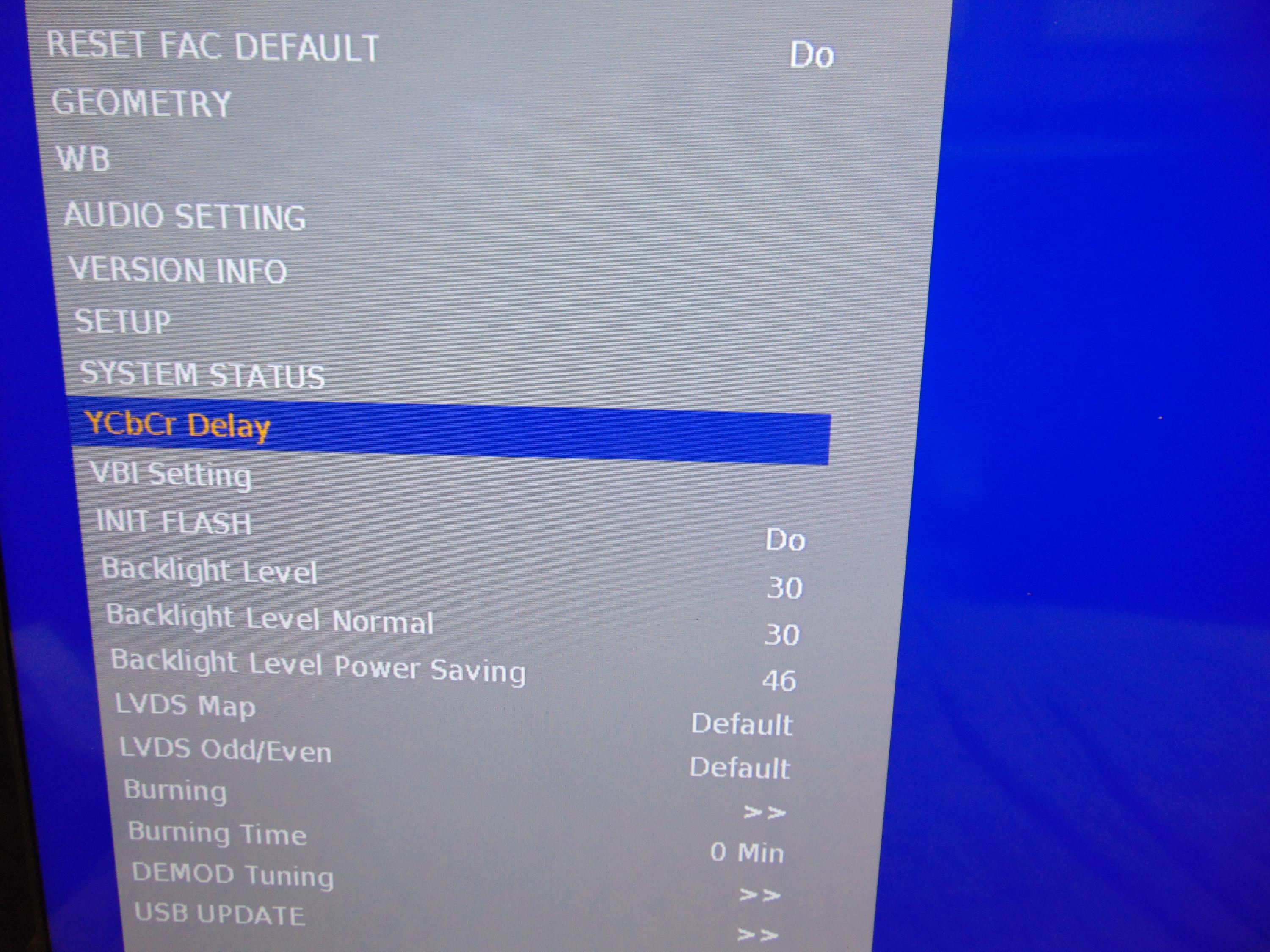

                What's under LVDS map?
                • dick_barton
                  • Aug 2015
                  • 6643
                  • Wales
                  What I should have said is if you select LVDS Map does it allow you then to select the correct panel type.
                    No. The options are default, 6 bit a, 6bit b, 8 bit a, etc. When I changed it to 8 bit the picture became distorted.
                      Here are some pics of the sub menus.

                            Was a solution ever found for this problem? I have the same issue with an RCA LED46C45RQ. I replaced EEPROM with a preprogrammed device to correct a power up issue. That corrected the original problem, but image is flipped. I have all of the same menus as shown in this post but I cannot find anything about HV flip. I presently drive the TV with a PC that I use as a DVR. I have inverted the output of that unit so I can watch TV right-side up, but all of the TV generated service menus are upside down.
                            • nomoresonys
                              • Jan 2013
                              • 12306
                              • U.S.
                              Might be in service menu--general settings--mirror control, might get in service menu by pressing menu and keying in 1147.
