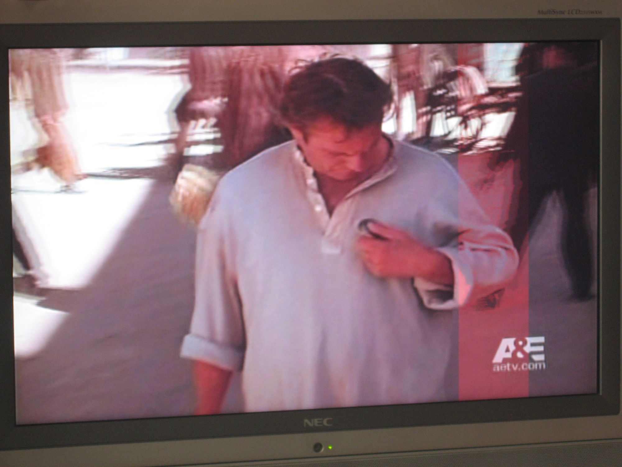

    Hi I am having problems with a NEC tv 23" lcd. There are two vertical lines about an inch wide that form together to make one (sometimes). These lines are on the right side of the screen looking at it. they seem to appear and disappear. appearing mostly as pinkish lines but not always visible. Is this something that can be caused by bad Caps? Is it something that will get worse? A problem that is very difficult to describe because it appears intermittent. I have emailed the manufacturer but no response. Any help greatly appreciated.
  • Wizard
    • Mar 2008
    • 2296
    Re: NEC TV with vertical lines
    LCD panel.
    Got warranty?
    Cheers, Wizard
      @ davg: if these thick lines appear always in the same place, I think there are two possible reasons: the first pixels in the columns are struct or two of the silicone contacts (aka "zebra stripes") on the vertical control are either moved from their default position or defective. For the first case switch off the screen and press gently on it near the upper part of the frame where the thick lines are; if it doesn't solve the issue, then these contacts are bad. Silicone contacts can be a pain: if their position is changed by a fraction of millimeter, then this prevents signals (in you case, the vertical control ones) to reach the lcd matrix; this issue happens when the screen gets a big shock (e.g. fall from a table) or due to heat (bad dissipation).
      If the screen is still covered by warranty, then call the manifacturer for a RMA; if it isn't and you're both patient and brave and own a microscope, then open the lcd, locate the silicone contacts on the top, remove the two bad ones, clean both them and the tracks on lcd with isopropyl alcohol, lastly reseat the rubbers with the aid of the microscope. No kidding: a magnifying lens wouldn't be strong enough to see the end of silicone contacts and a bad reseating could kill your screen.

        Old days of zebra strip is over when density of lines got real tight. The connecting tape is thermal bonded to the LCD glass substrance conductive lines with pressure and heat or ultrasonic.
        Oh yeah, the tape have bare flipchips for each column bands and there are more for the horizontal bands. The circuit board that is connected to these flex wirings are merely just bus lines connecting them all to a voltage and few ICs.
        This is panel exchange only where repair is not possible for most except at LCD repair factility.

                    Basically, on davg screen the two rightmost vertical contacts don't work correctly: the control chips may be damaged or the tape bondings weak.

                          Hi again I know this is an old thread but this problem seem to be getting a little worse. I have attached a picture in hopes it gives a better understanding of the problem. Is this an lcd panel problem or could it be something else?
                          • Wizard
                            • Mar 2008
                            • 2296
                            That's a band, not line.
                            One X driver IC failed. Send the panel out for repair (yes there are LCD industry repair) or replace to tune of over a 500 dollars.
                            Cheers, Wizard

                              Thanks Wizard glad I posted a picture. I guess I should open the thing up. Is replacing a failed x driver IC something I could tackle? if so where would it be located? I have repaired a number LCD monitors but no experience with TV's

                                I've manage to 'repair' monitors with similar faults by wedging a piece of paper in between the case and the faulty edge connector - just enough to hold the flex to the glass, but identifying where the fault is involves gently flexing the flex cables with the driver chips on until you figure out which one is faulty (its not always obvious), and that obviously carries the risk of making the problem many times worse.
                                A 'proper' repair is not something you can do at home (unless you have one of these http://www.pixel-interconnect.com/examples3.html in your garage), but if you've got nothing to lose its worth a try.

                                    Be extra careful.
                                    Not easy to do because the driver ICs are on the tape bonded to the LCD, easy to tear.
                                    and is hidden by the metal frame that hold LCD to the LCD panel chassis.
                                    Think hard on getting a quote from LCD repair factilty first.
