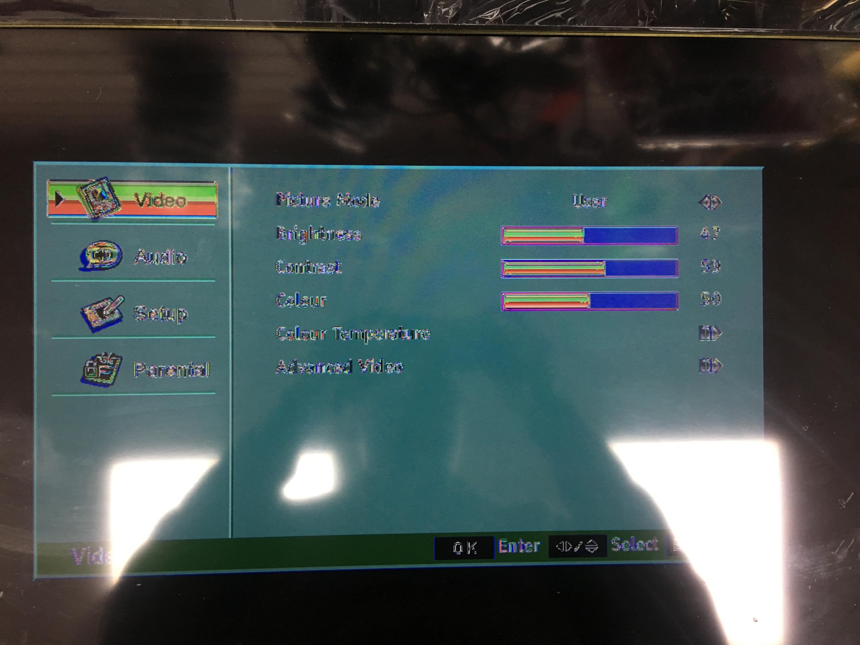

    I guess this person had no luck on here but I can give the pictures you all needed.

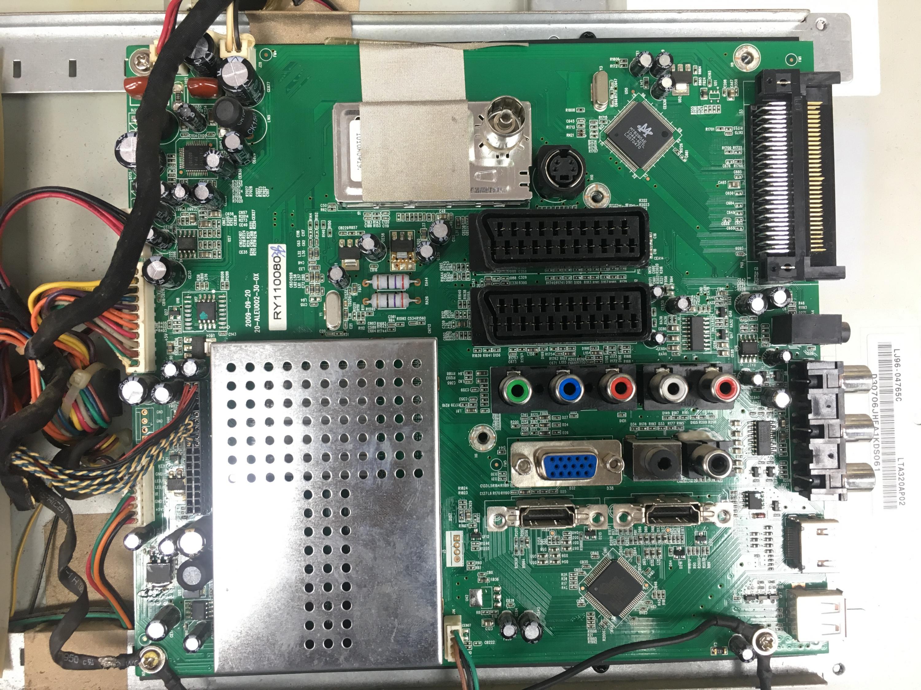

    I now have two off these board bought off ebay:

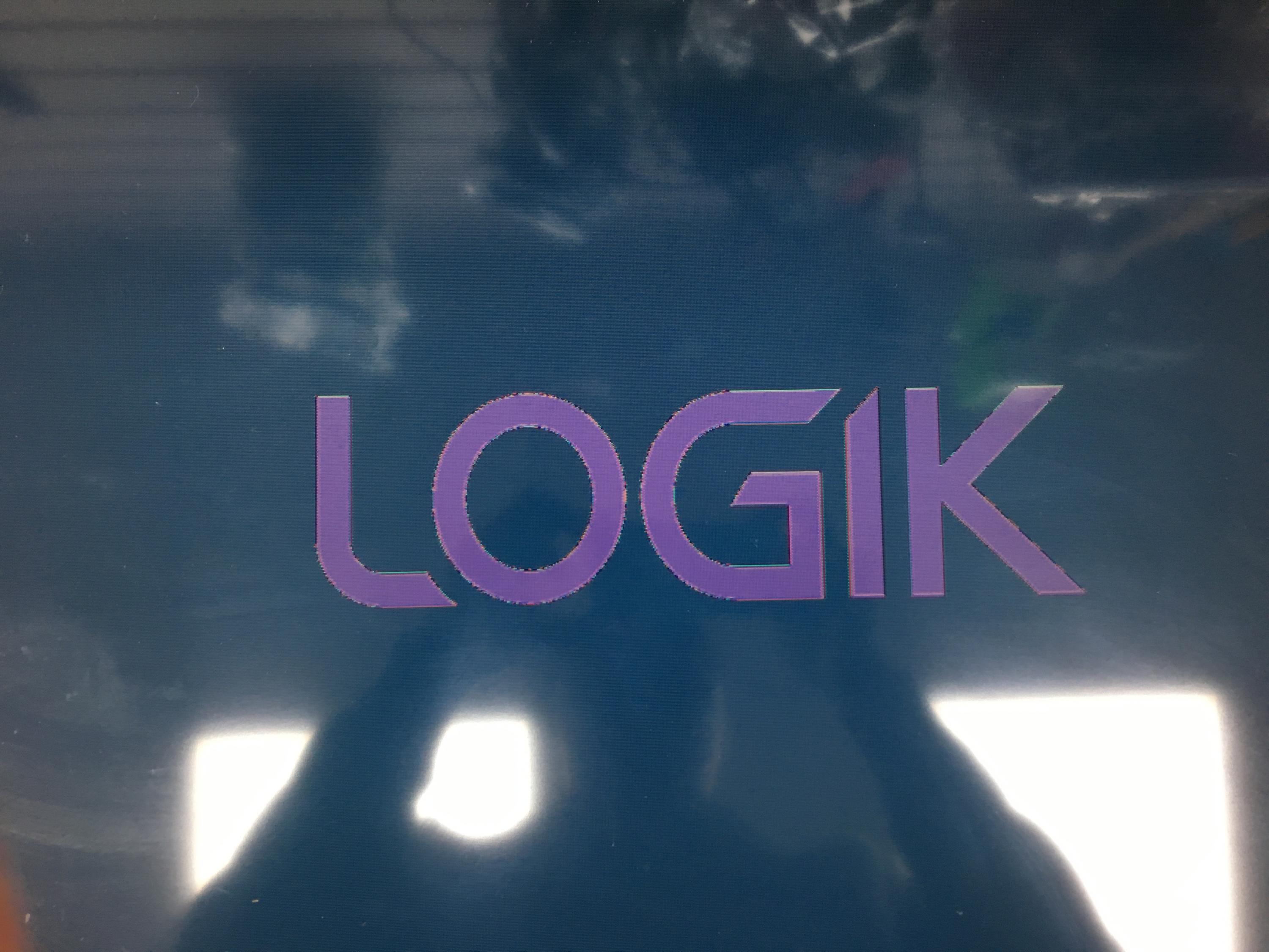

    The issue is the display, it look blurry or distorted:

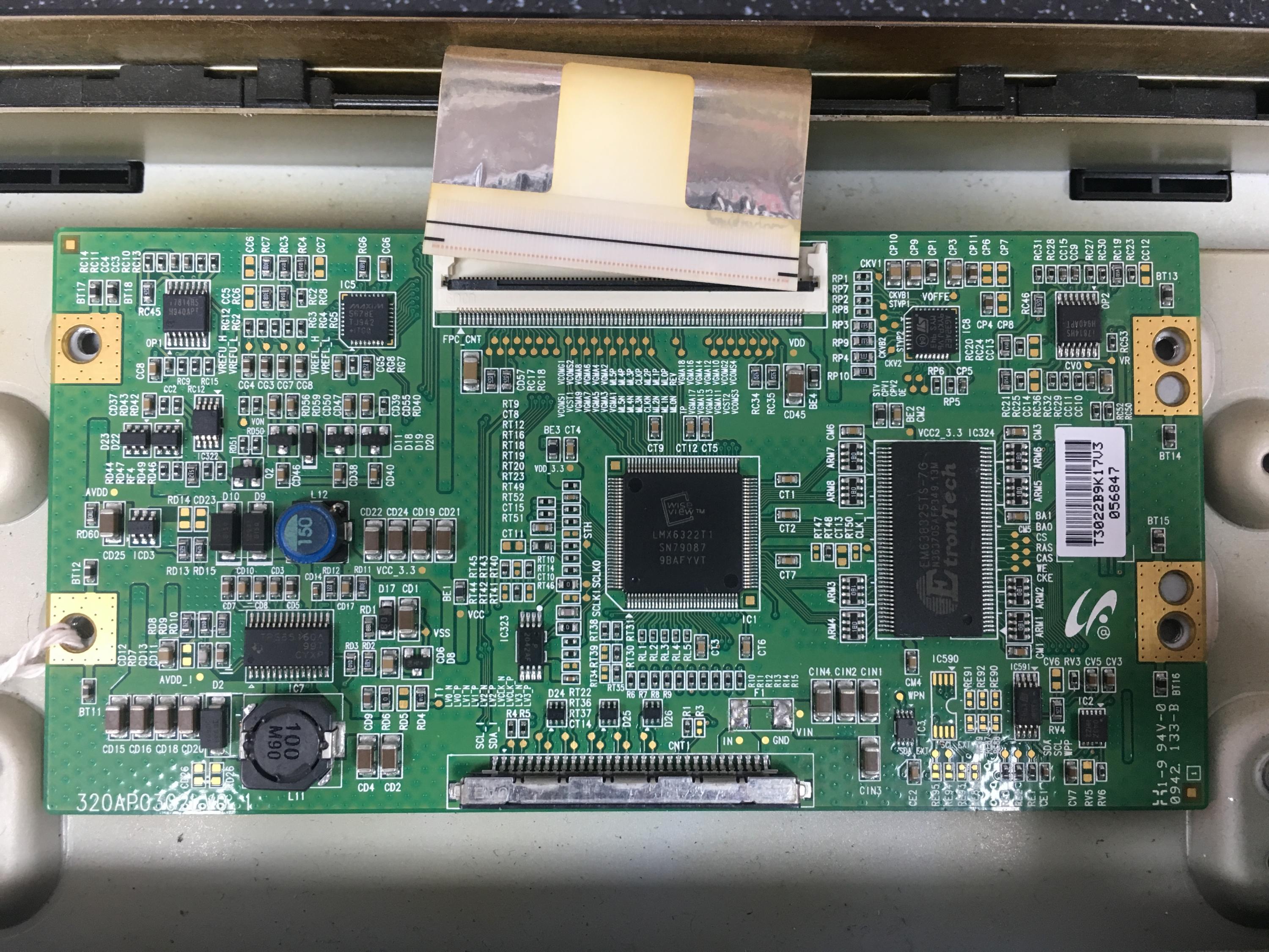

    The original tcon was misplaced so I cant find it. Ive bought another off ebay but it looks as above. At first, the tv had no power so I do not know if this is a tcon issue or not. Could I've bought a faulty tcon? If so, what is direct issue here?
    Tcon:

    Re: Logik L32DIGB20 - Display
    Wrong mainboard for panel.
        No Ive had it before, the mb needs to be matched to the Tcon on these shit Tvs.
          Oh dear. That tcon is no where to be found.
