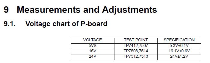

    According to service manual 16v and 24v are switched on by input from pin 7. You only seem to have about half the voltage you should at 7.5v and 11.5v

      Did you have Pin 7 shorted to 5.3V when you tested the voltages above? What voltage do you have across the two legs of the 68uF 450V capacitor C7213. Mainboard disconnected from power supply.

        I just shorted pin 7 in the p2 connector to TP7412 (5.3v) and tested the four points again. Now I'm getting a healthy 16v and 12v reading.
        16.1v between TP7414 and chassis/ground.
        16.1v between TP7415 and chassis/ground.
        12.0v between TP7430 and chassis/ground.
        12.0v between TP7431 and chassis/ground.
        By 'main board' I'm assuming you mean "a-board" which is the one with all the usb/hdmi connectors etc. I disconnected plug P2 from the p-board and the voltage at capacitor C7213 is still 166V.
        With pin 7 on the P2 connector (plugged back in) shorted to TP7412 (5.3V) I re-tested the following from earlier and this is what changed.
        Before shorting pin 7 to TP7412 (5.3V), I had nothing on TP7508 or TP7514. With pin 7 shorted, I now have 16.1v on both TP7508 and TP7514.
        Before shorting pin 7 to TP7412 (5.3V), I had nothing on TP7512 or TP7513. With pin 7 shorted, I now have 24.2v on both TP7512 and TP7513.

                        16V on pins 1, 2, and 3 of the P2 connector.
                        Pin 4 is 0V
                        pin 5 is 11.8,
                        pin 6 is 0V,
                        pin 7 is 11.8 (which is also connected to TP7412),
                        pin 8 is 100mV and drops gradually,
                        pin 9 is 100mV and drops gradually,
                        pin 10 through 14 are all 100mV and dropping gradually
                        pin 15 is 0V
                        The main capacitor is still 387V
                        I don't have 24v anywhere on the output connector.
                        24.0v on both TP7512 and TP7513
                        16.0v on both TP7508 and TP7514

                          The voltages you have given match the service manual.
                          I would now concentrate on the backlights to see if they are working.
                          So again with the mainboard disconnected bring up those voltages again as you did above but also add a 1K resistor from Standby Pin 5 of connector P2 to BL_ON Pin 2 of connector P4
