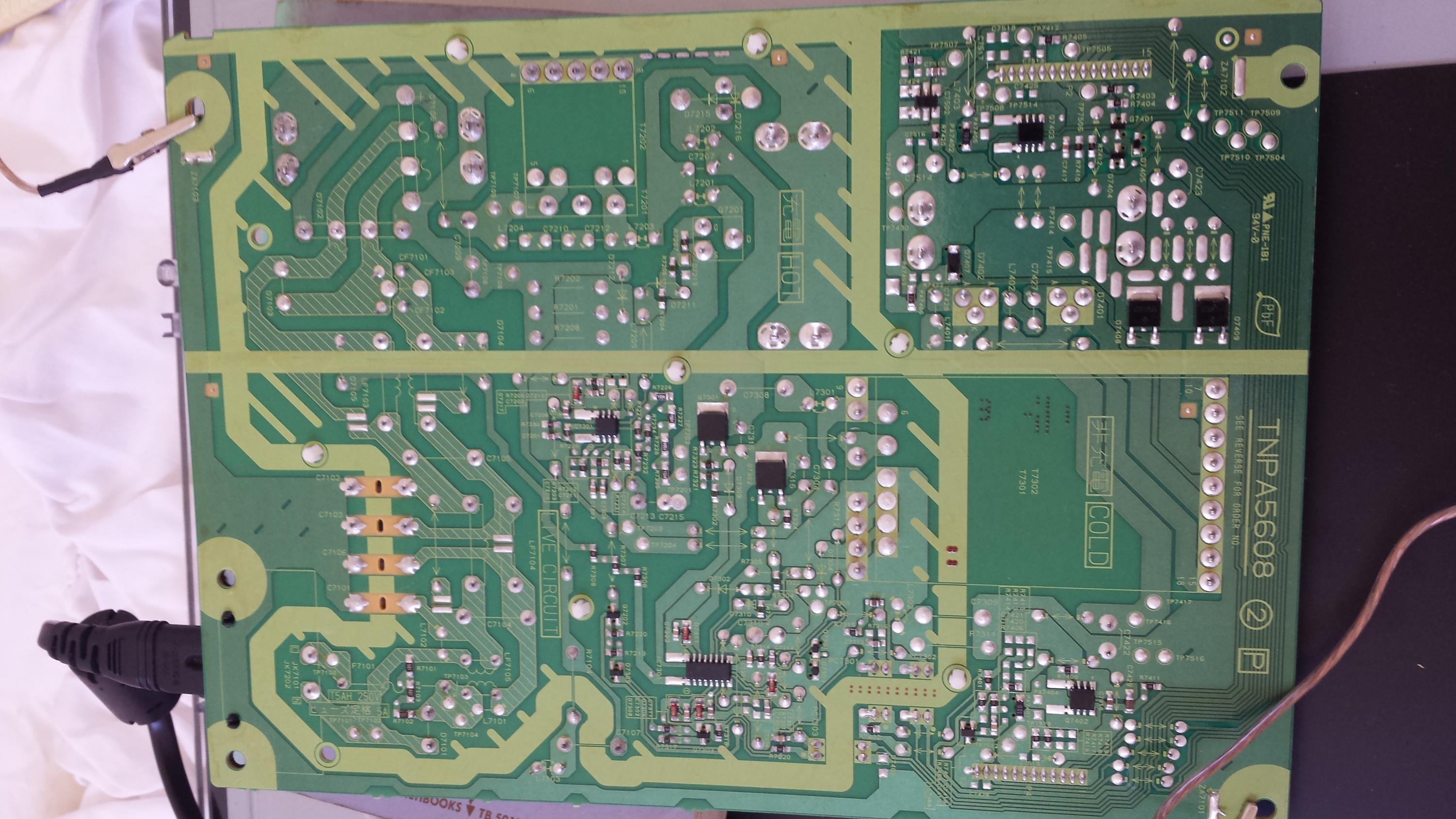

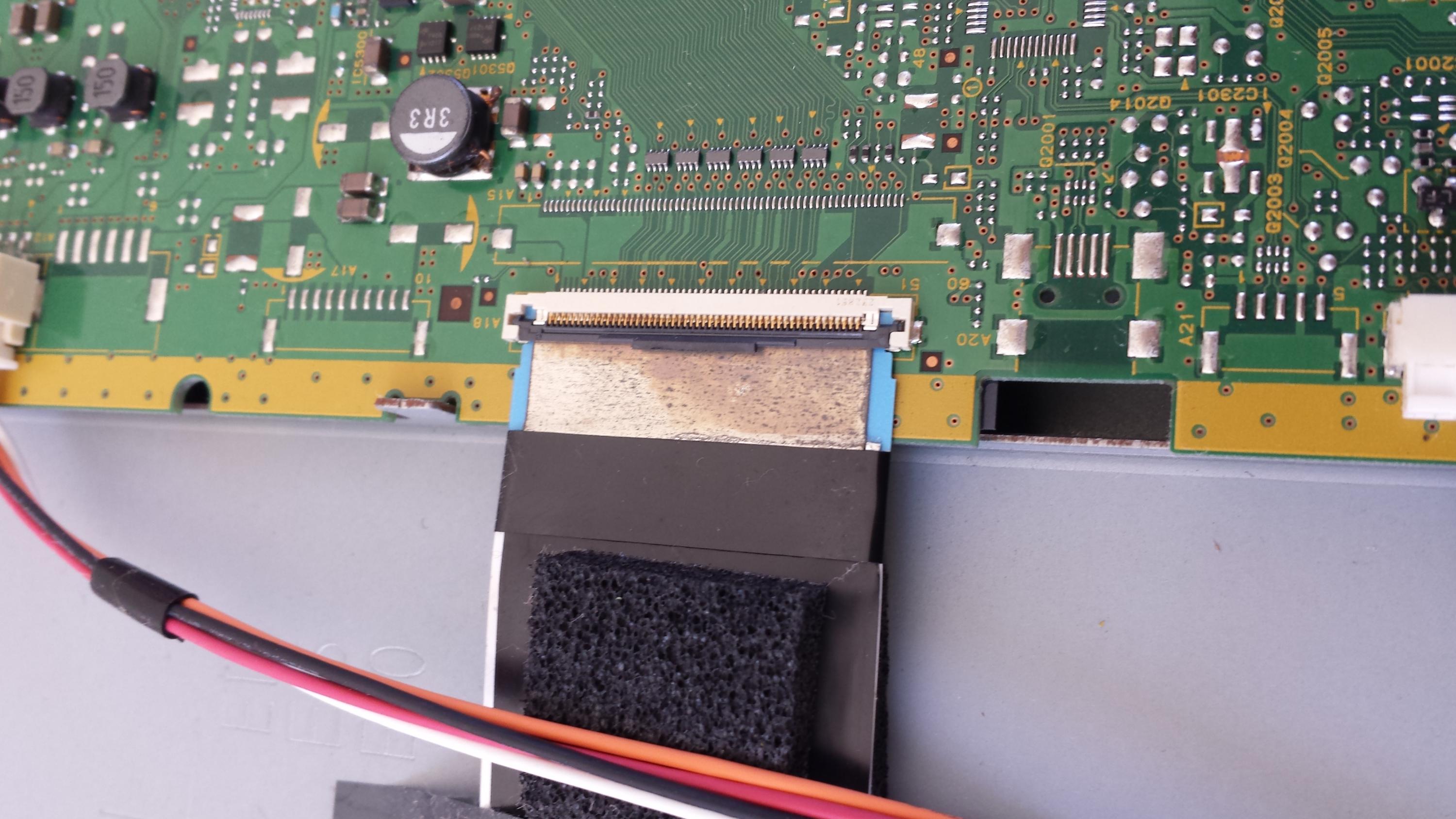

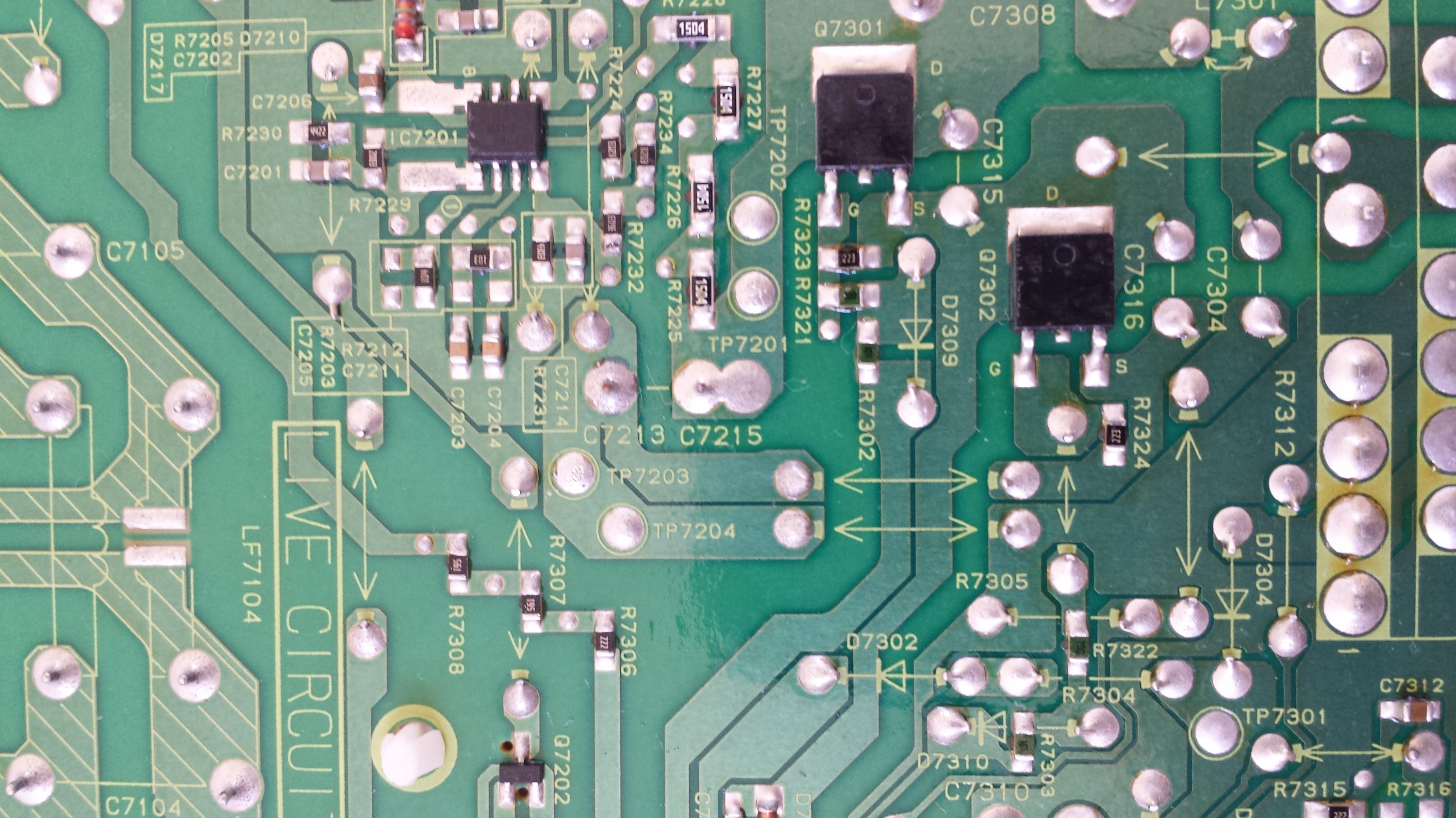

                          Re: Panasonic TC-L47E5 won't turn on [3 red blink code]
                          Okay first picture is component side of the p-board (capacitor CT215 is the big one in upper-middle)
                          Second picture is green side of p-board
                          Third picture is closeup of capacitor area from green side showing TP7201 and TP7203 area.
                          Testing between the terminals of capacitor from the component side shows me 166vDC. Same 166vDC when testing with one multimeter probe on TP7201 and the other on TP7203.
                            For clarification on power board you have a side marked hot and a side marked cold with lines around each. All measurements on hot side. The ground reference point will be neg. of your main filter cap. For cold and all others the ground will be chassis.

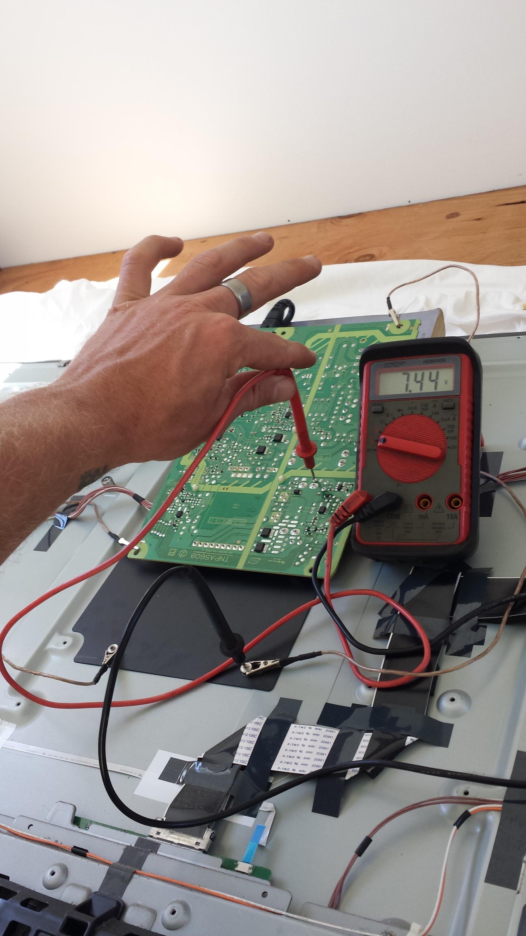

                                  Have you got 16V at TP7414/7415 and 12V at TP7430/7431. Use chassis as ground.
                                    You have the PFC voltage given earlier and also the standby voltage. The 16V and 24V should be available at the output connector when Pin 7 of P2 goes high switching on Q7401.
                                      I'm reading 11.5v between TP7414 and chassis/ground.
                                      Also reading 11.5v between TP7415 and chassis/ground.
                                      I'm reading 7.5v between TP7430 and chassis/ground.
                                      Also reading 7.5v between TP7431 and chassis/ground.
                                      Here's a picture of my test... Red probe goes to test point on p-board, black is to chassis. I have aligator clips [presumably] grounding the p-board to the chassis so it "thinks" that it's all assembled correctly. There's no way to reach the test points with the board bolted to the chassis. The book under the p-board is insulating anything from the component side from shorting to the chassis as well as propping the board up at an angle. Pretty sure I'm doing this right.
