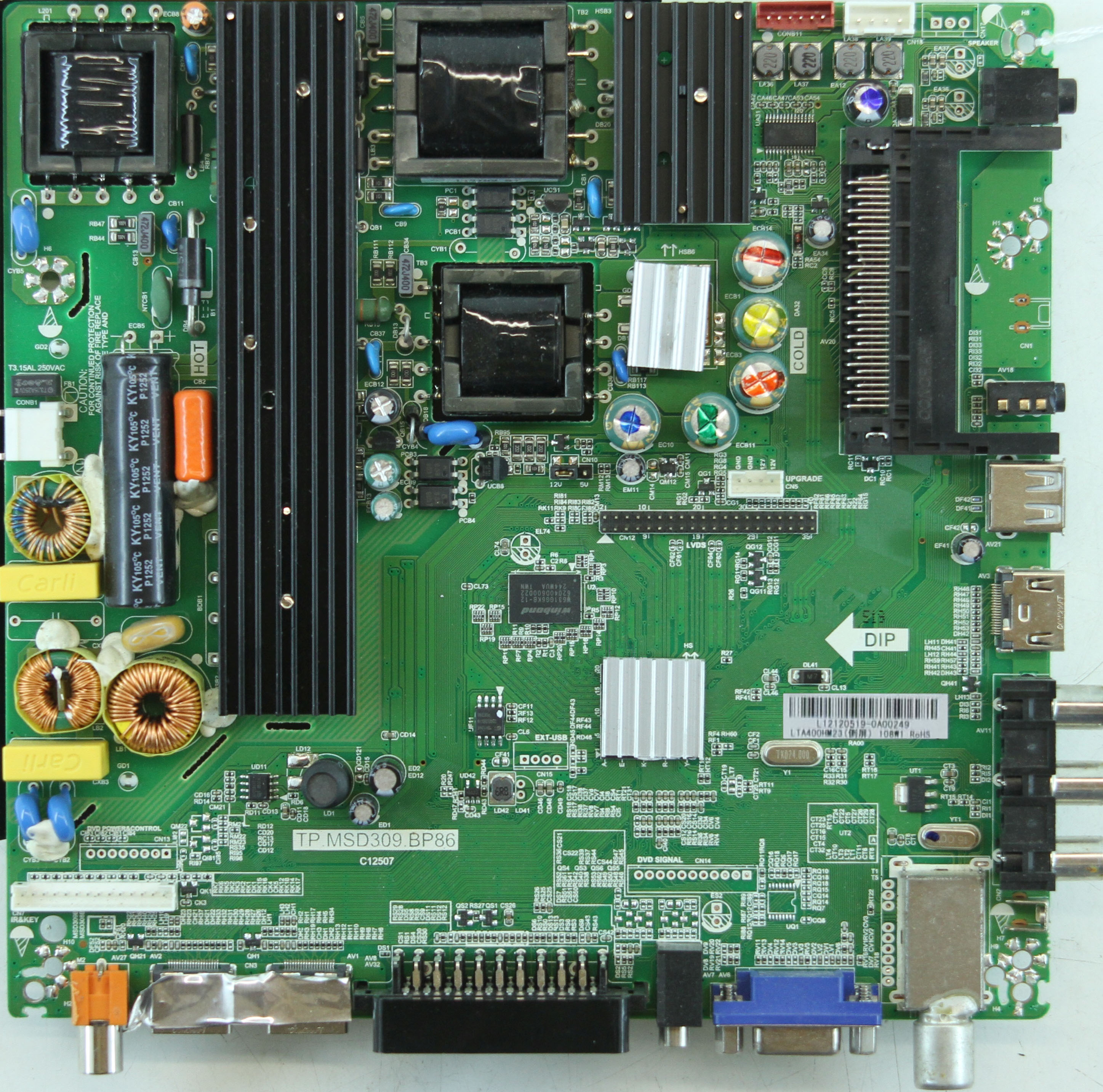

    Hi all, this tv belongs to a friend and I repaired it (mainboard, badcaps) about 2 years ago (when it was just out of guarantee) and I also bought and repaired a spare mainboard. Help with that came from here!
    A couple of days ago the screen went dead - completely black, no sign of backlight and seemingly no sound (though as it cannot be set to any specific source it's a little difficult to be sure of that).
    The standby light comes on (red) ok and it "turns on" (i.e. goes blue) and off ok, however there are no flashing error codes and swapping to the other mainboard does not change anything. I have searched online fairly extensively and found plenty of mentions of this set (I know it's a Vestel cheapo) however the symptoms this time are different to anything I've found so far.
    I have only a basic multimeter and similarly basic skills, however if anyone can suggest possible cause(s) or instruct me as to what to check I shall be most grateful!

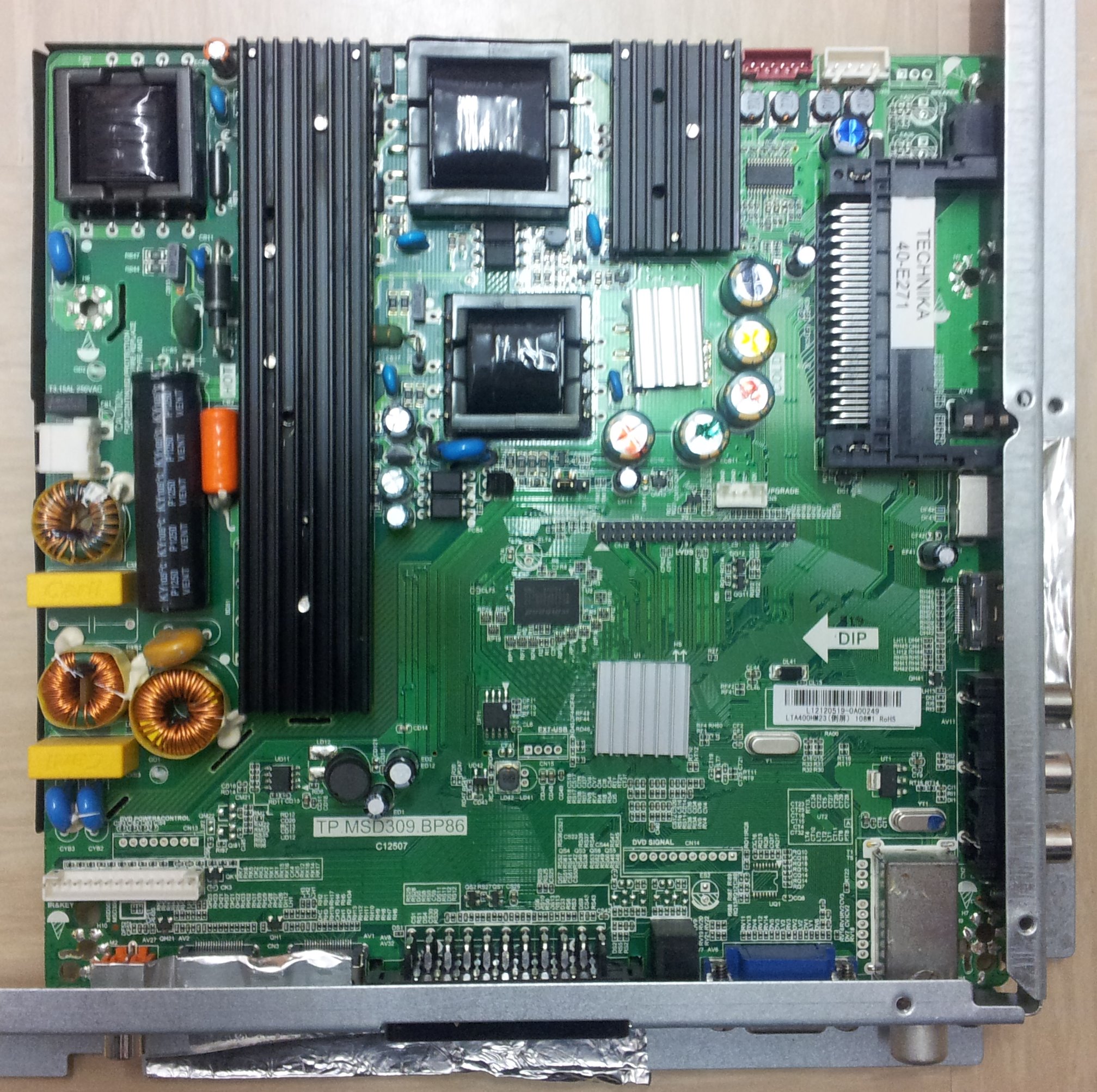

    can you upload a picture of the psu and mainboard this maybe a led issue so you may need to test the led voltages etc
      Re: Technika 40-E271 TV with TP.MSD309.BP86 Mainboard
      Photo attached, it's the best I can manage with my ageing phone - hope it's ok, if not I'll have to beg/borrow/steal a decent camera from someone (ok, not steal!)
        I found this pic which came with the spare board I ordered, and it's better than my own previous one, however I have just realised that I got my repairs confused (no surprise there) and I'm not sure I ever tested the spare so, though unlikely, it's just possible that they both have the same fault...

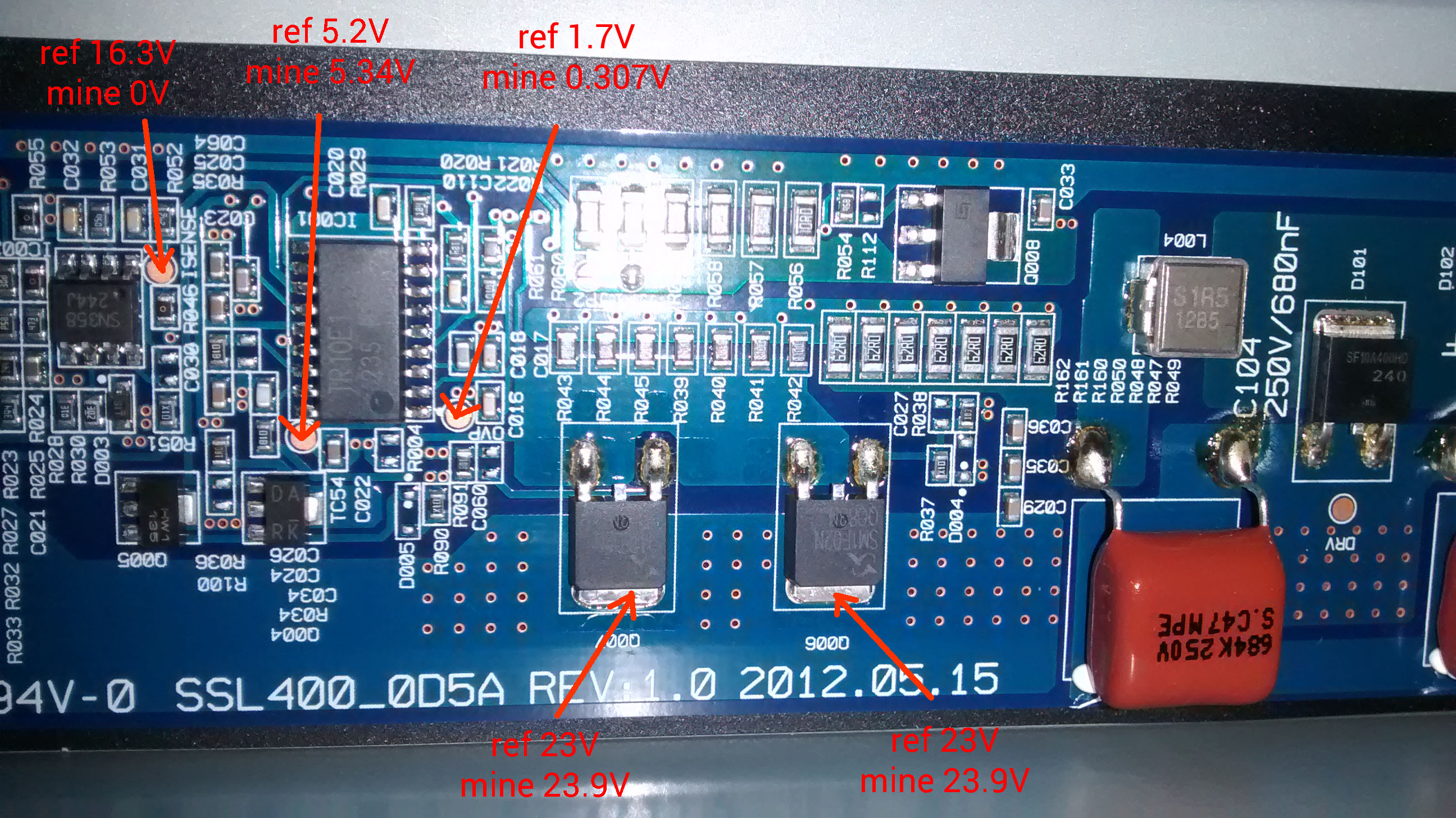

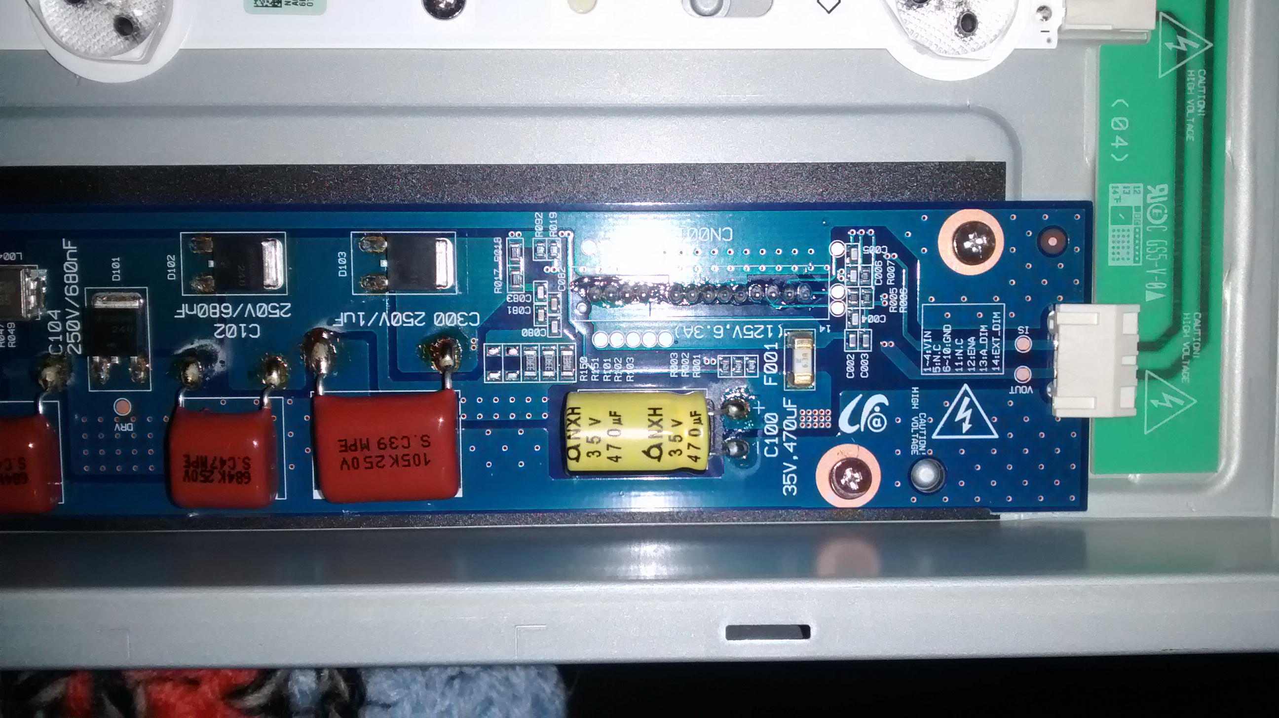

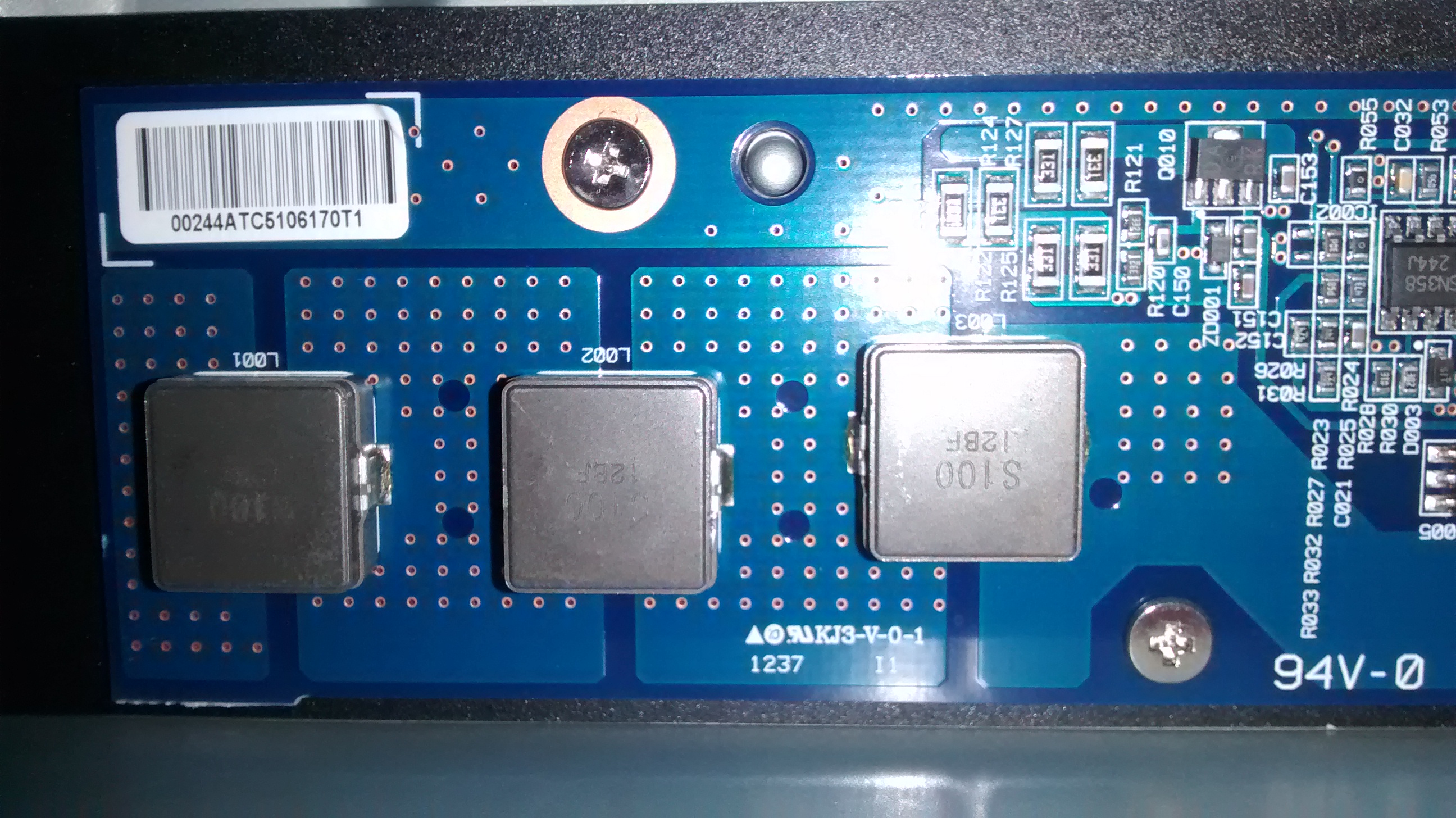

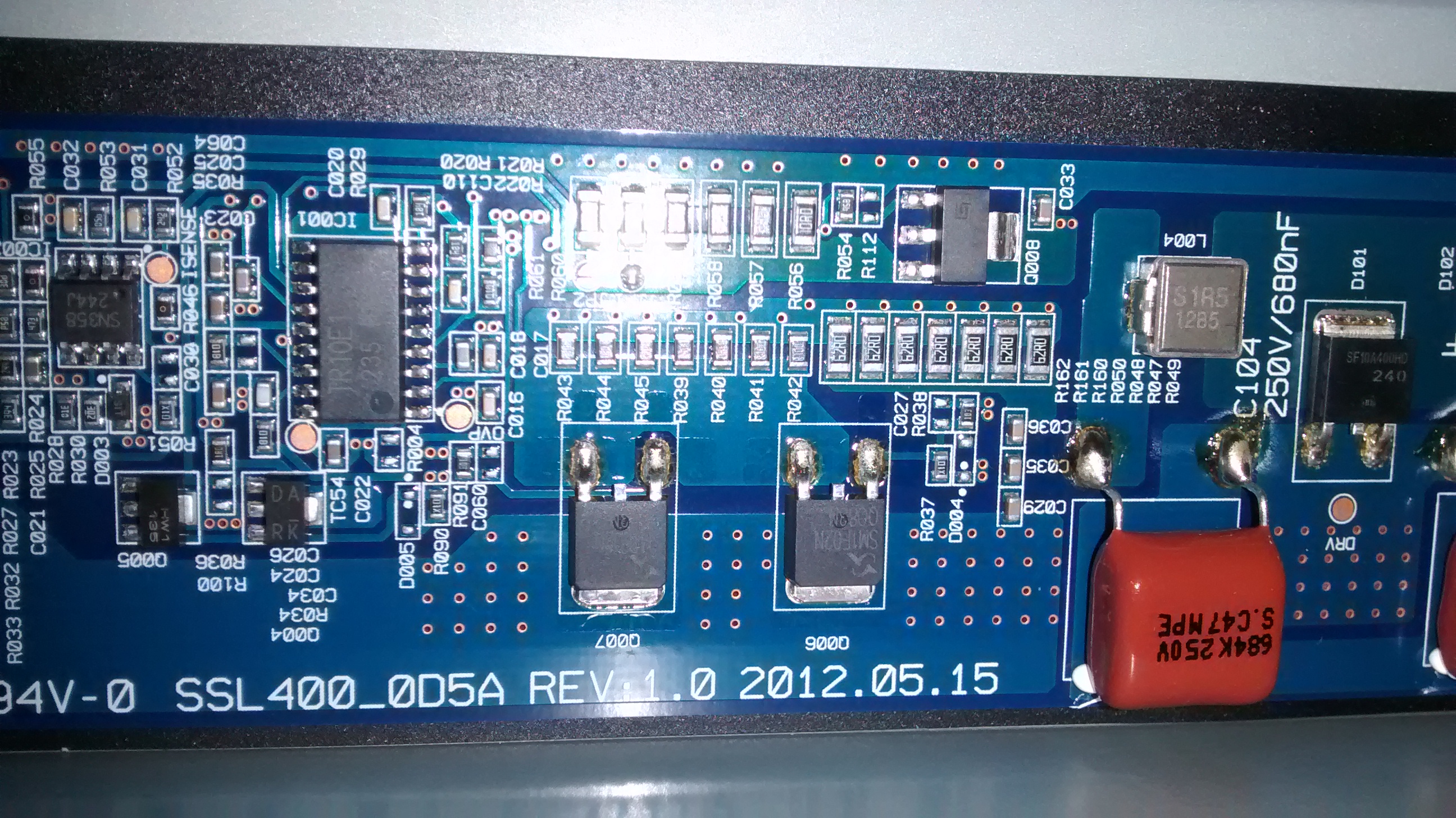

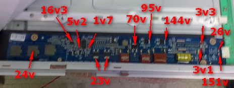

                  Now stripped (the tv thankfully - not me!) and even though there's nothing obvious I presume since no LED's light that the LED driver, SSL400_0D5A REV:1.0, is the culprit! Hence I'm now in pursuit of ideas/suggestions/test data for that (or maybe just source a replacement... rather not though!)

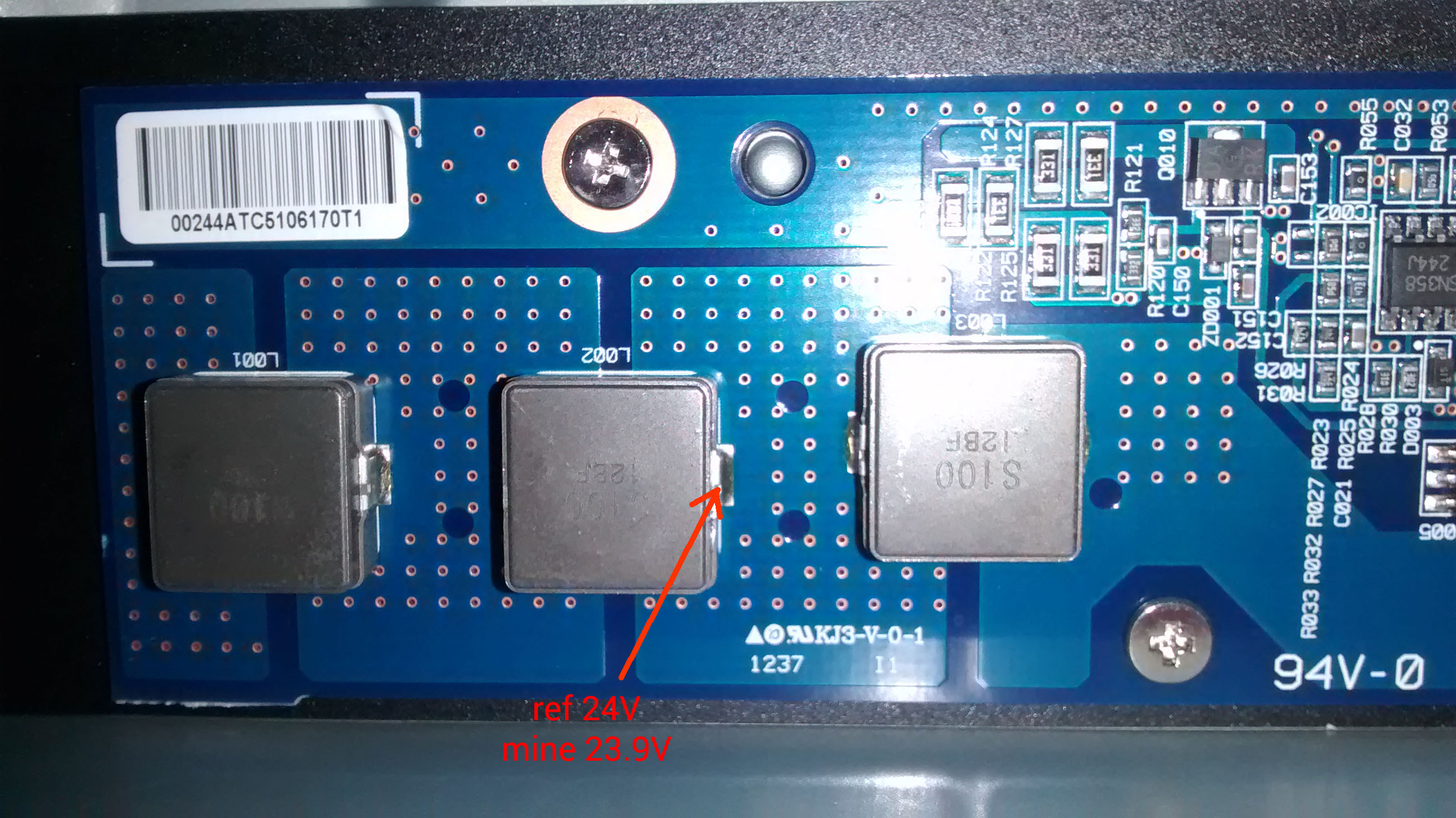

                    Have you checked the fuse and the voltages on the connector 1 to 14
                      No, but I will do now - thanks for heads up!

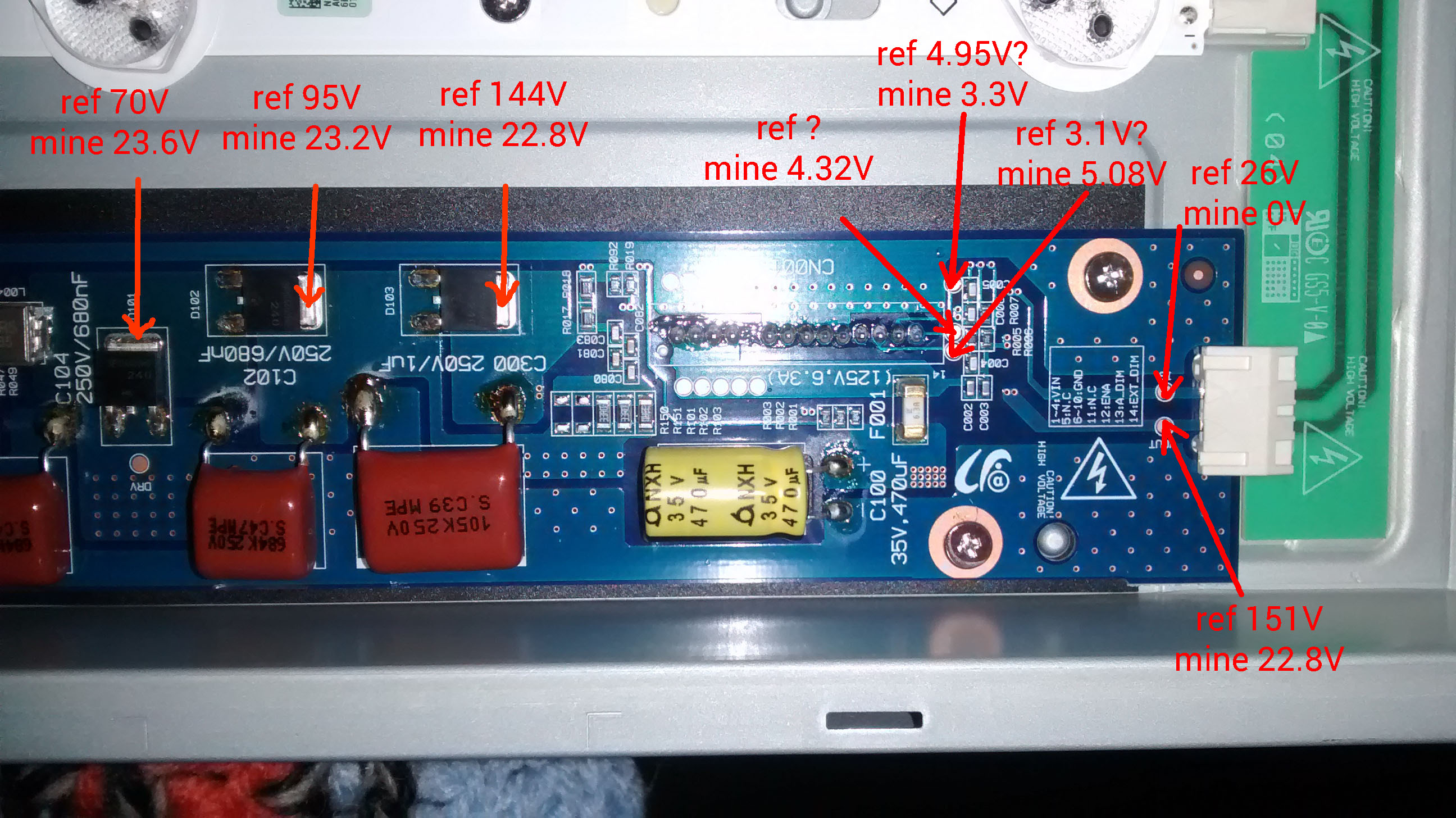

                        Both side of the fuse show 23.9V, and the connector runs;
                        1 - 4 all 23.9V
                        5 no connection
                        6 - 11 all 0V
                        12 = 5.08V
                        13 = 4.95V
                        14 = 4.32V
                        I will search online for spec/more info as to what they should be, however if you already know/have an idea I'd appreciate it.
                        And thanks for al the help thus far...
                          It says on the photo what the voltages should be and they look fine.
                          What voltage do you have at Vout as shown in post#9 photo 3
                            maybe whilst your waiting for answers start checking each led i use two aa batteries there are some good guides on you tube regarding test points on the strips
                              @dick_barton; I saw that 1-4 were Vin, but couldn't figure what 12,13,14 (ENA, A_DIM & EXT_DIM) should be - that's what I was wanting to check.
                              Vout gives 22.9V, do you know what it should be?
                                I found this but not a very good image.
                                They had a problem with Q005 being short circuit
                                  Found a thread here (https://www.badcaps.net/forum/showthread.php?t=41014, Sanyo, but same board) and there's a pic that seems to show Vout as 151V so there's def a problem with the driver - now about to work thro' the other points as best I can from that pic, which, though much better than nothing, is none too clear!
                                      Three photos here showing my values vs the reference ones on the (poor) photo - the ones with a "?" are very hard to discern on the original, in fact one seems to be missing altogether, but I've done my best, and if anyone can help pinpoint the likely cause(s) of the failure it'd be great.
                                      Also, those ref values applied to the board when fitted to a completely different tv, i.e. powered from a different p.s.u., and I have no idea whether that would make a difference (or how much difference)
