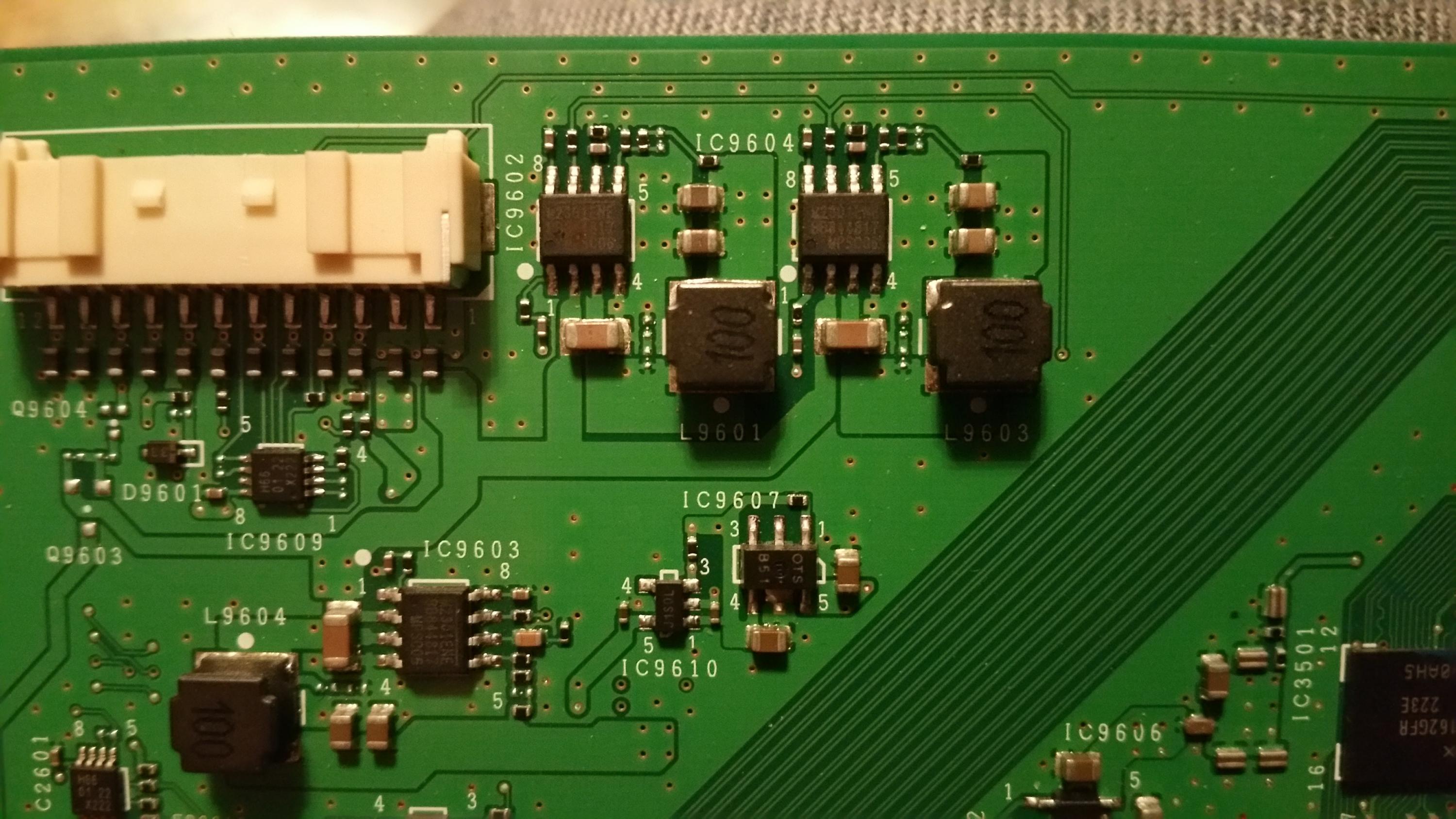

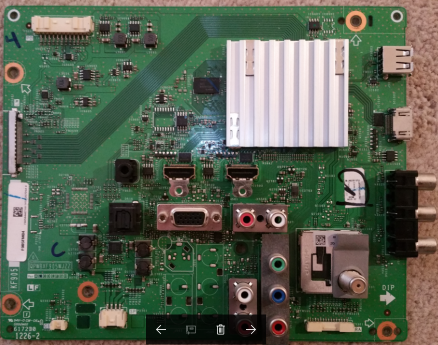

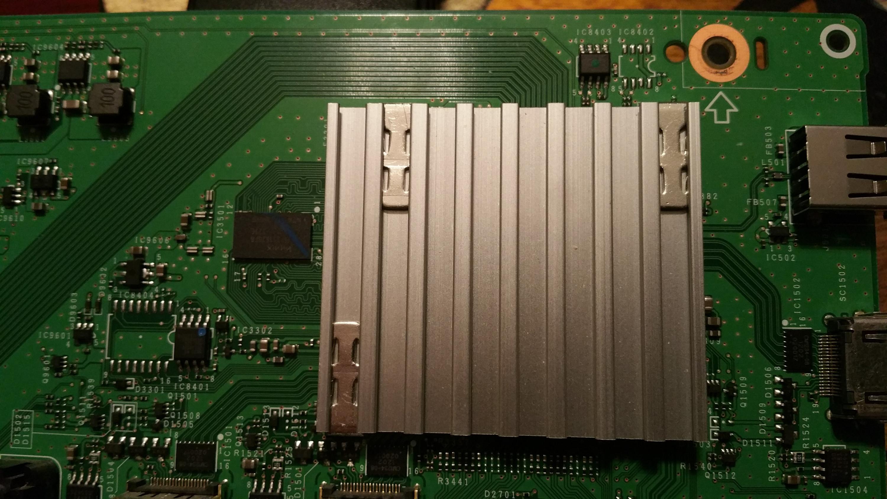

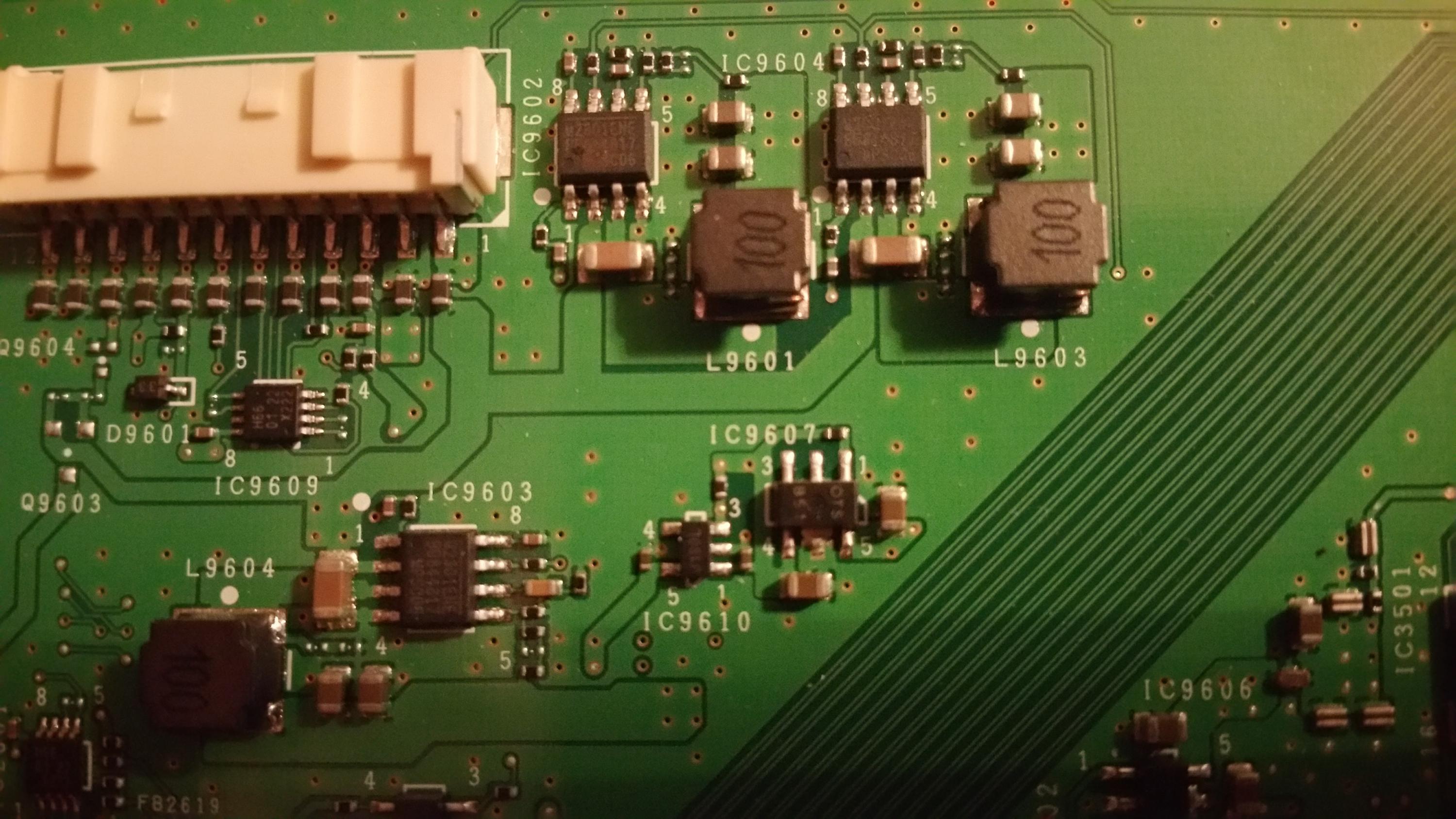

    Hello if anyone has any guidance I have a main board from a 60" Sharp that has issues from a power surge and from what I un derstand it is the eeprom or the voltager regulators or all of the above. The board-Sharp DUNTKKF905FM04 (KF905, QPWBXF905WJZZ) Main Board. I'm opting to swap these components out with a programmed eeprom and looking up the votltagre regulators through Mouser or digi-key. I don't know which are which since they all are 8 legged IC's- can anyone tell me where exactrly the eeprom and voltage regulators are located on this board?

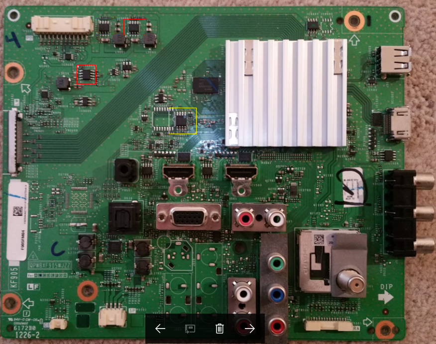

    post the numbers from the ic's eeproms (flash) can have a number like 25Q64FVSIG for example, also the eeproms are usually a bit wider
    The one in yellow could be eeprom, red could be regulators
    see if this list helps

      Re: Eeprom and voltager regulators
      Would need better pictures. eeprom have 24cxxxx. Upper left around coils should be dc/dc converters
        Please post bigger resolution pictures and USE JPG for images with lots of colors, like your image. It will compress much better, which means you'll be able to upload higher resolution images.
        PNG is great for screenshots and images with lots of sharp lines and things you want to keep in the file, as the format is lossless.. but for this case it's not necessary.
        A lot of your ICs have 24CS in the name ... 24 usually tells you it's an eeprom (or some kind of memory chip, flash based eeprom, regular eeprom) , CS tells you (most likely) that it's CMOS technology based, S serial (meaning data can be read or written from/it using serial links like i2c , spi

        and so on .. DA in front may tell you it's a DAC (digital to analogue converter)..
        Those MP2301 are probably switching regulators from Monolithic Power , same for RP130N331B chips which are made by Ricoh .. just take the most important part of those product codes and google it if you can't find the parts at the above distributors.

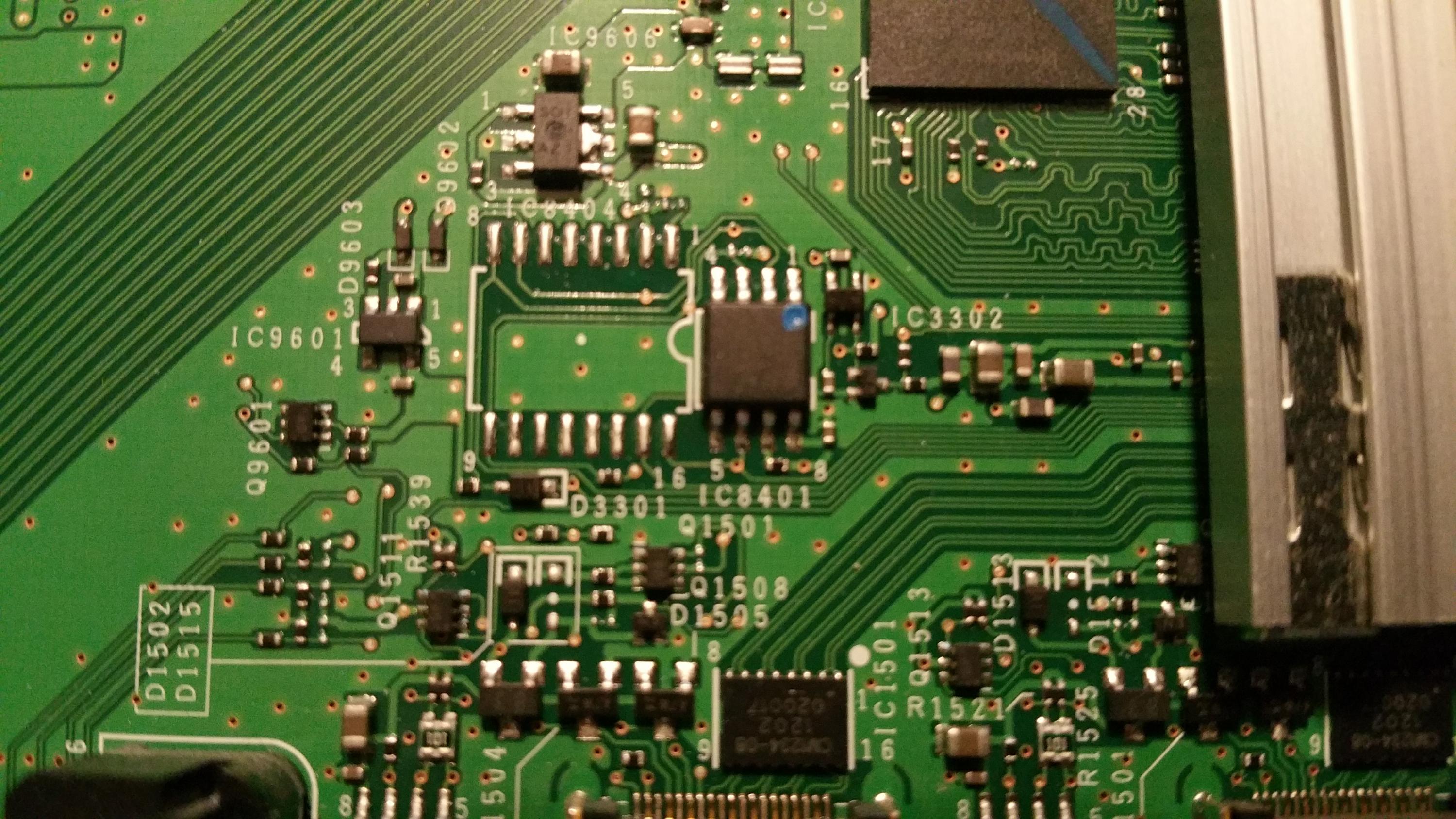

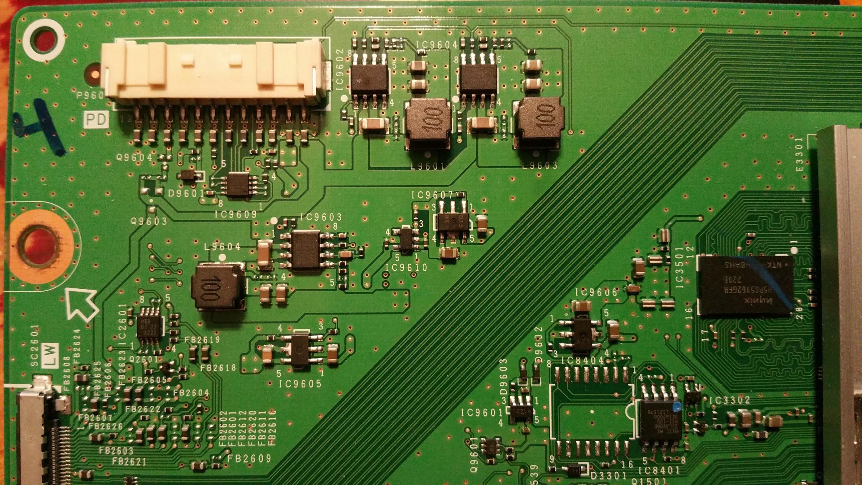

          not sure of that number either but heres better pics
            just dont know what is what is what but on a hunch I think the eeprom is the IC8401
              There are more than one eeprom and flash ic on this board, also a few regulator ic's I posted a list, look up the numbers and they will tell you what they are. Whats the model number of the tv I might have the service manual
              IC8401 IC MX25L3206EM2I-12G
                    I don't have the exact model. This is for a 70LE550U and this one uses a DKEYMF905FM06 main that looks similar. It should be possible to check the voltage regulator voltages, The board also uses eeproms for hdmi & vga 24cs02's I believe ic8401 (page16) is the main micro spi flash
