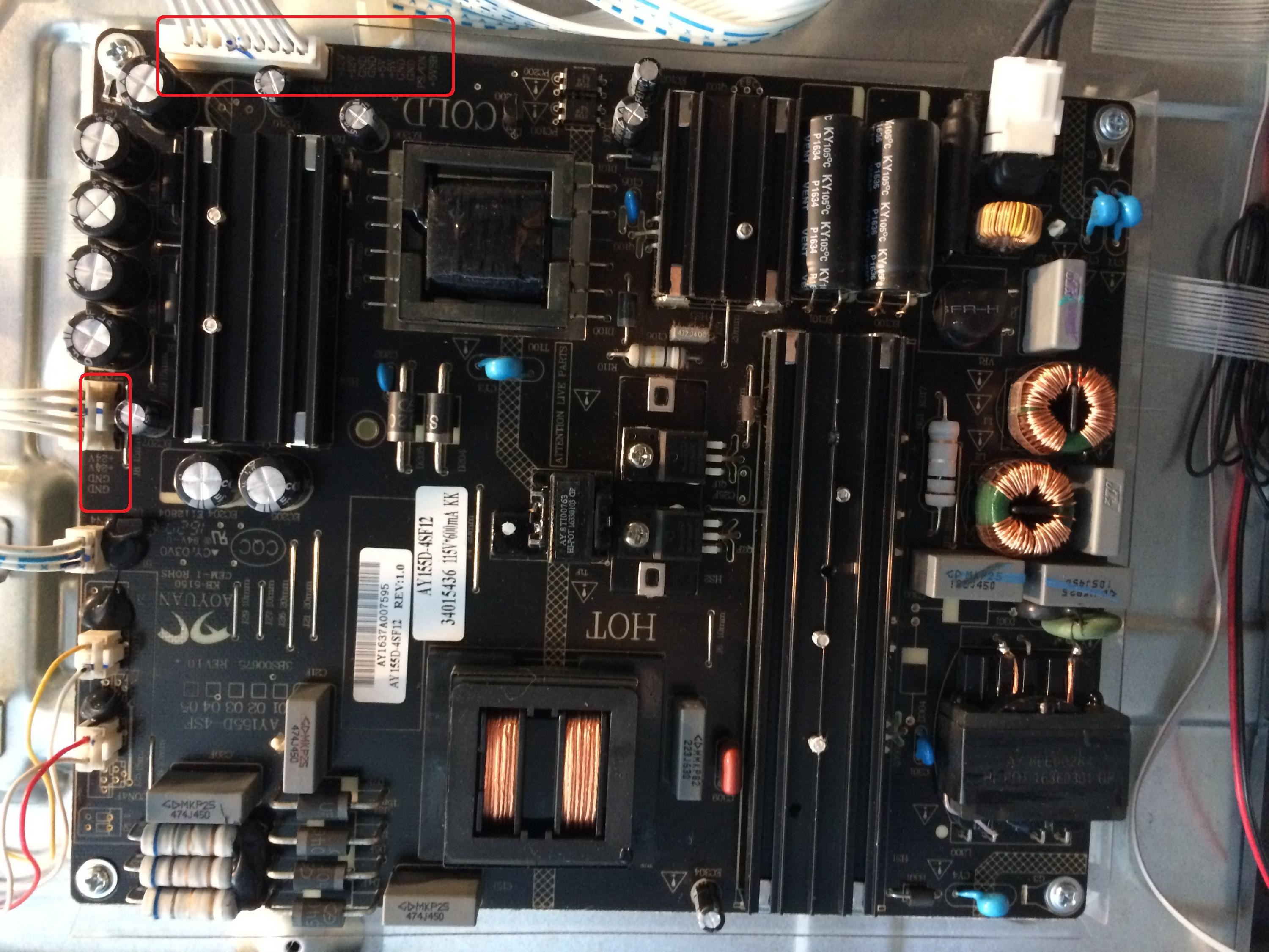

          We NEED good clear pictures of the board, especially the power supply board.
          Are you sure that 'aAY155D-45F12' is P/N of the power supply board?

            Re: Westinghouse 55" - mostly dead

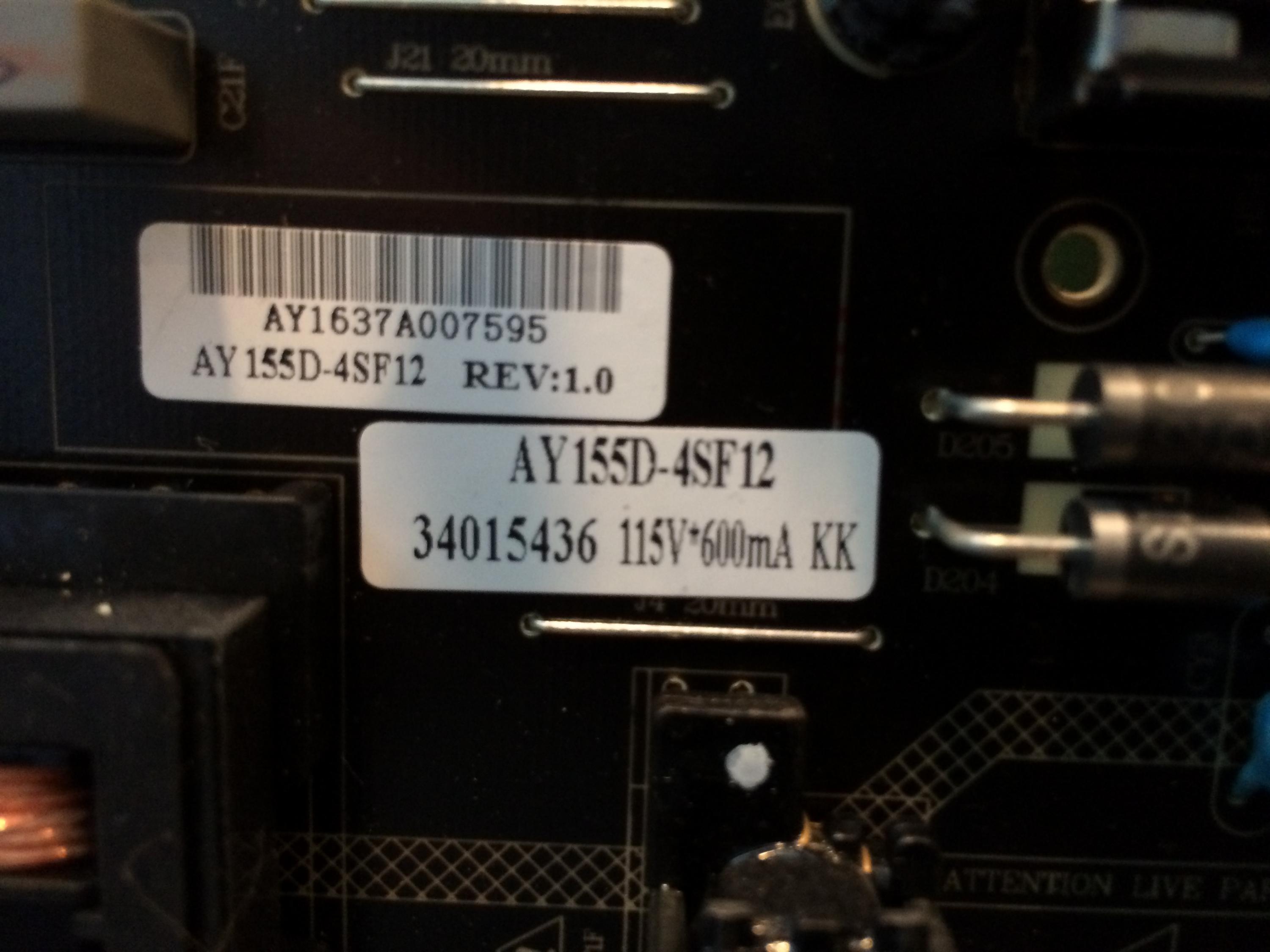

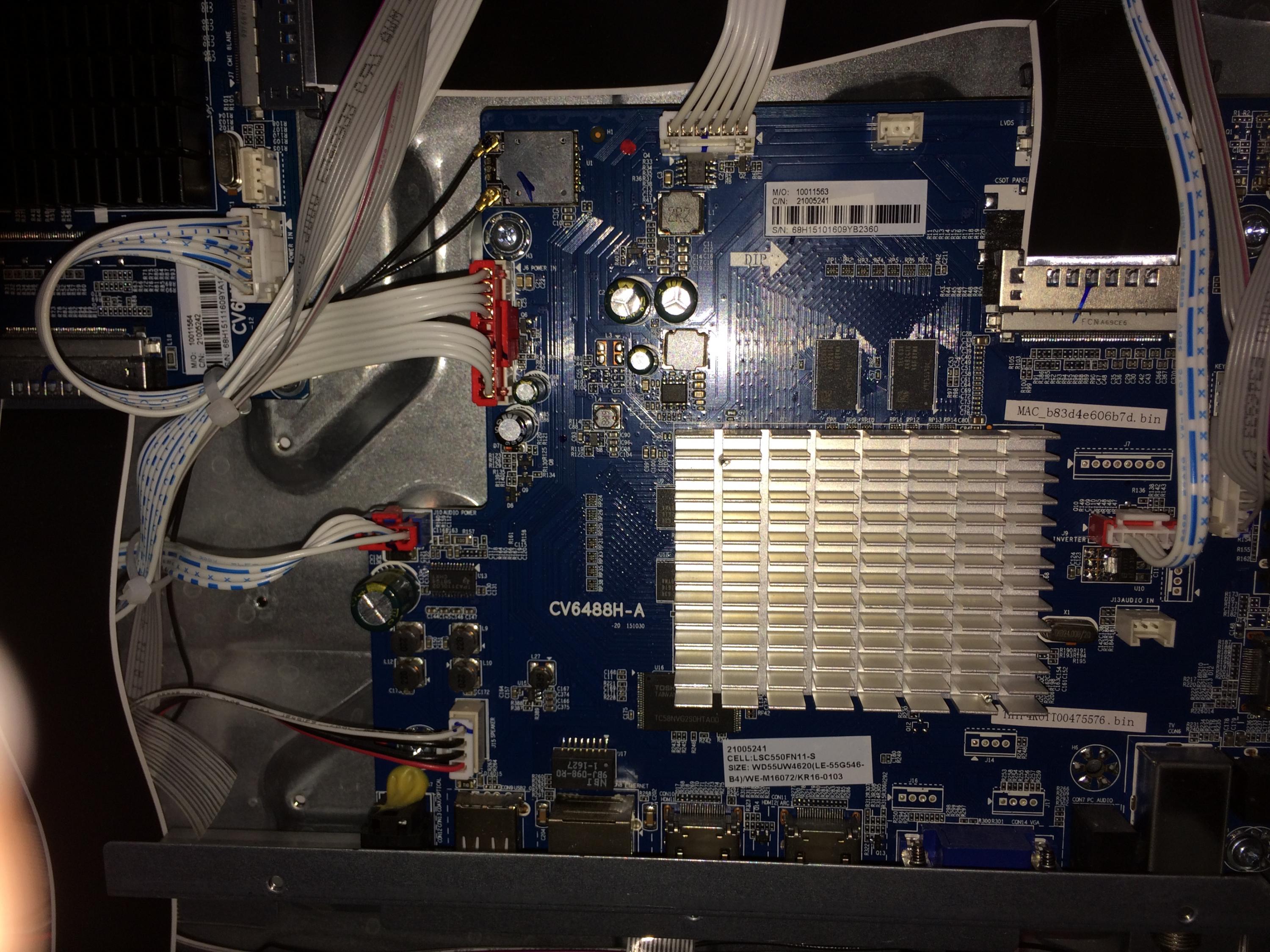

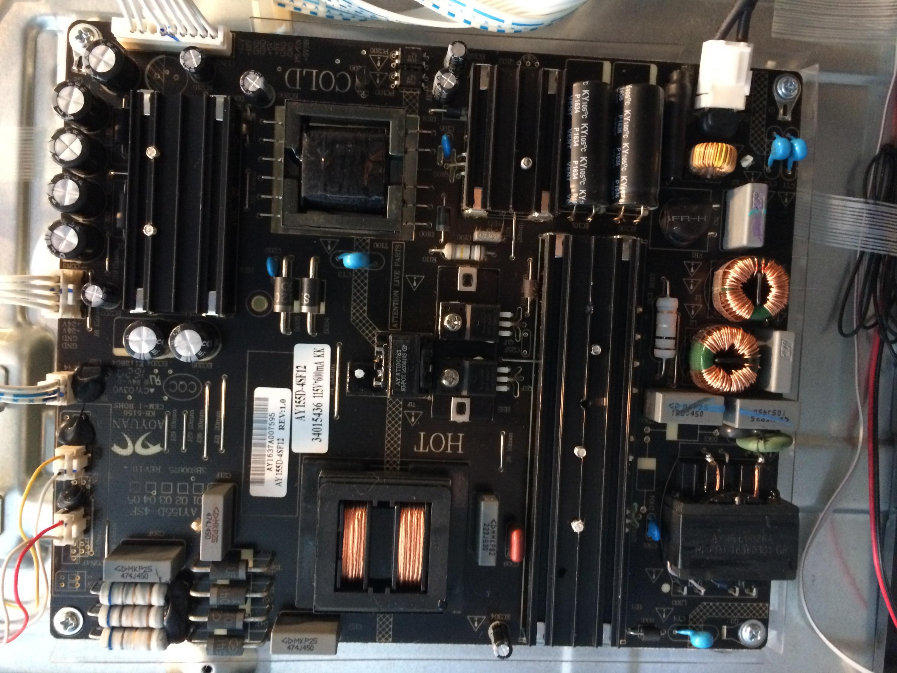

            As requested. (Thanks)
            IMG_2033 - Main Board
            IMG_2029 - Power Board
            IMG_2031 - Power board sticker
              Just looking a little closer, the power board part number is AY155D-4SF12, not AY155D-45F12 as I'd originally listed. (The 5 and S look too similar for these old eyes I guess) :-)
                Your board seems to be marked. Are there markings on con4 under the silicon? You got your voltages when you forced power supply on? Are your button voltages changing when you push them?

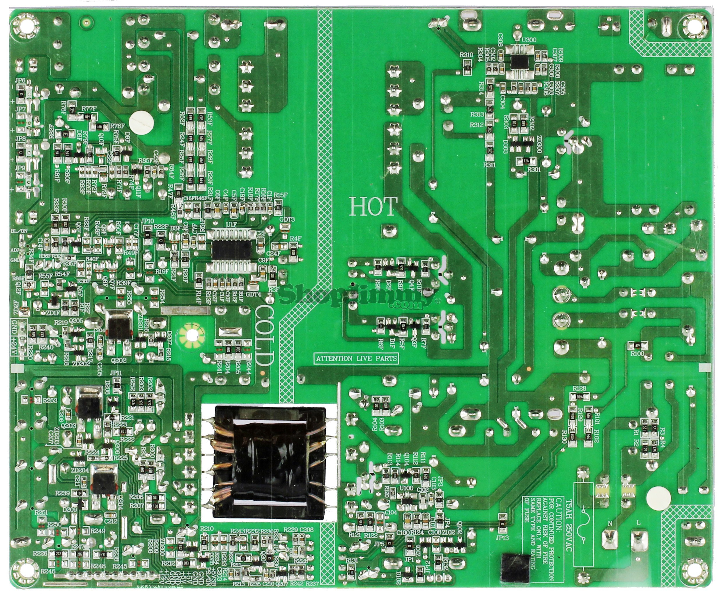

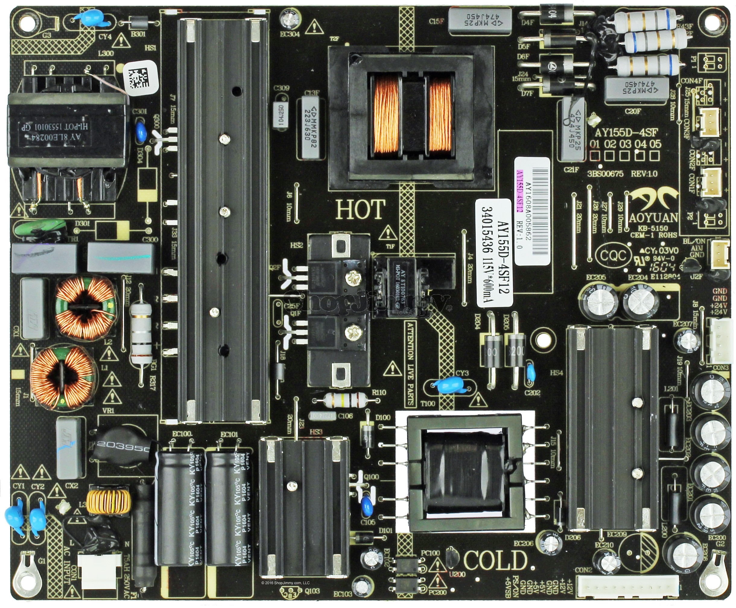

                              http://www.shopjimmy.com/westinghous...er-supply.htm#
                              Westinghouse AY155D-4SF12 Power Supply
                              Pictures provided by SHOPJIMMY.
                              BL-ON is on the 3-PIN connector with BL-ON, ADJ, and GND labels next to it.
                              See what you have on BL-ON pin.
                                Ahhhh, THAT's where it is.... The labels are covered with a big gob of potting compound so I couldn't see it initially. Thank you!
                                So - BL-ON: .05vdc. Disconnect cable between Main & Power board, BL-ON jumps to 1.34vdc then slowly decreases to close to 0 over 2-3 seconds. Doesn't matter if backlights are connected or not, same voltage readings.
                                2-wire back light connectors (wired to backlights) on pwr brd: .65vdc, decreases to 0 when pwr brd <-> main brd ribbon disconnected.
                                PS/ON: 4.71vdc, Does NOT change when pressing power button.
                                Thanks so much for the assistance so far guys...
