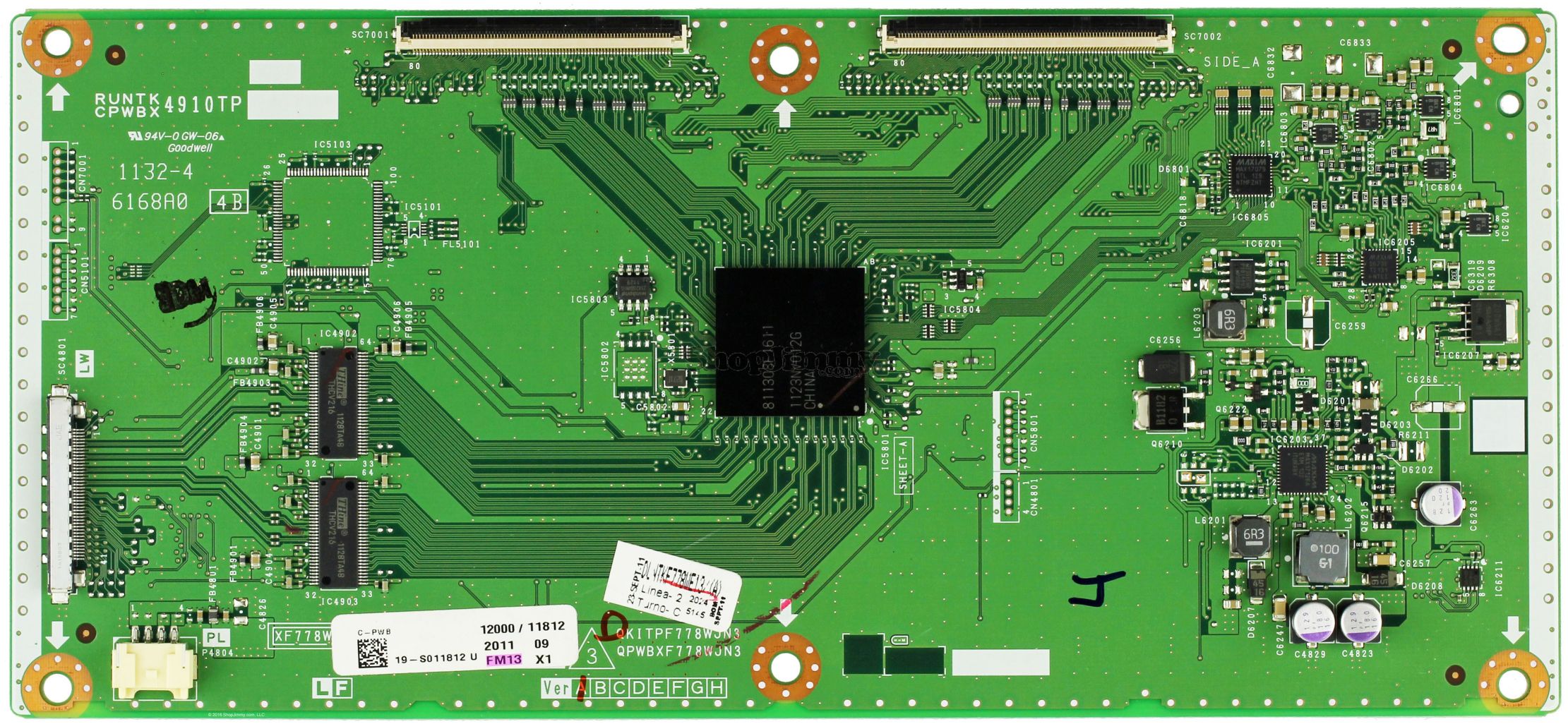

    How do you remove the ribbon cables from a T-con board?
    This is an image of a T-con board that goes in a 70 inch Sharp LCD TV(LC-70LE632U). You can see 2 black and white connectors on the top of the board that a ribbon cable plugs into. How do I get the ribbon cables out of the connectors?
    On the left side of this image close to the bottom is a white connector that a ribbon cable with a black connector plugs into. I have already pulled the ribbon cable out of the black connector as I attempted to unplug it.
    I have a service manual but am unable to identify the part number for it. Any help would be greatly appreciated.

        On the ribbon side of the black piece with your fingernail lift the black strip will pop up and you can pull ribbon cable. Might have to lift ribbon cable a little to get it out.

          Dskall thank you very much, I removed the ribbon cables from the top connectors on the top of the board with no problem. Now when I install the new board do the ribbon cables snap into place or do I have to lift that black piece to install them?
          Now, the connector on the bottom left is not exactly the same as the top. The connector on the ribbon cable plugs into the connector on the board, or at least that's the way it looks to me. As I mentioned above, I have already pulled the ribbon cable out of the connector. Looks like there might be tabs on both sides of the connector, not sure.

            Connector on left should have tabs on each side. Squeeze them as you pull cable. When you replace you should hear them click in. The ones on top slid in then you push black strip down to lock them.

                            Peter, I might have ruined the cable that goes from the T-con board to the main board. As I was attempting to get it loose from the T-con board, I pulled the ribbon cable out of the connector. I'd rather buy a new cable than take a chance, so if anyone can help me find the part number I would be most grateful.
