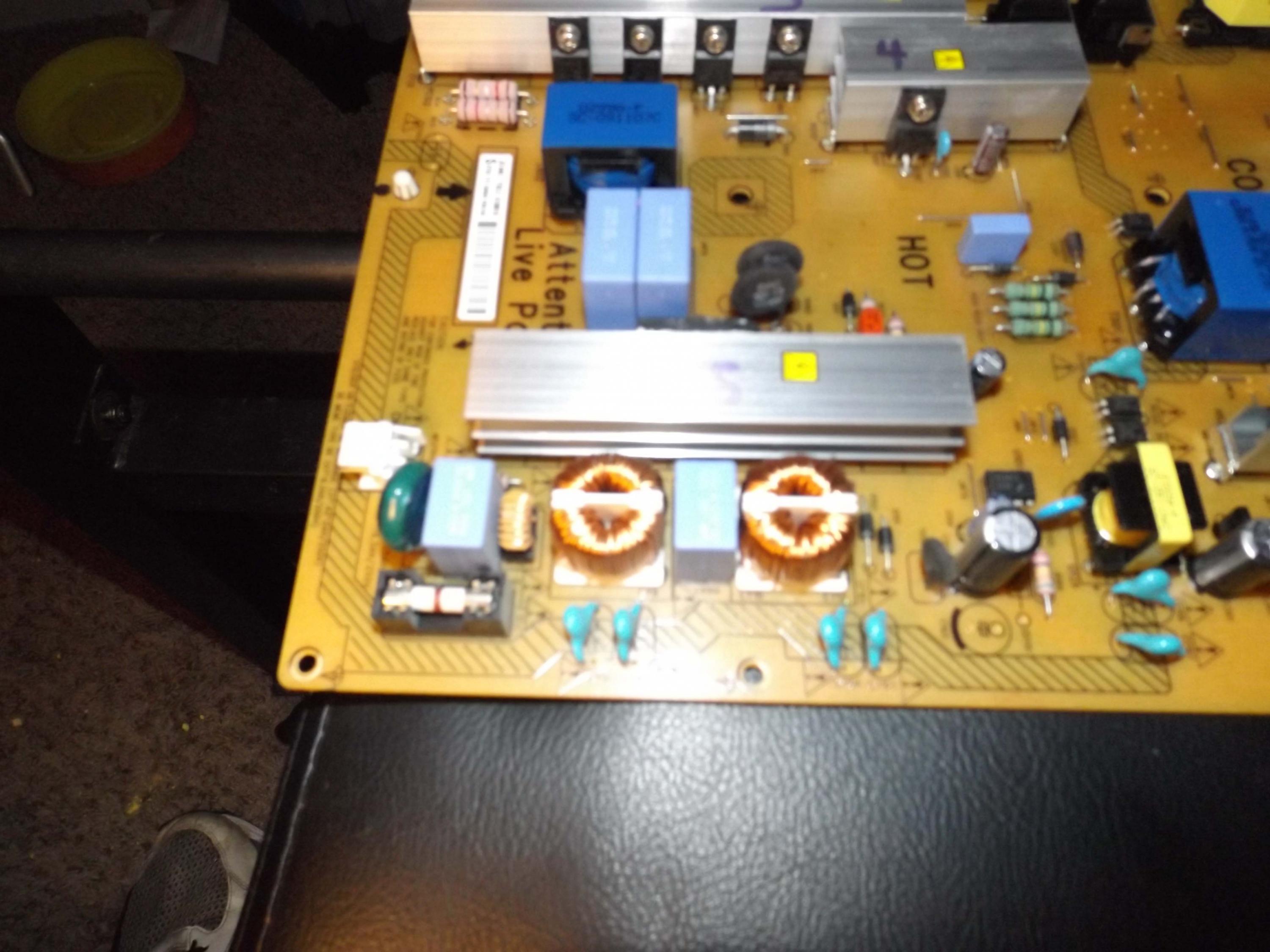

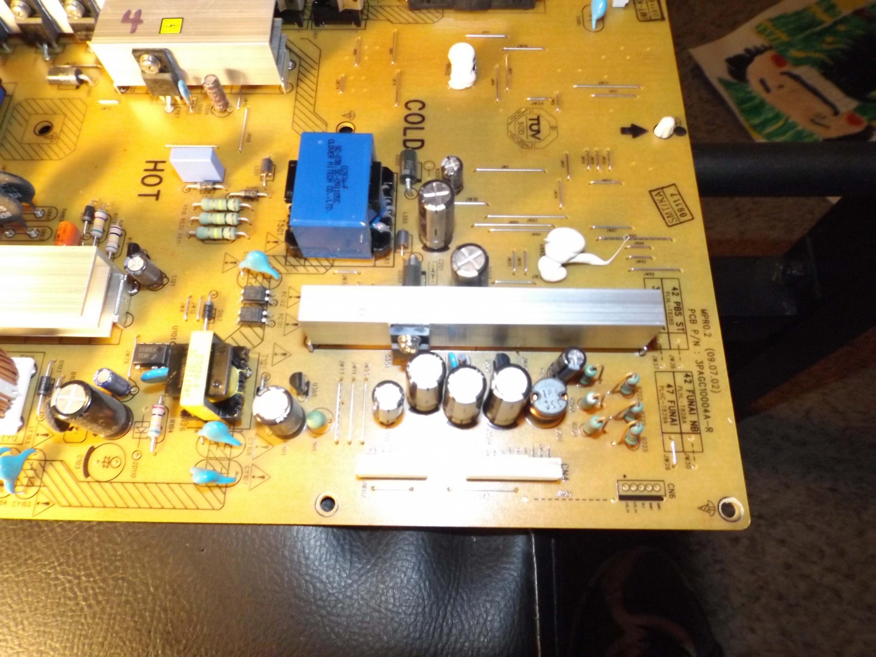

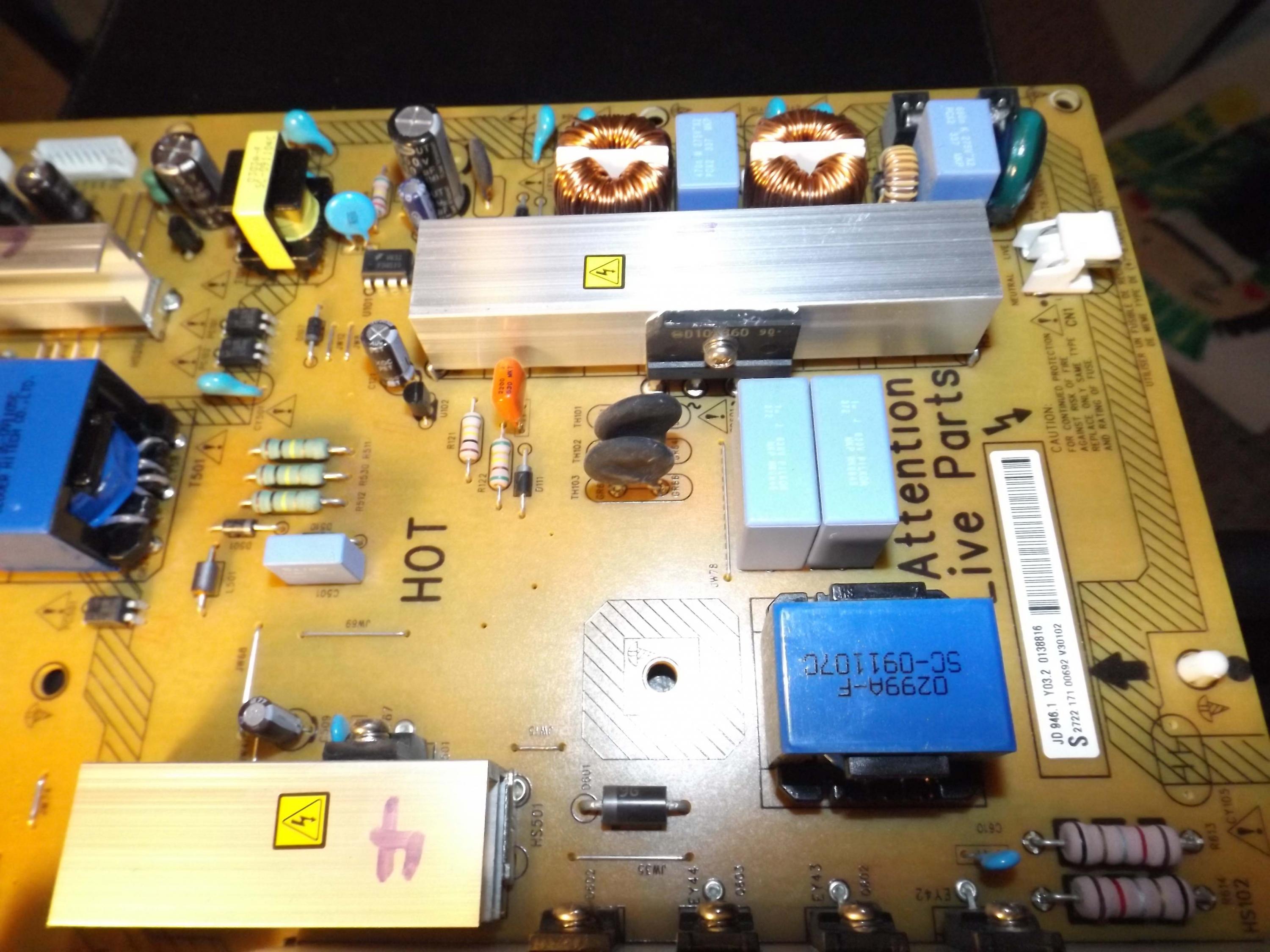

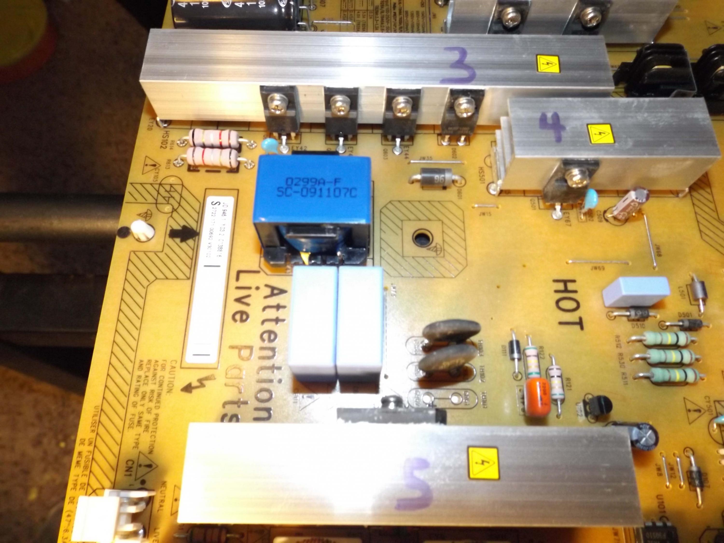

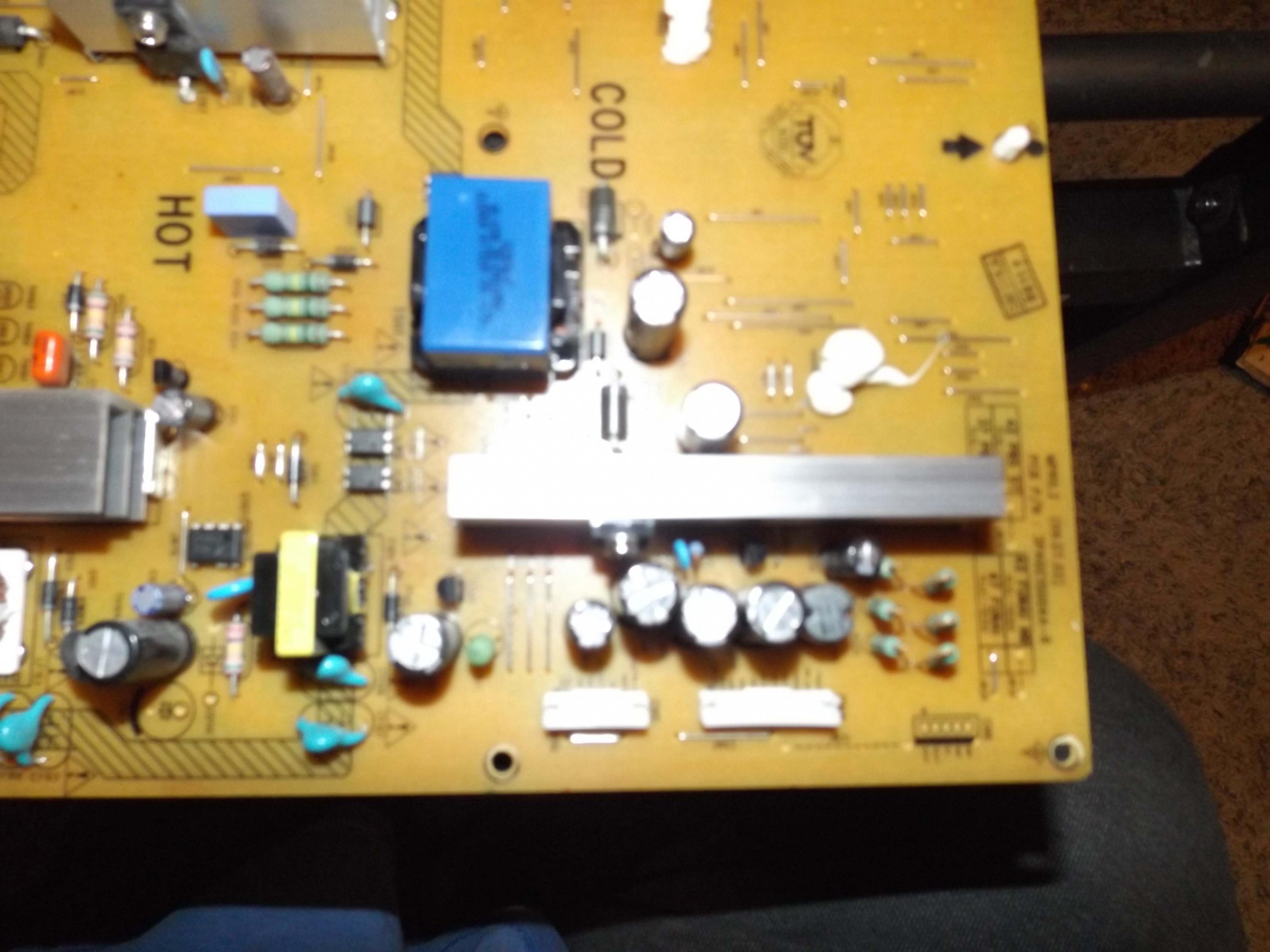

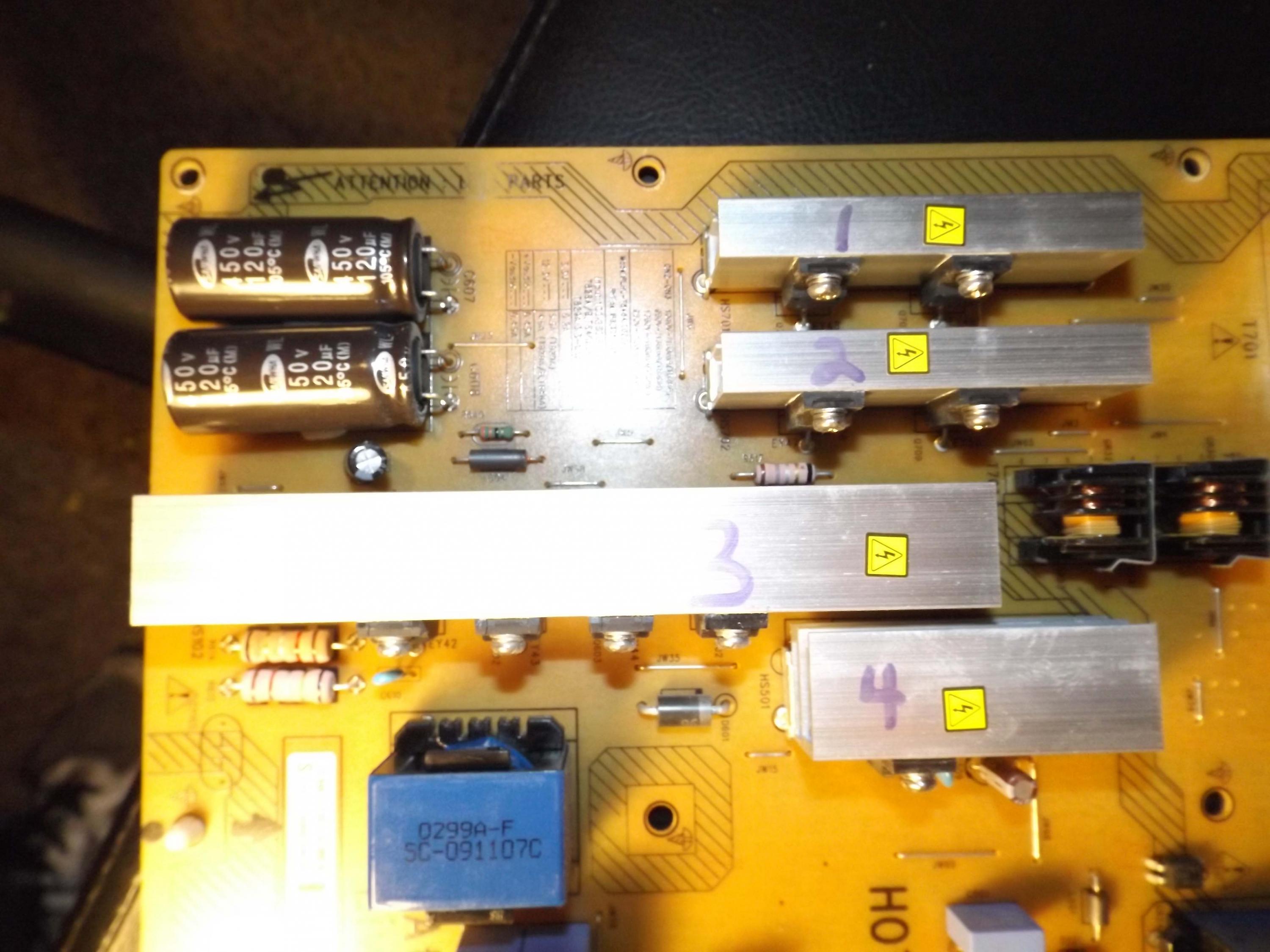

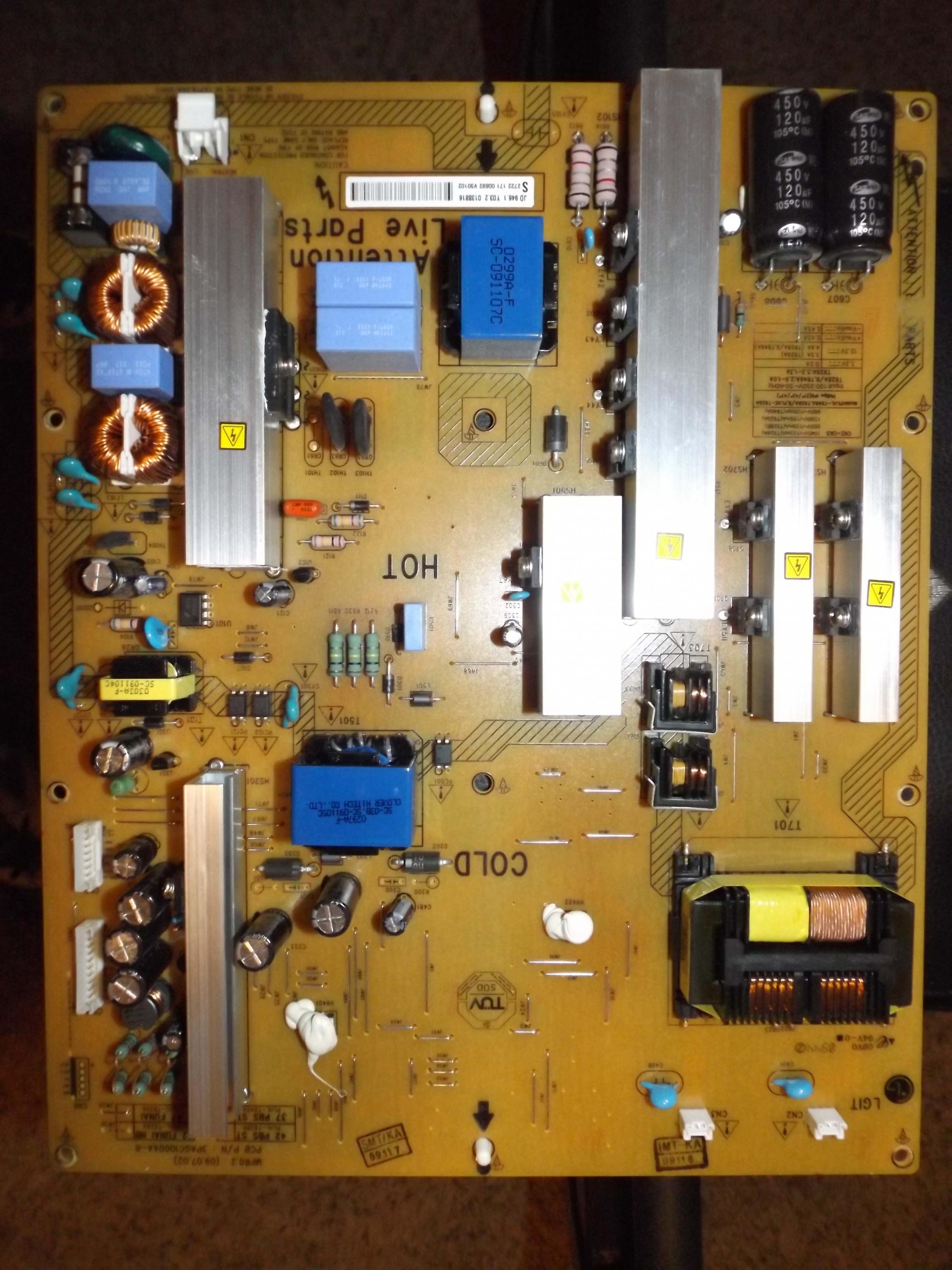

    When it turns on it has a low glow on right and left side of the screen. Like the lights are trying to come on. Then it goes black.
    With a flash light I can see menu, av, etc.
    With the back off, you press power button a green led come on near the cpu.
    It stays on if I leave tv on.
    No signs of bad caps, busted / cracked IC, or missing IC legs

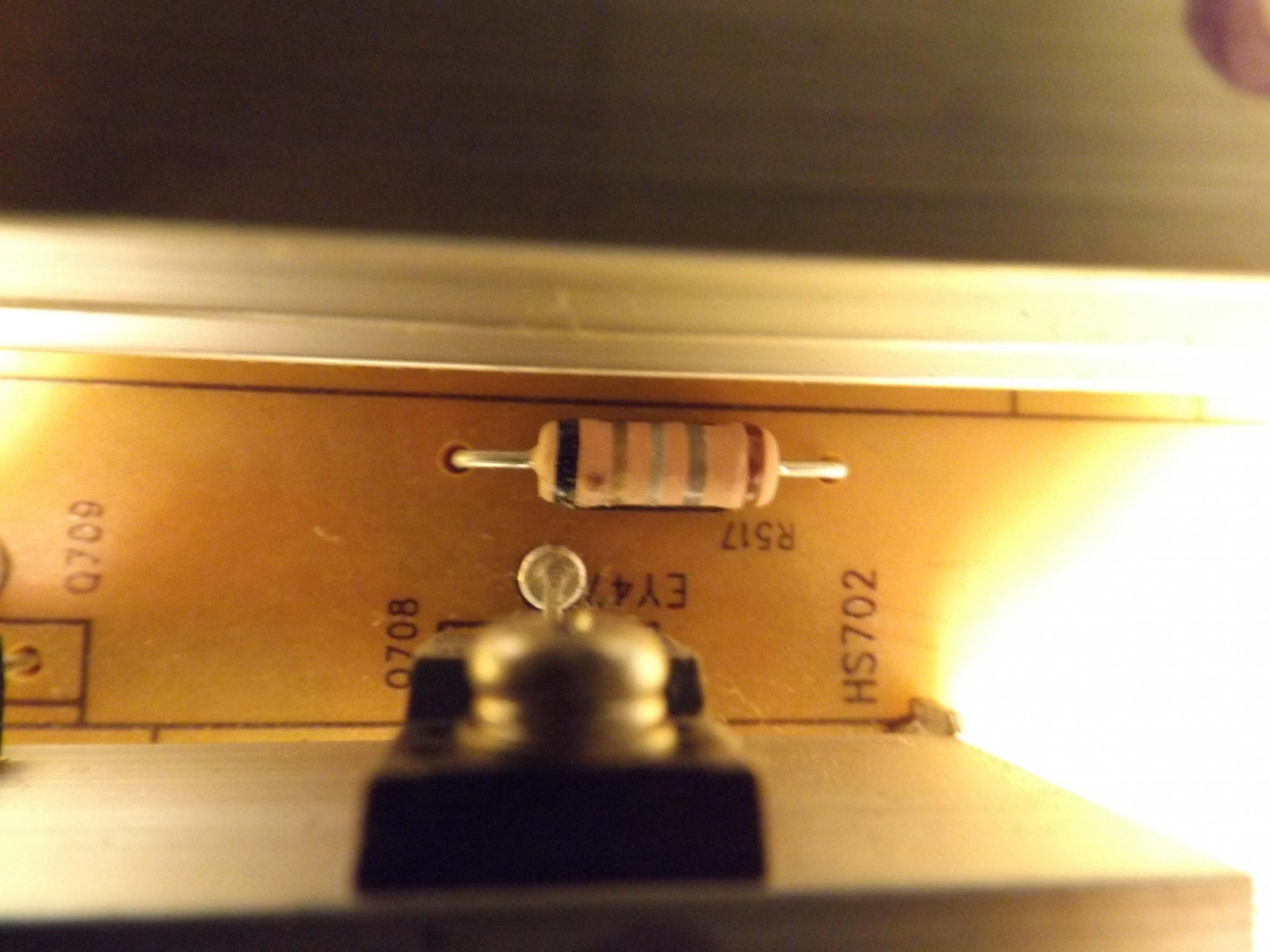

    There is one resistor that looks suspect , although I cannot read its value as it 5th band is black.
    I think the psu has the backlight inverter built in.

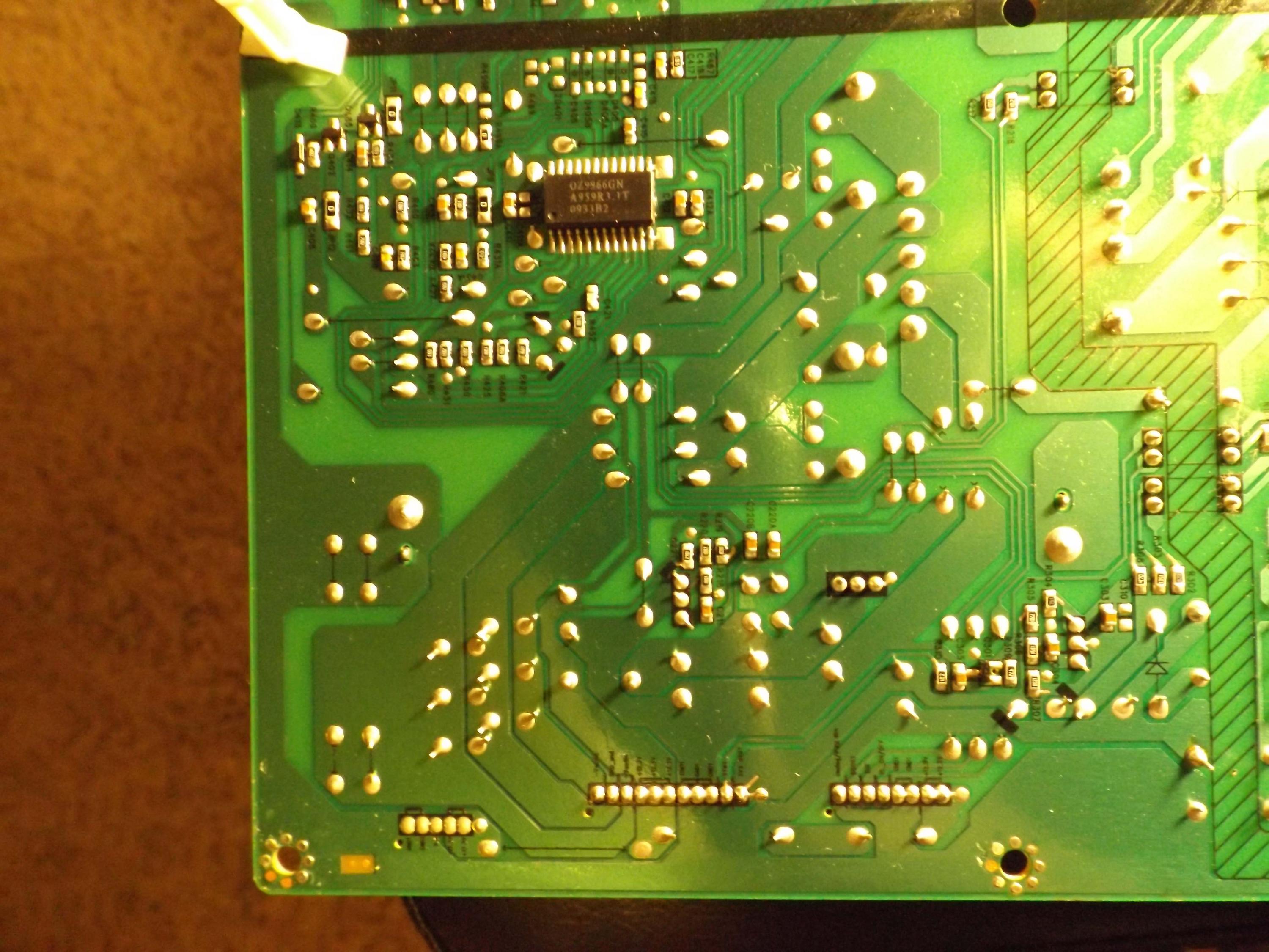

    The photos posted are top and bottom of the PSU.

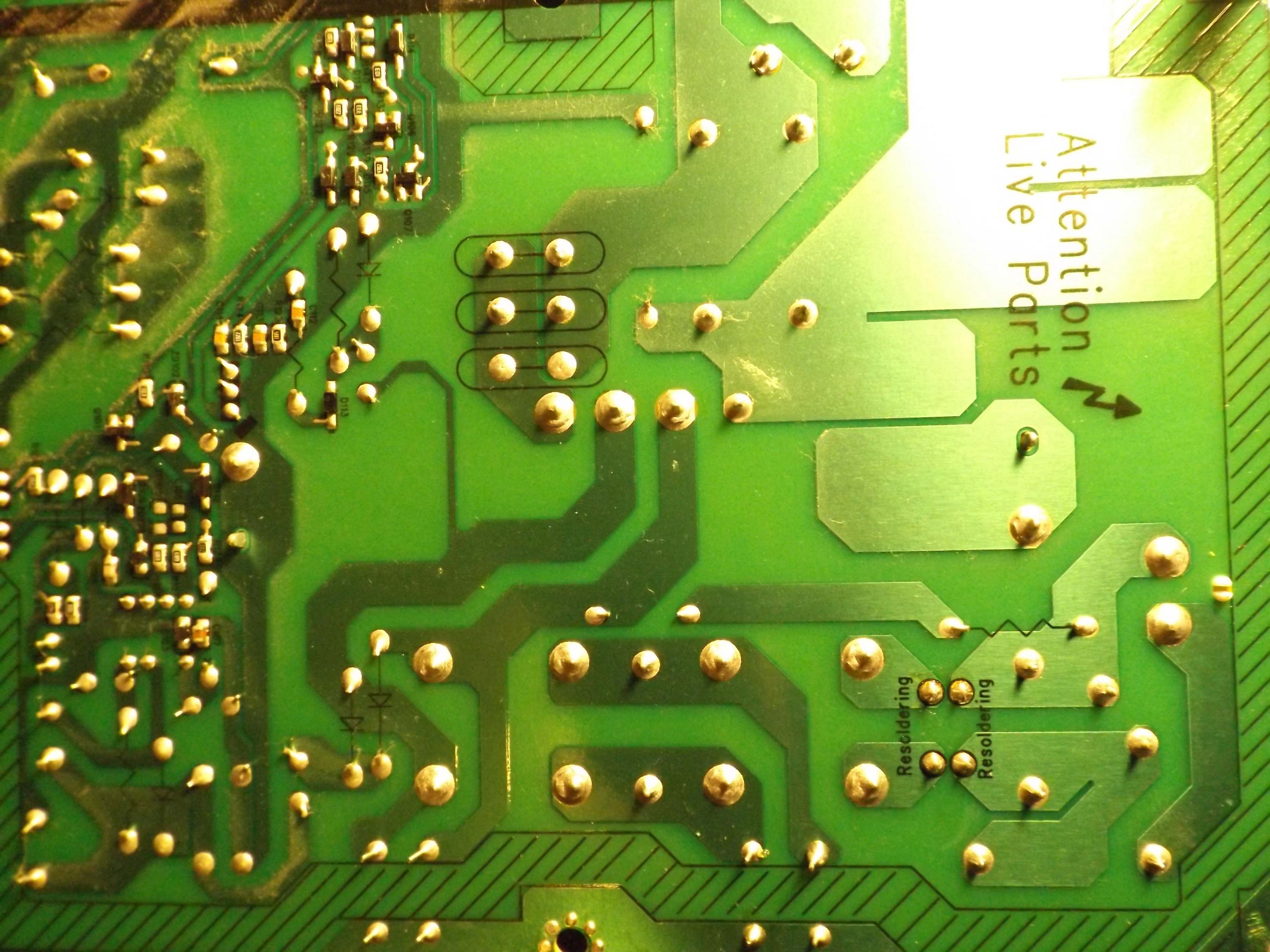

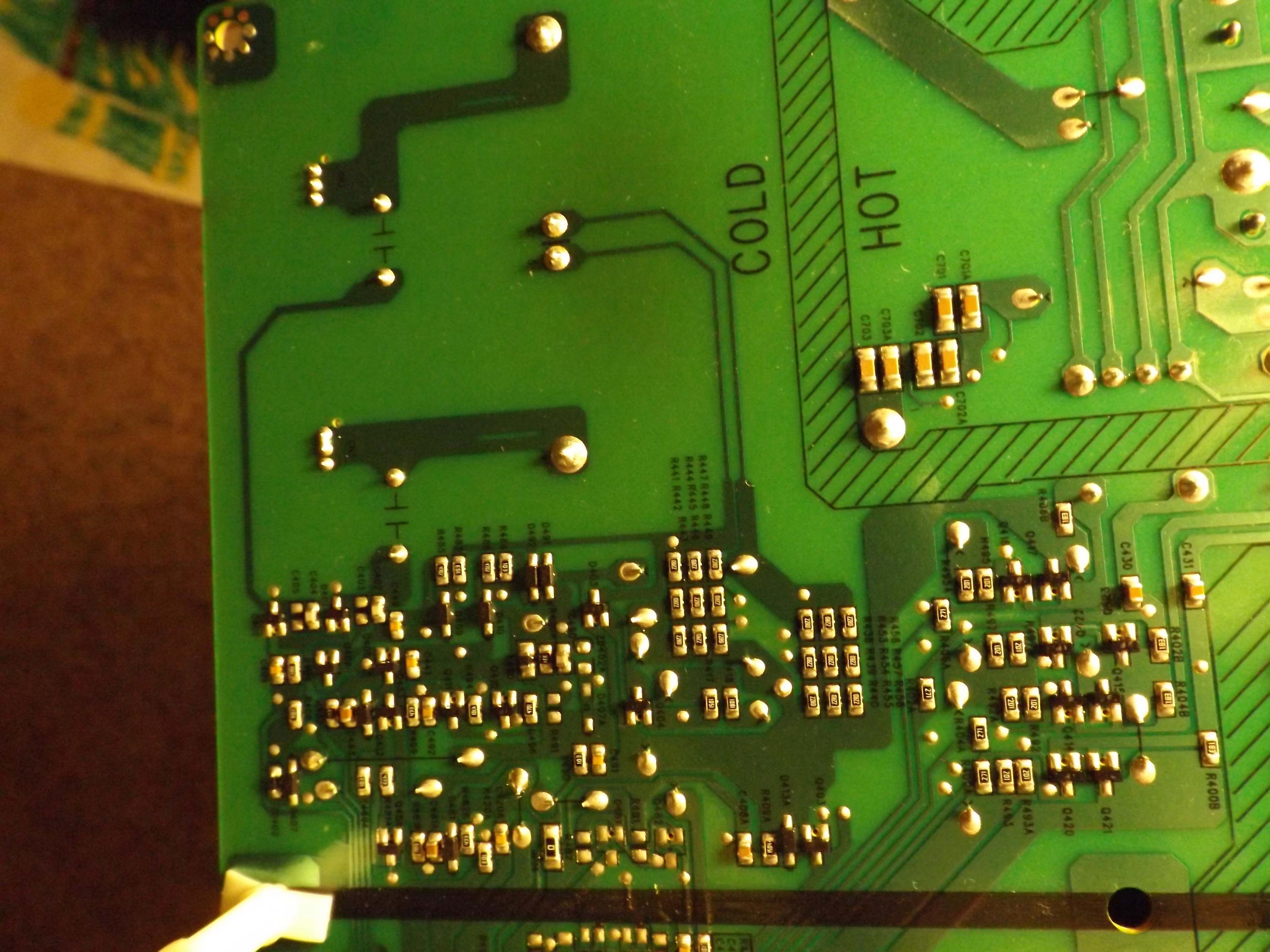

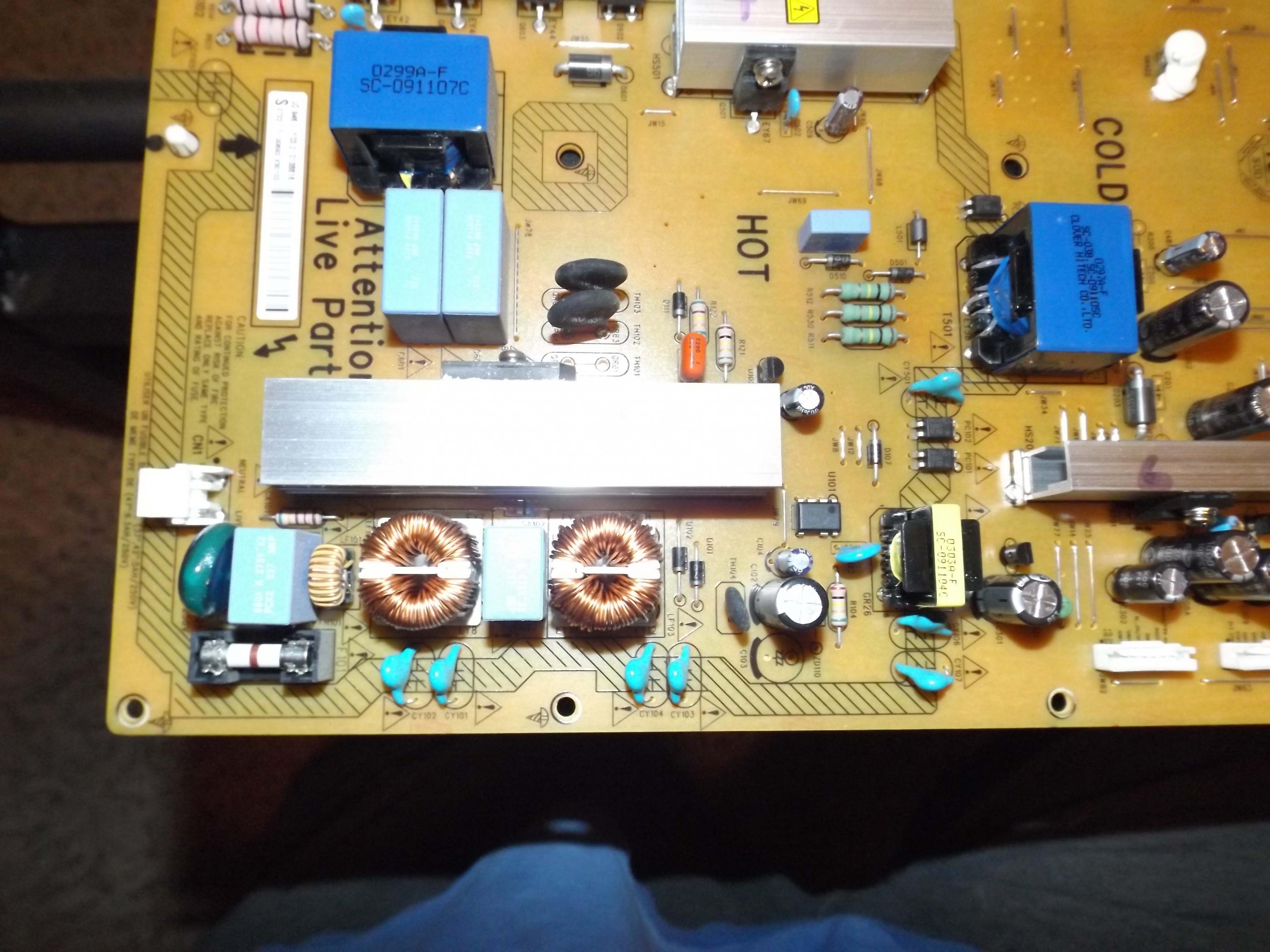

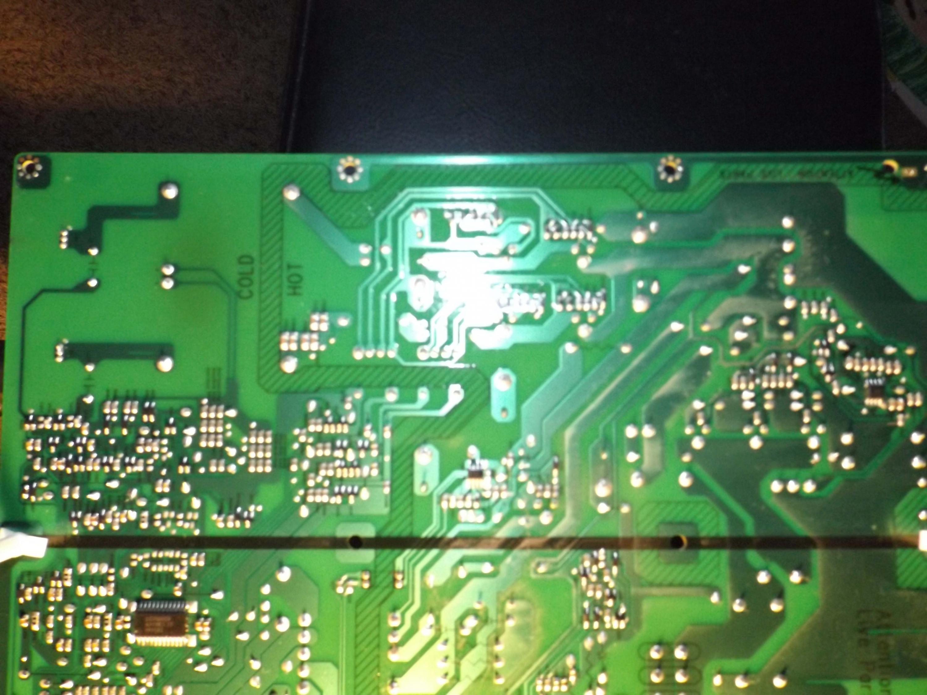

    Re: Phihips 47pfl5704d / f7 Back light not working

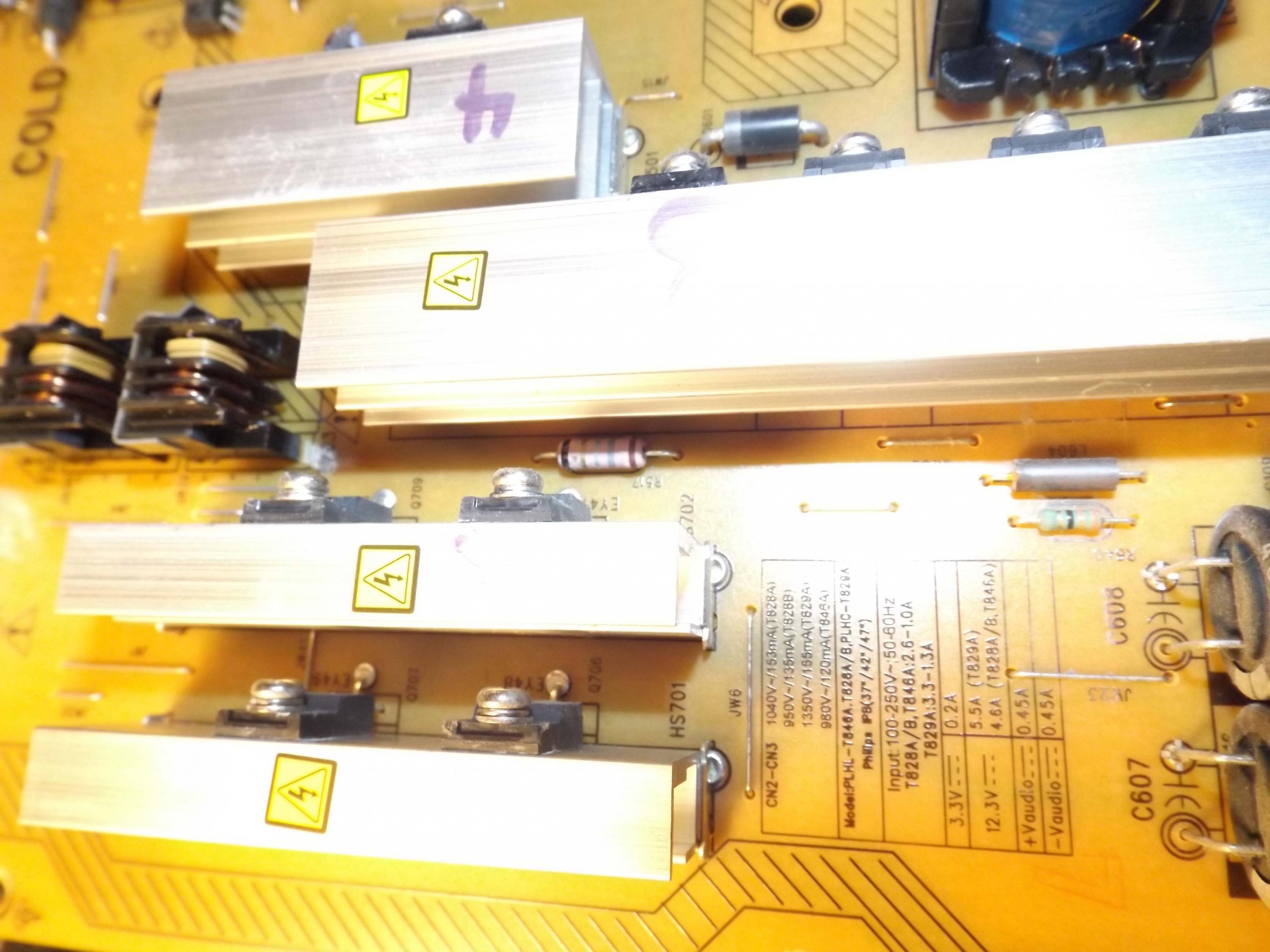

    Bottom photos and one more of the top.
    I can take more photos of what ever area if they are not clear enough. Will work on getting better photos anyway.
    I can put back in to do volt test too. Looking for what to do now, also maybe guide me through why you think i need to test xyz. I want to learn as i go thanks.

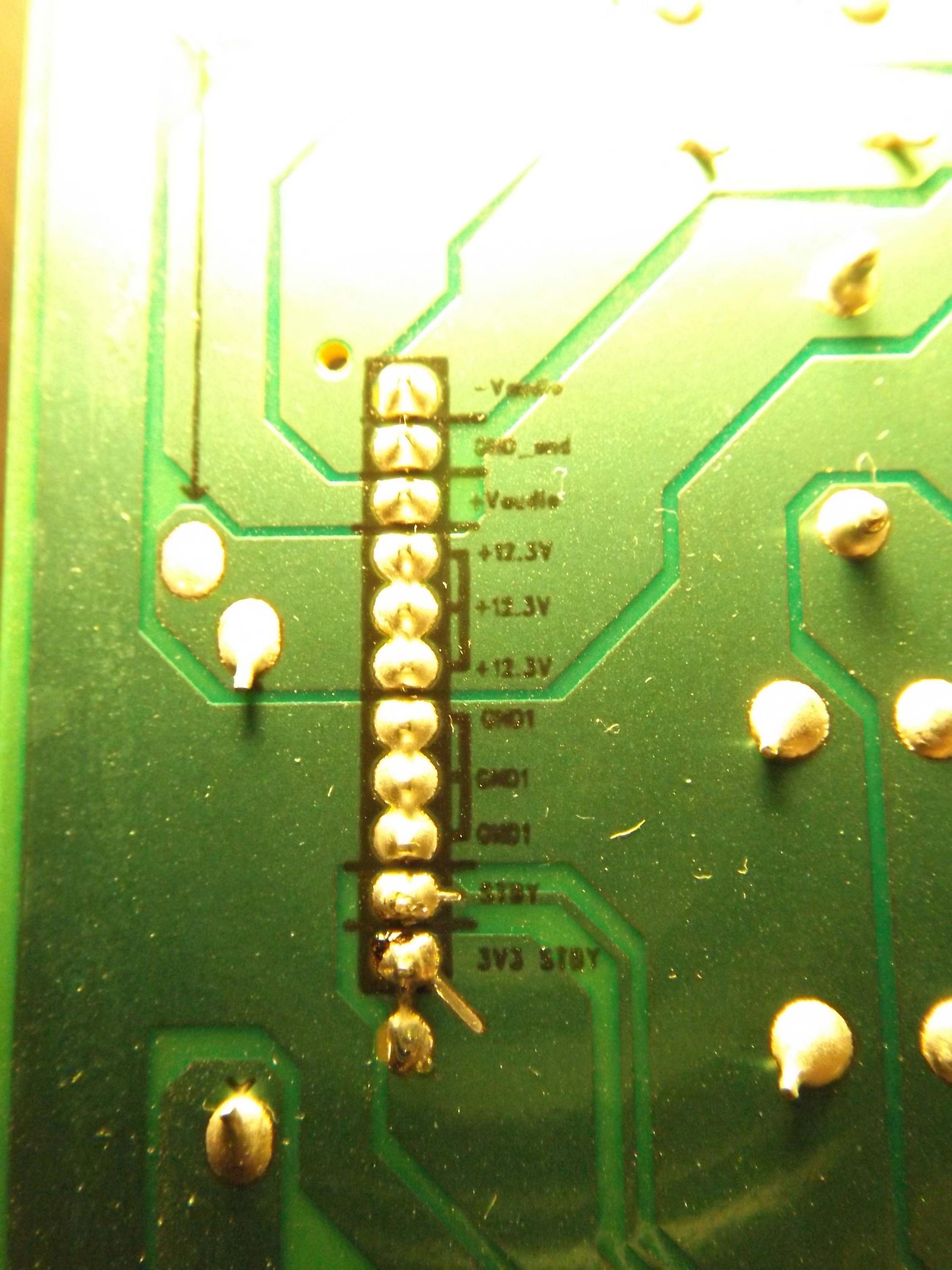

        This would tell me if it was bad psu or back light right? I assume that the back lights connectors are the 2 (2 wire ) connectors that run to the LCD pannle from the PSU.
        The connector on the PSU have 3 pin But the Connectors only use 2. See photo.

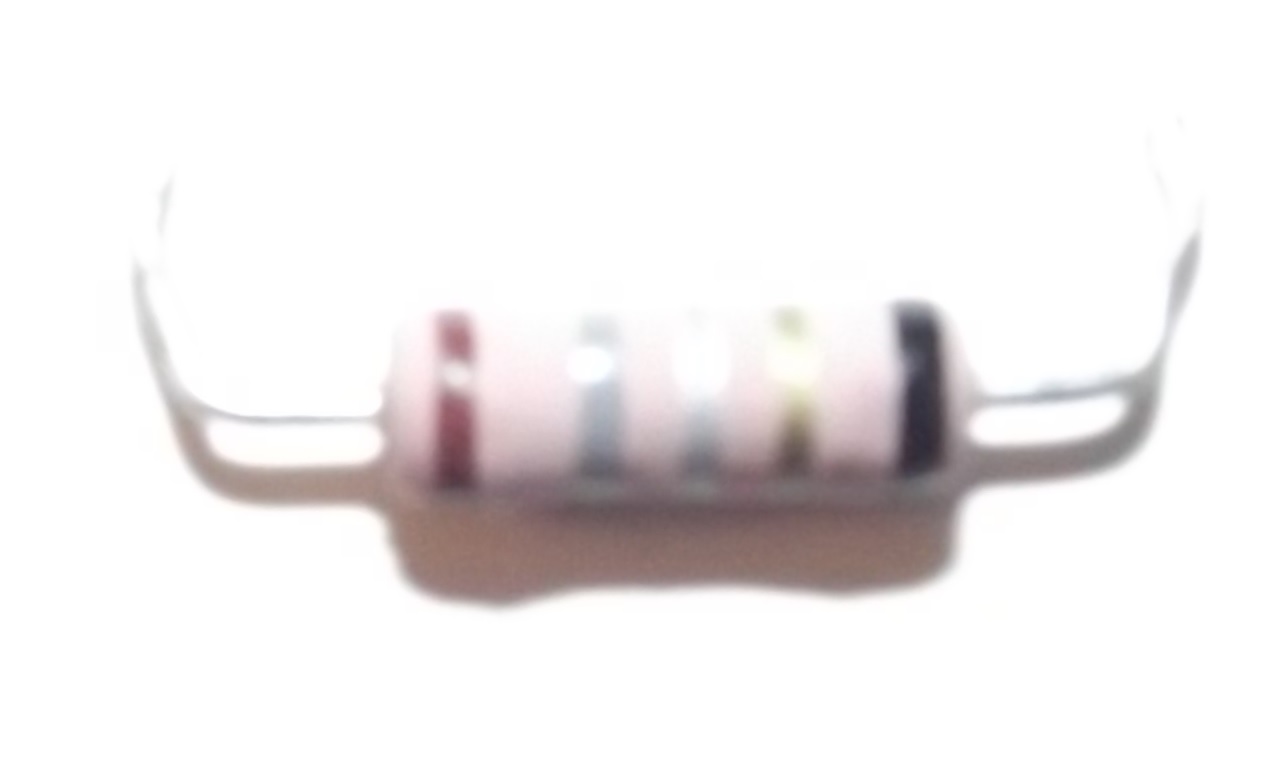

        TO any one: The resistor with the spot on it, that might be bad, that i dont know how to read. Its is located between heat sink 2 and 3. I labeled them at some point.
          Try and take a clear photo of it showing its colours and also what you meter reads when you measure it.

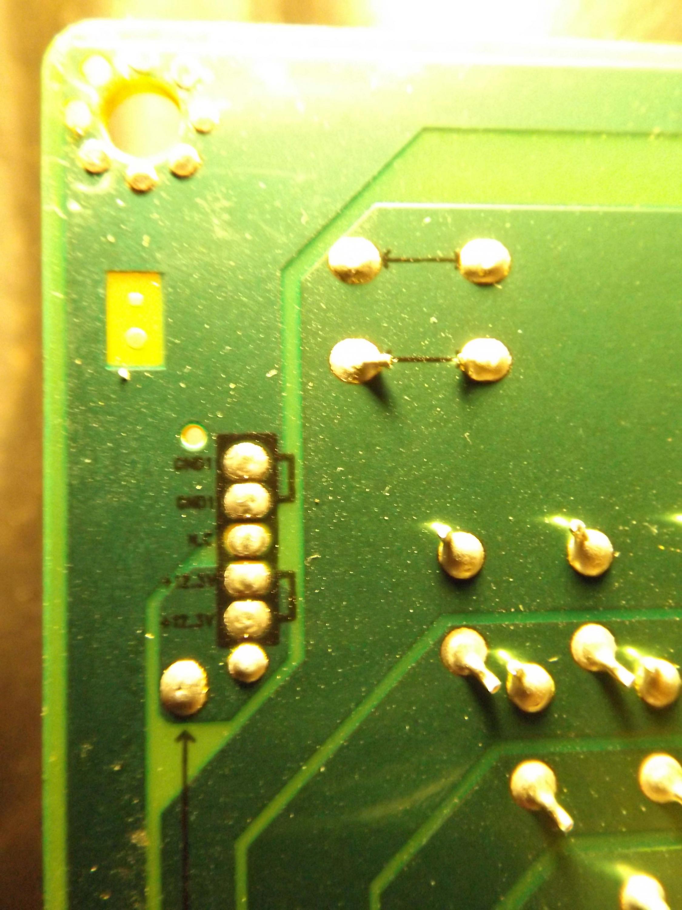

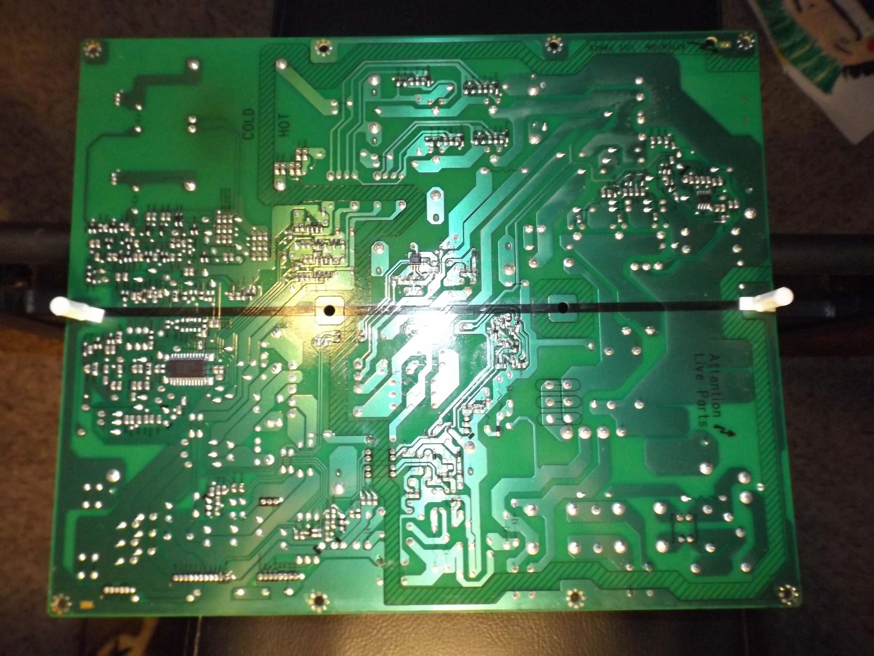

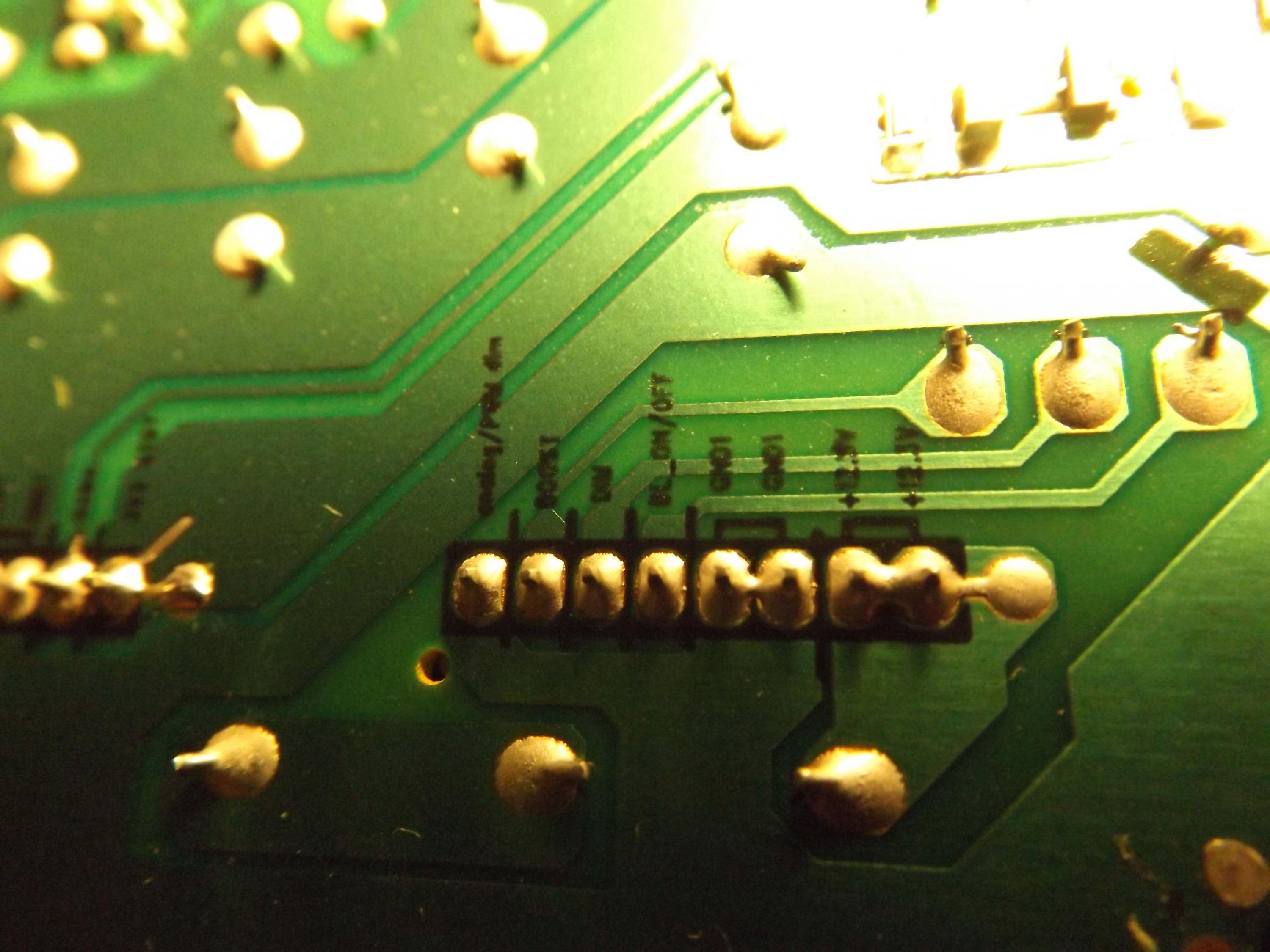

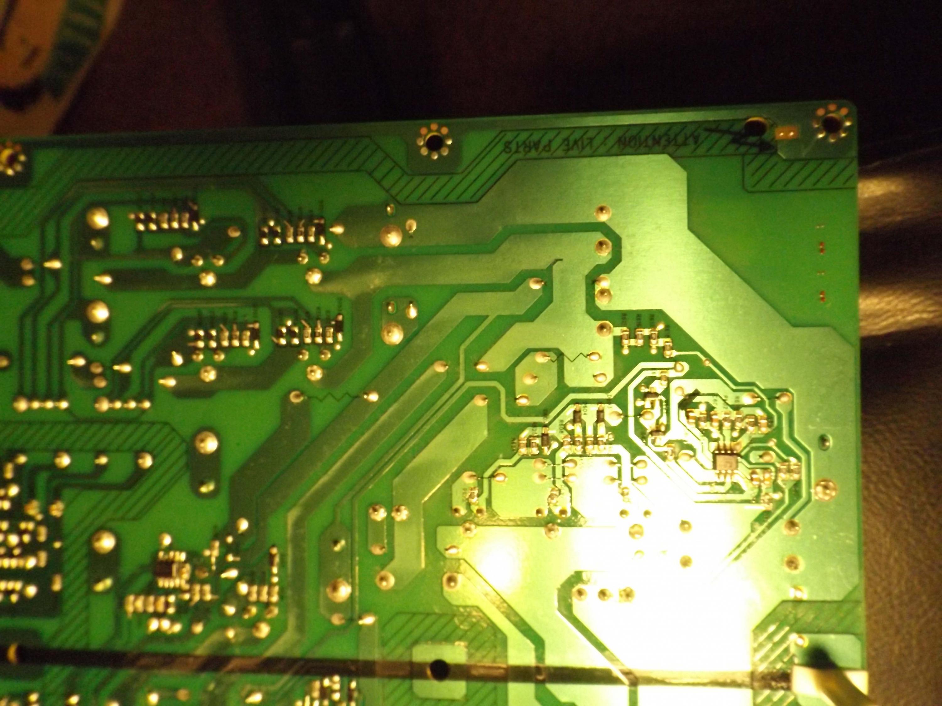

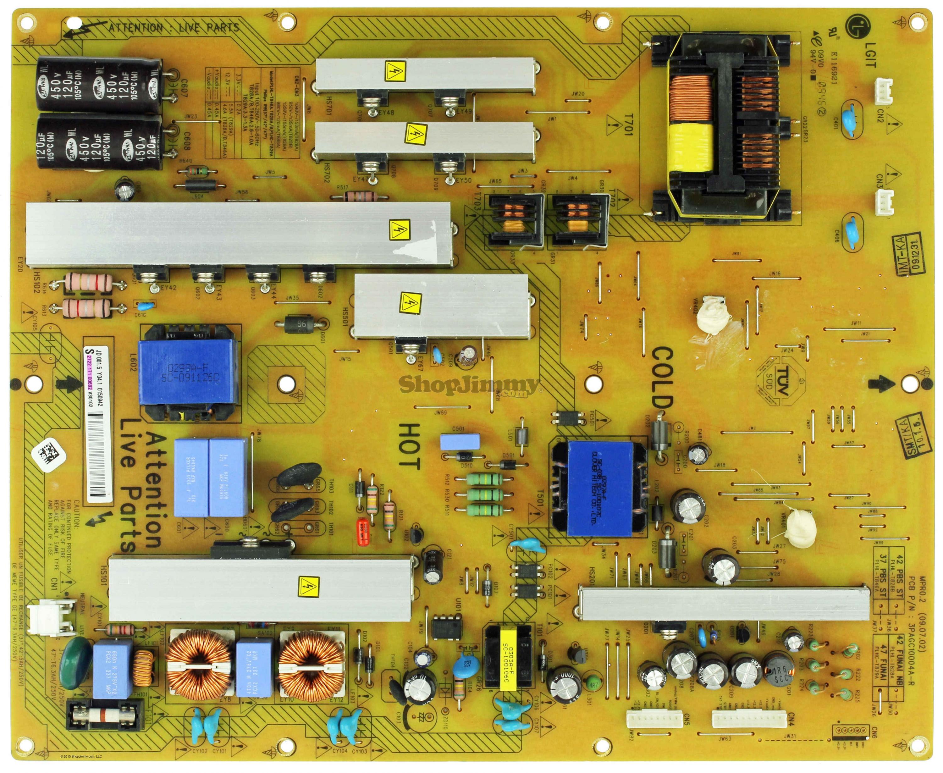

            What DC voltages do you have on DIM & BL_ON/OFF (pic5, Post #2) when you power up out of standby.
              5 band resistor brown blue blue gold black
              I will remove it after i use the dmm on the psu to get the volts you want. Then I will use the DMM on it.
              I posted a better photo of it in the first post, i Added the one on the 2nd as it shows the spot better.

              • cwolford
                • Mar 2017
                • 46
                Dim volt readings:
                power on ~3.3v then jumps to ~14v Then settles at ~1.68v
                BL_ON/OFF power on:
                it spikes some times But always settles at ~3.17v
                Power on 3 times. The spike is like less than second.
                1st time ~5v
                2nd time no spike just ~3v
                3rd time ~10v
                So if i ground Bl_ON/Off The side of the tv light up but dont kick on. IT was an accident
                • CapLeaker
                  Leaking Member
                  • Dec 2014
                  • 8352
                  If you get BLon at 10V DC, there is something totally wrong, because you only have 5V STBY. So either there is a measurement error or your batteries in your DMM are low.
                  The BLon comes from the main board. Shorting that to ground is not good at all. That's another way of kissing the main board good bye.

                    • cwolford
                      • Mar 2017
                      • 46
                      the resistor i don't know the value of measured 0.29 ohms
                      or red grey grey gold black
                      The two in the middle look shine not sure if blue are grey. Too the eye they look the same color. In photo they look different.
                      the first one could be red or brown not sure.
                      I dont know what to do about the black at the end tho.
                        You reading the resistance of the meter leads + the resistance of the resistor, it looks like 0.18 Ohms resistor, so it is OK.

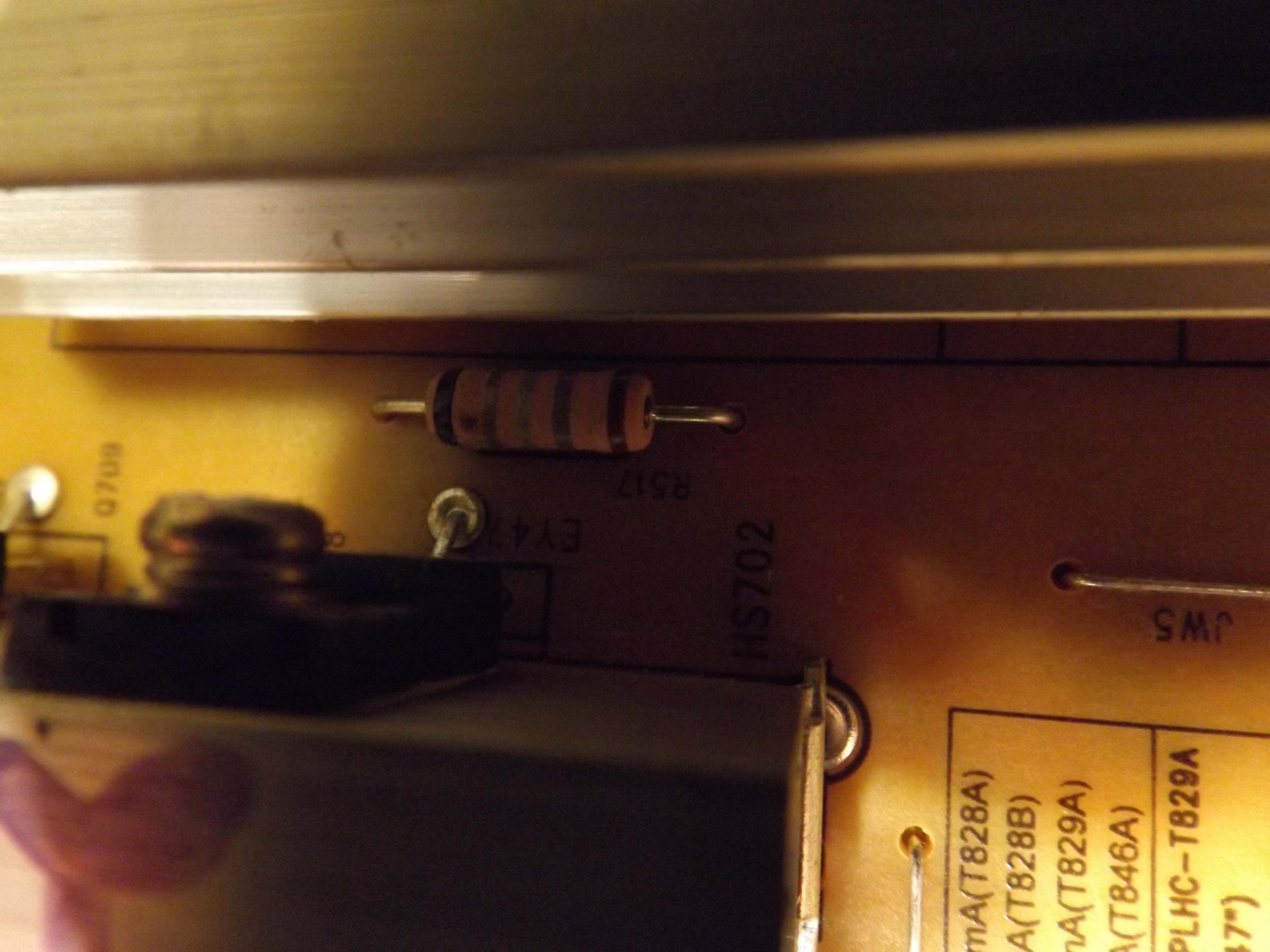

                          That R517 is the Source resistor for the power MOSFET Q501 which drives the power transformer T501 for the 12V and +VAMP power supply. So if you do have +12VDC at the connector then that power supply section is working.

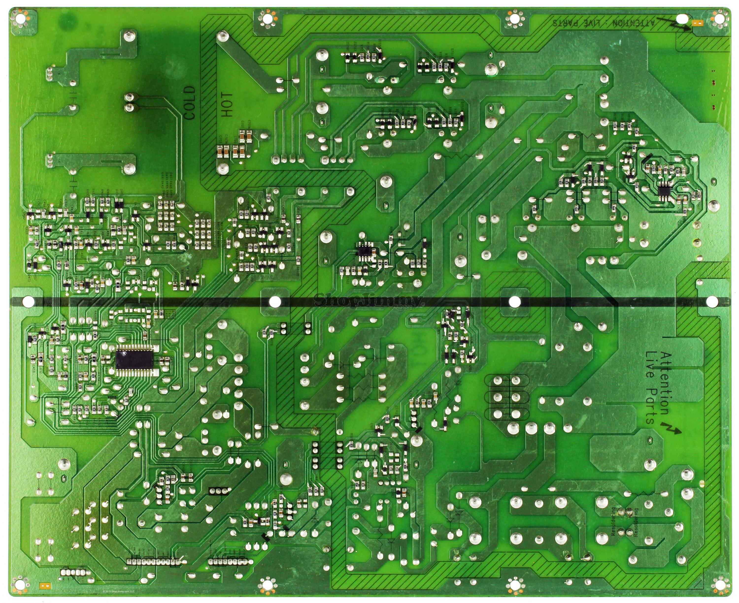

                          This looks like your power supply:
                          Philips 272217100692 Power Supply / Backlight Inverter
                          http://www.shopjimmy.com/catalogsear.../?q=47pfl5704d
                          Pictures provided by shopjimmy.
                          So if you look at the TV in the dark, do you see the backlights even flash on for seconds?

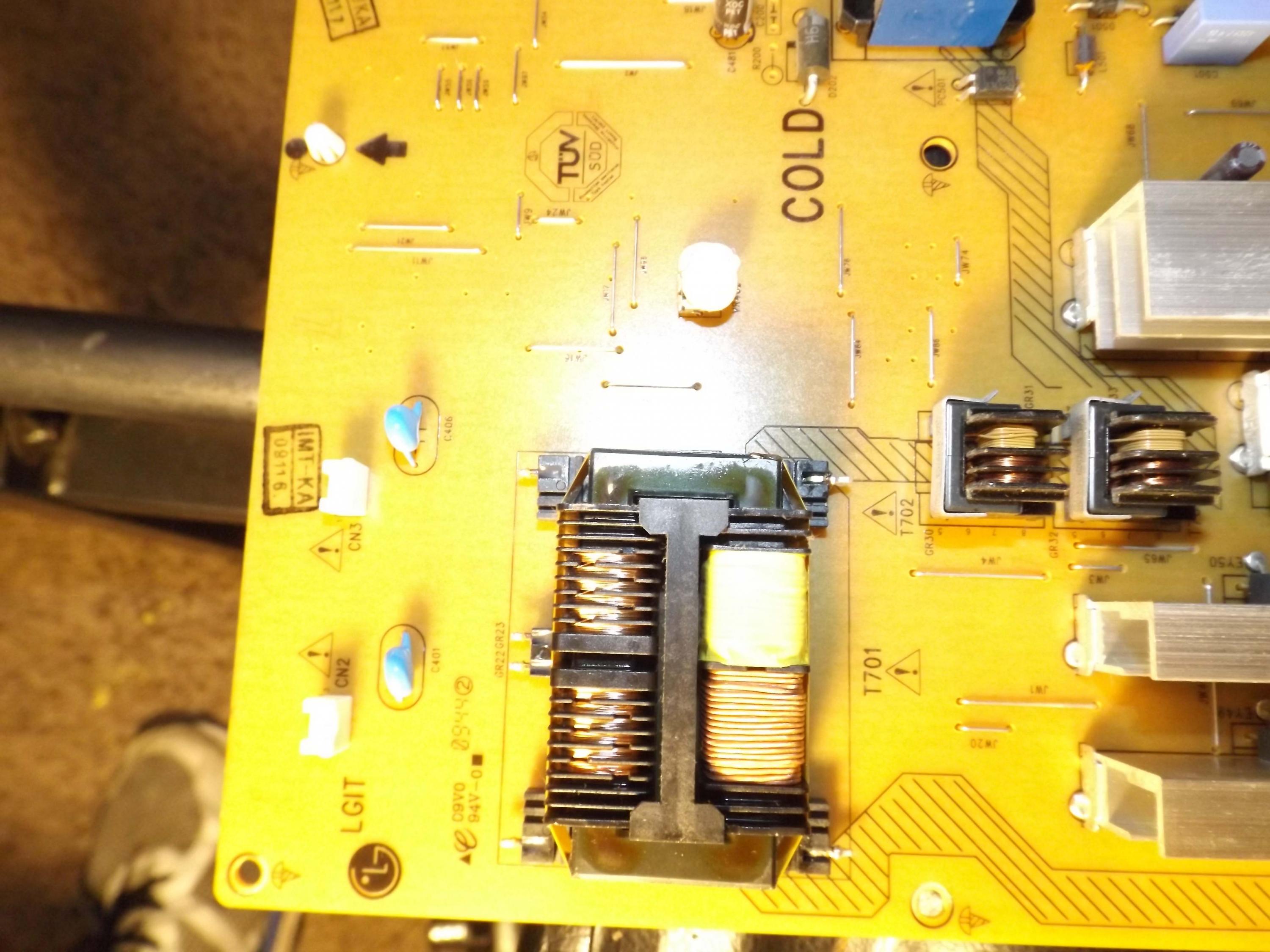

                              Is there any sign of over heated inverter transformer T701? Look real close on top and bottom side of the board where the inverter transformer is.

                                  I don't know what to look for in the transformer but it does not look melted or discolored.
