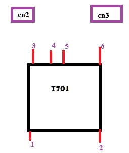

    using retiredcaps tuts i'm doing some measurements. Here is T701 backlight
    here is the print on it:
    2130kp029c-f
    gl 47 fhd
    ny091106b
    here is the measurements
    1 to 2= 1.04 ohms
    1 to 3, 4, 5, 6= 0L seems to not measure at all
    2 to 3, 4, 5, 6= 0L seems to not measure at all
    3 to 4=23.94 ohms
    3 to 5=67.95 ohms
    3 to 6=91.89 ohms
    4 to 5=44.1 ohms
    4 to 6=68.05 ohms
    5 to 6=24.05 ohms

      Re: Phihips 47pfl5704d / f7 Back light not working
      Like i said I dont know a lot, but Seems I have a bad MOSFET.
      KHB 5D0N50f
      all of them Q706-q709 have same readings but q706
      q706
      1 to 2= 14.92 ohms
      1 to 3= 2.109k ohms
      2 to 3= 2.116k ohms
      q707, q708, q709
      1 to 2 = .3190k ohms
      1 to 3 = cant get a lock DMM is seeking down from 20M ohms
      2 to 3 =Cant get a lock DMM is seeking down from 15M ohms
      Since this are the same somebody is bad. the question is who, then why.

        if the drain / source is shorted to the gate, then you have to look at the whole gate drive circuit too. Take the Mosfet out and check it again out of circuit.

              I removed q706 and q707 with the heat sink as I could not remove screws at that angle. Q706 same measurements. Q707 all I got was 0L on all measurements.
              I know how to solder I was in and out quick NP all went easy, I don't think I killed it. What gives

                        so i'm not even %50 sure, but based on what i have come to understand from chatting here and the spec sheets.
                        The circuit applys voltage to the gate of the mosfet to control it
                        That voltage should be 10v, but no more than 30v right?
                        Next
                        The source should be ground and then the drain seems to be the voltage from the 450v caps.
                        So I should be able to test to make sure there is ground at the source, 10-30v at the gate, and cap voltage of at the drain?
                        It seems it seems the mosfets control the current as compared to hooking the transformer up straight to the caps right?

                          seems i did not kill that MosFet the holes in the the pcb have the measurements with our with out the Mosfet.
                          Seems that mosfet is bad to seeing its all 0L yea? If anyone know of anything else i should check because of the bad mosfet plz let me know.

                                  thanks all, got the time to do it.
                                  $6 in MosFet. fixed it. IT boots up, back light flickers, but then after warm up is fine.
                                  been working 3 months.
