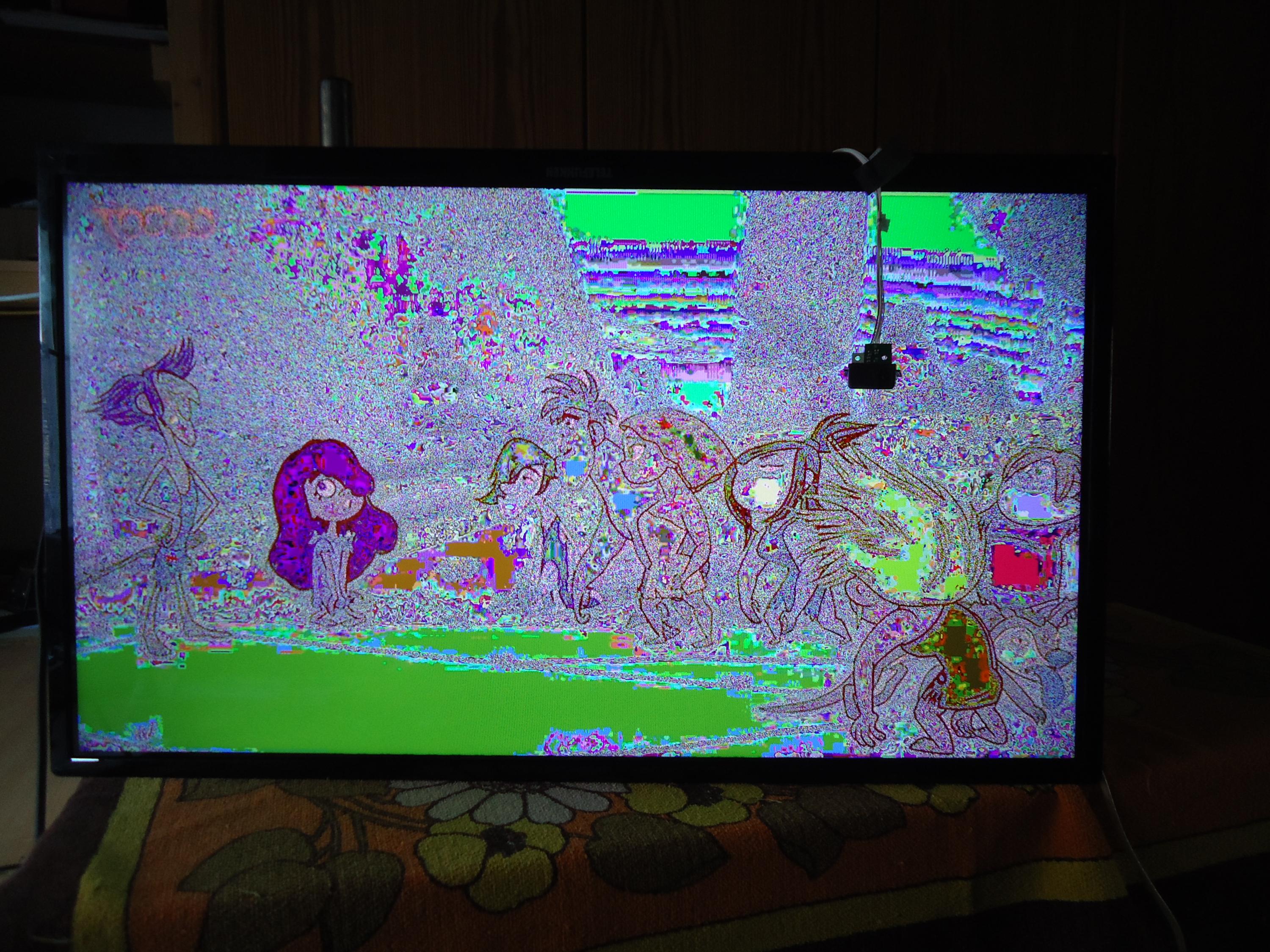

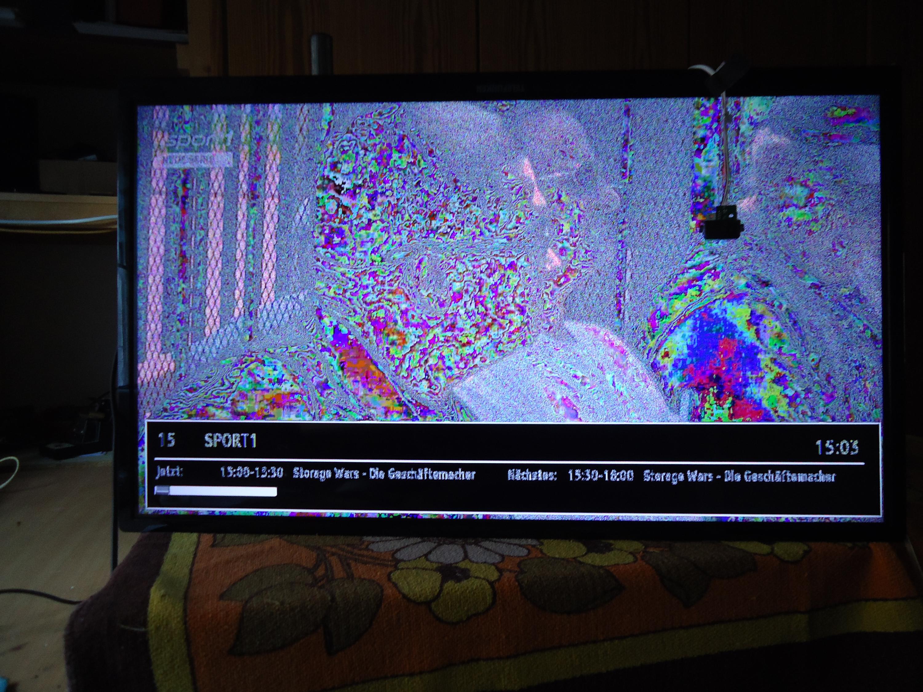

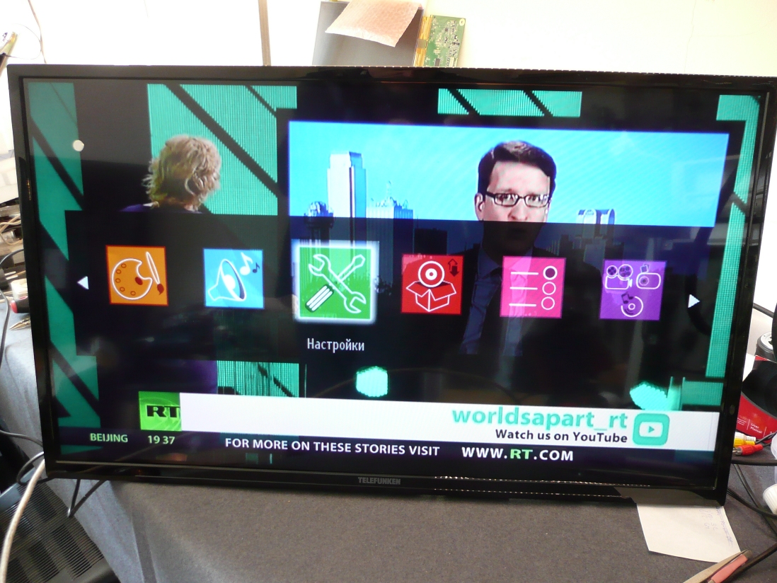

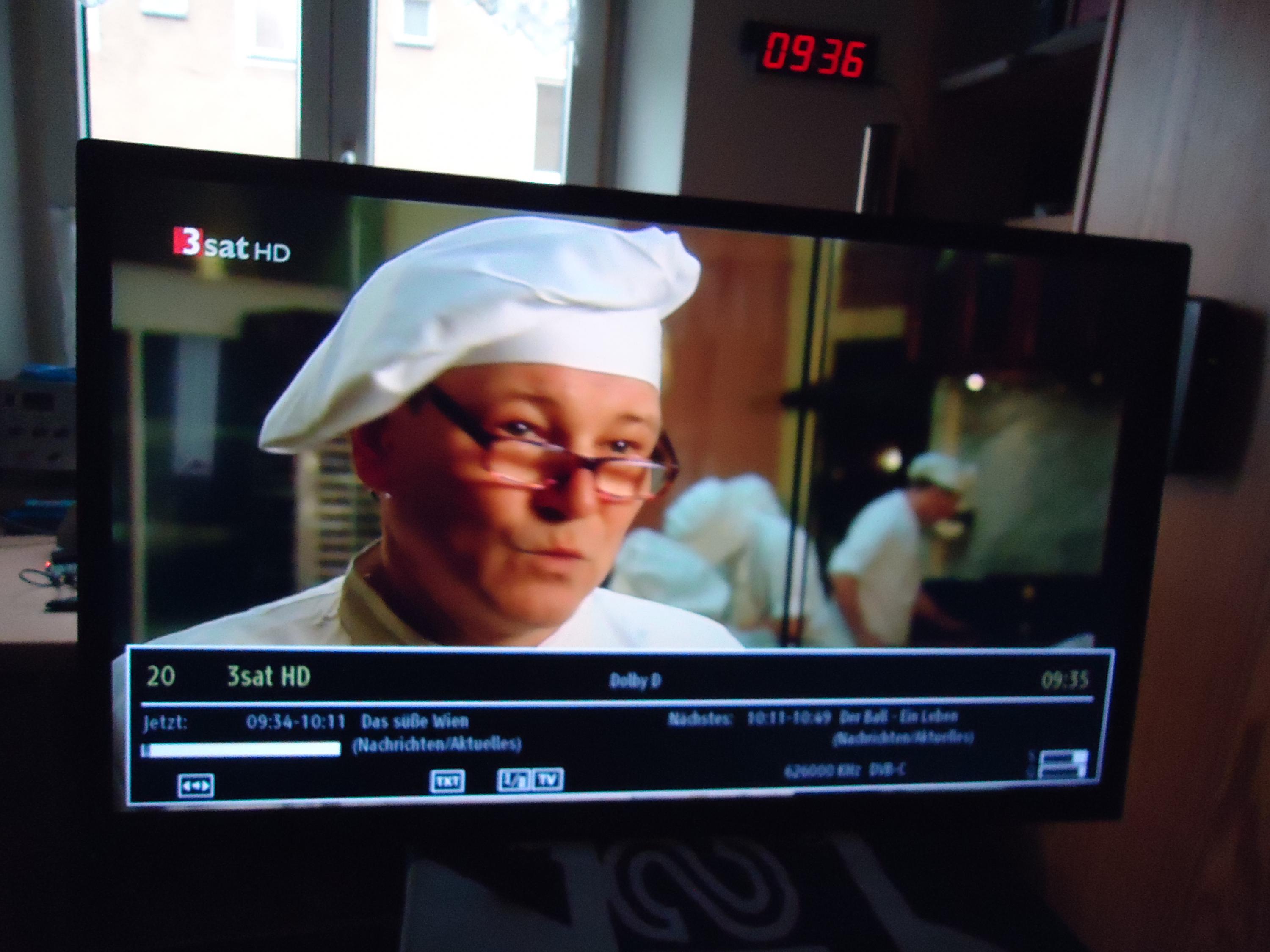

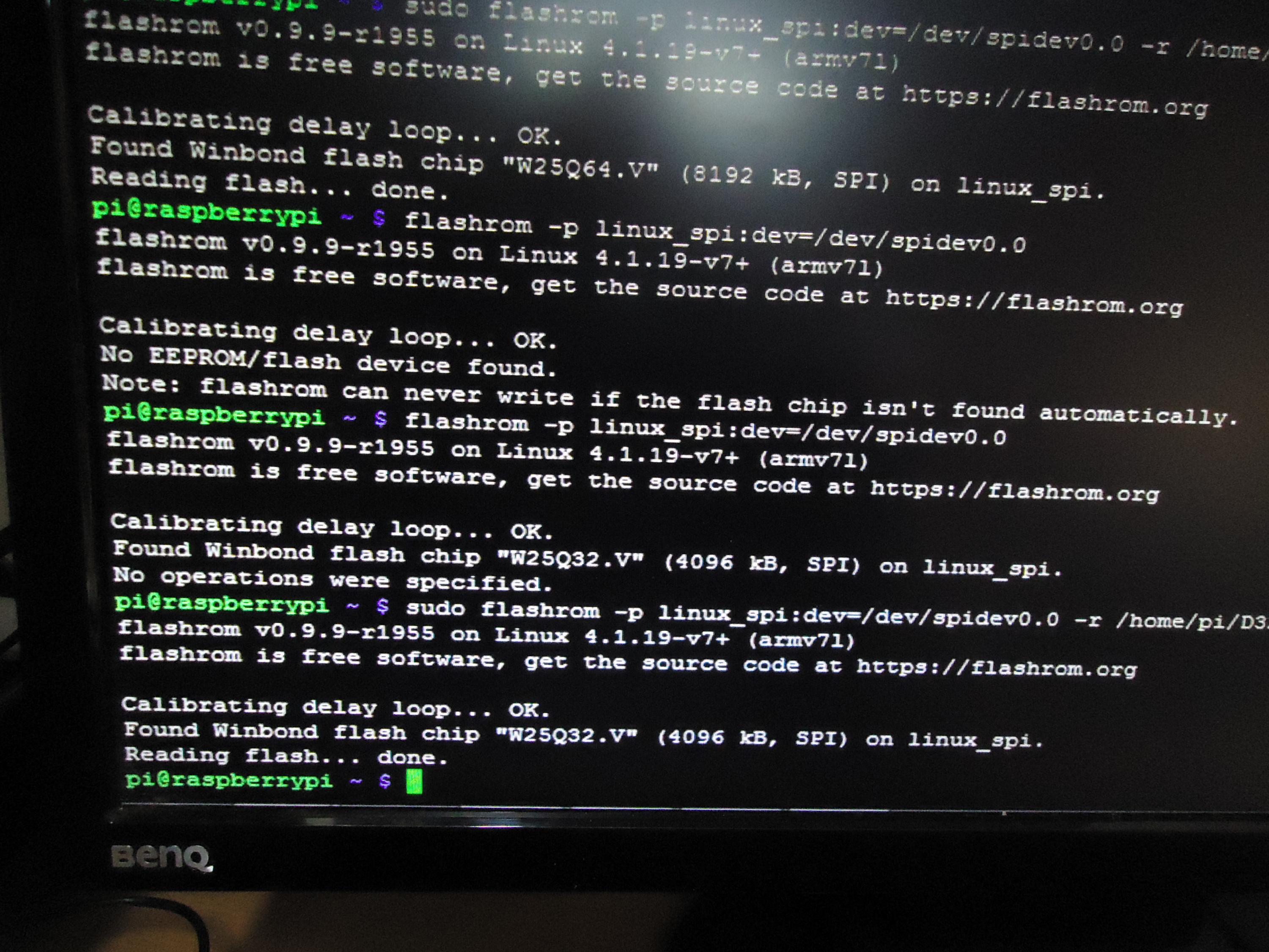

    i am new in this Forum.I am from Germany.My Problem:
    I have an Telefunken LED TV Model: D32H278R3
    The Motherboard Vester 17MB82 is broken.
    I buy on Ebay an other Board from an Telefunken D32H278A3.
    Now the Picture ist standing on the Head and the Picture ist very Bad.

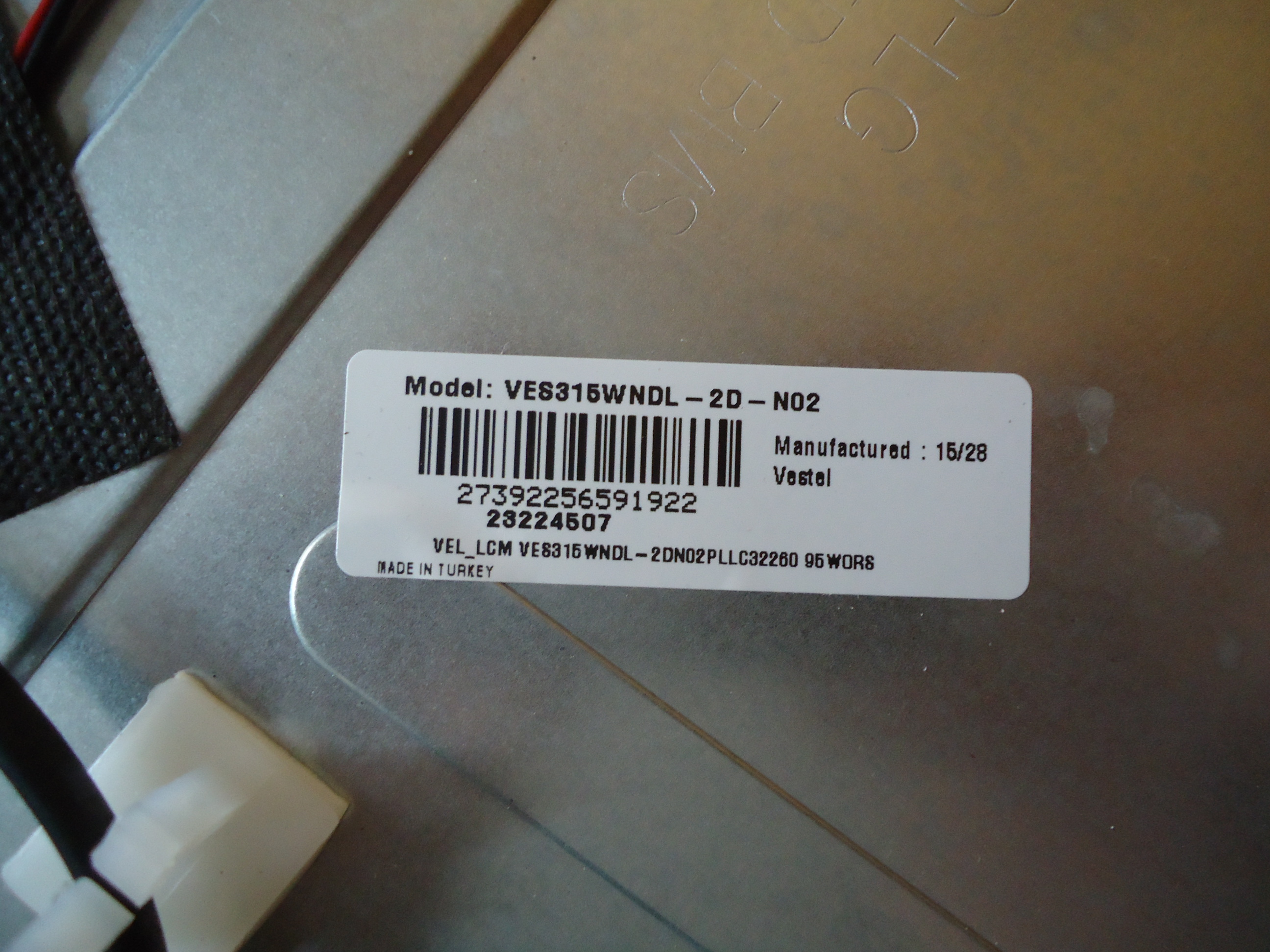

    Motherboard: 17MB82S
    Power Supply:17IPS71
    Panel:VES315WNDL-2D-N02
    Here some Picture from the TV.

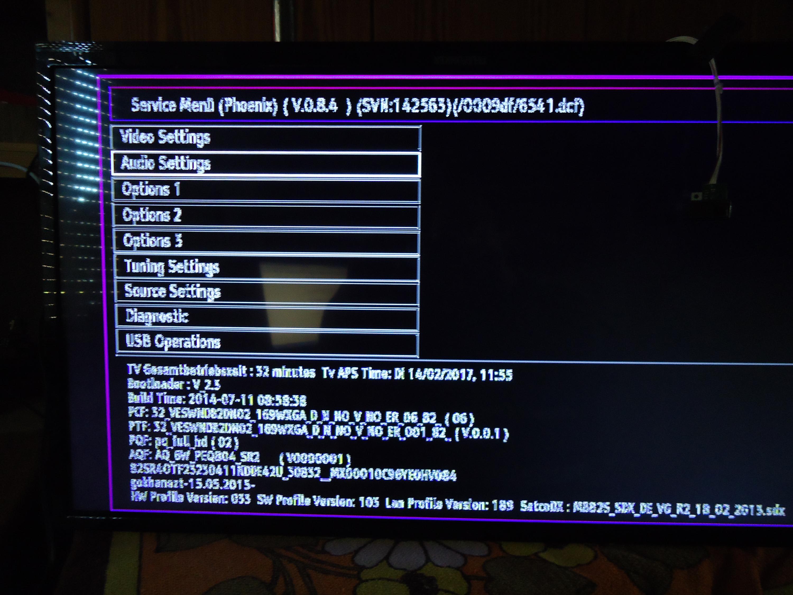

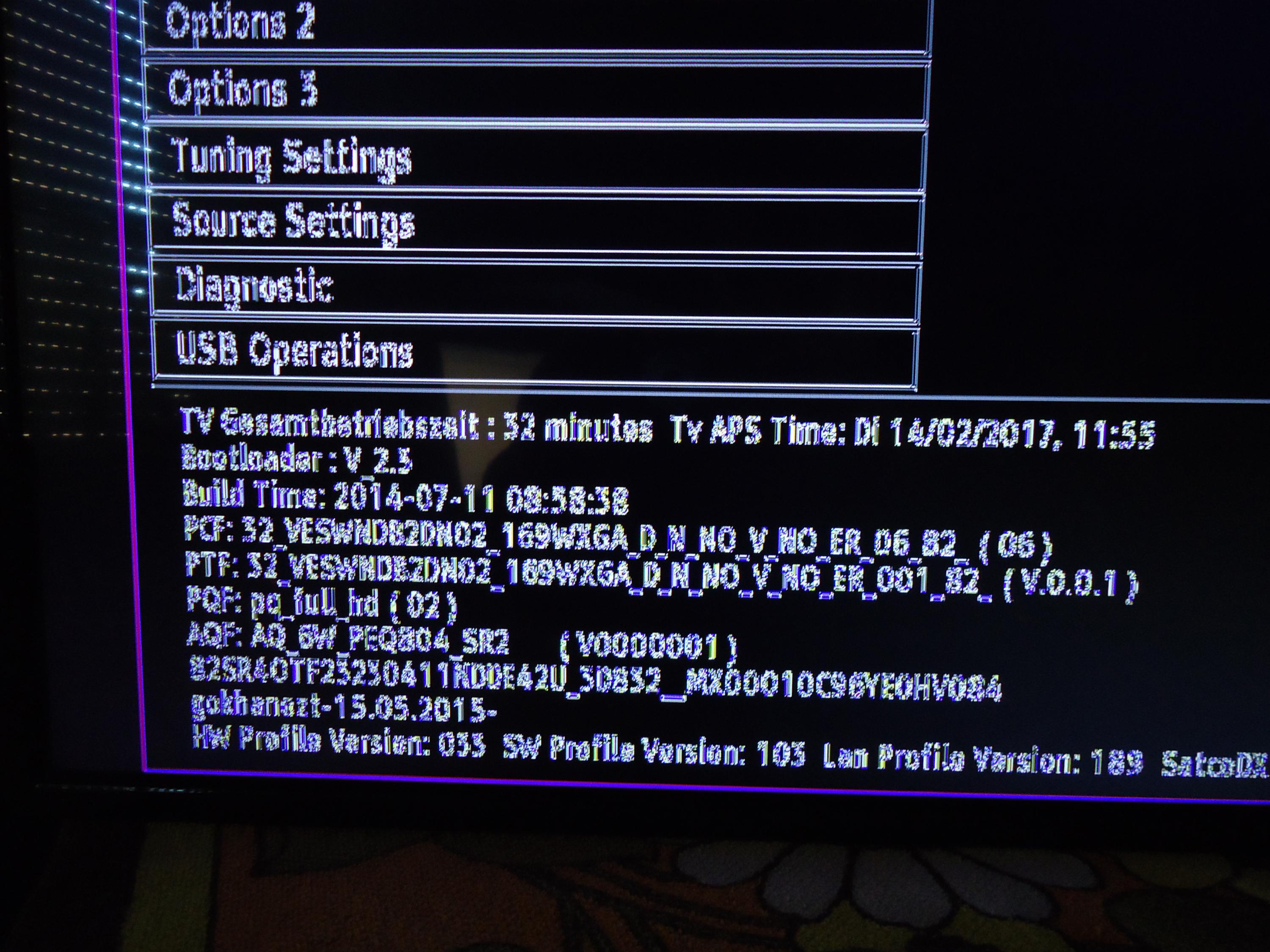

    Ok,it is not the right T-CON Board.Does the right T-CON board work with the VES315WNDL-2D-N02 panel?

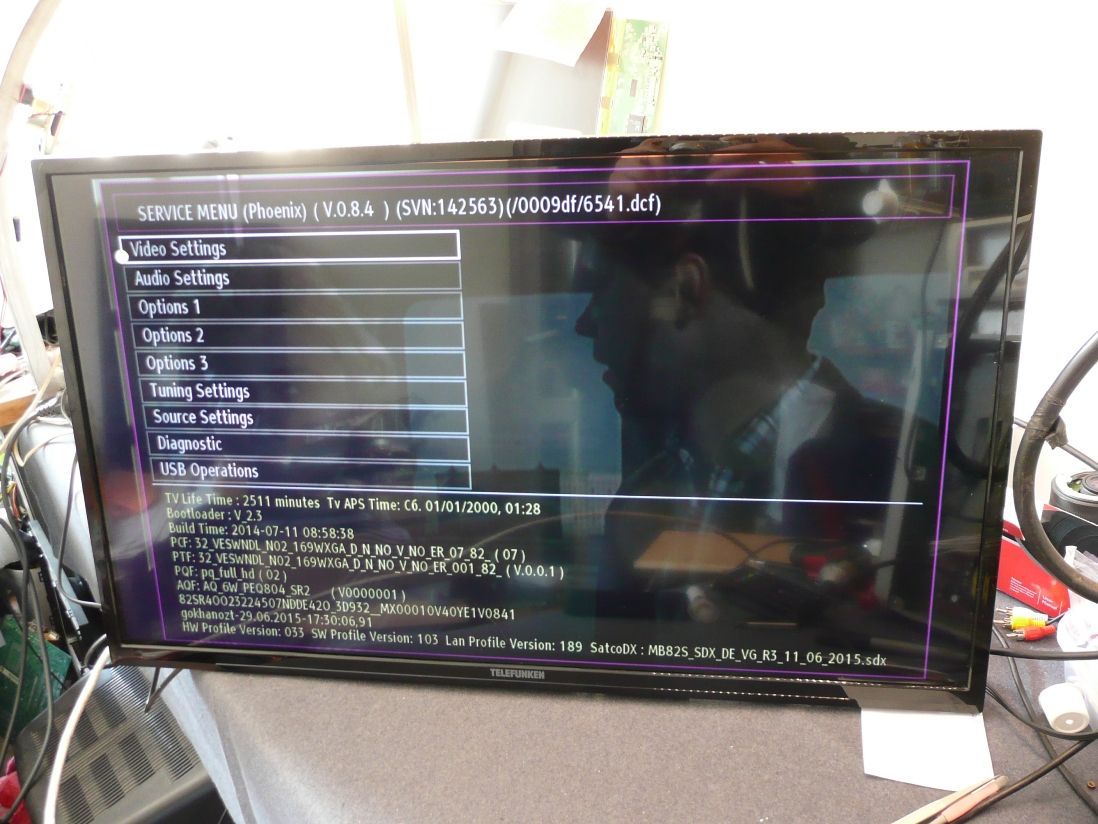

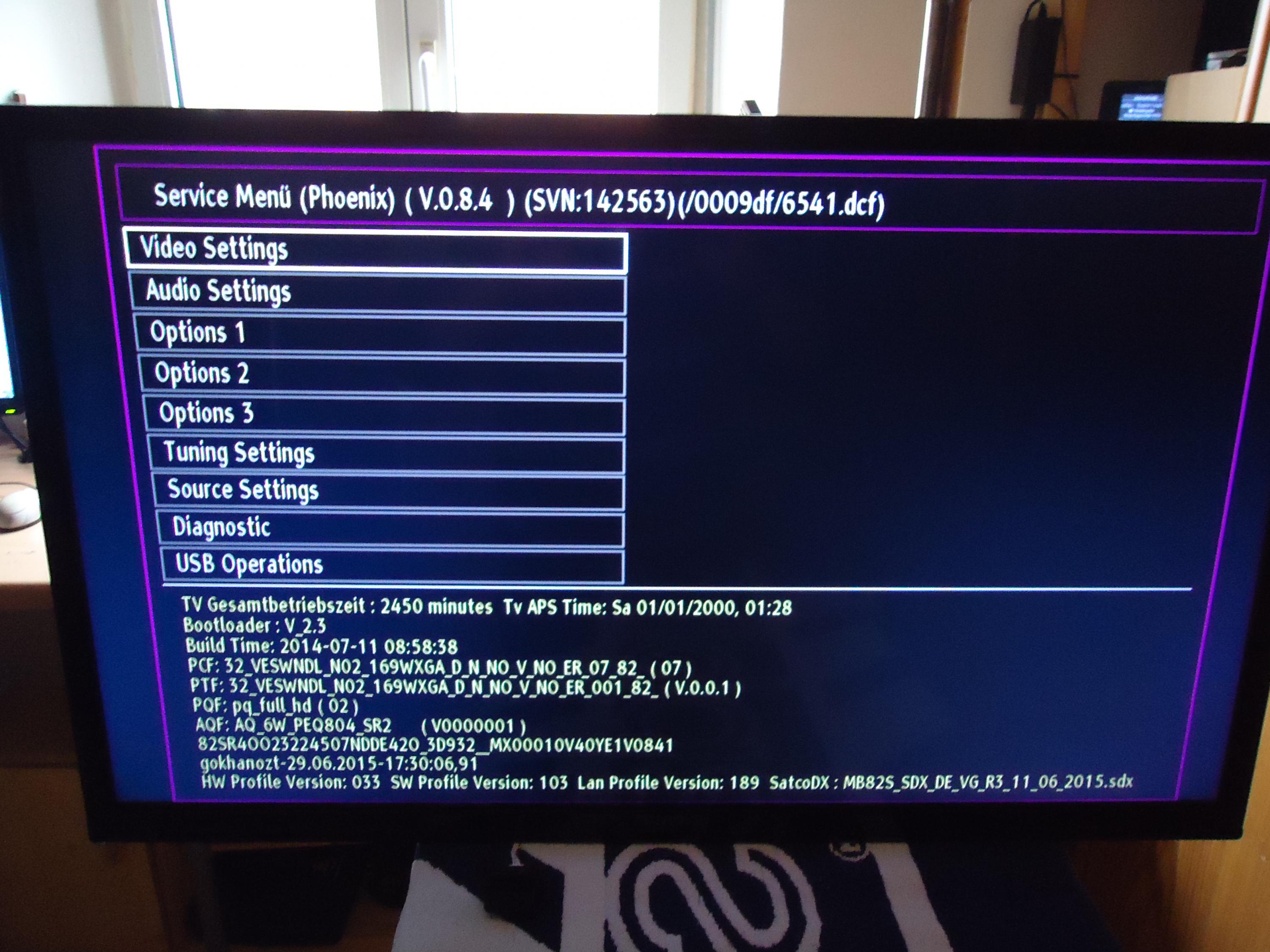

    In the service menu one can make some settings but panel does not select. A little at the color and sound.
    An update via USB does not go.USB Stick is detected. File does not go (08_nolu_yazilim_V.084/upgrade_loader.pkg)
    Wong Software?
    A USB log I could make(USB trace.log).
    Or I sell everything back on Ebay.
    I do not know what's wrong with the old board.

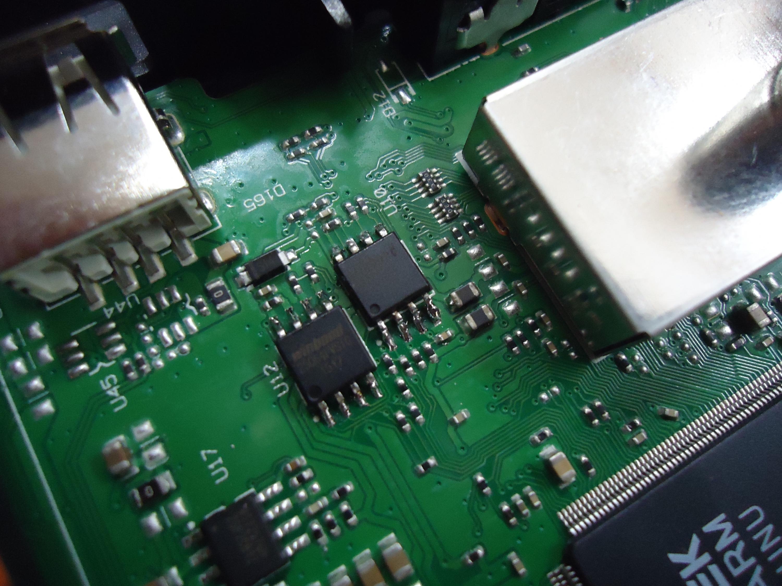

    CPU? RAM? Flash?
    Is the Software in the Winbond Chips ?
    Can i flash the Winbond Chips ?
    What can i do?
    Who can help me,please ?
    Greetings from Germany
    Martin

    Re: Need Help:Telefunken D32H278A3 / 17MB82S
    As I said there is no way to recover the FW off these boards and write it to use for the panel as its shared between 2 Ics and the nand. Nothing I can can do unless anyone has the dump saved.
        i would put the original tcon board back into the tv and get a replacement mainboard from ebay etc that matches your panel in your tv you can always sell on the wrong boards as you know they work ok.

            Please send me dump U10/U12 (winbond). May be I help you...

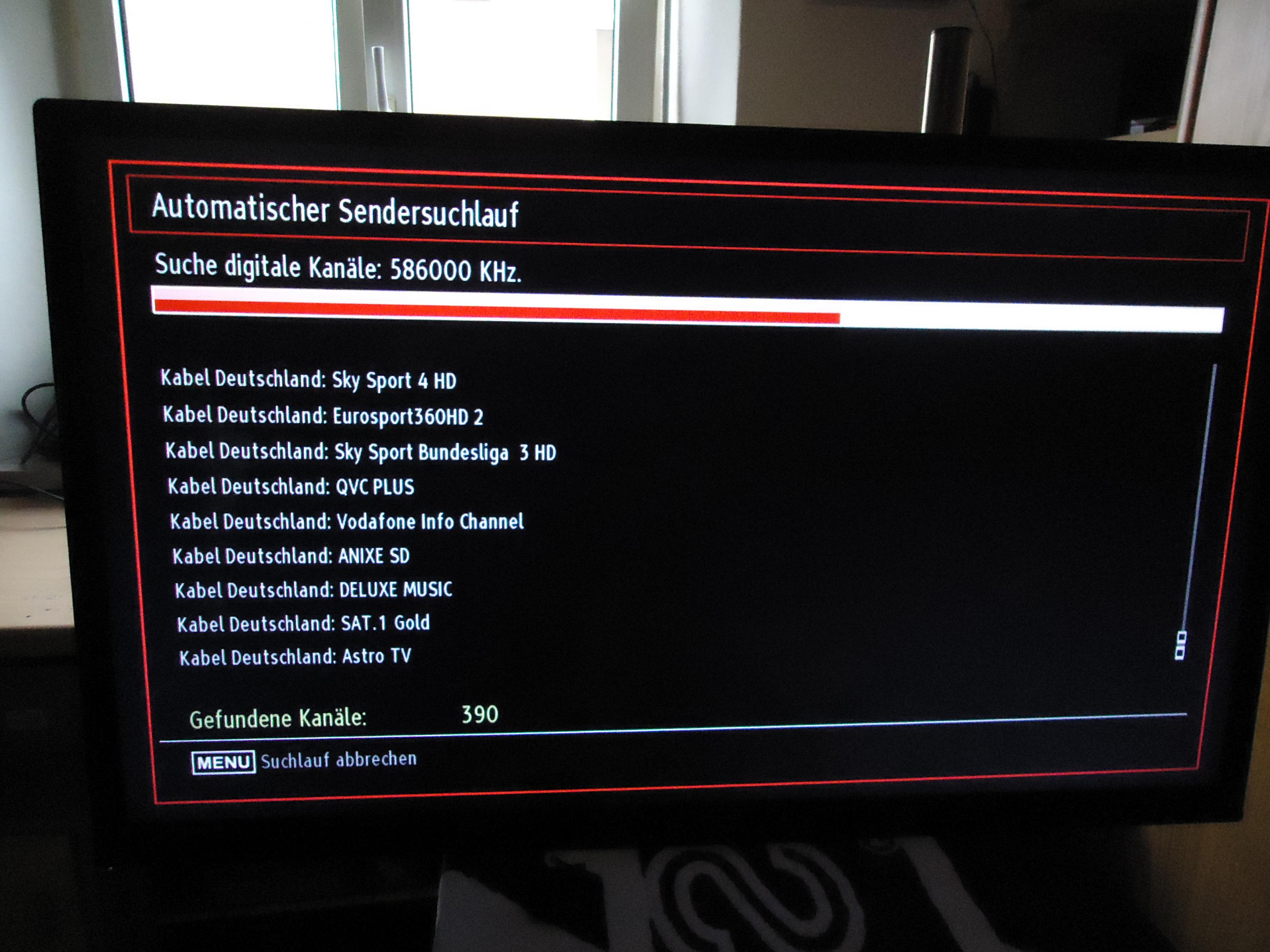

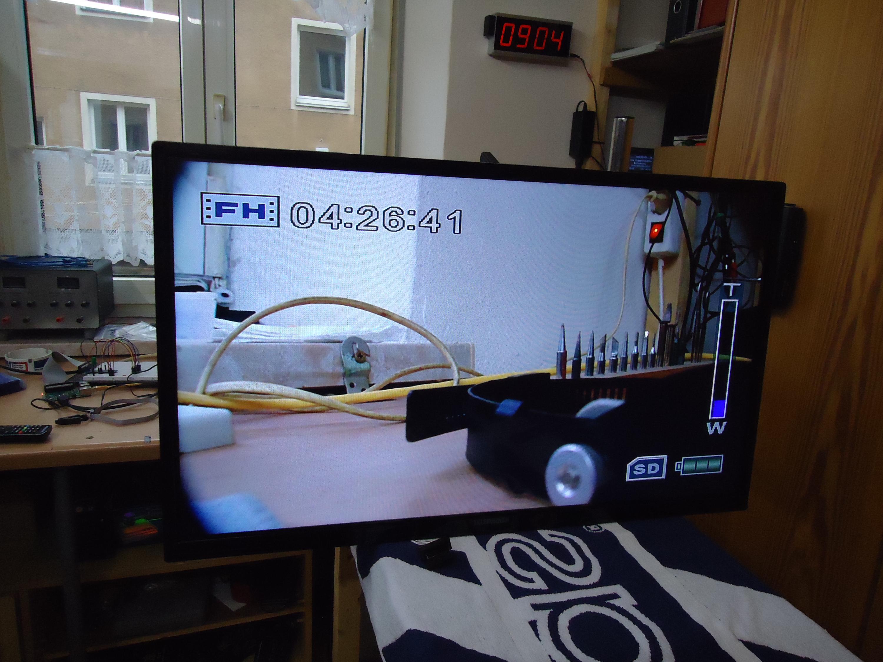

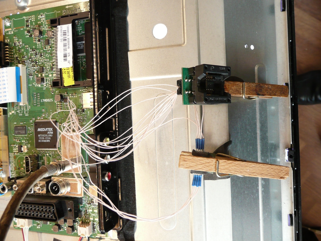

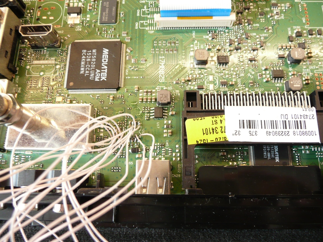

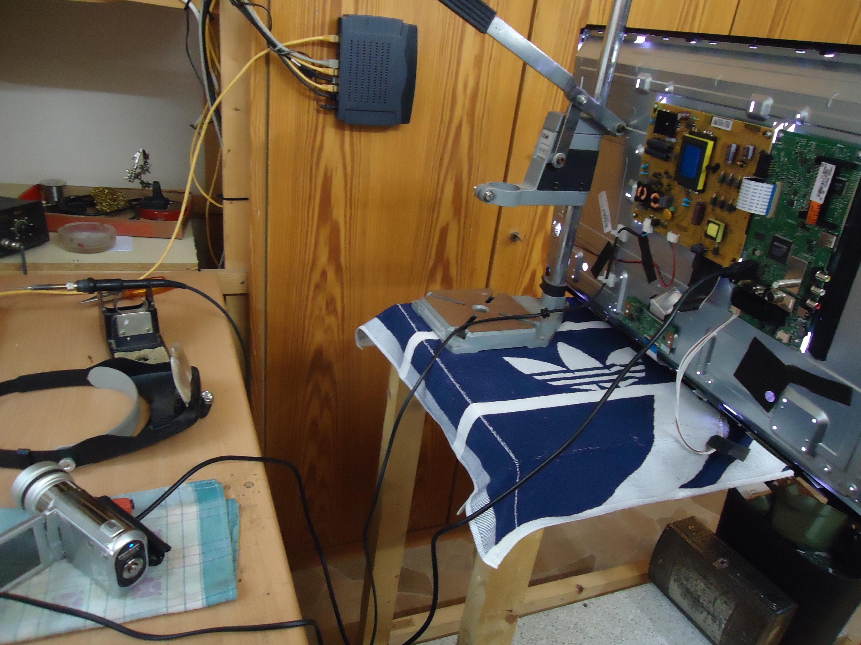

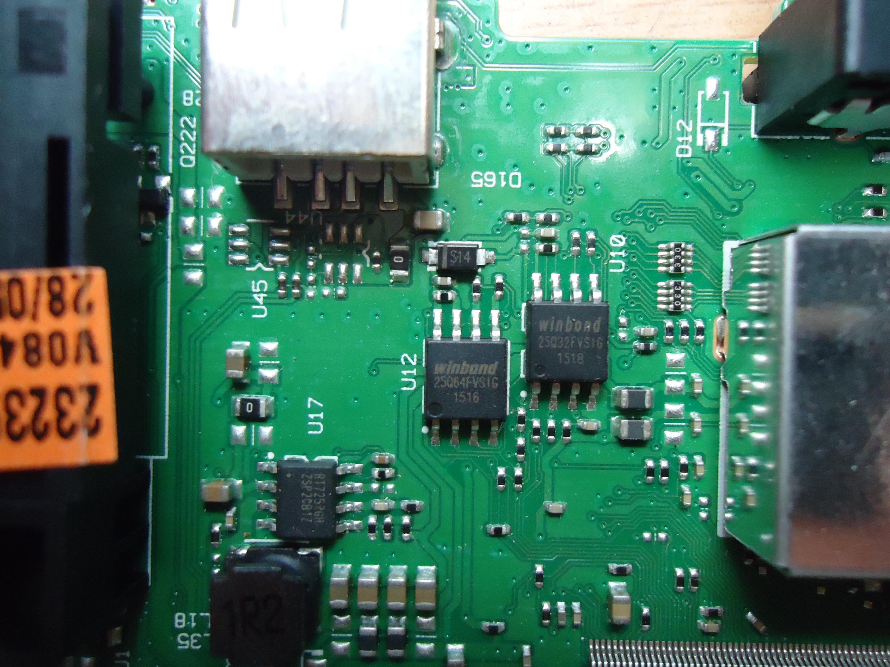

                Hooray ,
                my TV works again.I solder the old(from D32H278R3) Winbond Chips to the other Board(R32H278A3).Before I soldered I created a dump from the Chips.With Raspberry and Flashron Software.I have wrote new Winbonds and solder it but it works not.I think the CPU from the old Board is dead.Or not?I wrote the new Chips with Images/Dumps from a Polish Board.The Size was correct.
                When anywone needs my Dumps(D32H278R3 and R32H278A3) can i post it.
                Ok,see you next Time
                Martin

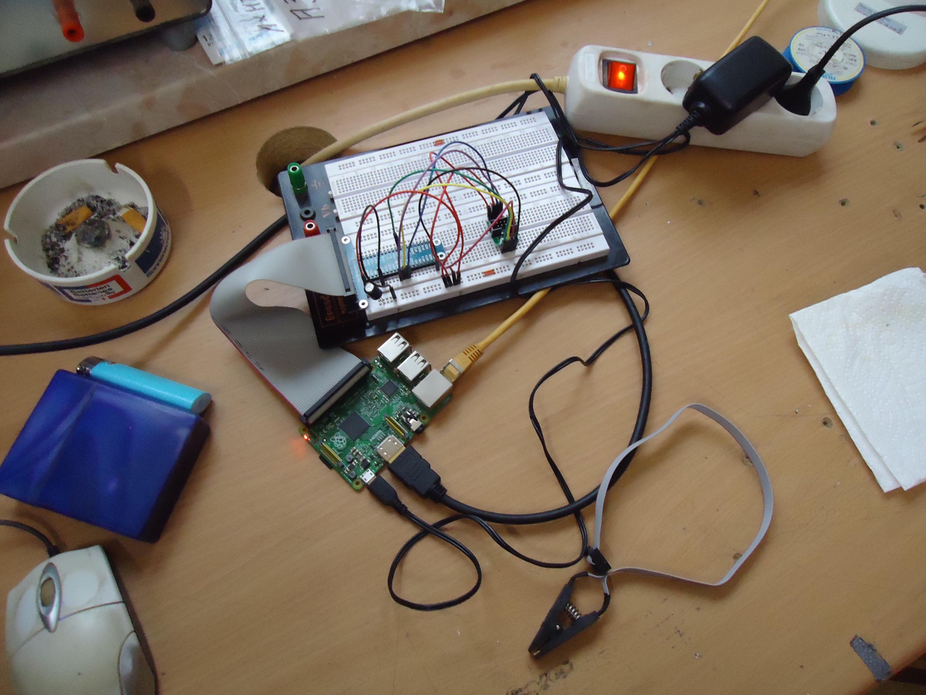

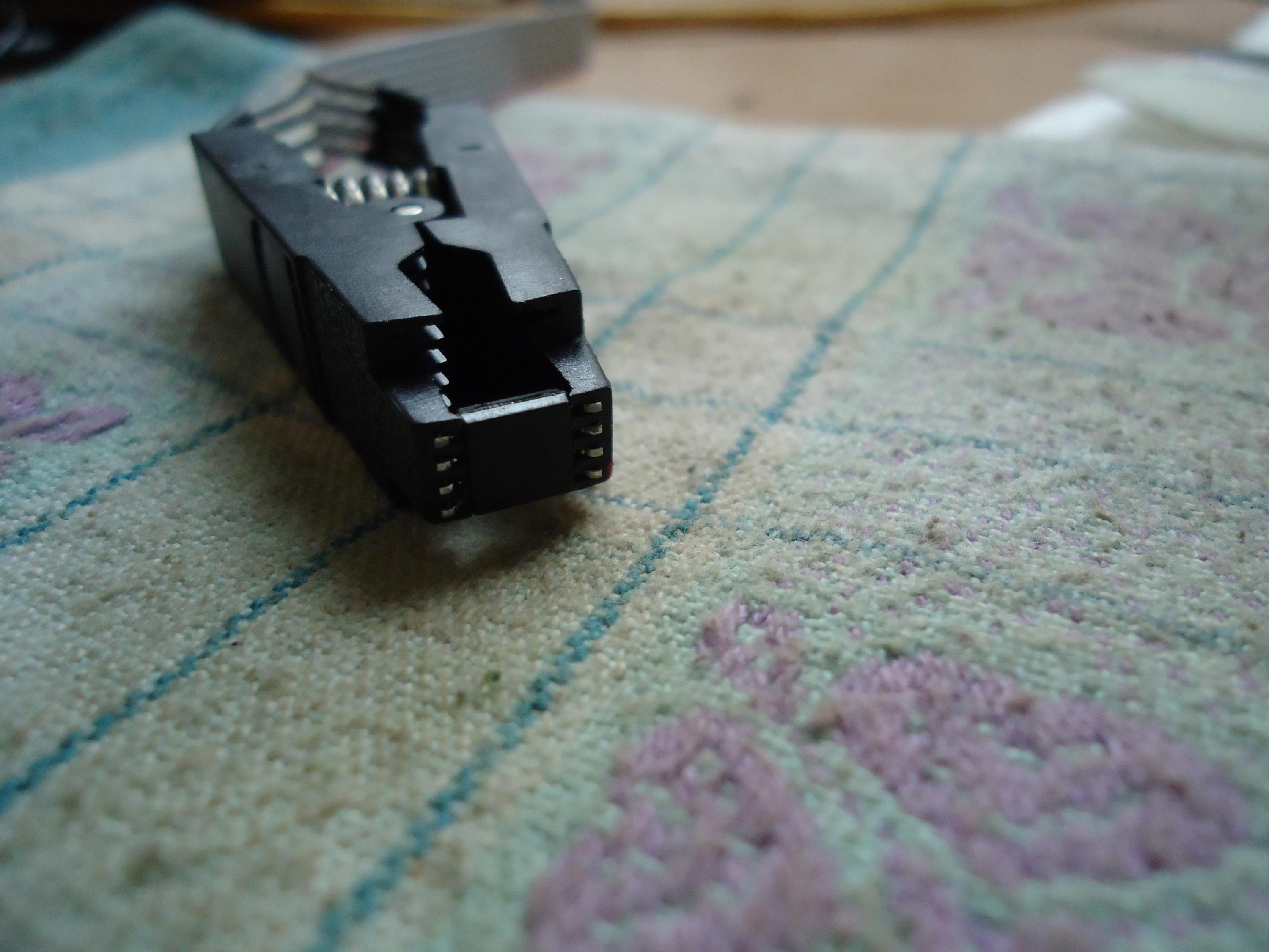

                      Hello, I made the quick a small guide.
                      I hope this help anyone a little bit.
                      CU-Martin
                        CU-Martin
                        Thankyou for taking your time to make that guide im sure it will help members in repairing there sets.

                          Hello Martin. Great job! I must say that you helped to repair my TV Telefunken D32H278KT3 too! My original dumps were damaged. TV works fine with your dumps for D32H278R3! ( With dumps from R32H278A3 video rotated and bad.)
                          Thank you very match!
                          Genady
