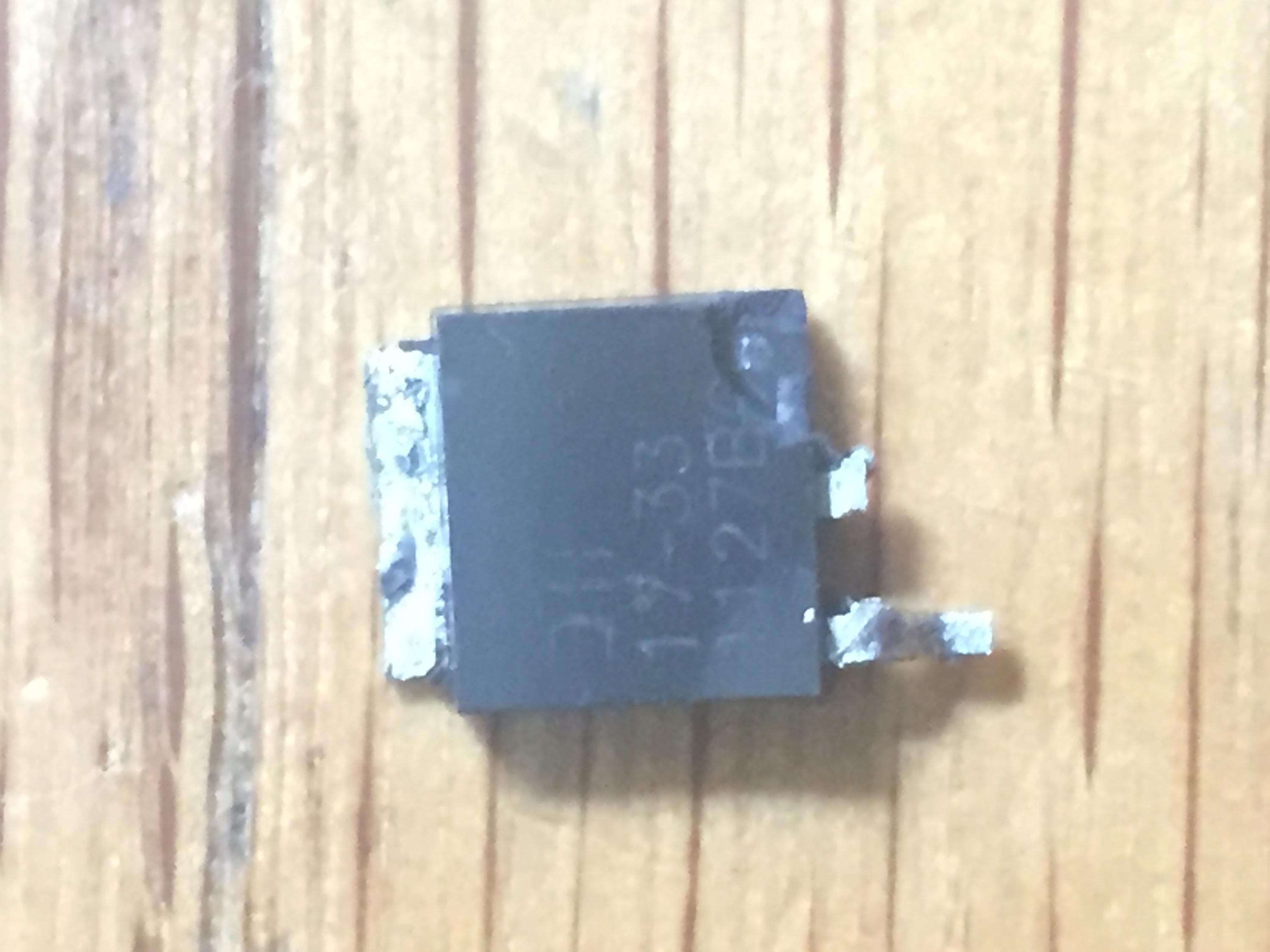

    Also i believe i traced it to a bad voltage regulator but not sure.
    the part says 17-33 1127BG and in dpak form. i removed it and broke a leg. lol\
    The reason I thought it was this was because there was the 5.25V going into pin1 but was getting nothing out of pin 2 or 3.
    Is it save to assume this was the cause? I'm not the best at trouble shooting curcuits.
    can anyone help me find a replacement? couldn't find much details on this.

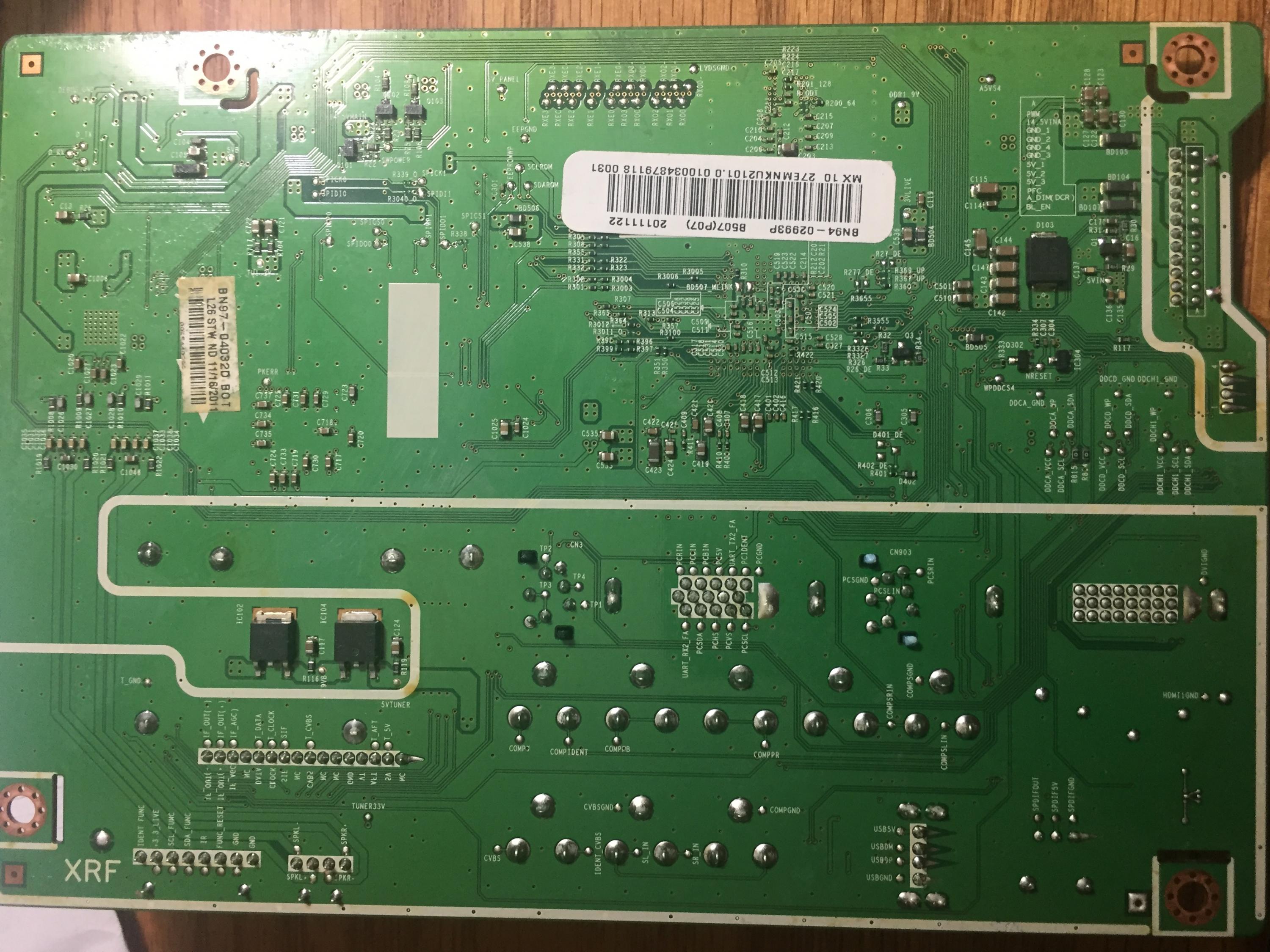

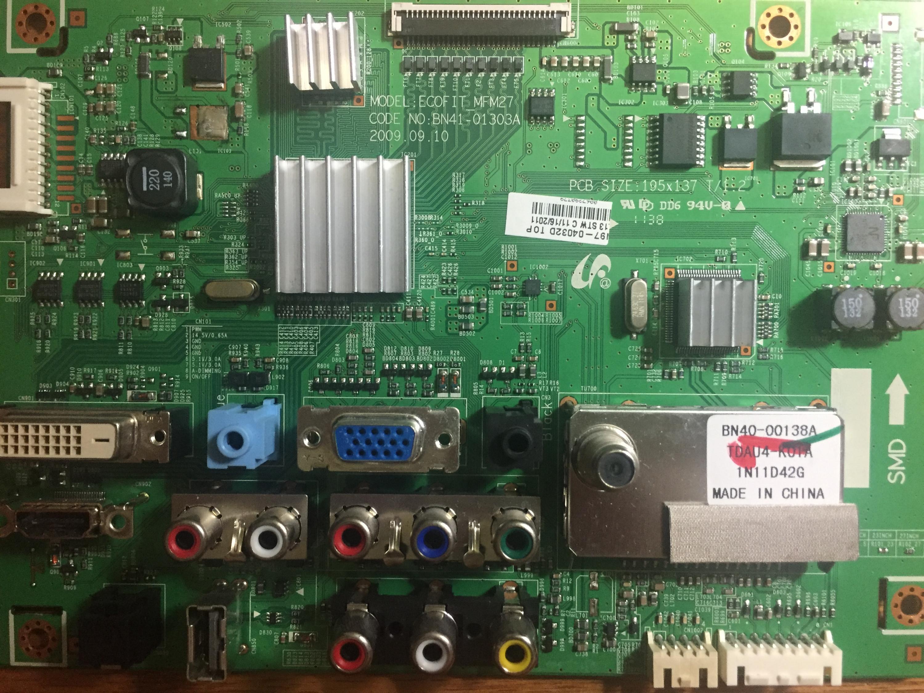

    At this point the monitor is off and the back lights too. Upload some high quality pictures of your main board so we can see something.
      Re: syncmaster p2770hd no power to touch panel
      "17-33 1127BG' What DCV do you have on the 3 pins of the regulator with ref to GND?

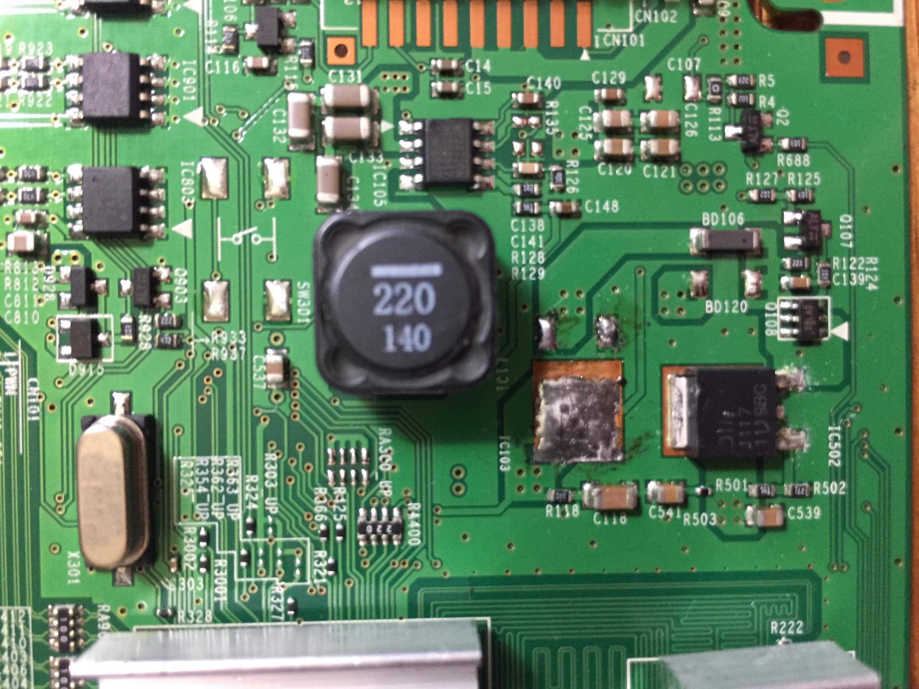

                          I'm not sure exactly what to check because I don't the schematics but I guess ill try to poke around.
                            Remove the regulator then check the resistance between the middle pad and GND to see if it shows <1 Ohm or not as suggested in my post #8 which you did so it is not the IC that is shorted.
                            Can I see the closed up pictures where that regulator is? you may have to remove some caps next.
                              The picture of the removed regulator is posted above.
                              Heres a closeup of the board with out it.
                              and the back side right behind it
