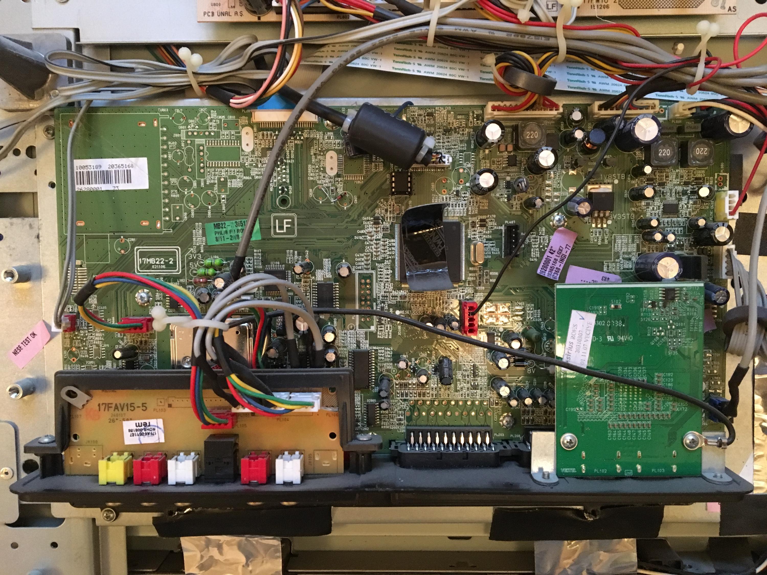

    Hi all again
    Been given this tv to play with, its was going in skip
    TV all seems to work fine but has a humming sound coming from speakers, if sound is high it is not that noticeable but when the sound is low its there and it is annoying

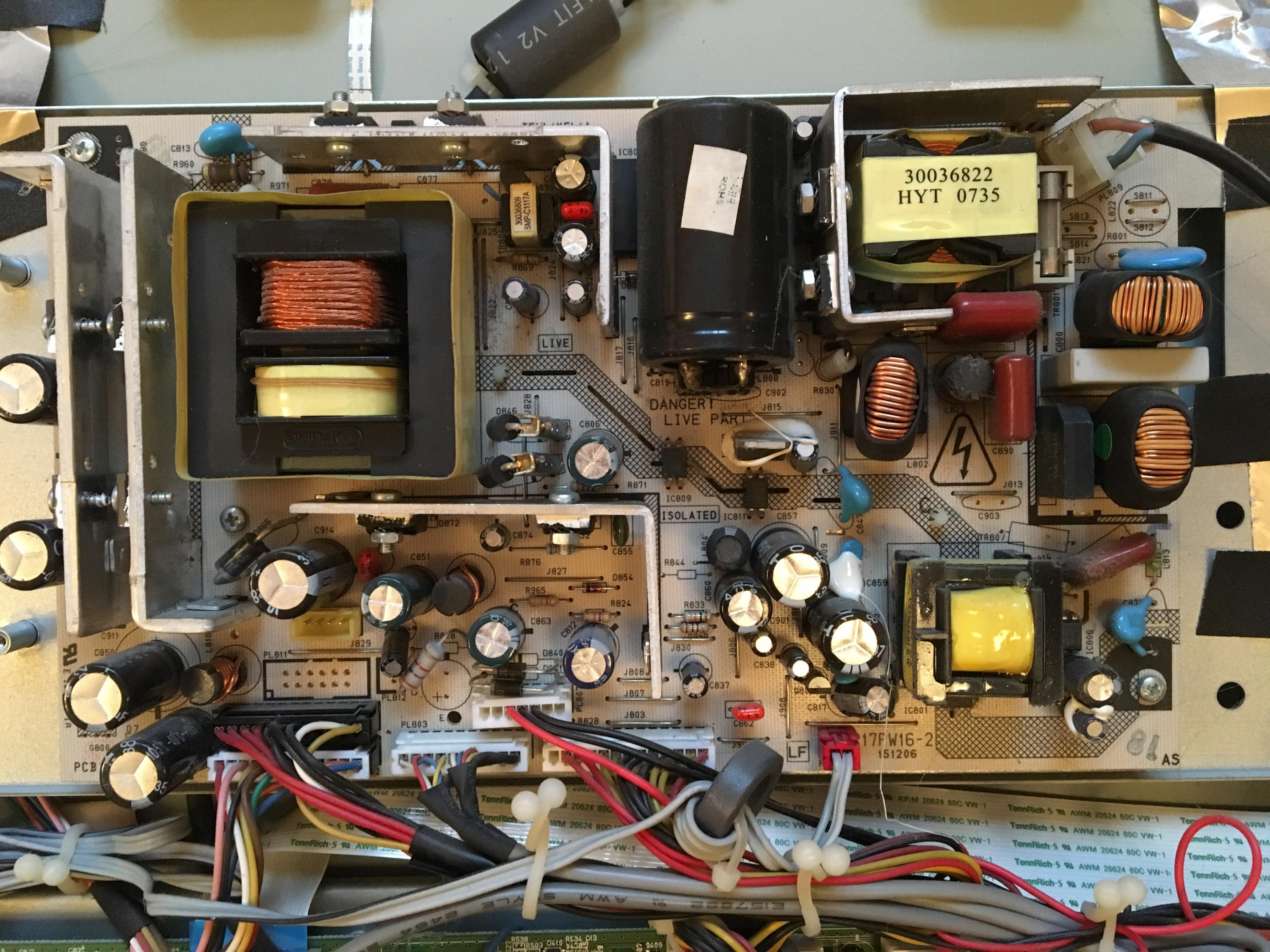

    Took back cover off expecting to see some bulged leaky caps but everything looks fine, therefore with my limited knowledge I would not have any idea where to look next, any ideas please where to start looking, Power board is a 17PW16-2
    will post pics as soon as they upload from my camera to pc

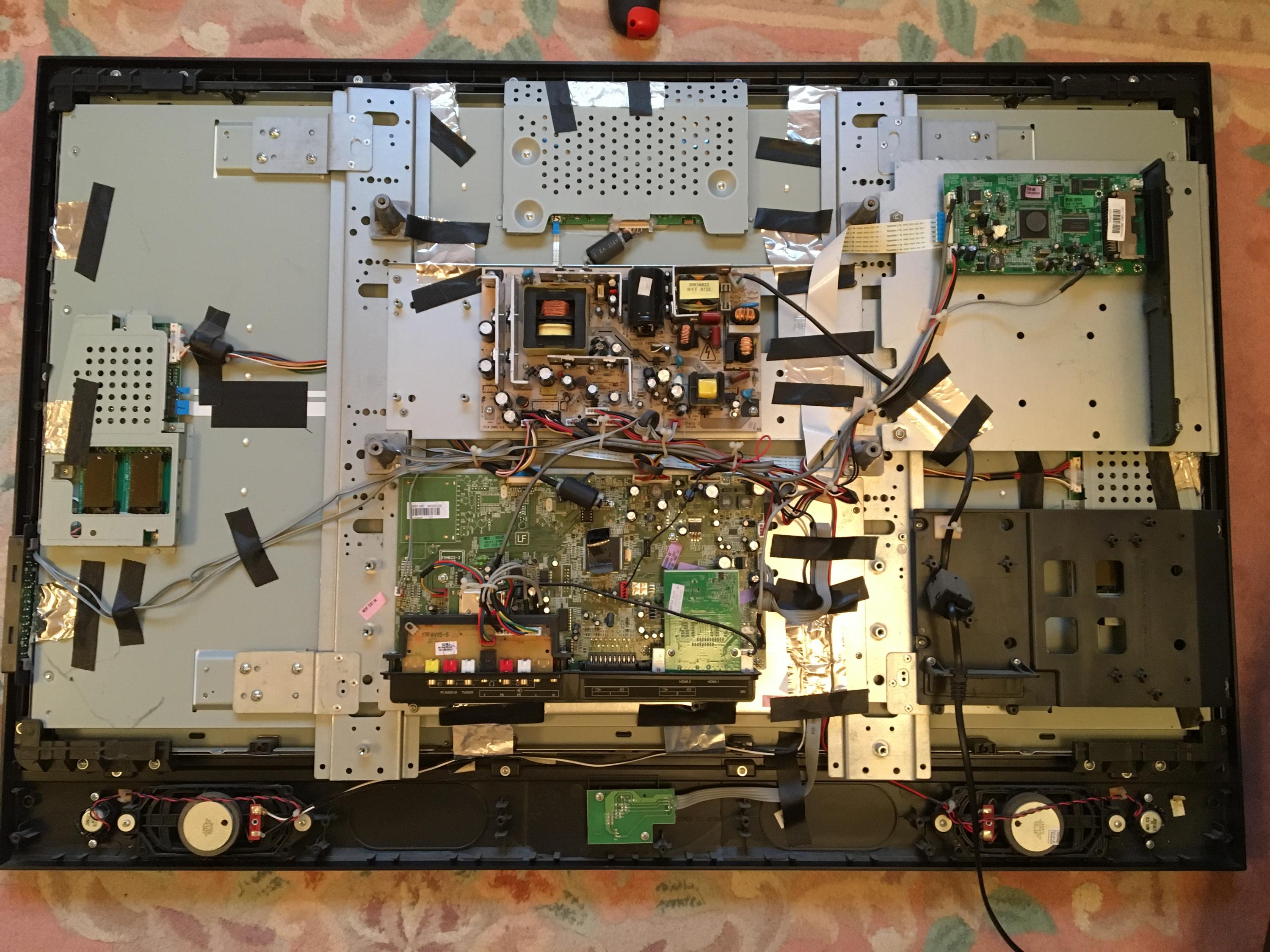

    Re: Technika lcd42-207 humming, buzzing sound
    here are pics
      They might not be bulging or leaking but as it's a Vestel I'd suspect some of those caps are the culprit.
      I fixed a smaller Vestel recently with a hum from the speakers by replacing a few of the caps. Check the 3 green ones (IIRC 1000uf) with an ESR tester and the 2 at the top of the mainboard.
          Test caps for esr on the mb, also the inverters Ive had cause a slight buzzing when the caps on it fail.
            First, is the hum on the speakers from all inputs tried.
            Can you hear it on the headphone out.
            Do you have access to an oscilloscope to look at the input /output of the audio IC
              hi thanks for the help
              humming seems to be on all inputs not tried headphone jack out
              have just changed the 3 X green 1000 16v caps on power board, humming is still there
              have not got the mainboard 1000 X 35v caps here to try them, will try and get some tomorrow
                    ok just done a naughty one, I have taken some 1000 35v caps off a scrap board and changed the 3 mainboard caps, just fired it up with no inputs connected yet and noise seems to have gone, it was noisy before with no inputs connected, will get it all back together and try it again
                      ok all back together humming buzzing gone so looks like it was those mainboard caps, even though i have put on used caps, should probably replace them with new but think will leave these while its ok
