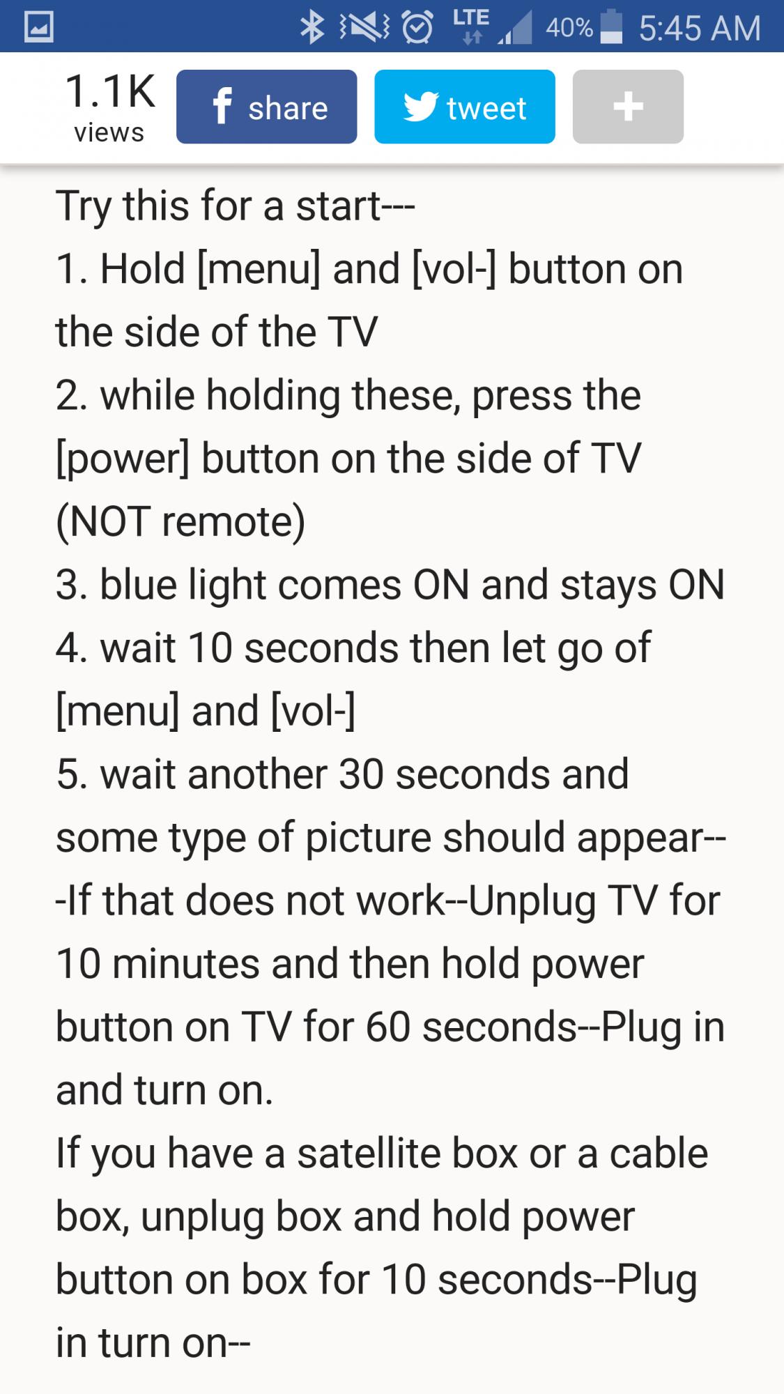

    It means the ic needs to be reprogrammed. Try to find out how to upgrade the tv's firmware via usb stick.
    I also found this - probably not for your model but won't hurt to try it.

      Re: Haier LE40B650
      thanks ,but this trick doesn t work!
      also can find any firmware for this type haier tv!?

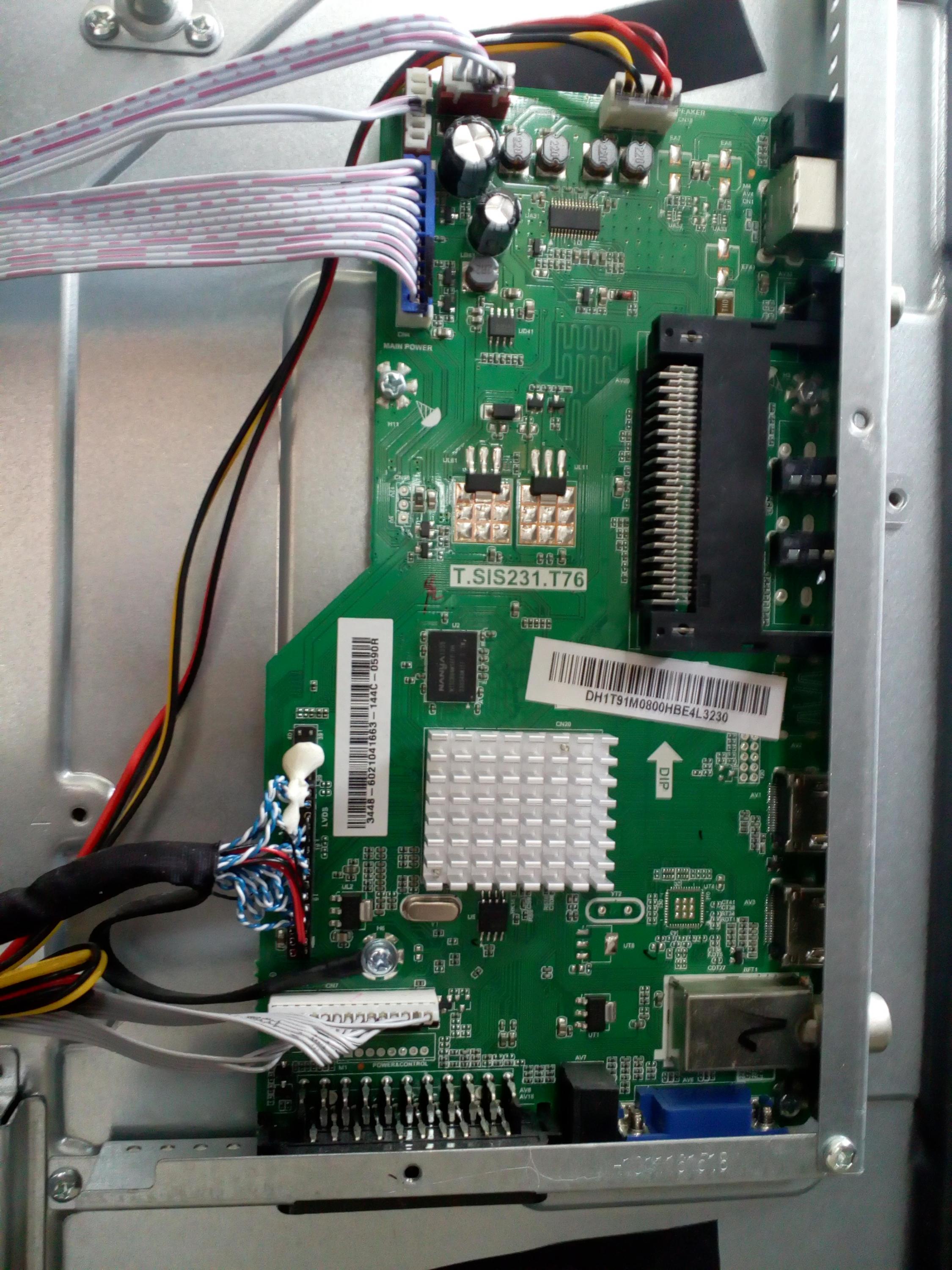

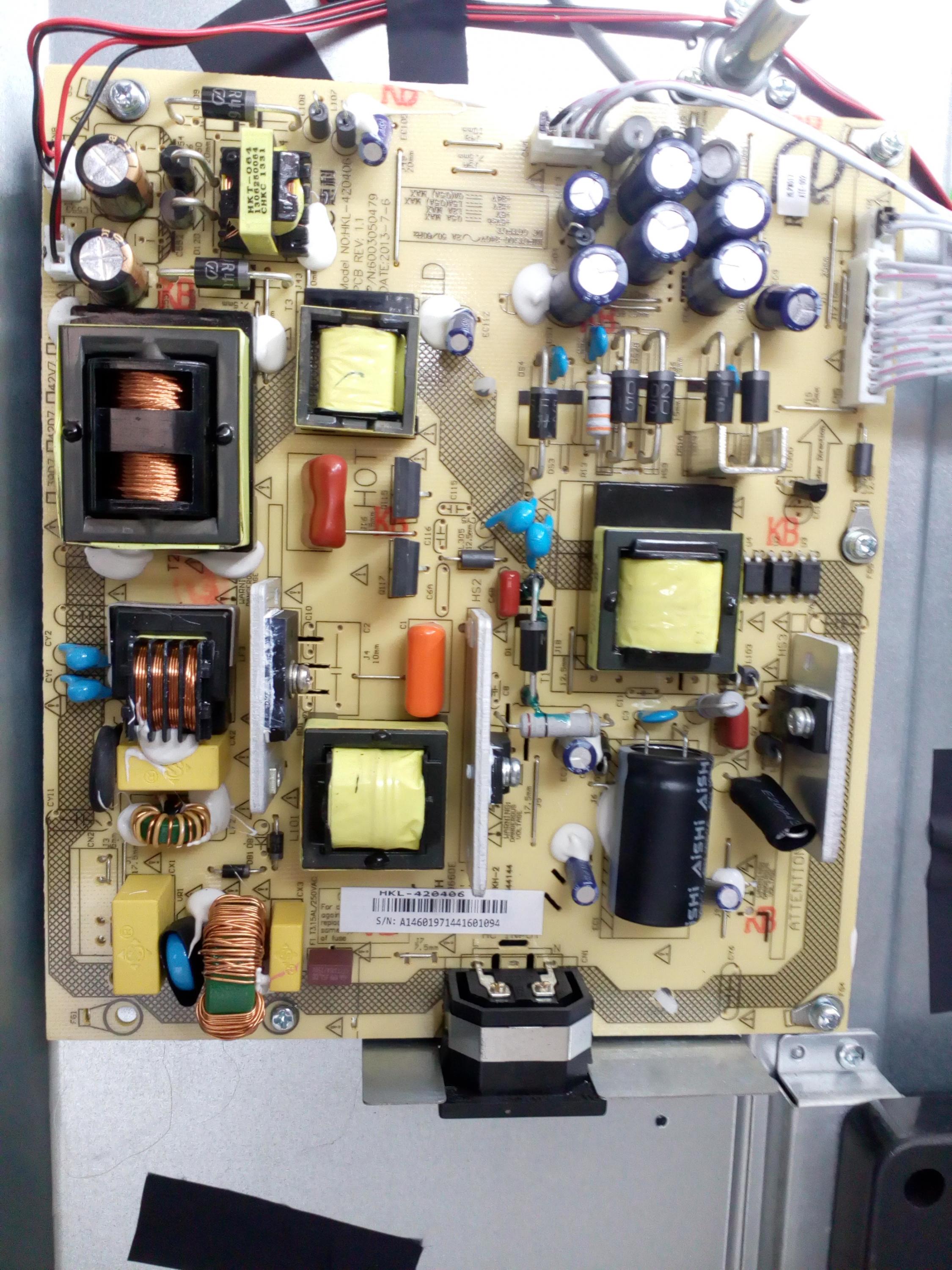

          Re: Haier LE40B650
          here some pictures of the power supply and the main board
          does anyone seen these before?
          can find nothing from firmware or other info off this haier!?
            Re: Haier LE40B650
            Westinghouse TV uses the same board.
            http://www.shopjimmy.com/catalogsear.../?q=HKL-420406
            Westinghouse HKL-420406 Power Supply
