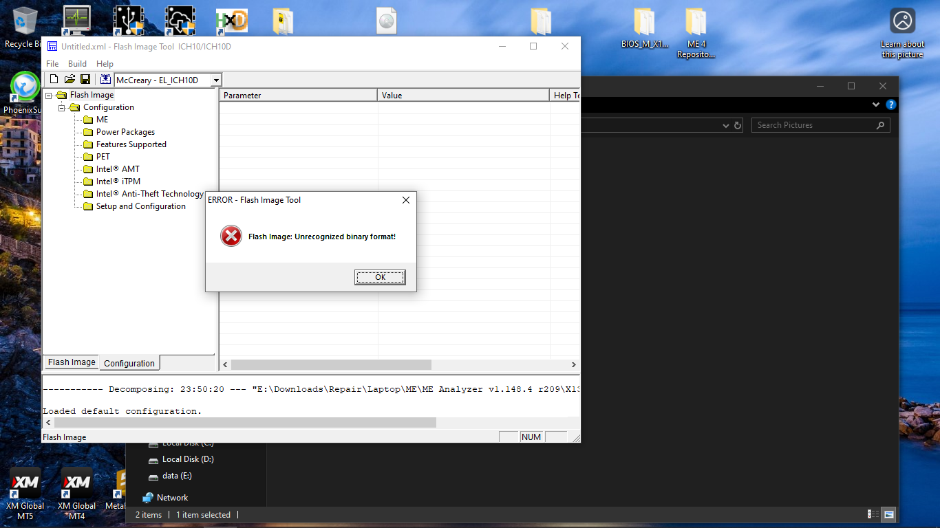

    I have been trying to revive a dead laptop without sucess. Checked all the voltages and they are present, only bios is left. I have tried to correct this firmware without sucess and seeking for help here.
    Attached here is the bios dump.
    Laptop model is Haier S2.
    S/N: JM032E00004WK3W0451
    Board: X133G rev 3.1
  • gurangax
    • Apr 2020
    • 34
    • Malaysia
    Tried to open it with FIT but its unrecognized.

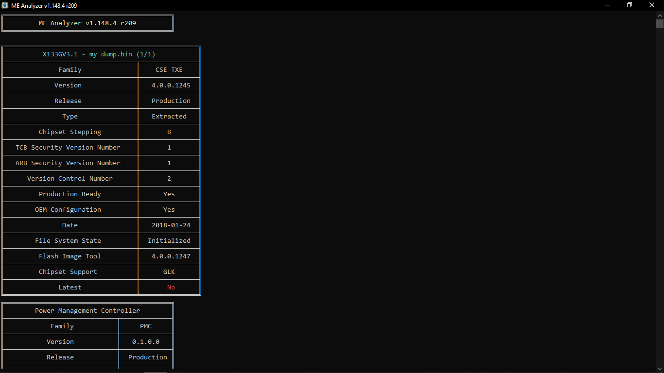

      • 21823
      Open the bios with ME Analyzer, it has TXE 4 firmware, so you need the TXE 4 system tools and TXE 4 firmware

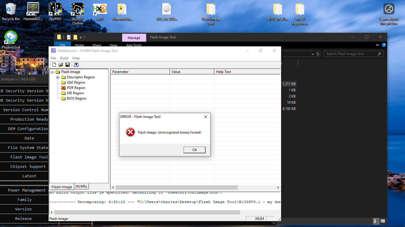

        I tried Fit 4 and failed. What did I do wrong?
        • gurangax
          • Apr 2020
          • 34
          • Malaysia
          I used the wrong version. Thanks to you I managed to find the right TXE tools. Now I can try to clean this bios. Thanks
          • gurangax
            • Apr 2020
            • 34
            • Malaysia
            I wonder if i did it corectly. I tried to clean me region, but still no display. Can anyone comfirm if i did it correctly with this file.
